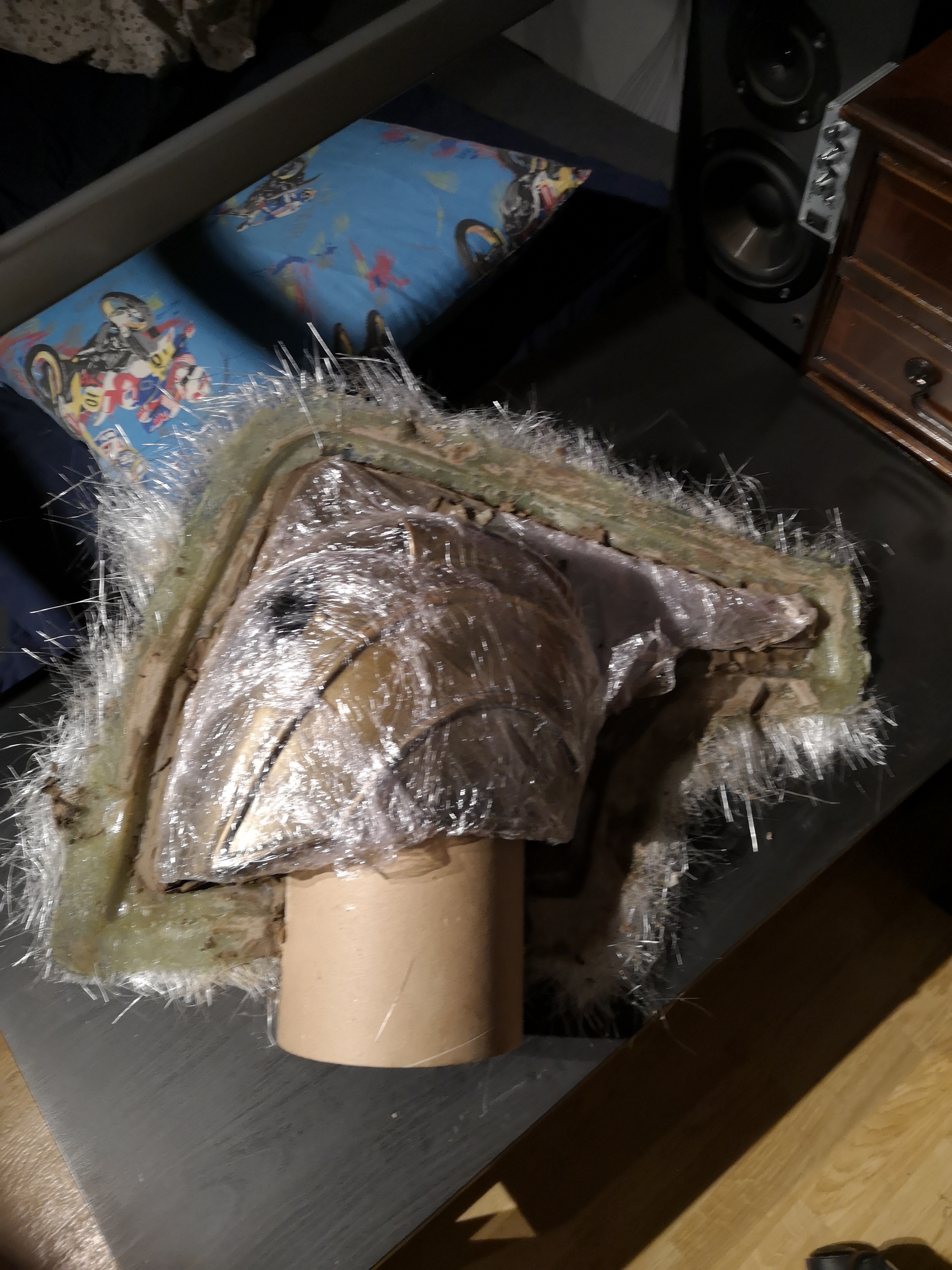

I began by covering the helmet in WED clay to create a barrier between the helmet and what would become the jacket mold. I did one side at a time, using hardboard and plywood as the center-line. Basically; I cut out a hole in the wood which matched the silhouette of the helmet, I then put the helmet in the hole so that the wood went along the center of the helmet. I then put the clay on, and once one side was clayed and fiberglassed, I could remove the wood and flip the whole thing over to repeat the process for the opposite side, minus the wood this time (don't forget to use some release agent to make sure you can pry the fiberglass apart later)
Once both sides were fiberglassed, I could then pry the jacket mold apart and remove the clay from that half of the helmet. I then re-assembled the jacket mold, poured the silicone and once that dried, I flipped it over and did the same thing again on the other side, and then I had a mold!

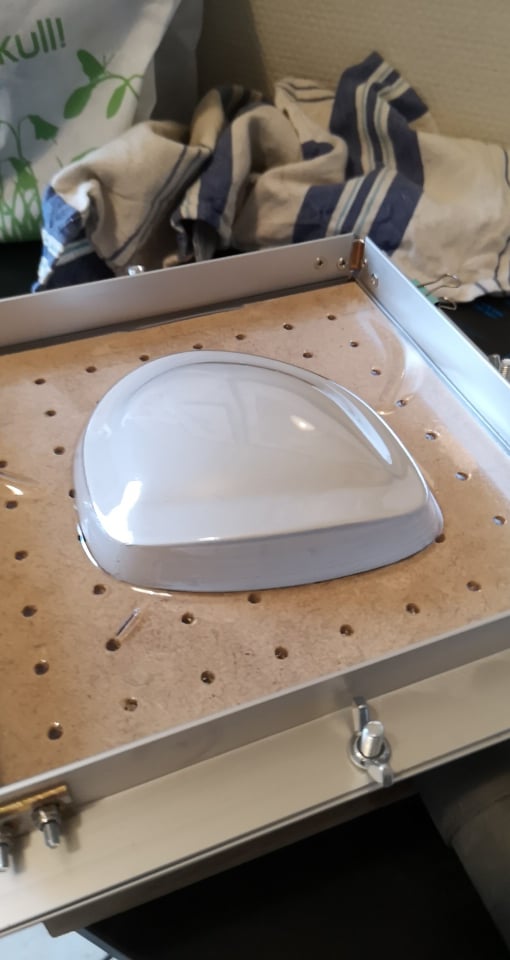

And lastly, let me super quickly go over how I made the eye lenses!

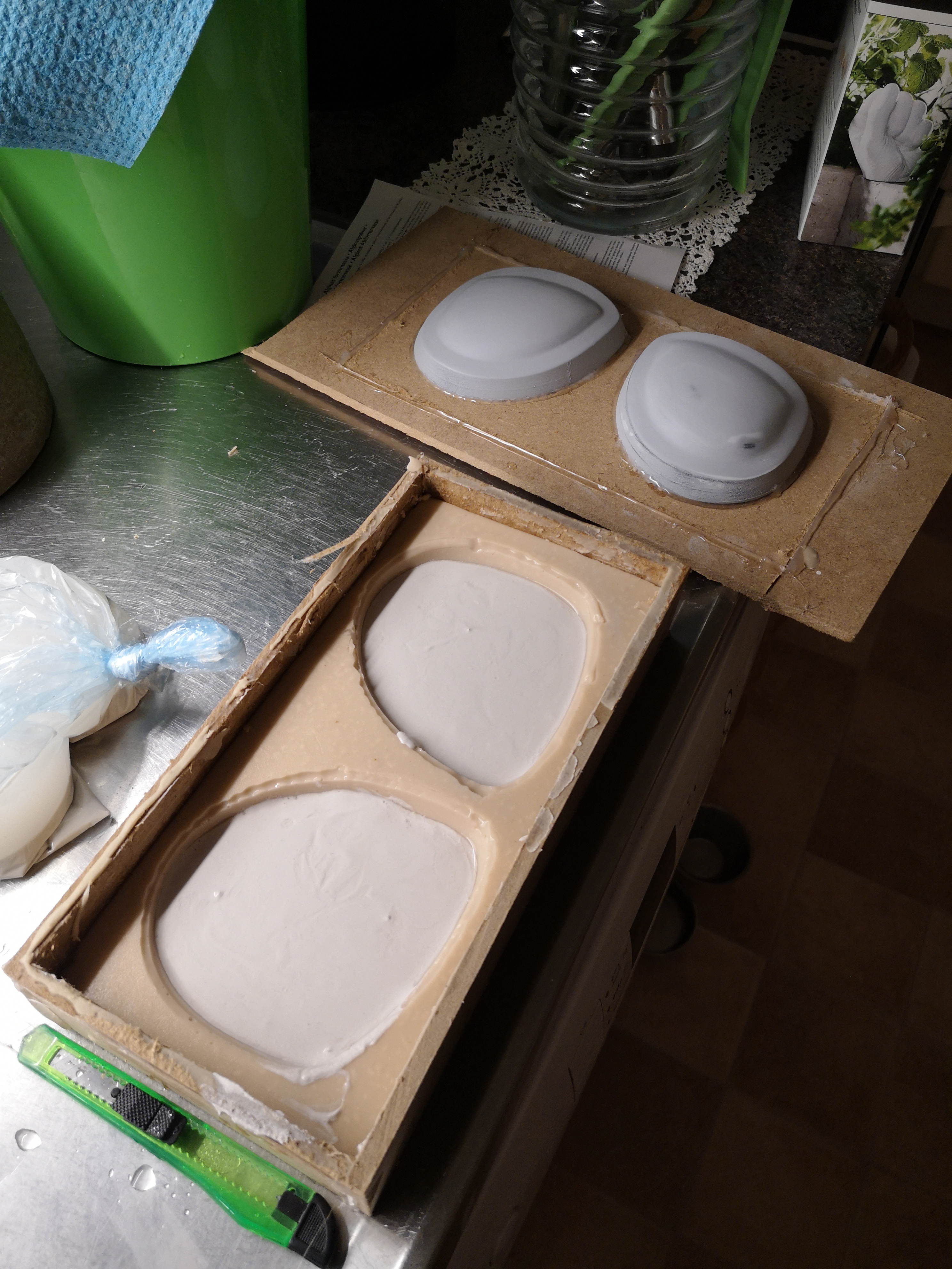

I intended to vacuum form them, so I 3D printed bucks for the vacuum forming process, I then cast the bucks in plaster using a mold made from alginate (a one-off mold which is destroyed after a single use)

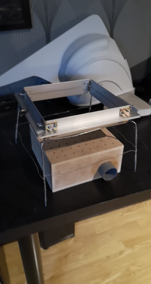

I made a small vacuum former using MDF, some scrap aluminium profiles, steel wire and my vacuum cleaner. I didn't incorporate a heating element, but heating the frame and plastic in the oven worked fine for my purposes.
Once I had the clear lenses I dyed them using a synthetic fabric dye called iDye Poly. It's the only one I've found which seems to work on PETG plastic.
