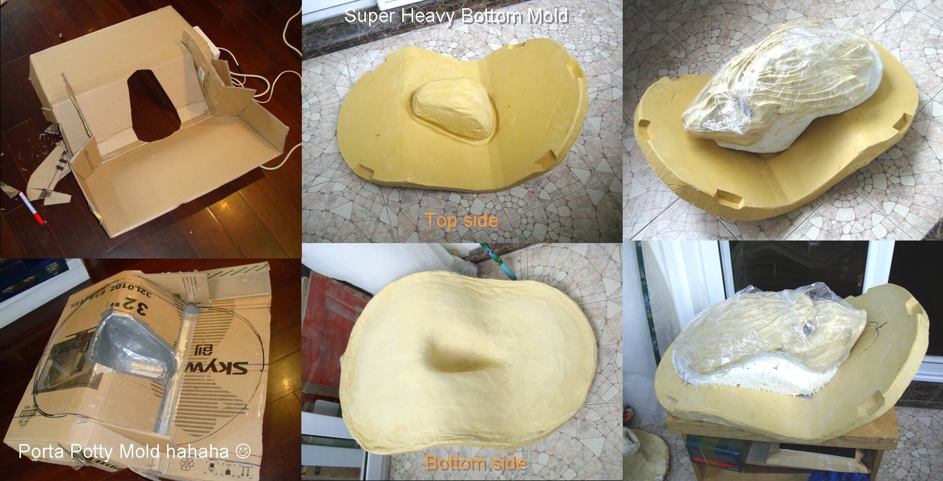

Top Jacket molding stage in Progress
5cm Thick Bottom mold good for making 3+ more Bios.
Unlike the last one that broke during demolding of my third Bio Scuba which is surprising since I made the bottom mold for molding Ancient Bio
Built to Last
- Bottom mold made of layers of: Plaster powder infused with Burlap, metal wire mesh, more Burlap, fiberglass, Plaster bandage, fiberglass and last layer of Plaster bandage
Pics: Bottom Mold and Mounting.

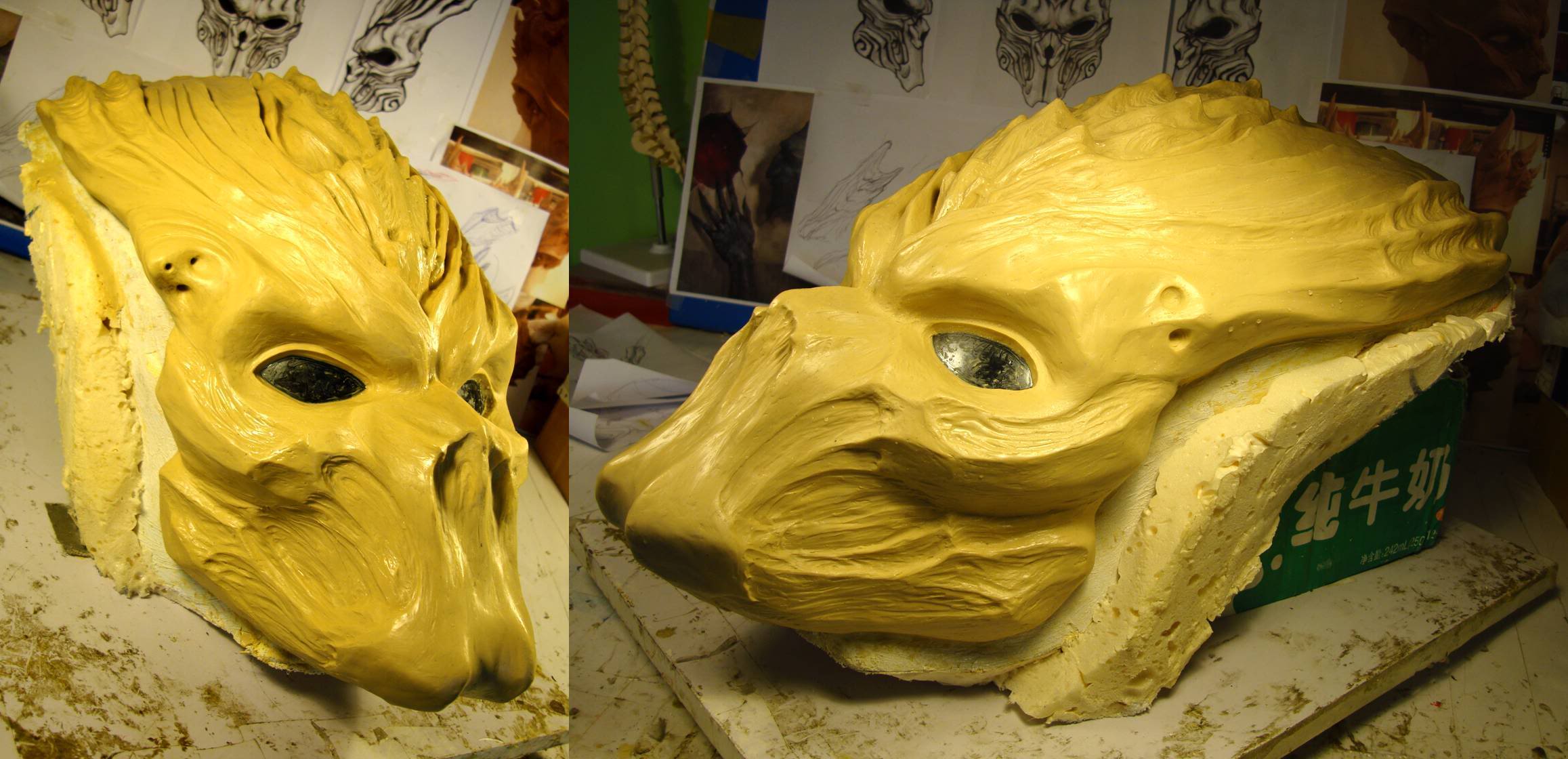

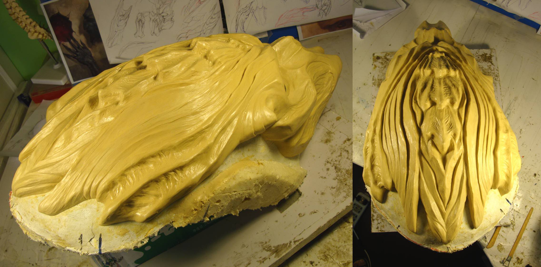

There! Its Done!
Been struggling with the Heat and the clay melting to a Peanut butter consistency. I've been putting a spray bottle water in the freezer overnight and constantly spraying it
with cold water to keep it from melting. its like 95 Degrees in Shanghai -HOT!
So hot the Silicone cured in 4 hours instead of 6.
Hopefully it didn't **** it all up during the molding stages. Will be demolding tomorrow.
- If it is this Bio's Prints and posters will be available for sale instead - Kidding :)
Here are the final sculpt picts - you can see there are still some water droplets here and there evaporating....
If you see any asymmetrical stuff blame it on the Heat and melting it out of proportions - :lmao:

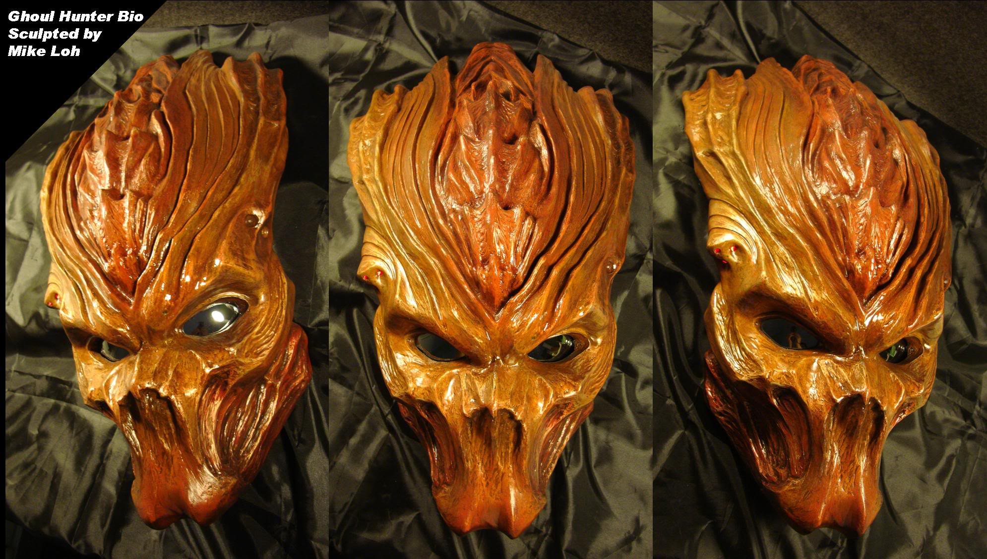

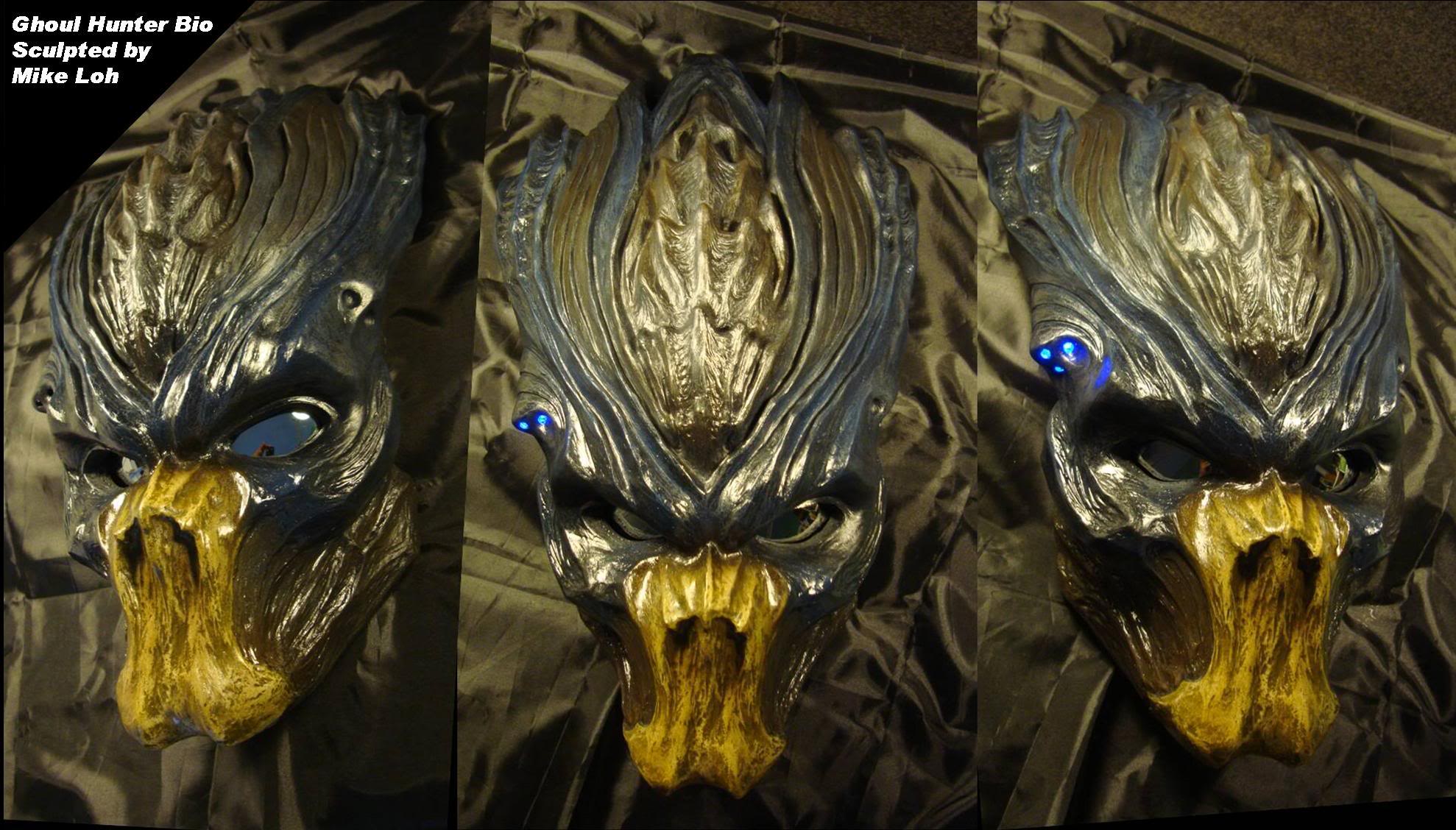

Just Finished sanding trimming patching painting and photographing and I'm fkin tired.
Too hot to think of any other creative paint jobs....
Painted on the hottest day on earth 40*C! * Resin Fbg with Tamiya & Acrylic Spray Paints
Black -Blue Hues Bio for the Ghoul Hunter aka Famine! Notice the Blue LED's ?

Actually I always think what would be a crazy color to put? When in doubt go RED!
I just play around with what ever colors ideas I have at the moment. The Red I was trying to go for a copper red finish but the red paint dried too quickly and the rub-off didn't
work as well so I said **** it - lets go with the RED. I spent whats left of the Gold under paint for that.
