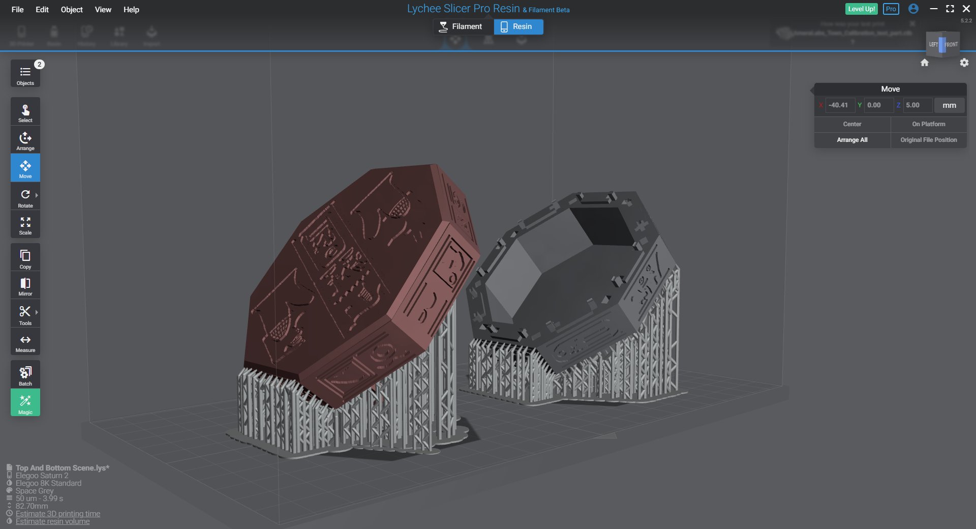

Hi MTB, I could use your advice... Most of the pieces printed well the first time for me, but I'm having trouble with the bottom--five tries so far. If you have time, would you mind sharing a screenshot of the bottom in your slicer, to show the general orientation and supports?
Im am sorry this took so long for me to reply!
Here is how I printed the top and bottoms and the settings I used in Lychee. I have the Elegoo Saturn 2 8k printer:

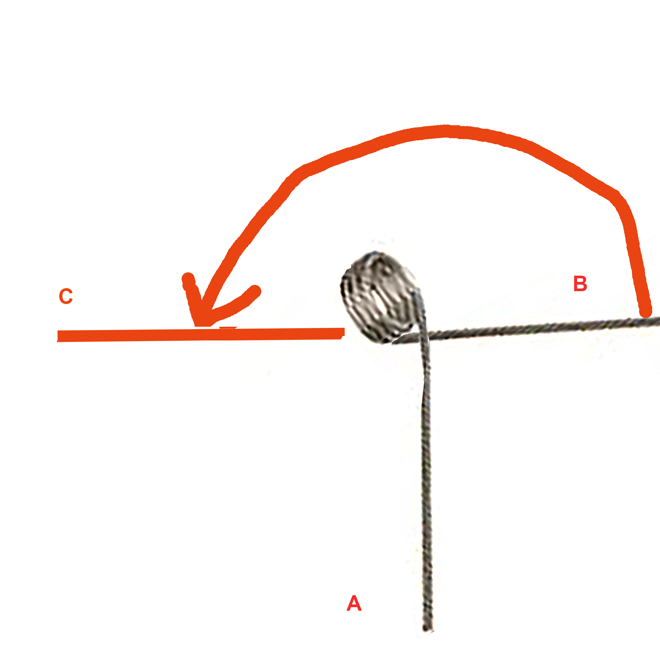

So, the springs in this instance are a custom size and I only ordered so many, because they're actually pricey. Also, the posts that go through the flaps are included, but could be ordered separately. In short, the springs I already have are spoken for. I will post the spring-guy's contact info if you wish to order some yourself. The post (for lack of a better word) is a short straight 1.6mm rod. One per flap. Eight flaps. I got them off of Amazon. I can post that info as well.
Hi Jintosh, I'd like to call back to this comment from Feb (sorry if there's a follow-up I didn't see).
Will you please post the spring and rod specs and where you got them? I lost a couple pieces, so I'm in a tough spot. :eek:
The brass rod is 1/16th of an inch diameter. And you cut them to about 18.5mm wide. You can get these off of Amazon cheap and easy.
T .100 X .013 X 7.75C, LH is the spring.
T stands for TORSION spring. LH stands for Left Hand wind.
.1 is OD of coil and .013 is diameter of wire, and 7.75 is the amount of coils in the torsion spring.
I tried to draw the spring, remember, it's left hand wind. So, from the closest leg, the wire winds in a coil. This might be called a 270 degree spring. When closing the flap, it rotates counter-clockwise from B to C. When the bottom is turned, the spring flips open from C to B.
That's great, thank you! Can you also provide the outer diameter of the coil? It seems about 2.5mm, but I don't have calipers.
Also, you mentioned you had them custom made. What's the name/website of the place you ordered and how much did they cost?
Dimensions are in inches. OD is .1 inches, which would be 2.54 mm.
