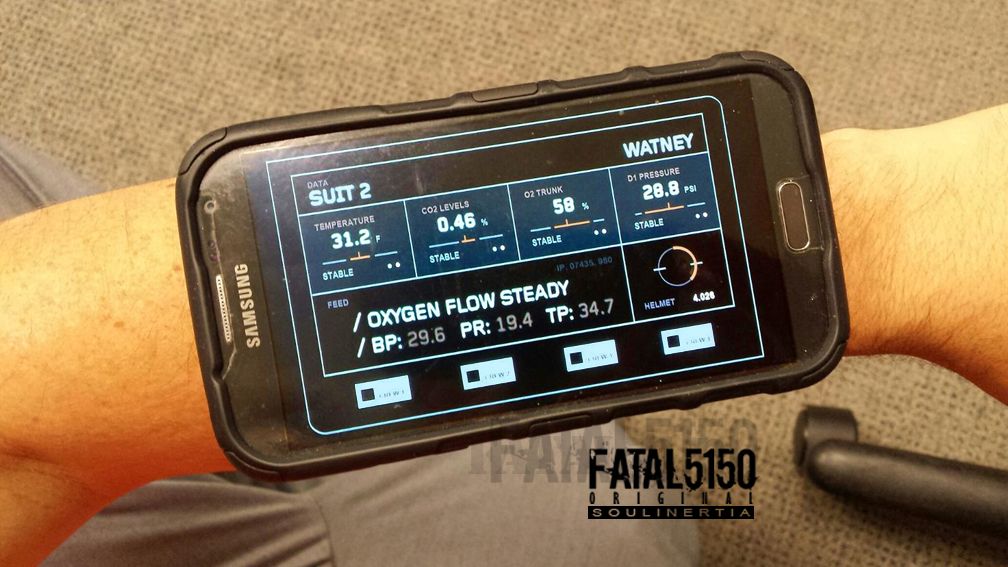

I think my Galaxy note 2 might be a bit big.
I noticed that a new Raspberry Pi 2 touch screen has been released, think that would work?

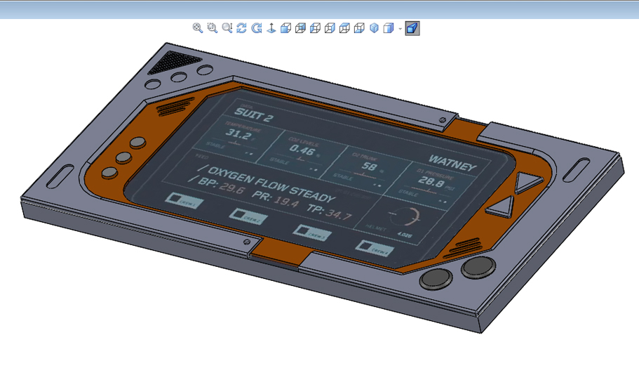

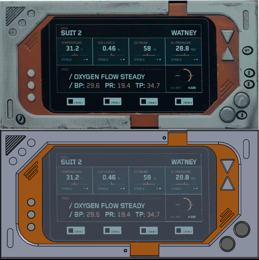

Started modeling the wrist computer today. That high res photo really helped. Will attempt the sides this weekend.
Also an iPhone6 will fit and thew screen will work for this. At least according to this model so far.

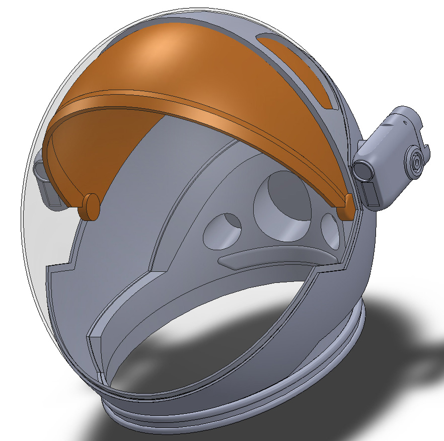

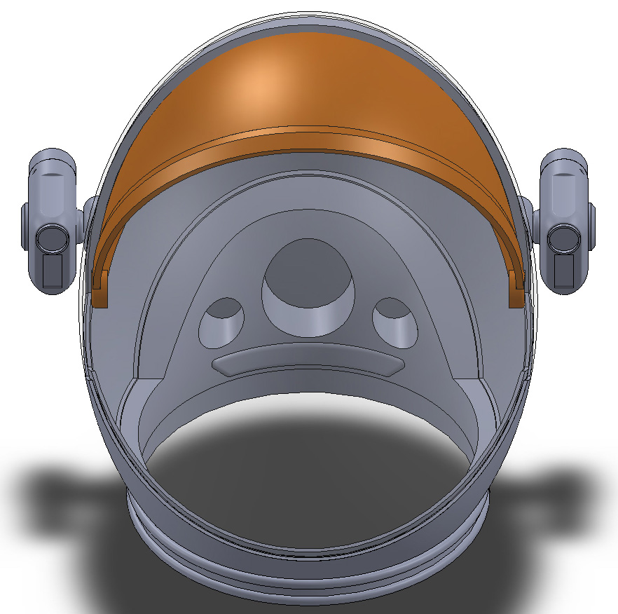

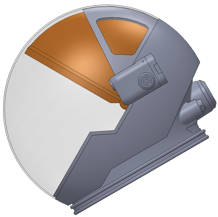

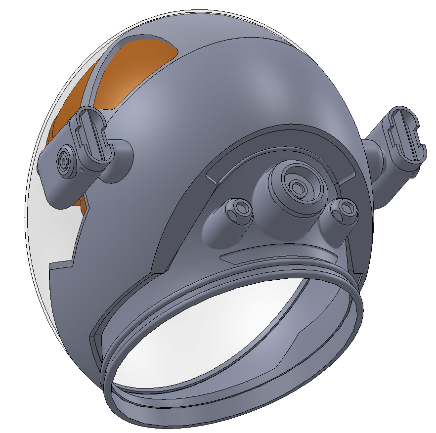

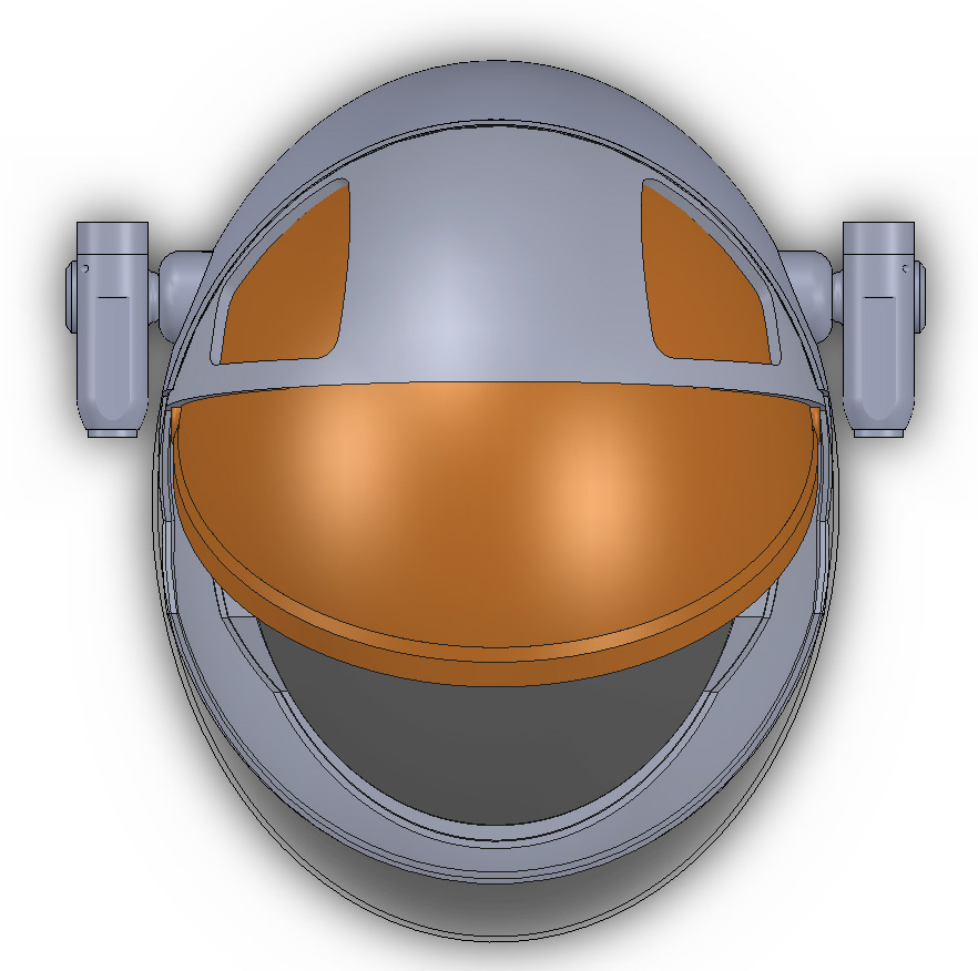

Also, that helmet is starting to look really accurate, April. Any tips on making the visor? I thought about 3D printing the whole helmet but the visor would require me to print it slightly smaller so I can vacuum form the visor.
