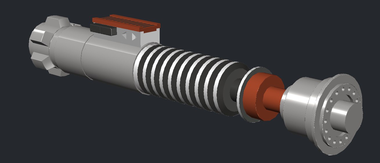

To me it looks like the step up from the main body of the pommel to the flat spaces between the cubes needs to greater.

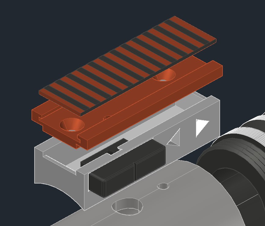

Only update is that Slothfurnace has mailed me to say he is looking doing a run of 13 gold trace cards for the Romans V4 which is slightly bigger than the control box so that the first trace can be filed down
That’s exactly what I have done with his cards?!
Both the RoTJ card and his creepy uncle card?
Here is the card, alittle bigger then the box, with equal length hanging off each end

And here it is sanded, I sanded .50mm on the bottom, and .20 or .30 off the top so it fits flush

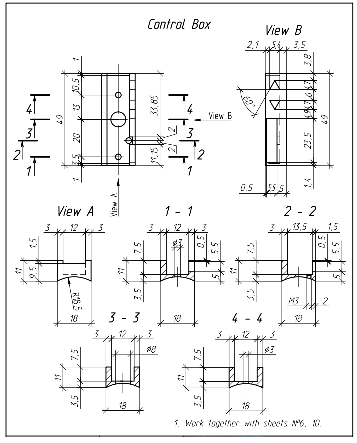

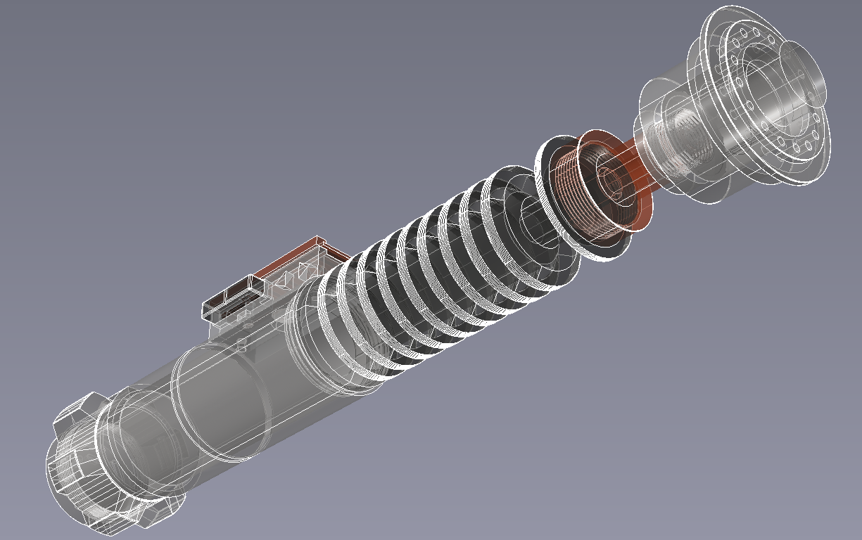

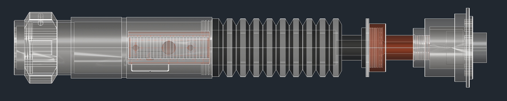

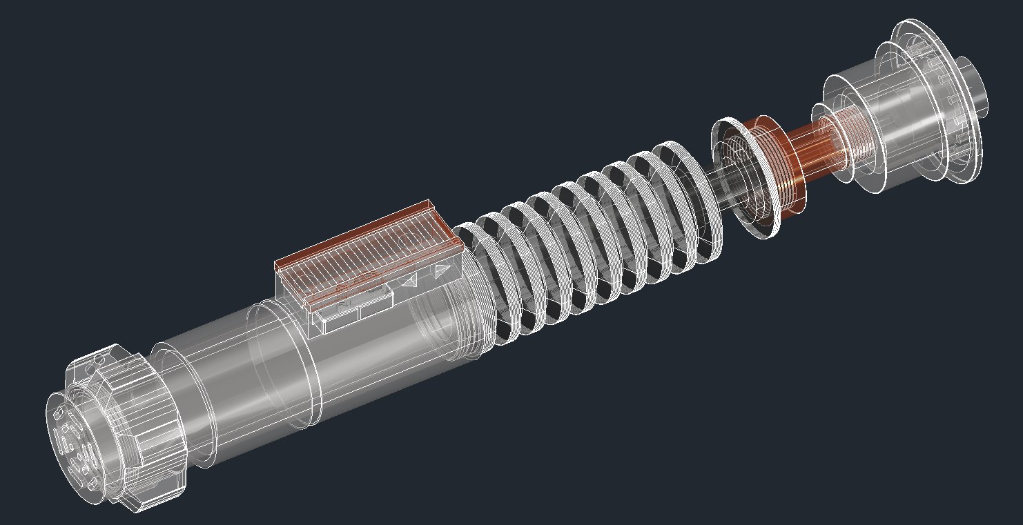

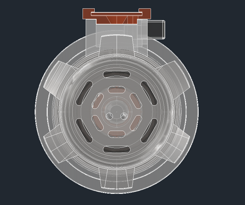

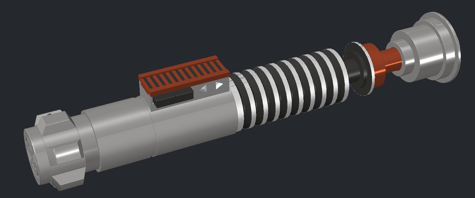

I think the spaces between the pommel cubes are flat on the prop, and it looks like they're curved on your model.Finished 3d model based on my drawings.
Finished 3d model based on my drawings. Anyone interested? I think it will be ~180-190$ per hilt (machined aluminum, copper). Should I start "selling thread"?
View attachment 804391 View attachment 804393 View attachment 804394
View attachment 804397 View attachment 804398
View attachment 804400 View attachment 804392 View attachment 804399
Yes, they're curved cause I'm pretty shure that they are curvedI think the spaces between the pommel cubes are flat on the prop, and it looks like they're curved on your model.
You mean without holes? Shure. (btw, I missed one round hole on the model :$)That looks great!!! :thumbsup Can I ask if you would be making an alternative plain pommel end for those that do not want to add electronics or sound?
Yes, they're curved cause I'm pretty shure that they are curvedHonestly, I thought about this issue. I have not found evidence that they are flat.
I studied for a long time all the shots, they have not convinced me.Look at the "coming off the belt" photos on the previous page. There's a round section at the end of the pommel above a flat area between the cubes. The reflections and lighting makes it quite clear.
