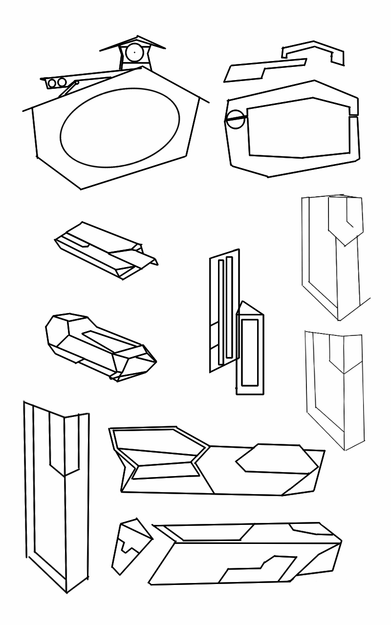

Weekly(ish) update!

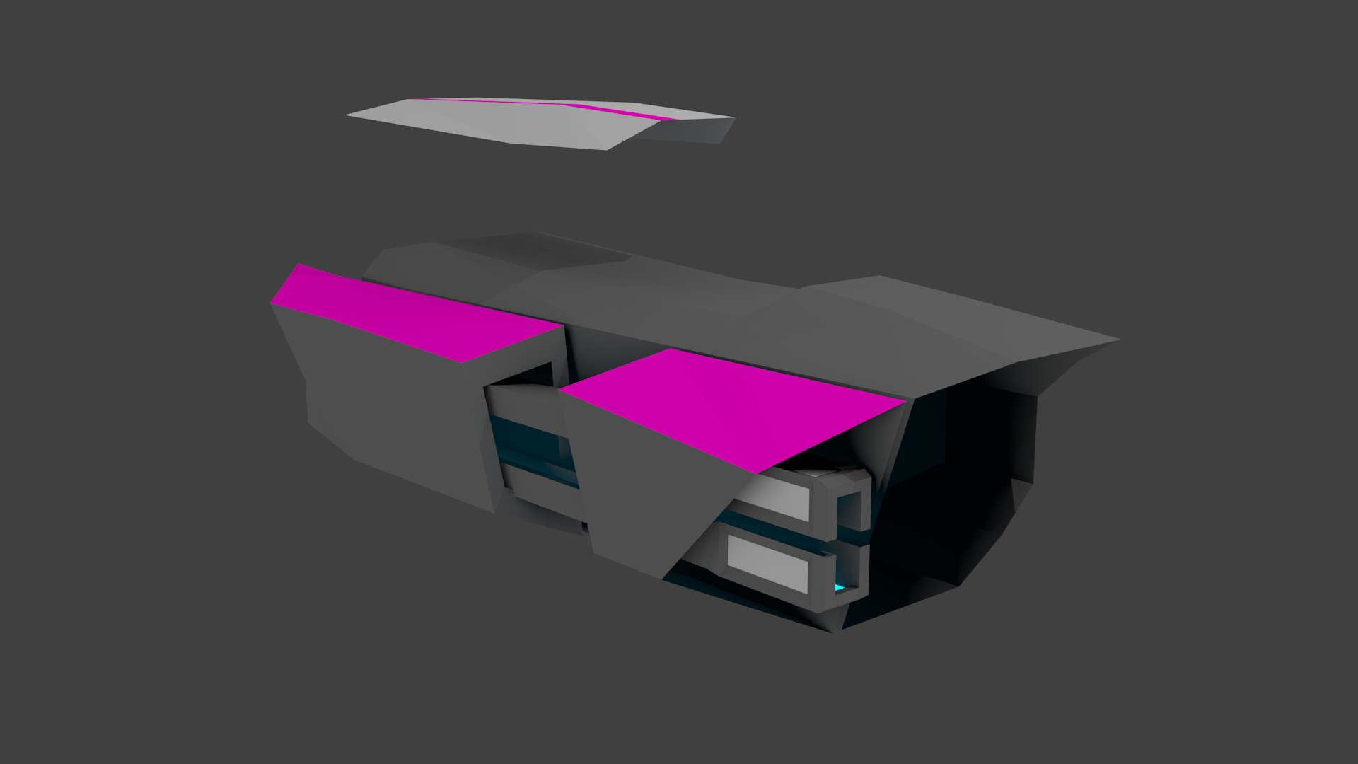

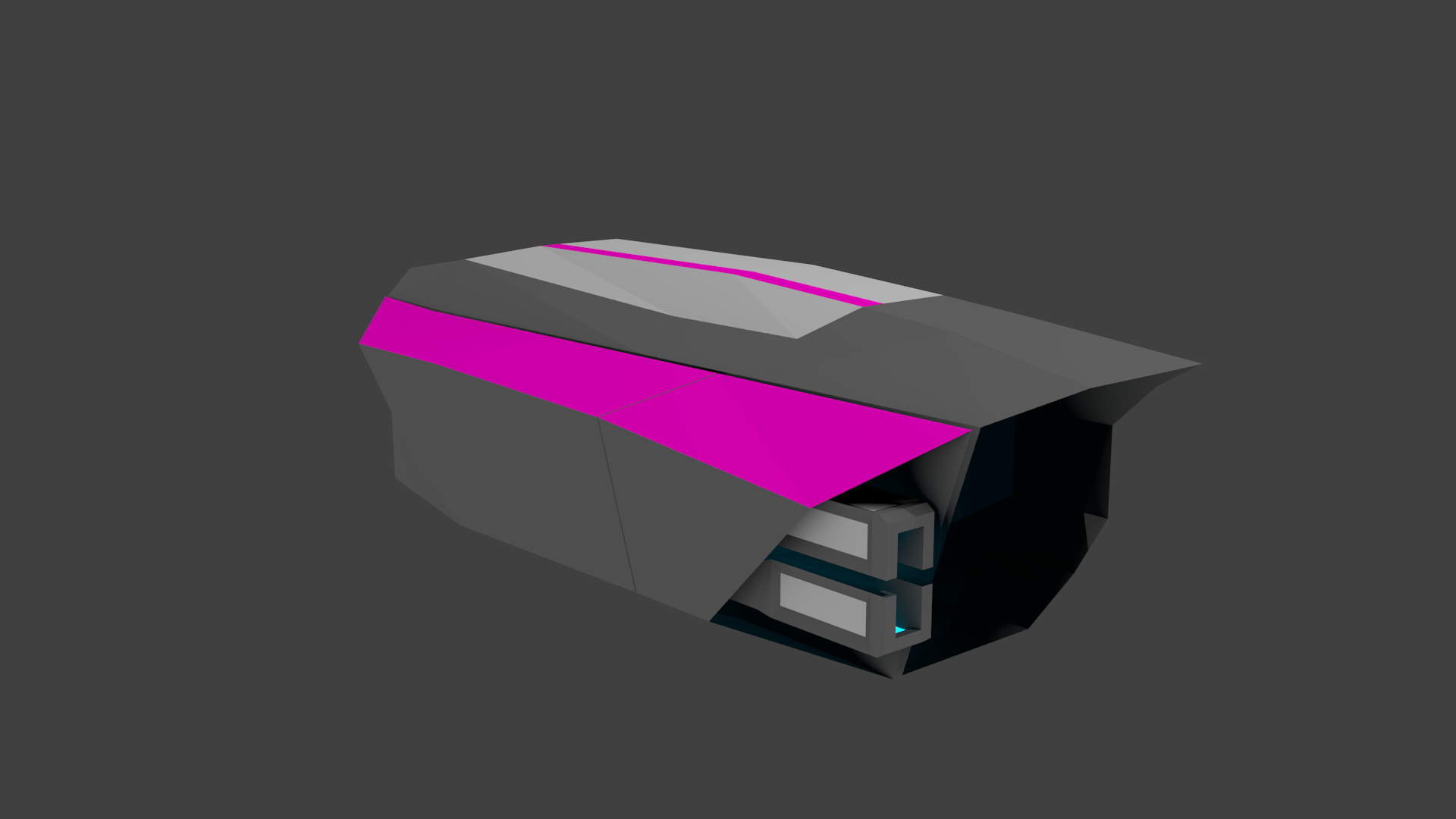

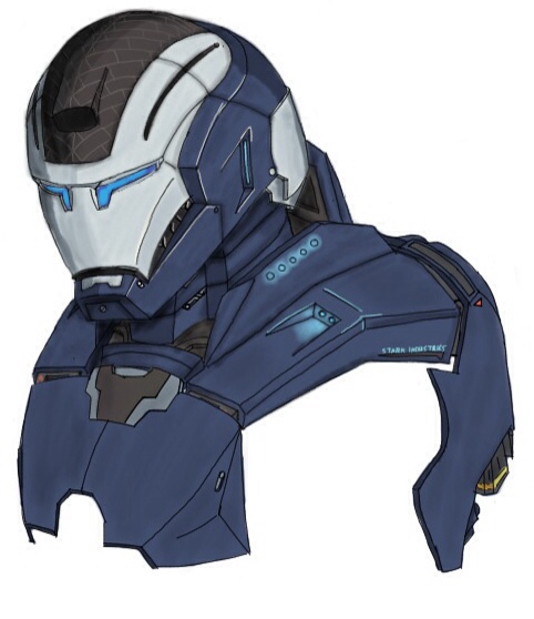

Worked primarily on War Girl this weekend, building up some concept sketches of her and starting with the gauntlet model. I settled on an energy weapon as opposed to the F2000's mounted on War Machine's arms, for purely superficial reasons. I also added the missile launcher pod from the Mk III/VII up top, though I don't think I'll have two missile launchers. Maybe a small SMG, unsure yet. Suggestions?
The top pod opens and closes like normal, but the back half of the arm gun only slides back when the weapon needs to cool. I kind of want there to be an "overheat" function - Mass Effect-style - where I can fire it for ~15 shots (heavy, shotgun-ish blasts), the inside of the arm starts to glow red/orange, and the weapon temperature on the HUD goes into alert mode. Then the back half slides open, internal lights fade from red/orange back to blue (add "hissssss" sound effect), weapon closes, resume firing. Haven't got all the details worked out, but it's definitely doable, and right now that kind of gratuitously unrealistic fun stuff is a breath of fresh air from the exoskeleton mechanical design (slogging along). And it makes me all happy and excited, so there. *squee*
Here's a few renders, hot off the Blender:

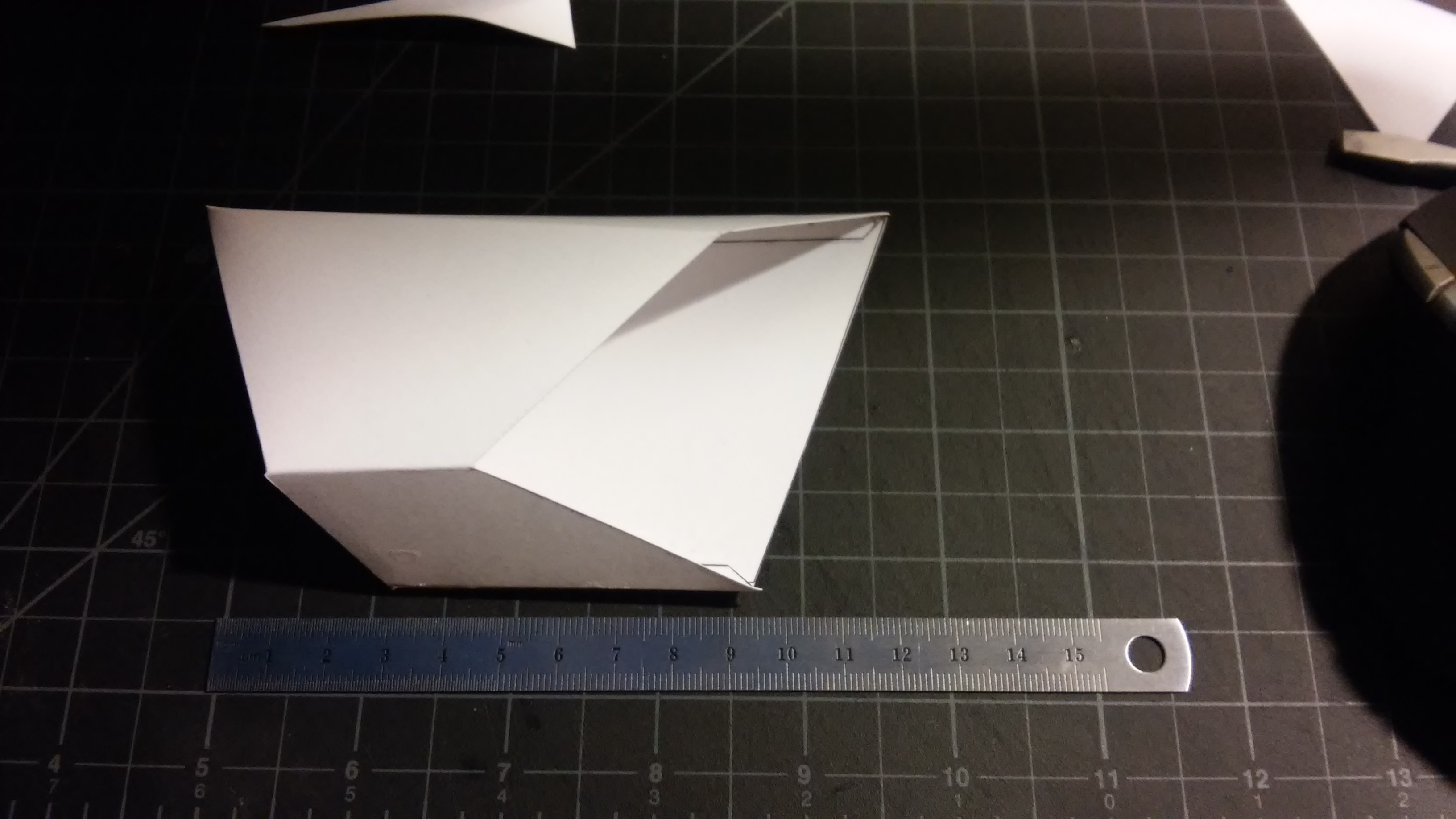

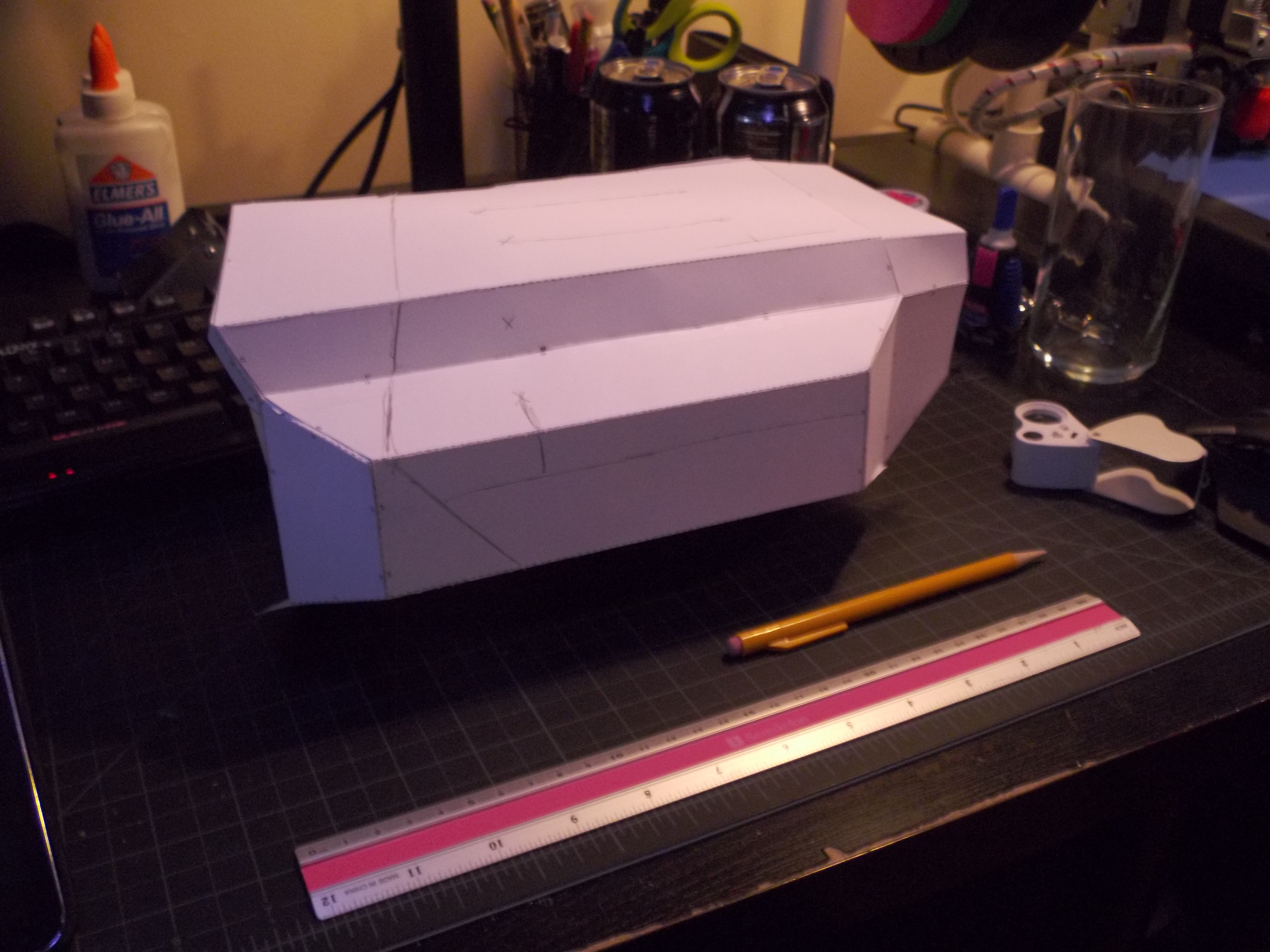

I've done a few quick peps of the front barrel cover (smallest part), and this is probably the scale I'm going to use, maybe a tad bigger if I get around to getting legal-sized cardstock:

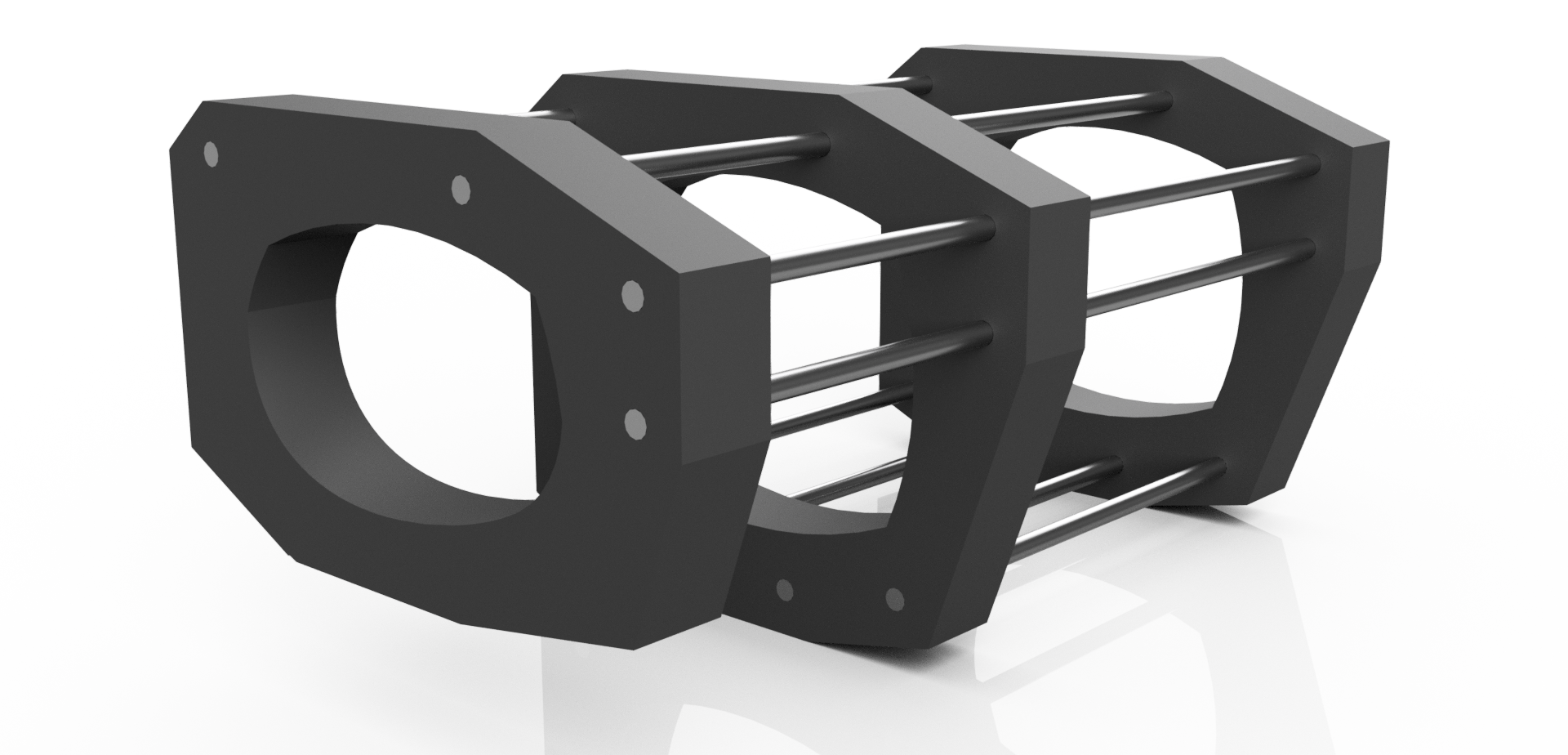

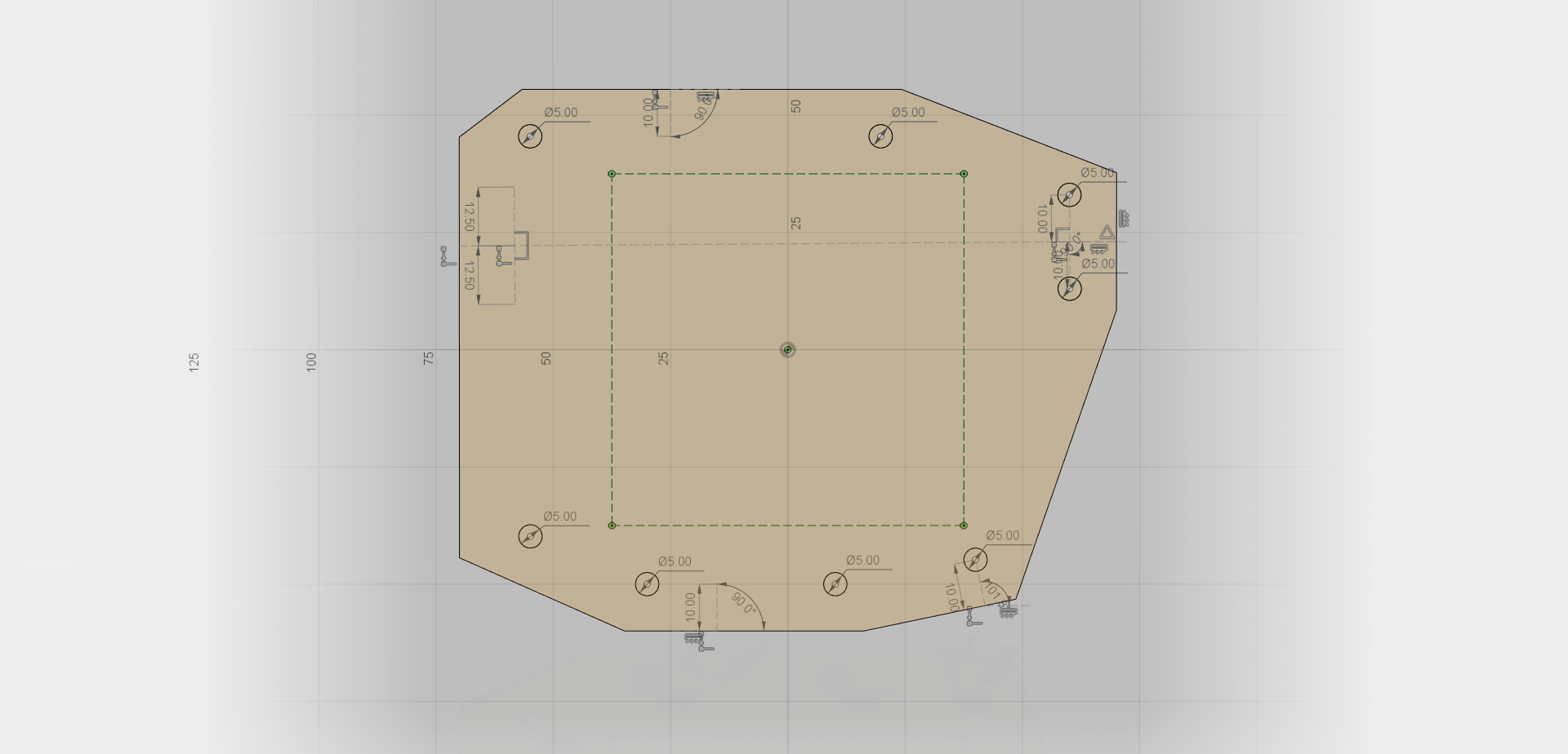

Just a nibble of a post here. I've been spending the last month switching my 3D models from direct modeling/sculpting over to CAD. Not only does this allow me to print/fabricate parts more easily, but I can run stress simulations on the suit. The forearm interior skeleton is just about done - I just need to add cable routing and maybe a hinge to the wrist bracket. I've aimed for chunky since it'll be inside the War Girl suit, and I don't have the magical satellite metals Tony Stark had access to.
The cross-section, if anybody wants to look at how it's laid out:
A render of the forearm module:
And a quick stress simulation on the outer edge:
Hopefully I'll have time to work my way up the arm as November gets on. I'm still getting the hang of CAD, so excuse the mess.
