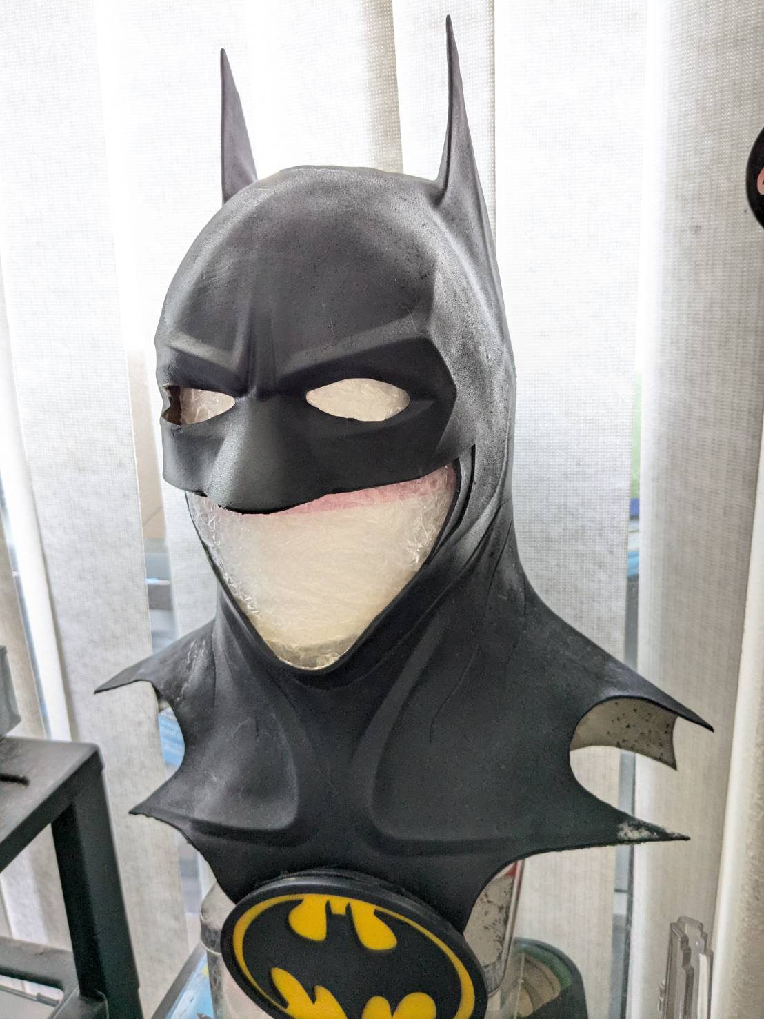

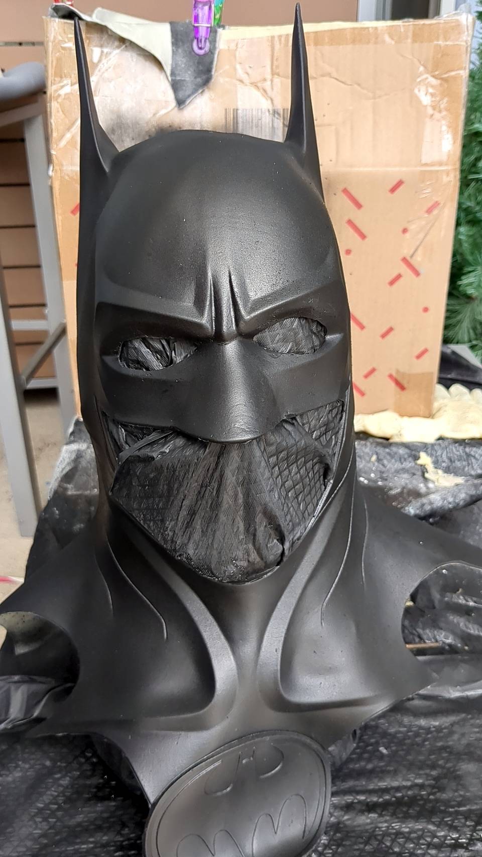

Cut some foam sheets for ear support and cut out the wouth and gave it some plastidip. Not 100% if im gonna try and thicken some areas with latex since it seems to hold it shape well on the manaquin.
Before Plastidip:
After
I do plan on replacing the emblem but im not sure if im going to cut it off or use it as a base
Added some latex to hopefully thicken it up/fill the ears (I removed the foam). Some of it dripped out onto the eyebrow but I'm hoping some light sand paper will fix that. I can't slosh it (for obvious reasons) so I'm brushing it on. I'll probly use the gauze soaked latex for the scallopped pieces

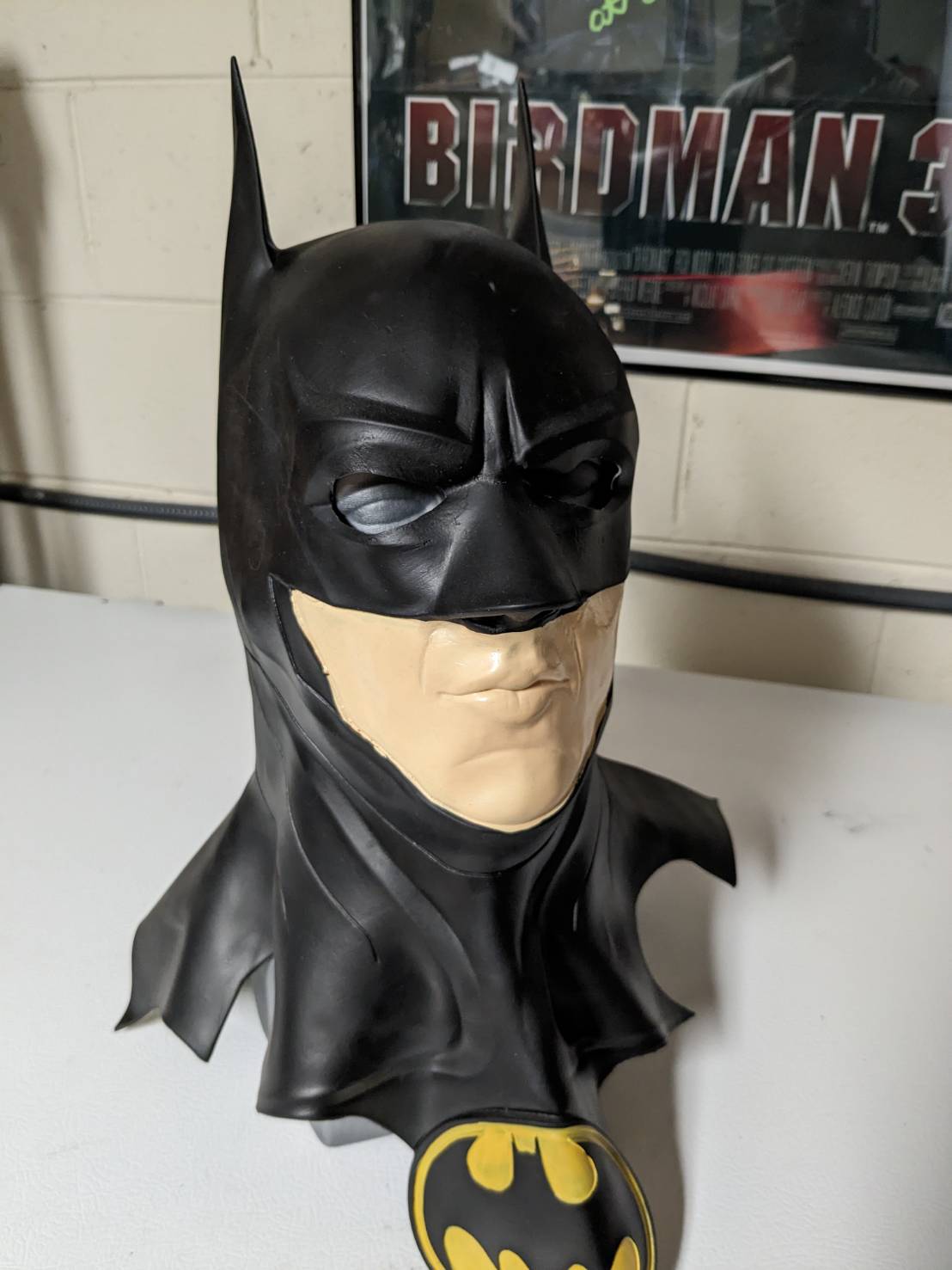

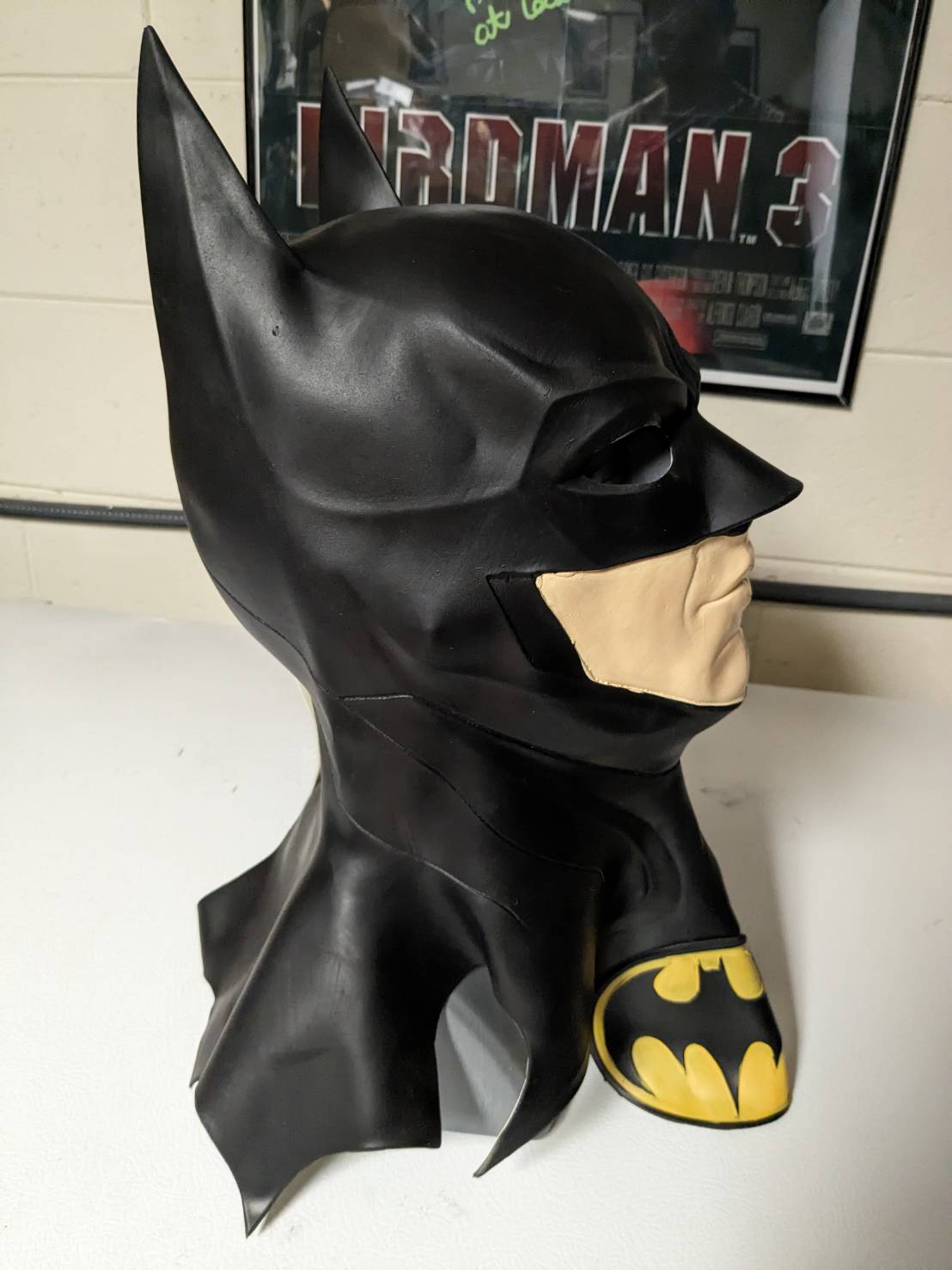

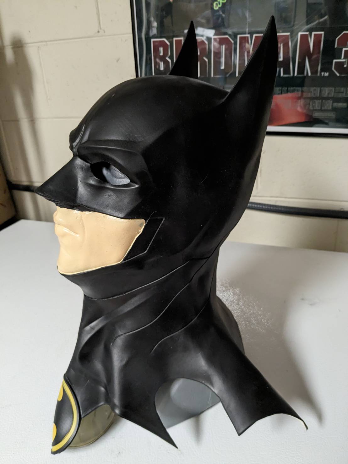

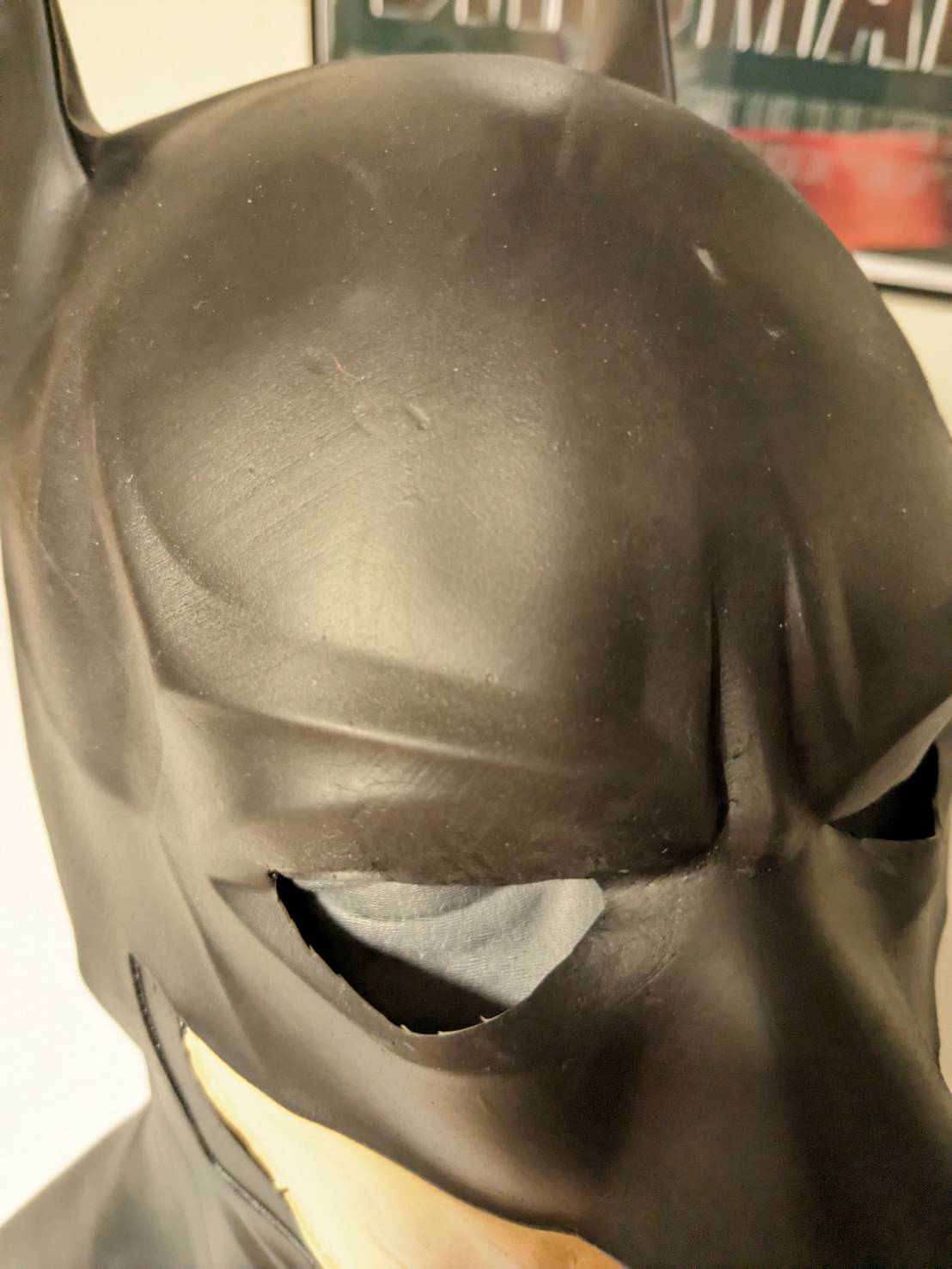

This has been a learning curve. I did mostly a slush-latex but added some gauze halfway thru. It's hard to prevent the latex from pooling because there is no support structure. Overall it came out not too bad, tho the head it a little lumpy and trying to not get the inside of the ears stuck was a challange. However, it did fix the drooping upper eye!
Plastidipping now, the can is not shooting correctly and leaving drips everywhere

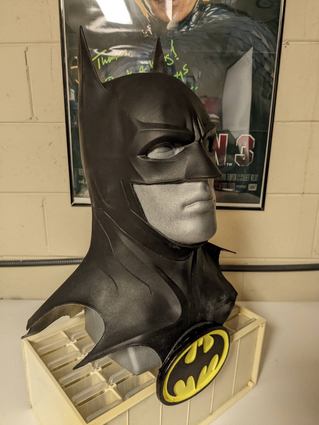

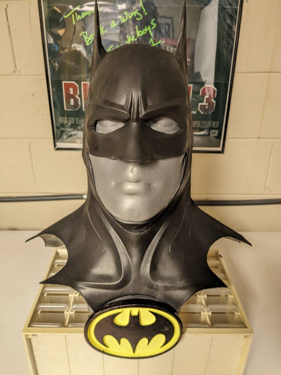

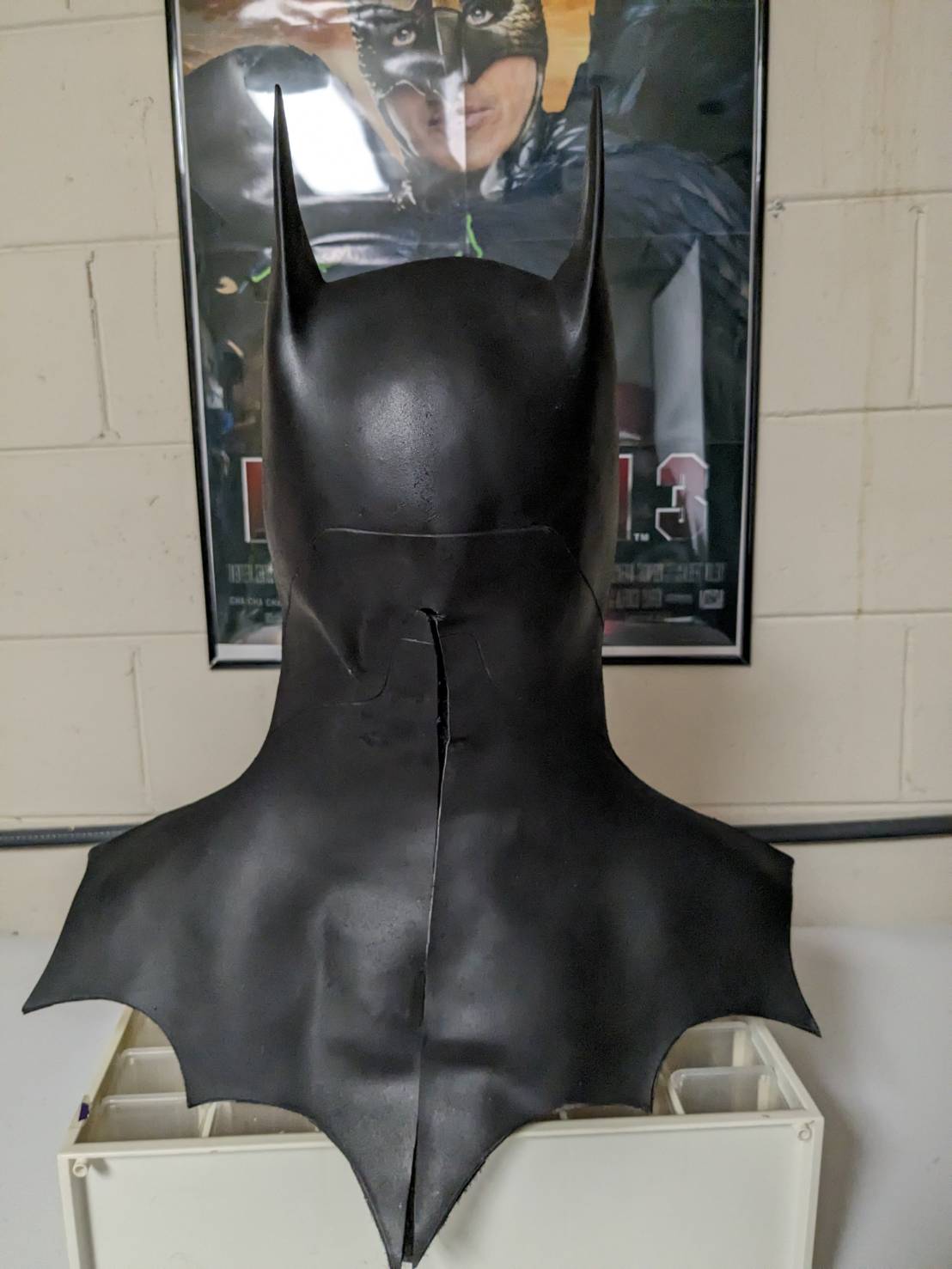

Edit: I think I'm done with this one (re-working The Batman cowl also). It's about 80% where I'd want it to be. Not as tick as I'd like but given the limitations (and my first time working with latex) it came out ok. It kind of feels like a Rubie cowl now, but thats ok lol

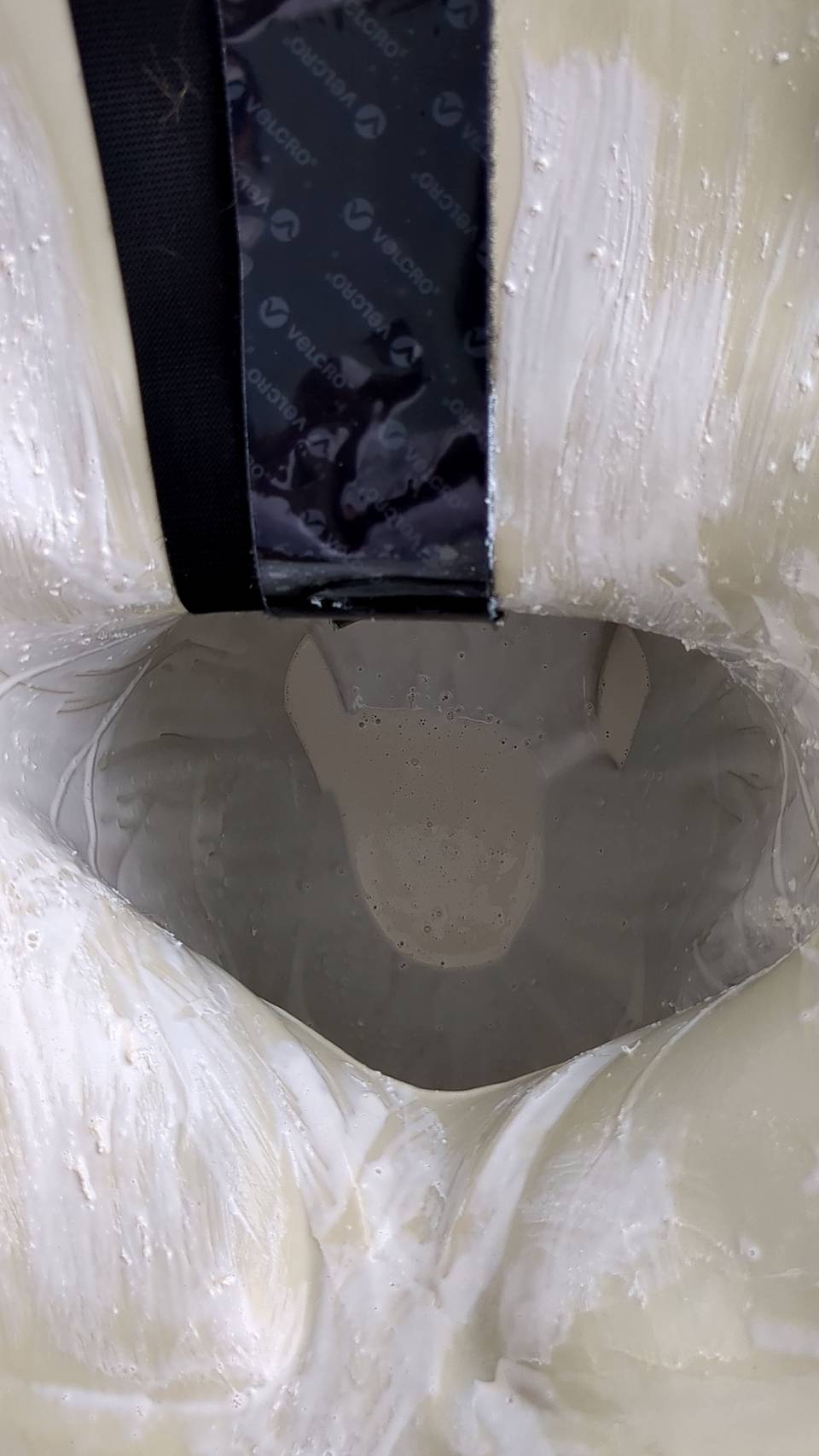

Also added some Velcro since it's easier to put on and off.

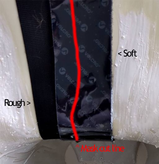

Hey how did you attach the Velcro please?
Just some cheap super glue. I attached the abrasive side as one normally would (with the adhesive (with some super glue) side on the cowl right along the seam (so it wont show) and then I did the opposite for the soft side. I covered about hald of the soft side with super glue and then attached it so the other have is overlapped over the mask (you'll see it when it's un velcroed.
