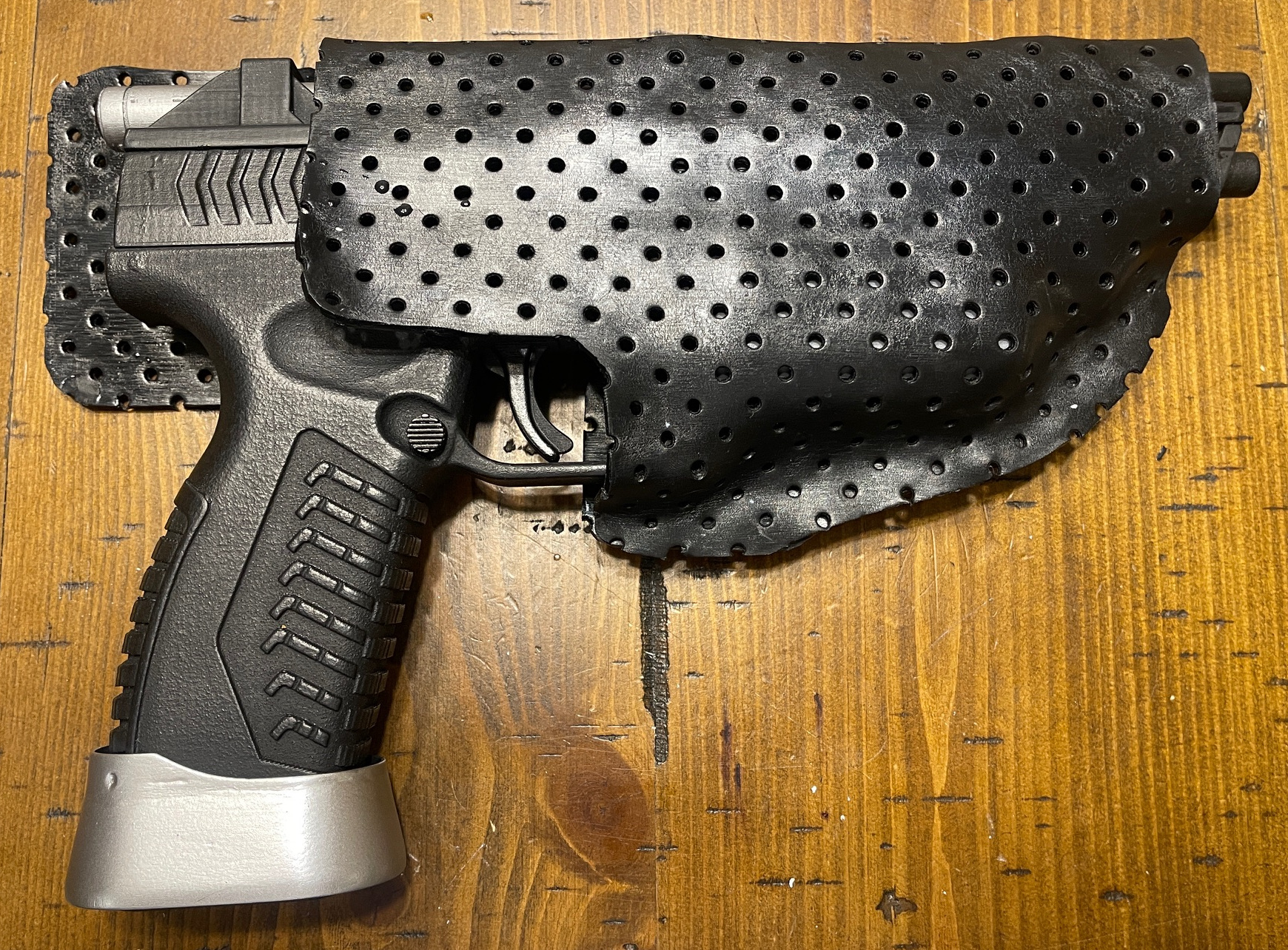

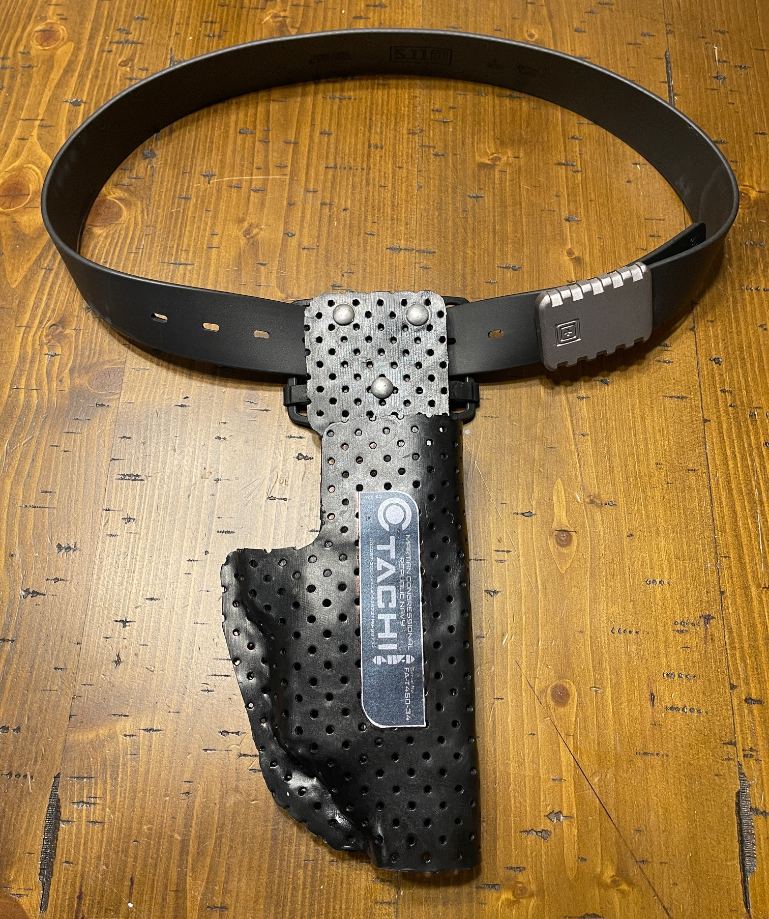

Initial pattern creation and first molding attempt I'd call a success! Two items of note. First, I have a lot of work to do yet to form, mold, etc. - this was just my first go with the material. Second, the setup doesn't look identical to the PropStore holsters as I've opted to create mine to accomodate the gray accessory on the front rail, where the PropStore ones are without that accessory. I'll keep at it and post updates, but overall the material was straight-forward to use and the effect is spot on.

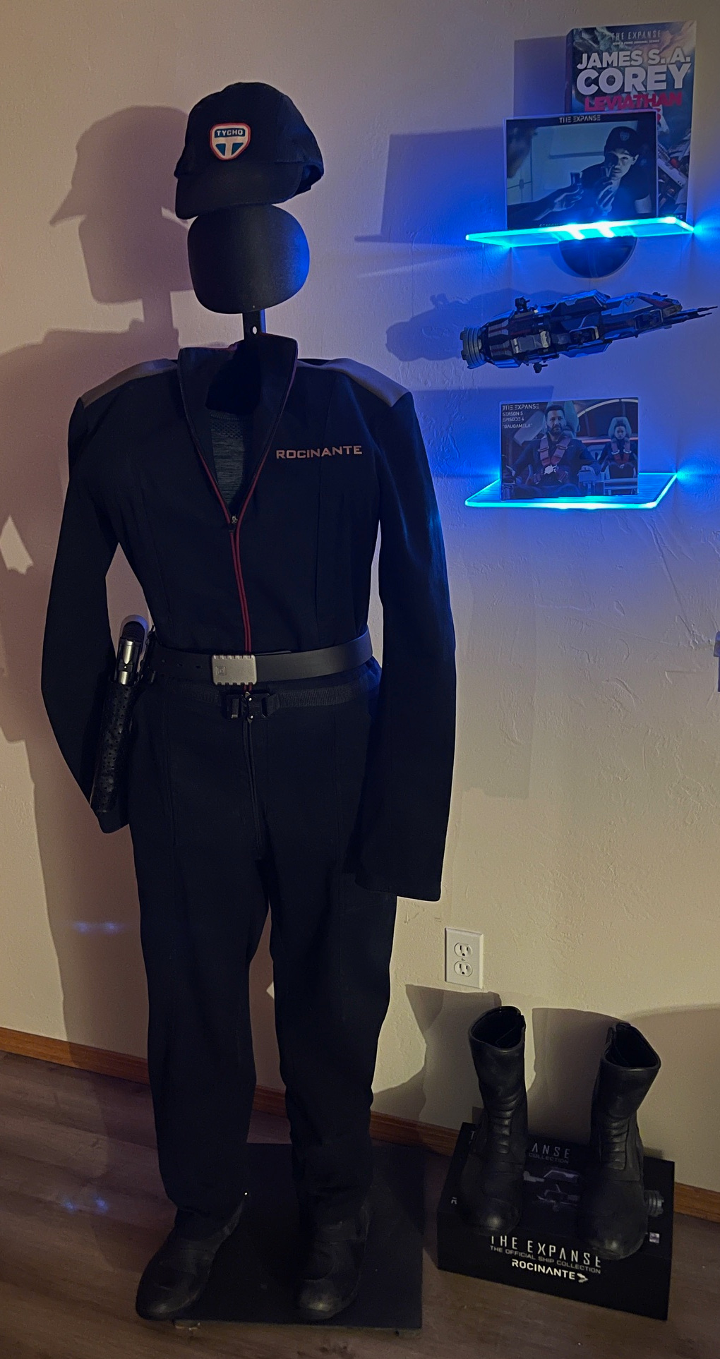

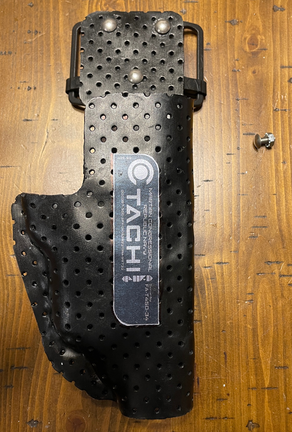

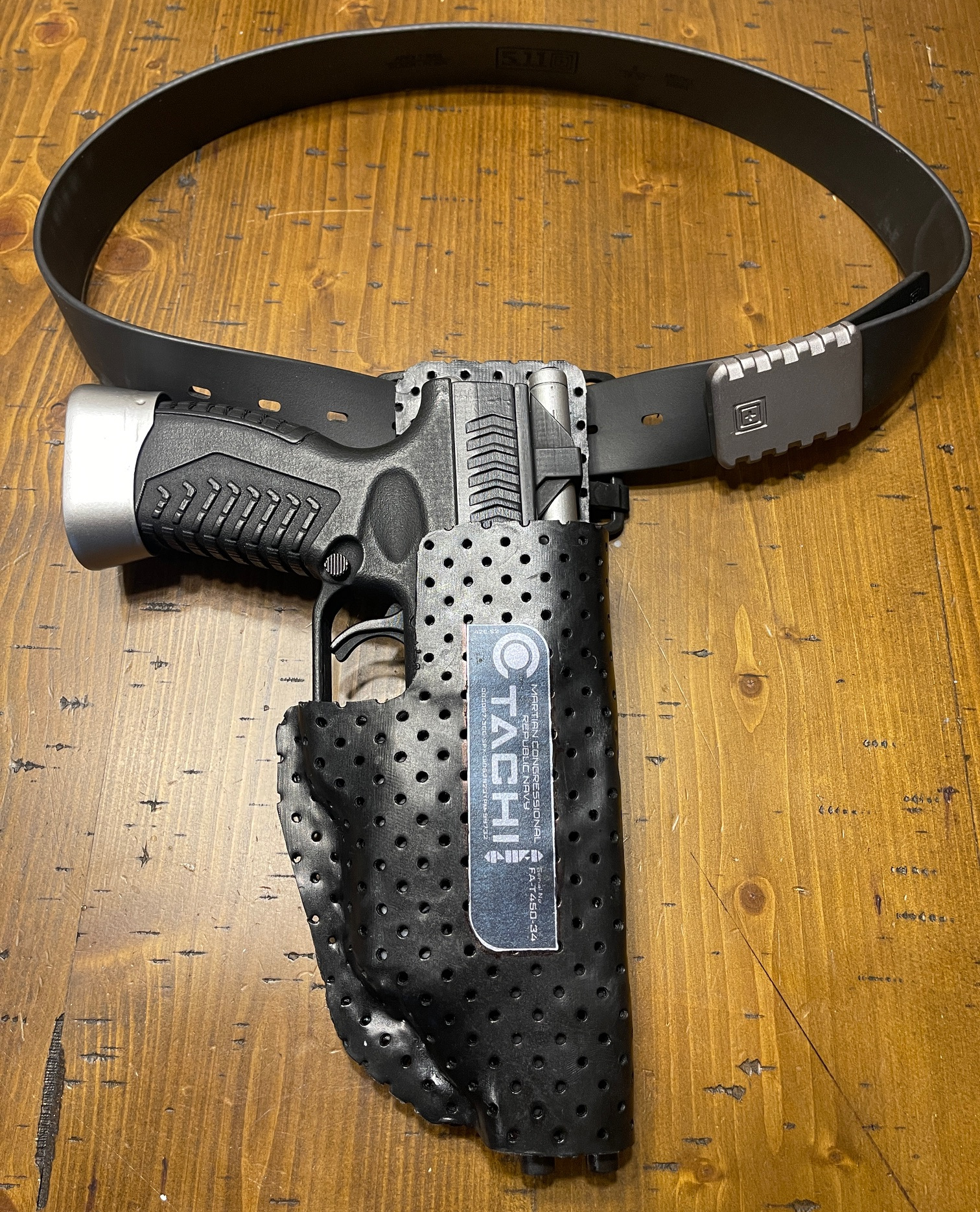

Keeping its shape enough that I was able to finish! Images attached, including 'as installed' in my display along with the Roci flight suit I won from PropStore and other show used items from Ebay. So, many items to document here for others:
1. The Aquaplast material is fairly easy to work with. I actually reheated it (hot water bath) three different times to make it just as wanted and each time was able to lay flat, re-form, etc. I made a few teaks with a heat gun.
2. The Aquaplast basically cools hard within 15 minutes after forming so you need to work pretty fast. That said, it continues to cool and shrink, just a little, over the next 12 hours. So, leave whatever form you're using in the material for that long. Fortunately I had a prior, but not great, build of the same 3D pistol print as my second build. I wrapped that first build in gaff tape to have the holster form just a little larger to allow for easy pull from the hoster and reinserting.
3. It was interestingly difficult to find the three bolts to attach the holster to the belt clip. Carriage bolts were my first thought, but those have a square shoulder under the curved top. Everything else I found had either a standard, Phillips or hex top. In the end I purchased bolts that had a Phillips top, filled the top with solder, sanded and then painted. Not perfect, but plenty close for me.

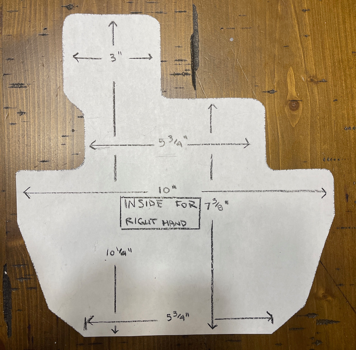

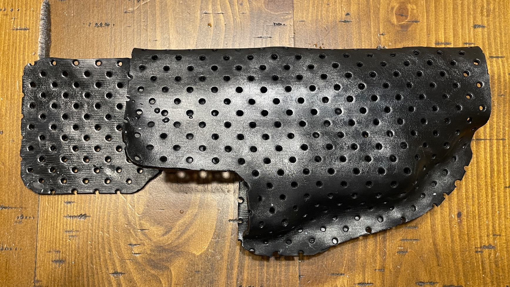

4. Image of the template I used, with some basic dimensions attached here as well. Note, as in my prior post, I wanted a holster to accommodate the gray accessory (my pistol fits with or without the accessory of course). If you don't care about that and want something closer to the show, you'll need to modify the template. Also, I don't know how closely the 3D print I purchased is to the actual XD prop pistol. So, as always, your mileage may vary.
5. Speaking of show reference, I was able to track down the Holden holster on PropStore and it's different than the others. First, it has the Tachi label in the center, which is how I went. Was just easier. Second, the Holden holster used the 5.11 Apex Gunners belt where others use the T-Rail belt. So, looks like either belt, as used by the Roci crew, is canon.

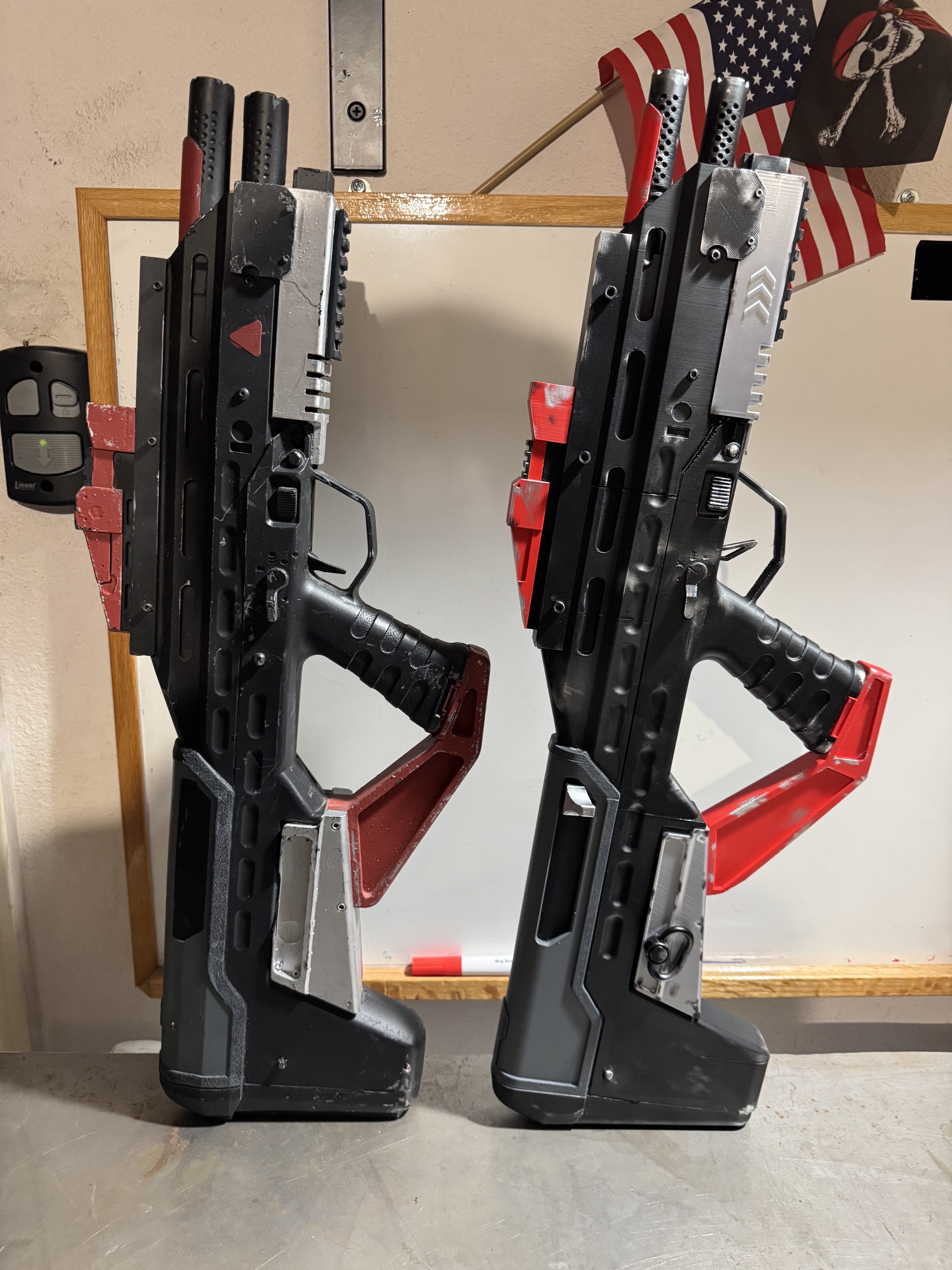

Since I apparently didn't post these before, here are a couple of photos of the MCRN rifles. The one on the top & right is my 3D print. The one on the bottom and left is a cast prop from the show that was in the armory of the Roci throughout the series.
The 3D print was printed mostly with CosPLA with 100% infill for weight and strength. The red and the two large silver pieces were printed in color and I decided to just use those rather than paint them, mostly because they stand out more.
The two rifles are very similar but as with most 3D print replicas there are dimensional and other differences. For example on the rear cheekpiece, the border on the prop is textured. The 3D print is smooth so I faked the texture by masking it and dabbing with a darker paint on a sponge. But overall it's a very good replica.
The 3D print does have some details that are missing from the cast version, notably the cocking knob and the rear sling swivel, which I added and is an actual metal swivel.
Glue was challenging to make all the pieces fairly sturdy. I used IPS Weld-On 16 which seems to have worked pretty well, although the stuff doesn't like to stick to a painted surface. That caused me to have to re-glue several pieces although they seem solid now that I've provided a clean surface... Cyanoacrylate/superglue probably would have worked as well.
The 3D print actually feels better in my hands (and a bit lighter, but still of a good weight) than the cast version. The weathering isn't great but it was my first attempt at weathering something this large. :)

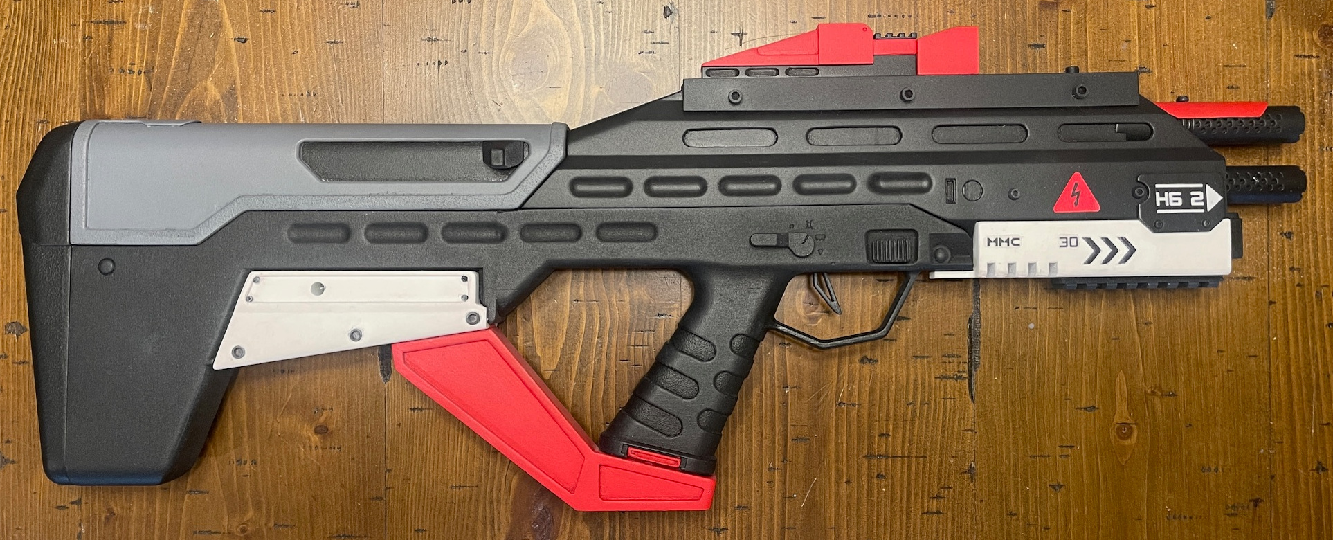

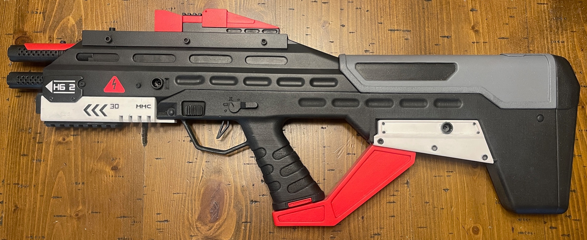

Hello everyone - it's been a few moments and I've finally finished my MCRN rife build, getting ready for DragonCon next month. As expected, took quite a bit longer than the pistol build and, while not perfect, turned out pretty well. The one thing I changed from the show was putting the quick release mounts for the sling (I ended up going with metal ones that I epoxyed in) on the 'left' side as that made more sense to me. I also put a second quick release on the front so I could use the sling from two points.
That turned out great! Having made my own, I'm curious about some little details.
I think you sling decisions make perfect sense to me. I epoxied a real metal QD sling into place in the original location/side mainly for looks, with no matching one at the front. I don't know if we ever see a sling ever get used in the show. I guess I'll have to watch for it the next time I watch again. :)
The texture on the grey portion border at the upper rear... Did your file have that, or did you add it, or did you do like I did and fake it with paint?
Lastly, I really should add the decals to mine...
Again, really nice work!
