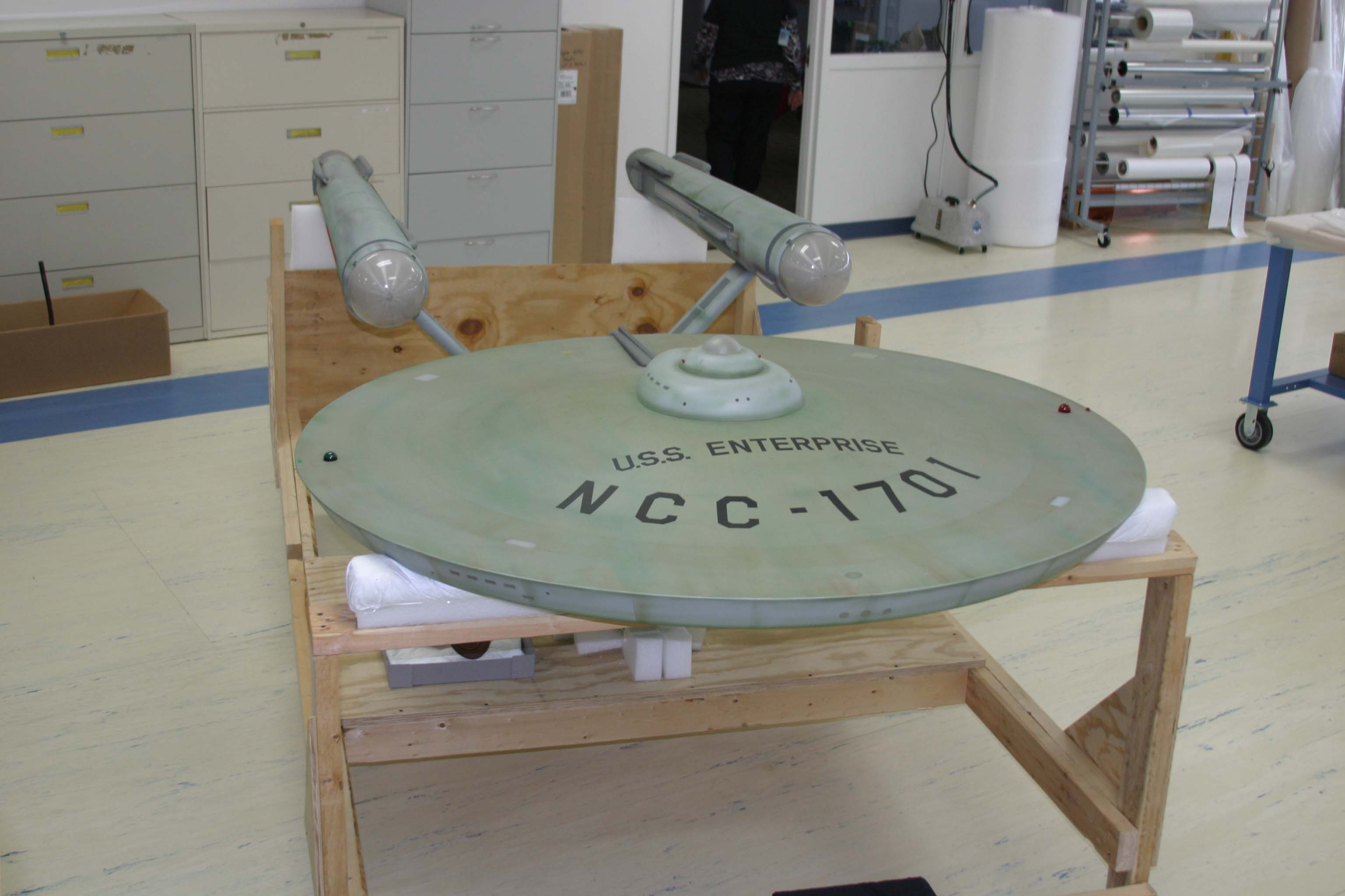

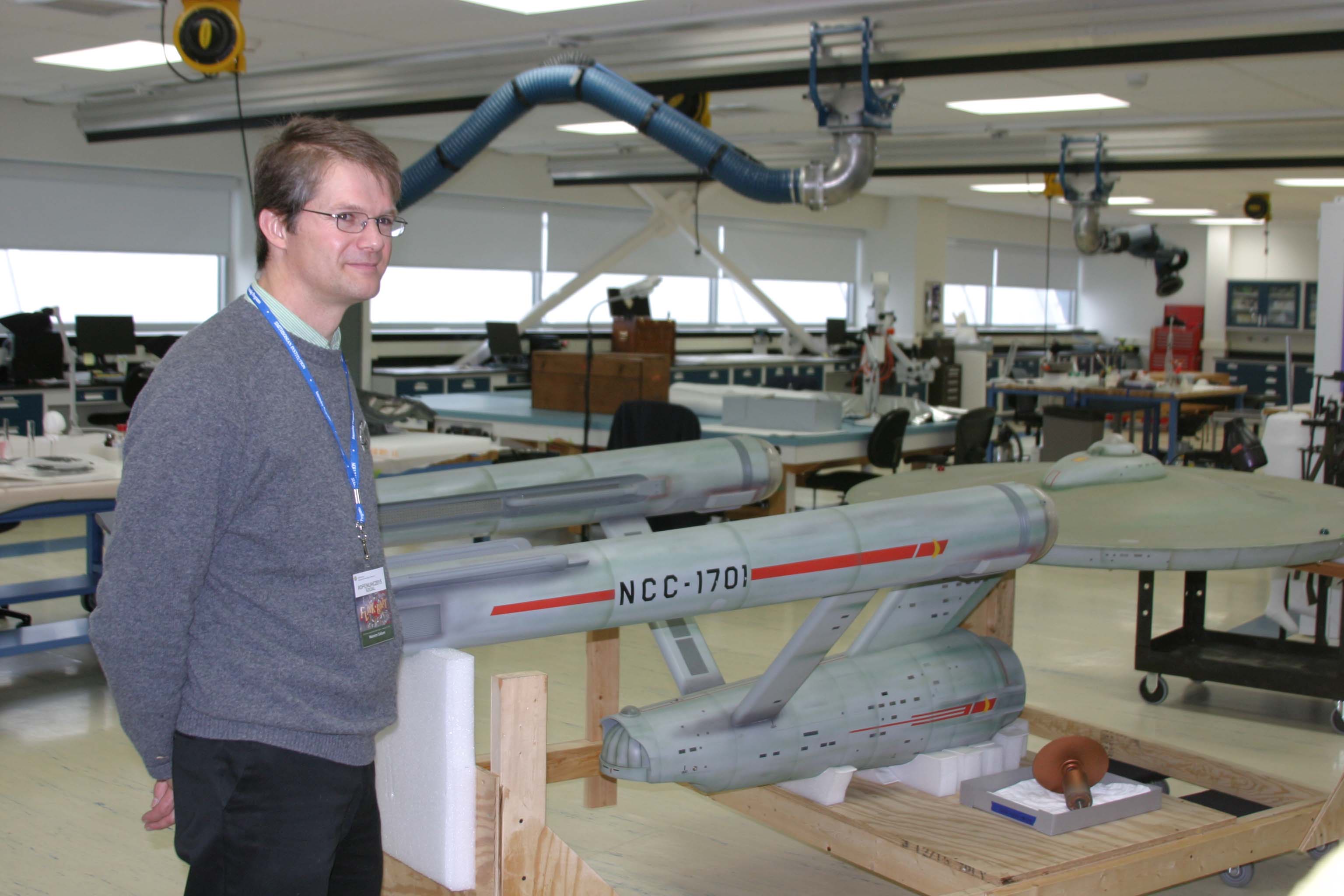

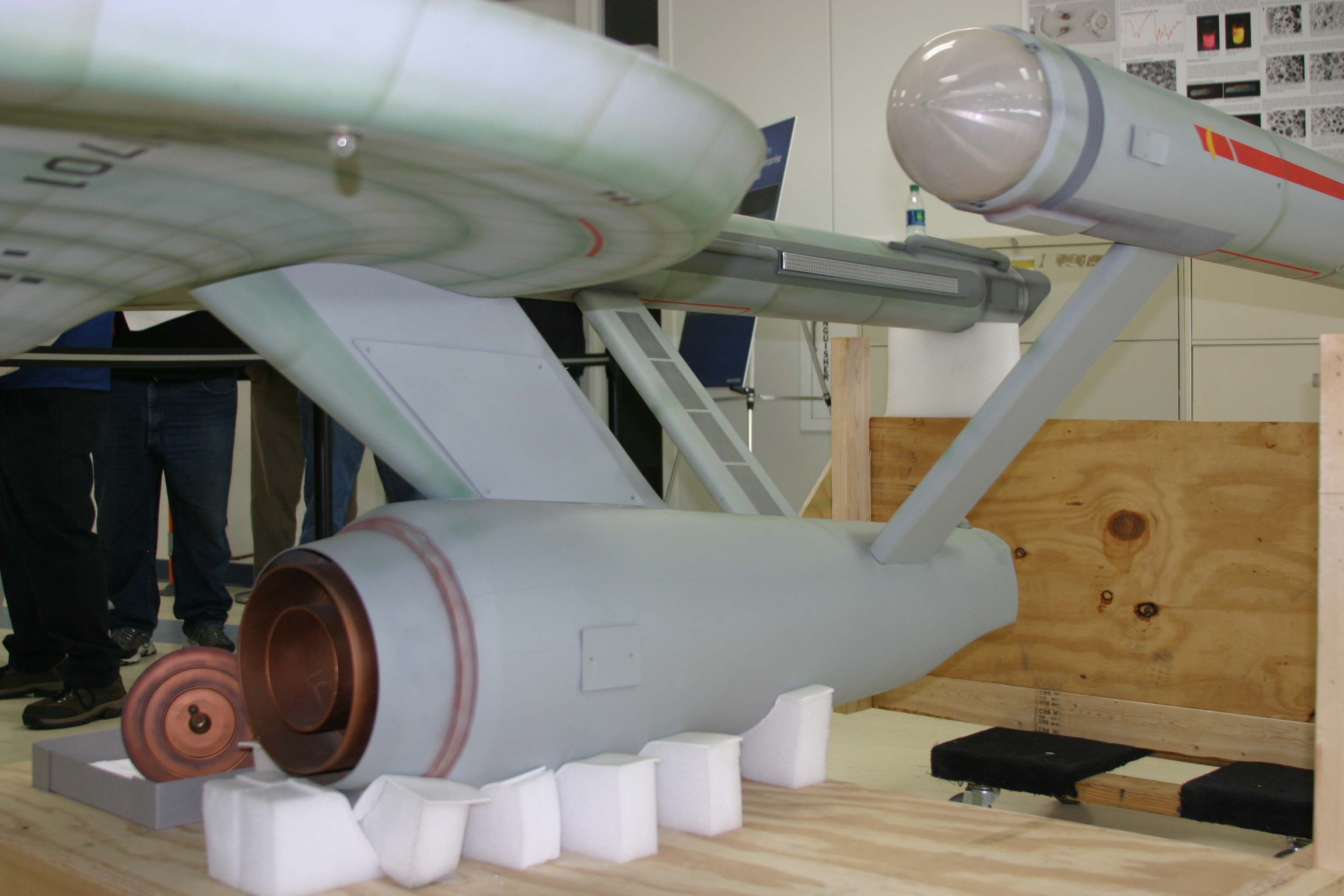

I've posted the links to all my photos over at the Stuck Page:
But here are some favorites:
