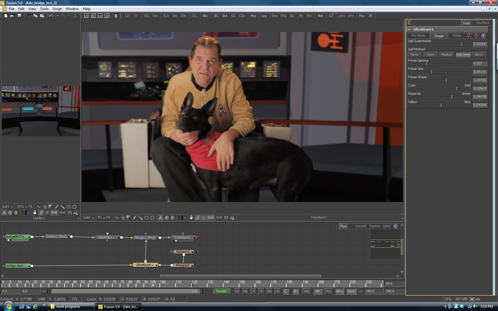

I've been at Digital fusion, Premiere and Lightwave coming up with a sure fire system for matting into the bridge so I can proceed ahead with the many shots and angles.
It takes matching the camera angle and lighting of the practical shoot to the CGI set in Lightwave. I used the CGI chair to get my distance and angle the same, match lighting. Then I would remove the CGI chair. run off a single frame and place that into Digital and pull a comp. I'd keep doing this until I was happy then had Lightwave run off the background animation.
The clip test is 8 seconds long and I hope to post it tonight.
Here are a couple of pictures, one a frame test and the other shows the Digital fusion set up which I prefer over AE for comps hands down. UltraKeyer1 rocks!
Steve
Steve
