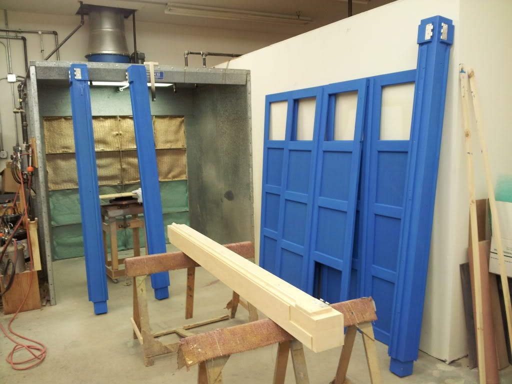

Finished up base coating the posts today and decided to take a break from that and start toning and weathering the back wall.
Here is the wall as I began the initial layer of toning color.
The "toning glaze" is a custom muxture I made using a dark teal, flat black, transparent glaze and water. It is applied in thin, gradual layers using a sea sponge:
I ran out of time today, so only got a chance to do a single pass on the right side, but you get the idea:

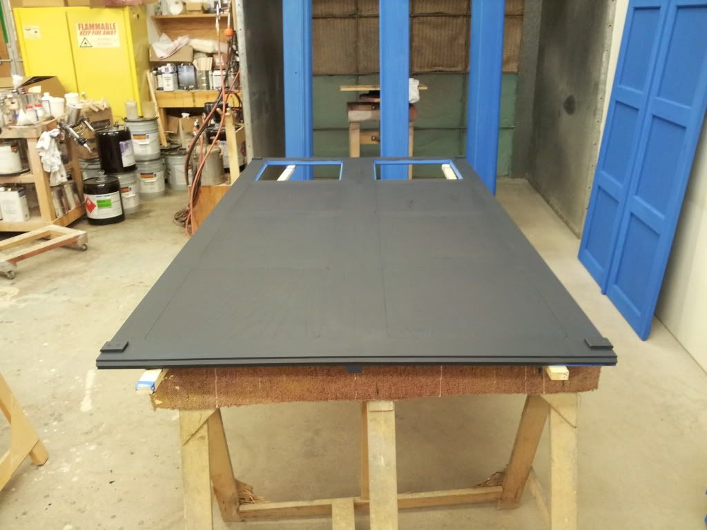

I hit the shop hard tonight, driving the 45 minutes there right after work.
Put in a solid six-hour paint session, so much to get done for our upcoming event, I didn't leave the shop until well after midnight.
Backsides of the three walls and underside of the roof painted flat black:
Before I begin the toning glaze and weathering over the fully dried base color, 320 grit sandpaper is gently stroked over all surfaces to remove the rough texture the wood produces after the initial coating. This helps keep the surface smooth for topcoating later.
People who see this in person will no doubt want to touch it, so a professional finish is key:
All the walls finished and ready for topcoat. The access panel is finished, just not hinged to the wall yet:
The roof. Built tough and to precision standards:
The fruits of my labor so far. I'm exhausted. Glad I have a supply of Jammie Dodgers to come home to (thank you Brian):
I should have all four posts finished next, then I can begin base coating the doors and sign boxes.
