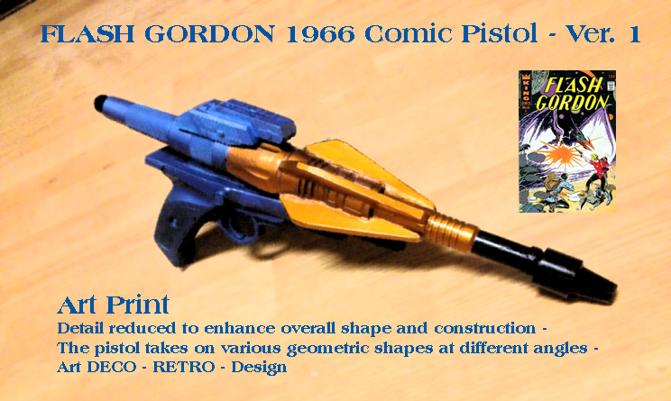

I have a box of items I collect for model making. Some parts or shapes are scratch built. In this case I made silicon castings of various parts, pieces, and the Hamilton Invaders pistol and made a basic collection of resin parts and shapes I wanted to fashion into a unique gun. I had a basic design in mind - The Flash Gordon Comic Book drawing of his pistol. Then I took my collection of parts and custom modified the Hamilton Pistol into the final version you see. I am also using the molds I made for the resin parts to customize several other entirely different designs on the same basic RETRO Art Deco cannon. If you are interested in making your own props - all the information you need is here on the forum. Some members helped me with specific questions and there was a lot of trial and error. With each project I learned something new. After FOUR YEARS on the RPF - I finally get to build my own project. You can use any combination of techniques to fit your budget and modeling skill level to produce your own creations or replicas. Source chemicals and materials can be purchased on line from the SMOOTH-ON web site. You can watch HOW-TO Videos on prop building and casting on YOUTUBE. You can look at other members BUILD THREADS on the RPF. YOU CAN DO IT ! Watch the videos - follow the directions - you do not need a whole workshop (but it helps) . You can do almost anything on a small scale at your kitchen table. Start with something simple. Set a goal, and don't be afraid to try something new. Baby steps. I have been working on the skills for this for four years. I made the RHINO model in 2004 (with an early version of RHINO - Now I have the 2012 RHINO release.) I am only now finally getting to do my FLASH GORDON concept. I have been making props since I was a kid. It is never too late to start. If you ever went to kindergarten and played with crayons, scissors, and a glue stick - you SIR - can make a prop. How determined, how detailed, how big, how expensive, is entirely up to you. You can spend $ 20K on a CNC cutter or 3D Printer - or gets a piece of wood, pvc pipe, and an exacto knive - and go to town. It your are determined enough - you can make a lifesize 1:1 scale model of the Eiffel Tower with nothing but Toothpicks and wood glue (I did not say it would be easy.) Just try it.

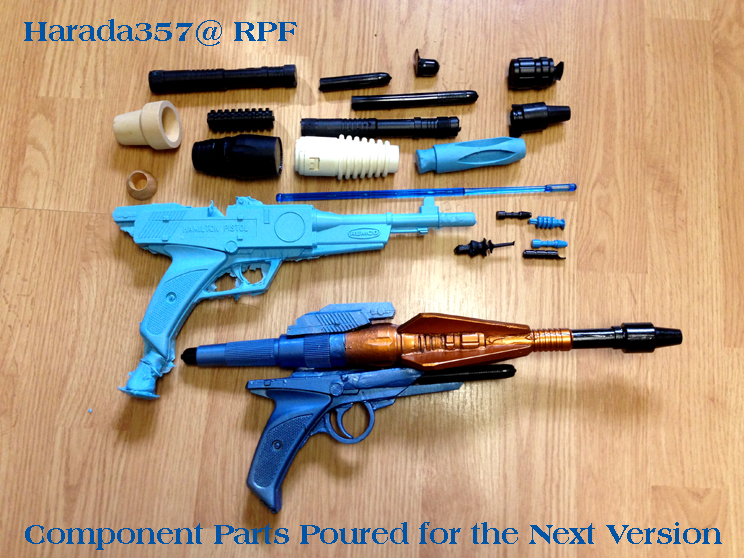

NEW VERSION component parts poured - more to come.
In progress - pouring more parts for a unique reconfiguration of the original component pistol. The final design will be decided during construction. The concept of component parts solved the problem of being limited once a pistol was built and design locked in - the molds would only work for the the original design. A new molding process would be costly and have limited possibilities. I guess that is what makes LEGOs so popular.
Ooooo- I like where this is heading , judging by the components own.
