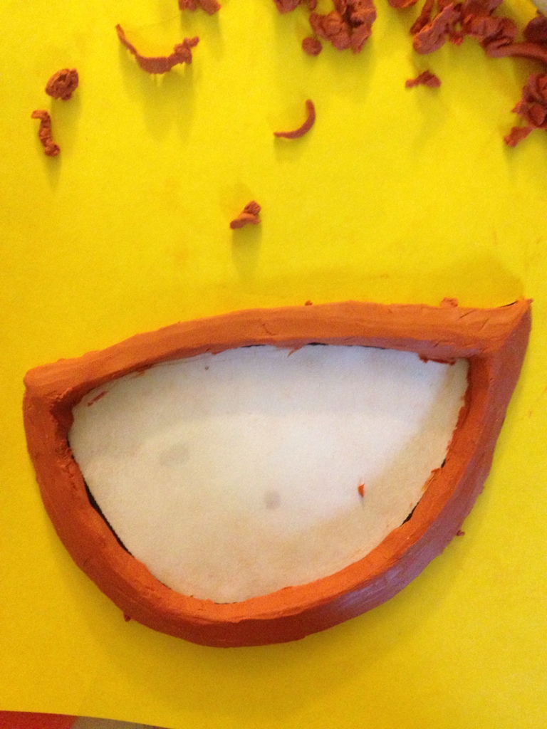

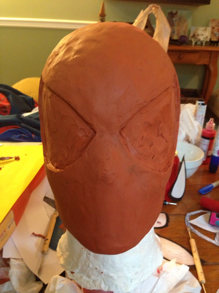

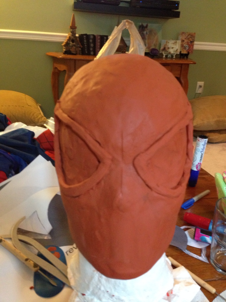

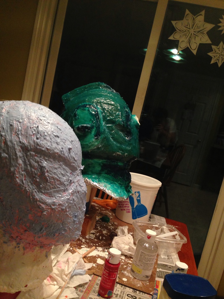

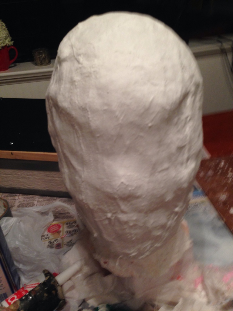

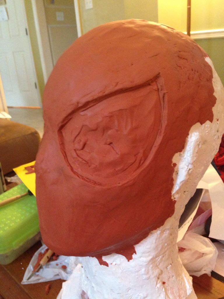

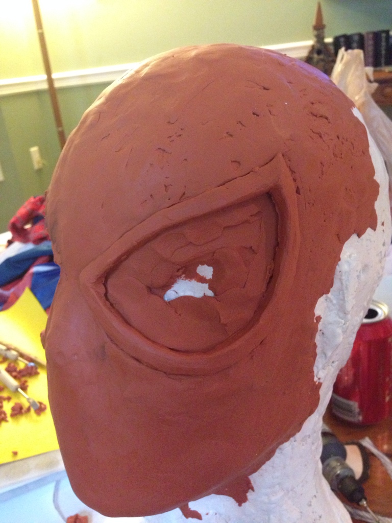

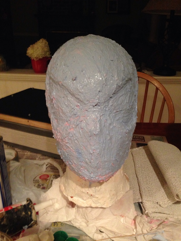

Basically done sculpting the face shell. Now I just have to make a mold and cast itImageUploadedByTapatalk1408821907.854499.jpgImageUploadedByTapatalk1408821930.746274.jpgImageUploadedByTapatalk1408821937.067524.jpgImageUploadedByTapatalk1408821946.899141.jpg[

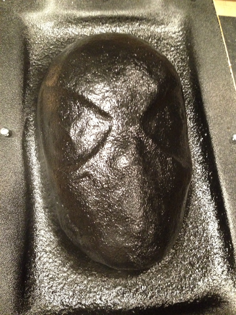

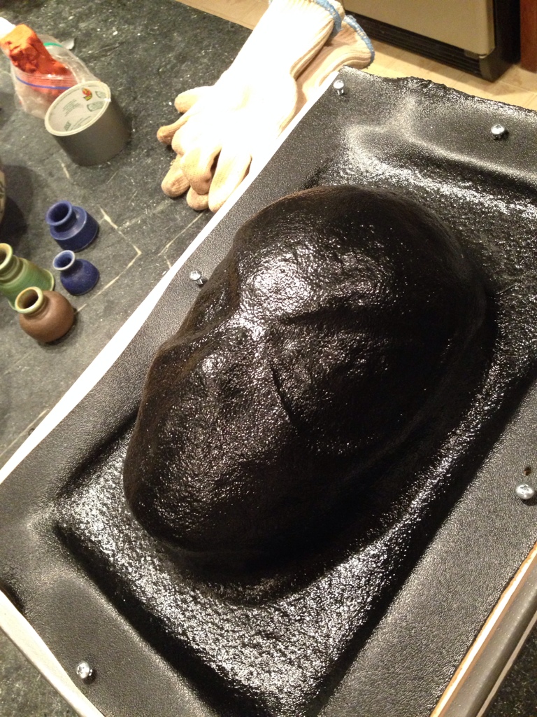

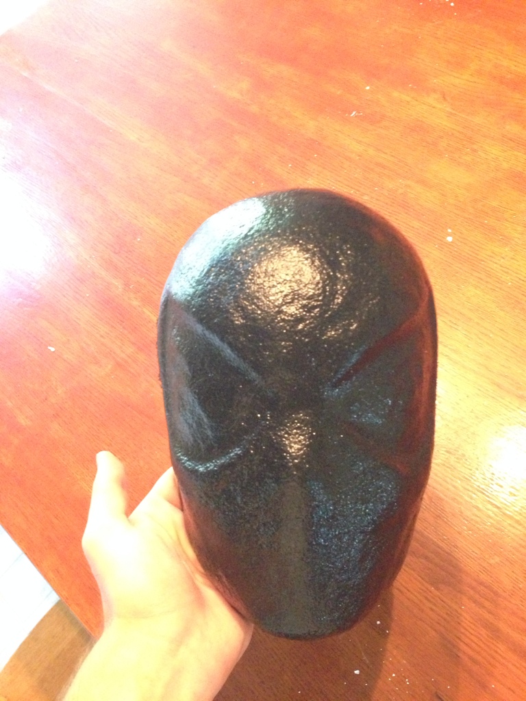

Done casting and moulding, now it's time to vacuum form itImageUploadedByTapatalk1408863112.477833.jpg
Handles and spidey just hanging out, waiting to get plastered.

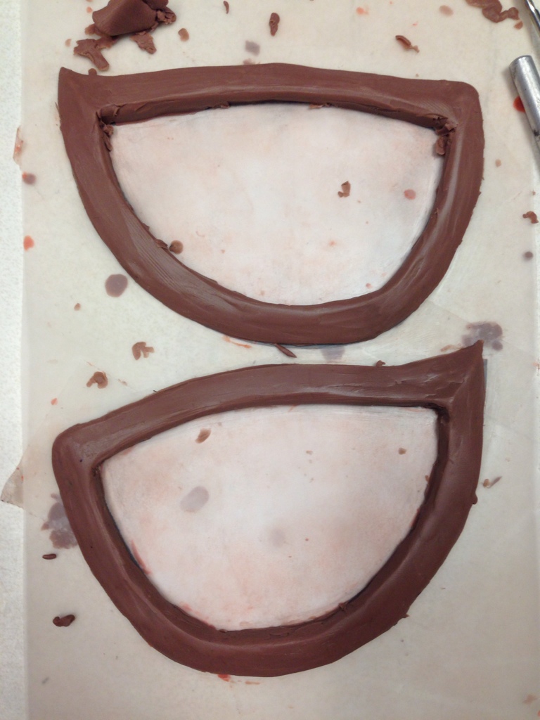

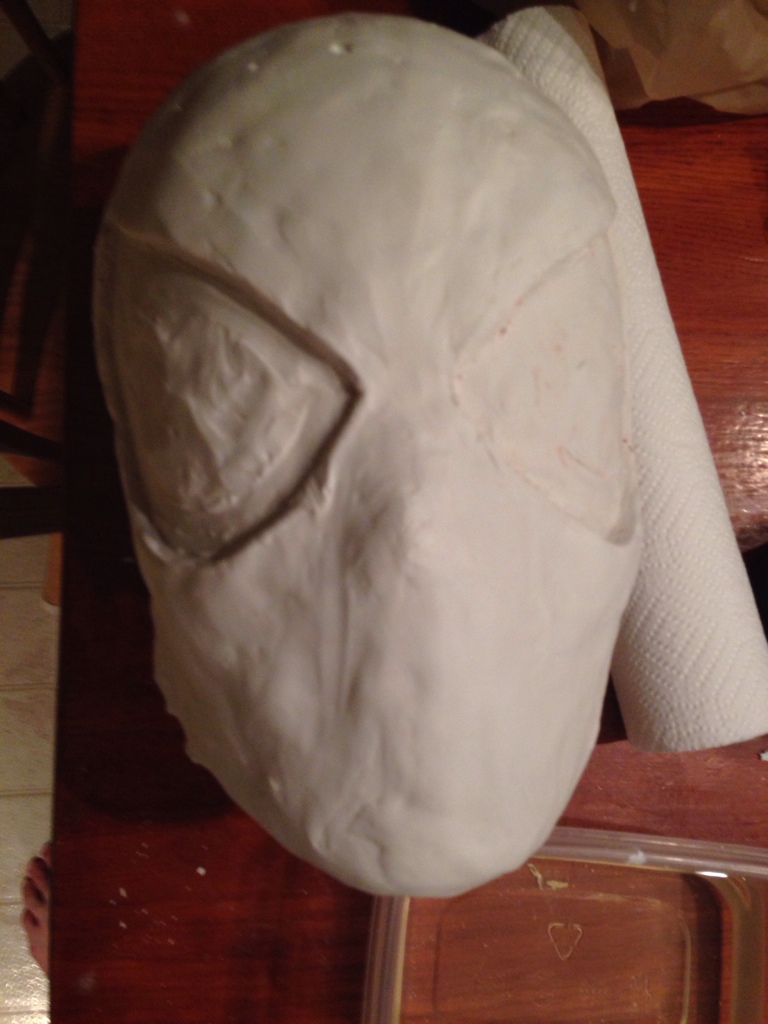

After a long break so that I can get properly situated in a college dorm, I'm back with an update on the lenses. I started re-sculpting them with some new clay (monster clay, which is fantastic stuff) and should be moving on to molding and casting soonImageUploadedByTapatalk1409966415.634339.jpg
You need to smoothen out and round it with water
Your method is rather ingenious sir, but cannot be applied here. This clay is a wax/oil mix, both of which are very water resistant, which never dries. I will be using my hands and an alchohol torch to round and smooth it.
Also, I'm doing a completely different method for making my lenses: first I will mold the lenses in silicone and then cast it in resin.
Thank you for sharing your advice though!
