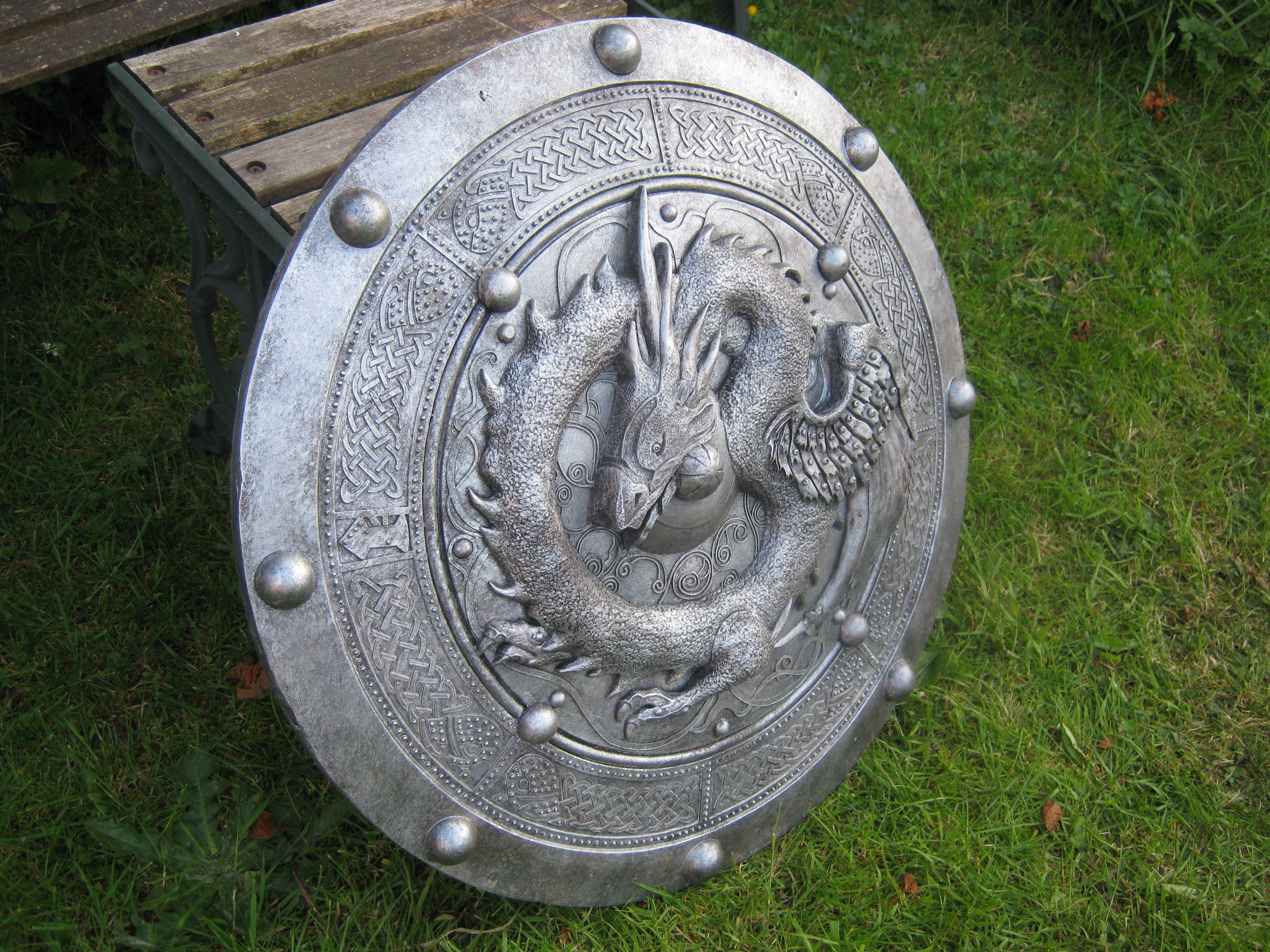

I'm currently studying Modelmaking at the AUB and this was my final project for the second year. I was looking into De-skilling in the prop making industry, and as such made this replica shield entirely by hand. No use of machinery or automation, just hand skills.
Based on the cover art from 'A Dance with Dragons', I created a full scale replica built as if it could be used for the TV show.

First of all I built a purpose made plaster spinner to spin the domed shape of the shield.
This was the outcome, a 27ish inch diameter dome, onto which I cast hemispheres and started on the detailing around the edge.
All the detail was made from 1mm thick sheet wax, which was sticky backed so saved on the gluing.

The finished sculpt with all of the wax detailing. I ran out of primer so just sprayed the dome silver to help seal it before the clay went on, I also added more wax on top as extra detail.

With the master sculpt finished , I moulded it with 'Supersil 25' condensation cure silicone, that I got from MouldLife. Onto this I made a fibreglass jacket to keep it in shape.
The second photo is of the first gel coat layer I put into the mould. I built up 3 of these, then did a layer of resin with chopped strand, and finished it off with 2 layers of matting.

All the fibreglass in the mould, and first shield de-moulded. I pigmented the resin black to save on paint, and if the paint ever wore off, then it's still dark underneath.
All that's left to do is clean it up and paint it.
If you want to try for a decent finish right out of the mould then smooth-ons cast magic powders actually produce good results. They will obviously need some weathering to really look the part, but for a basic all over metal finish they do a good job. And the finish won't wear off because it's bonded to the gelcoat.
I did think of using metal powders for the finish, but it was a rather quick turnaround and didn't have the chance to order any in time. If i do a few more casts however, I'll definitely look into it, thanks.
Awesome job. man! That thing is truly a work of art and your finish on it is incredible, it looks almost like real metal and is very convincingly weathered too.
Really fantastic man. If I had space, I'd be asking how much for a cast. I hope it gets you top marks!
