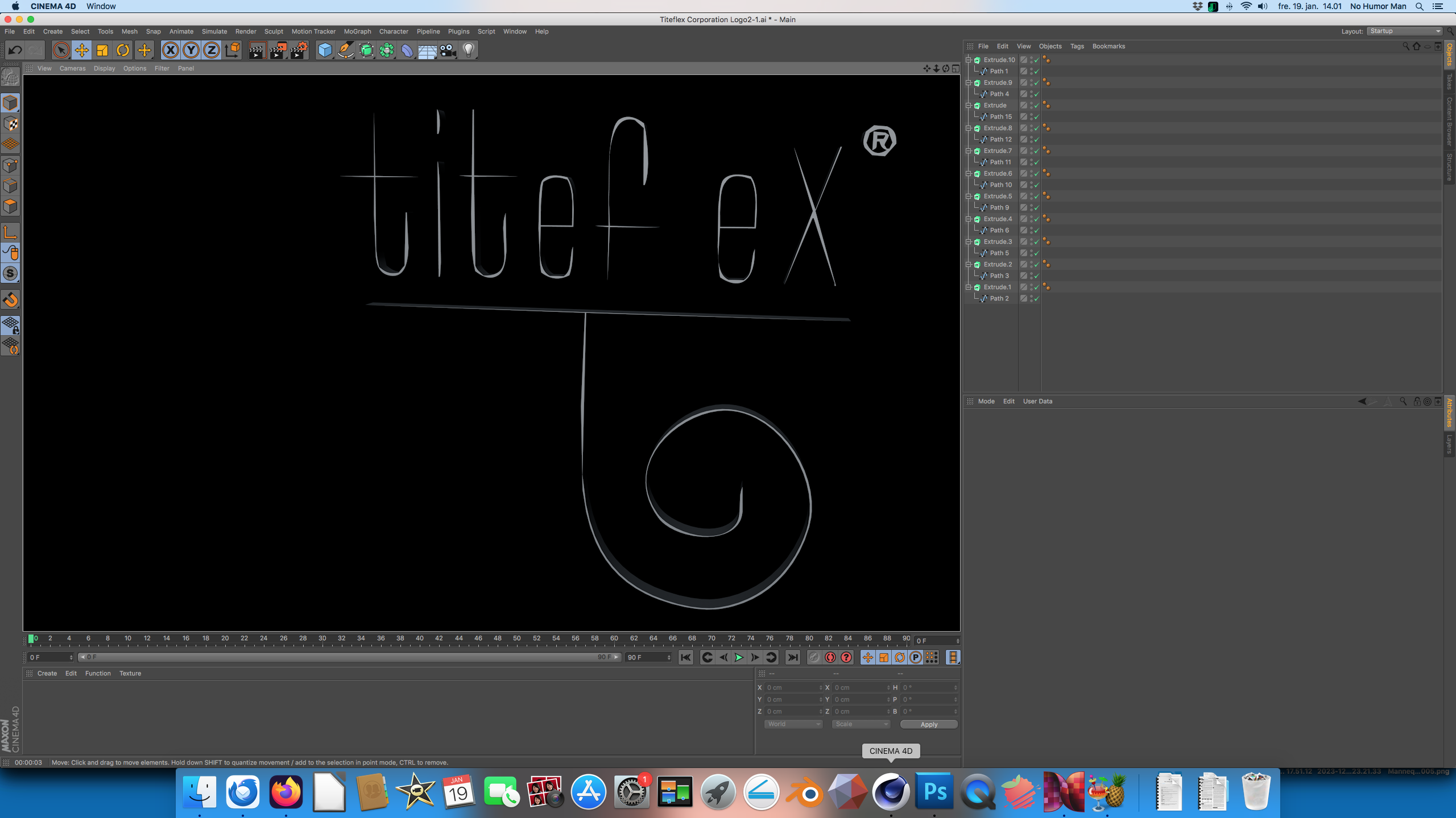

I vector png would probably be better, because I can import that into the software the add thickness to it. Unsure if I can do that with a pdf. Haven't tried, so will have to look that up.
Looks like there was some warping with the resin cast that distorts the logo. I outlined the pdf logo with a technique that draws a line down the center of each character.

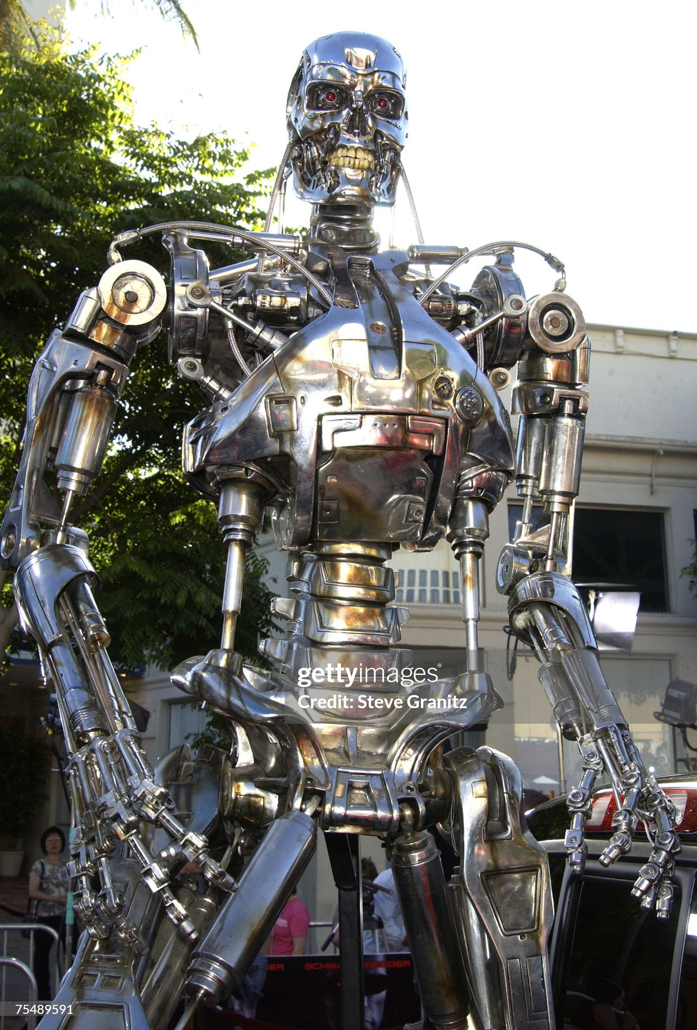

I wonder if that can be used to replicate the rest of the spines missing on most castings, and even help fix what was removed from the castings that do exist?
Possible, but only if there are many photos from different angles. Moreover, the angles should overlap to some extent; otherwise, it won't work.
Well, we have pictures of the spine in different angles - front, back, sides - but not many of them show the whole thing and other things are often in the way, such as either the piston in that area or the chest pieces... or watermarks.
The neck is going to be more tricky because most of it is nearly always obscured.
The rectangular chest piece should be easy, as it's rarely every obscured.
