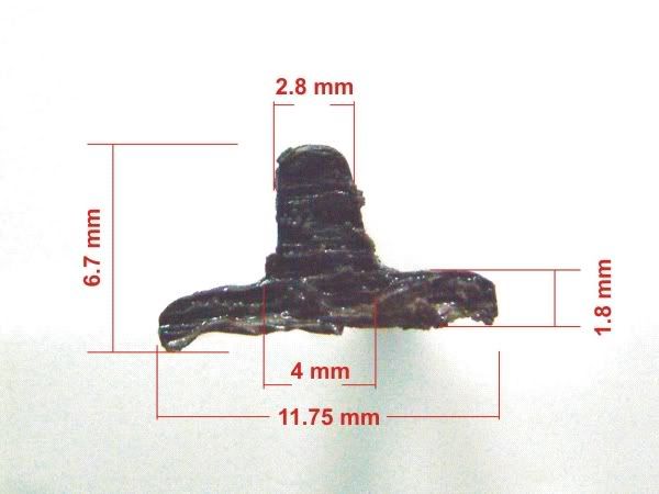

Sorry for the long silence. Been real busy plus wanted to have something solid before posting.
Below is a pic of the profile and mesurement of the t-track I broke off from the cabinet in my house:
As you can see its bottom is very uneven. I thought this could be due to degradation from being there for over 20 years or so, so I decided to find something more recent.

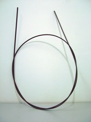

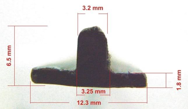

I search every shop that sells anything related to furnishing fixtures in my town and after countless wild goose chase, false leads and similar t-track which are too small, I finally found a company which has a few strips in their inventory which matched the one from the cabinet from my house.

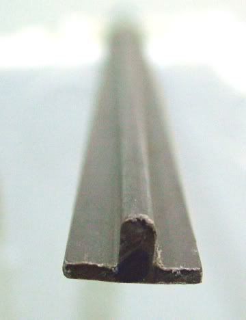

It comes in strips of 8 ft length, is made of rather rigid plastic/rubber, but is pretty flexible nonetheless:
Here are the mesurements for the new track I found:
There only 2 things that don't match: The groove on the bottom, and the color. The one I found is a reddish brown, not black.
Don't know if this track is anywhere near anything screen accurate, but I sure have more then enough grips now for all my custom sabers, if nothing else.

One thing I beleive we need to keep in mind, since it is plastic, and we are finding the track profile in all sorts of conditions, is the wear put on these tracks over the years. Hence the track sample that shows a flat side and a curved side as shown above.
We know some of the T-track was brown plastic painted black.
Except for the curved bottom, the shape and dimensions is the same as the rubber T-tracks that are available from Blast-Tech and others.
Congratulations. It is the most accurate out there yet found.

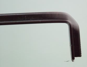

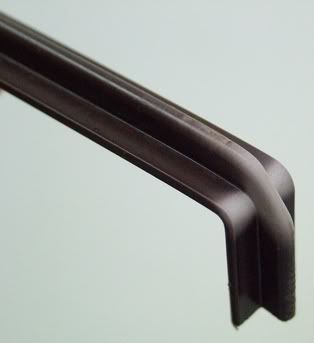

Posted this over at the Junkyard thread but thought I'd post it here as well.
The track bends real easy, but won't snap. The bent part do get discoloured and the ridge slightly distorted.
However it WILL snap if you bend it back and forth couple of times.

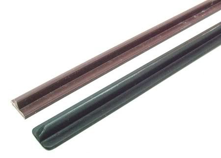

Sanded & painted a t-track to see how it takes paint. I paid special attention to the top of the ridge area when sanding as this is the place that will get most knocked about or scuffed up after the tracks have been installed onto a saber or blaster.
I used flat back and put it under the sun for 15 minutes to allowed it to dry completele.
Here's the painted one next to an unpainted one. I rounded off the edges to make it look more screen accurate.

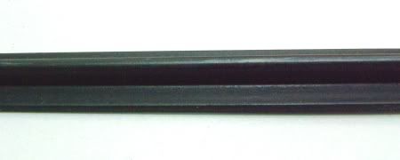

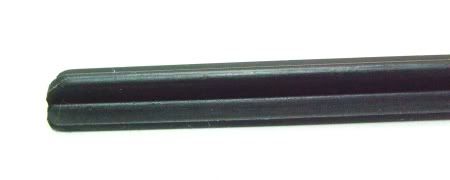

After that I carried it around with me and used it like a drum stick to knock on everything I come across. I even scraped the top of the ridge across the edge of a table.
Here're the scuff marks on the top of the ridge:
Looks like it takes paint very well.
<div class='quotetop'>(Darth Lars @ May 21 2006, 06:20 PM) [snapback]1247853[/snapback]</div>
Good to hear. :) But did you use water-based, acetone-based or enamel paint?[/b]
I have no idea. The can said it contains Xylene & Methyl Benzene. Is that Acetone?
