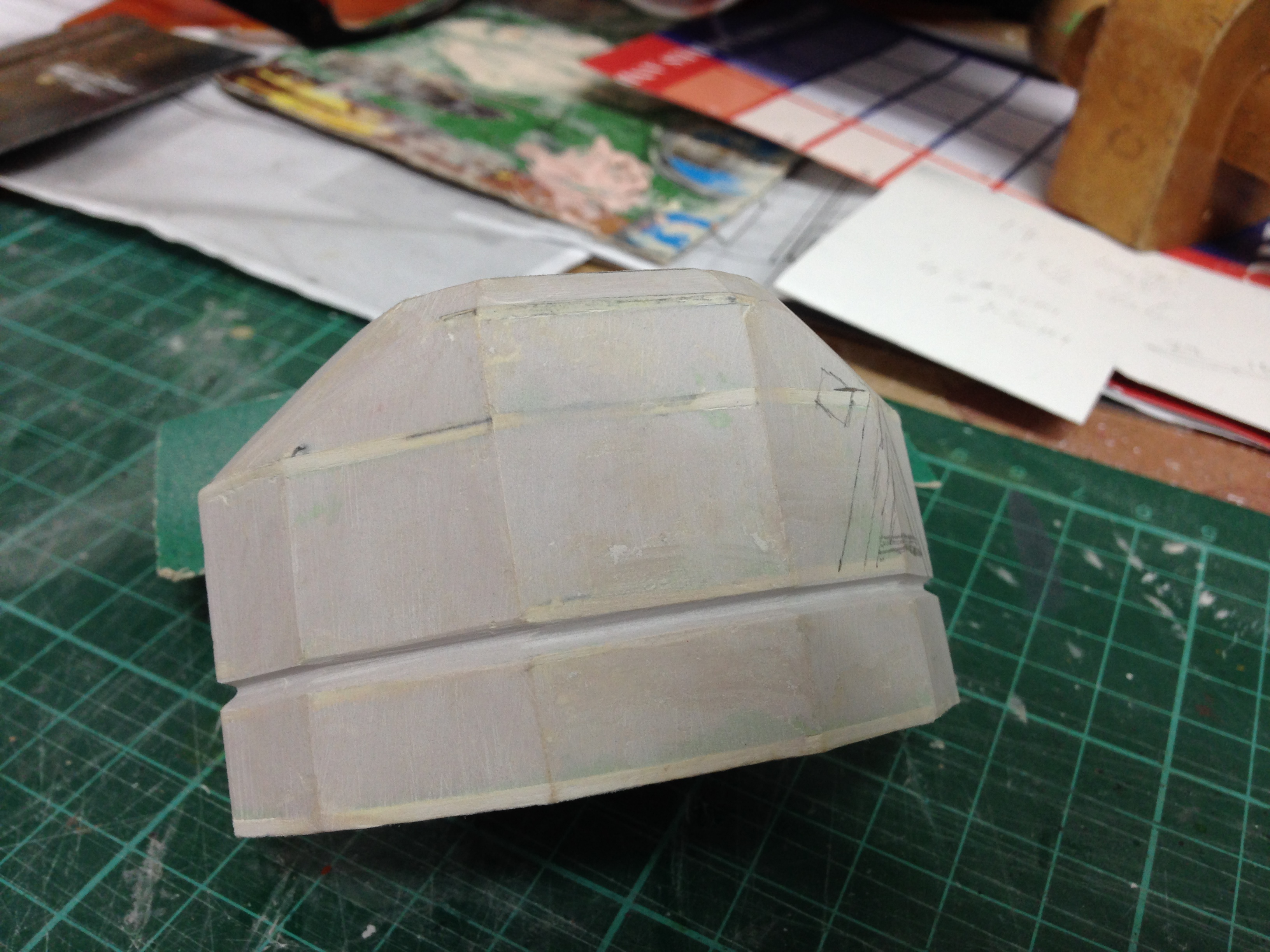

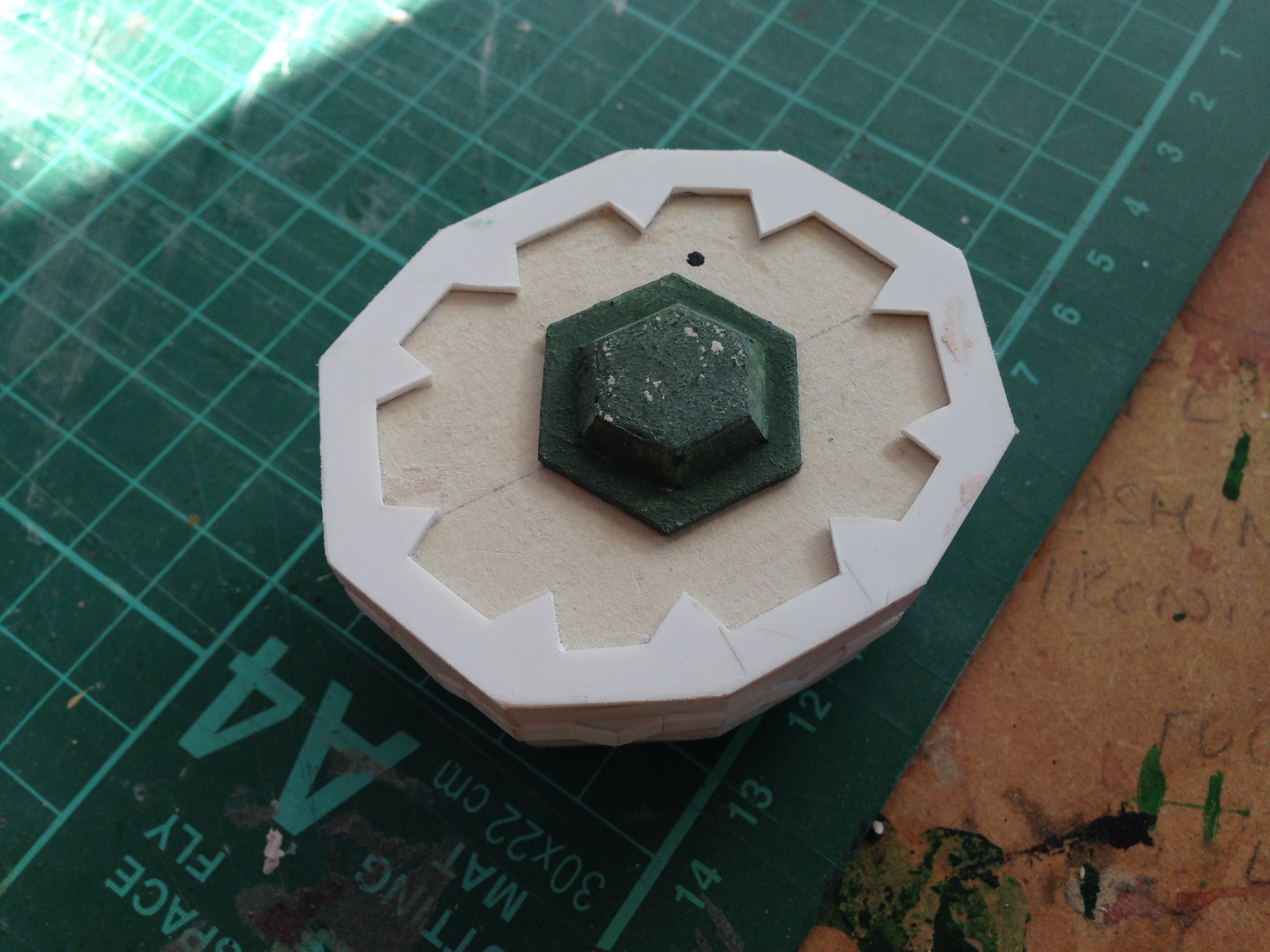

The plan and some of the card stock cut out.

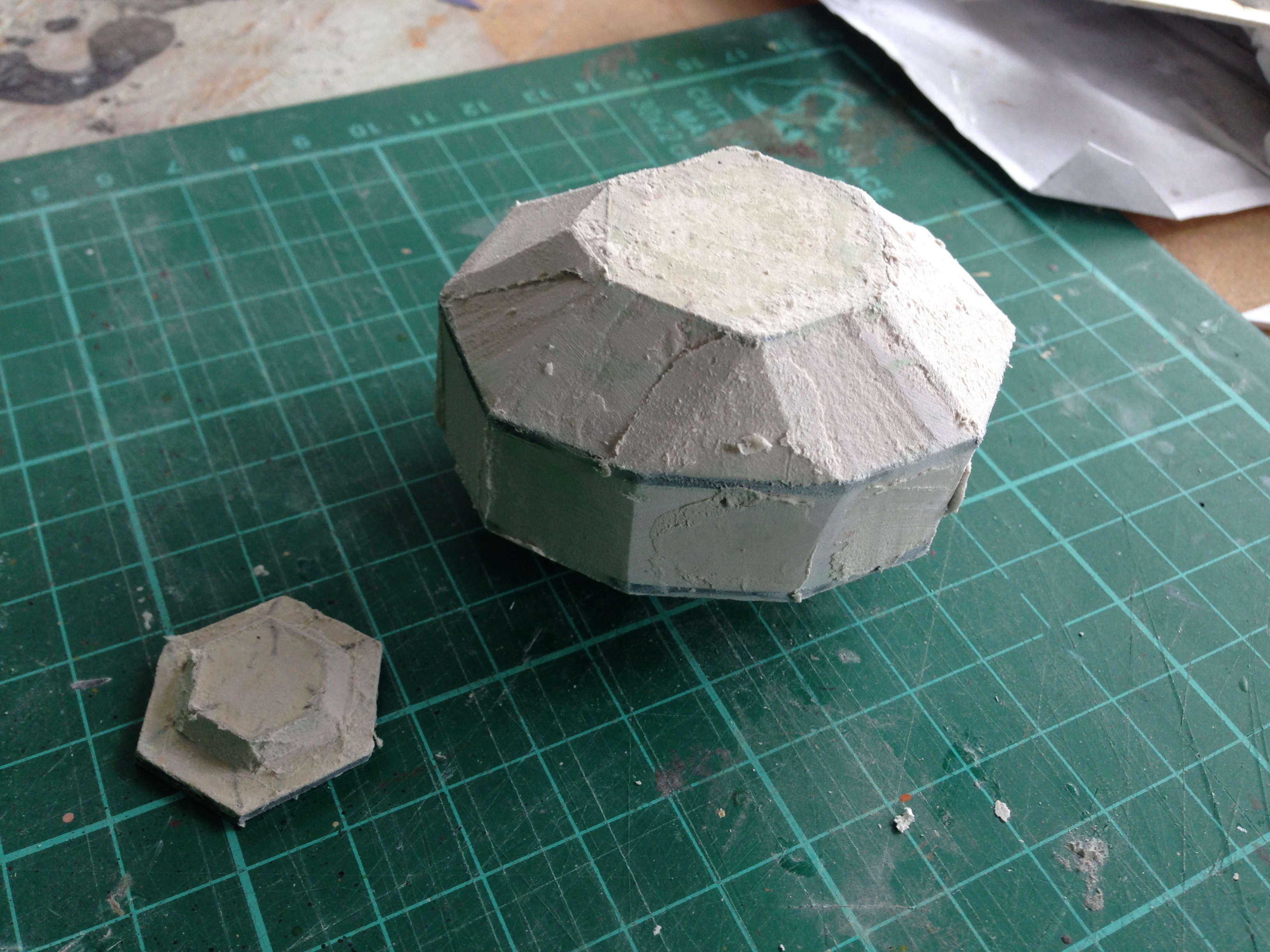

Some pics of the prototype ready for casting. I love the feel of this so far as it's, for me, the right size unlike the mass produced which seem to be a lot smaller than this. This feels Dwarven!

Love the level of detail, especially on the pommel and the precision of these ornament pieces. And your hands look unharmed, I would have cut myself several times working with such tiny bits
