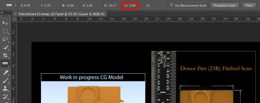

I wanted to prove to myself that the overall mandible thickness (not including plating) was actually 2 inches. With the recent acquisition of a key donor kit, I was able to use Photoshop and its measuring tools to compare what I know to what I want to find out. Carefully measuring the part's dimensions and building it 1:1 in 3D (I'll use this part later in my 3D comparison layout), the results are as follows.
After scaling the measuring tool to the correct pixel length units
(Photo credit: Jedilaw)
We get, circled in red...2 inches.
More to follow...

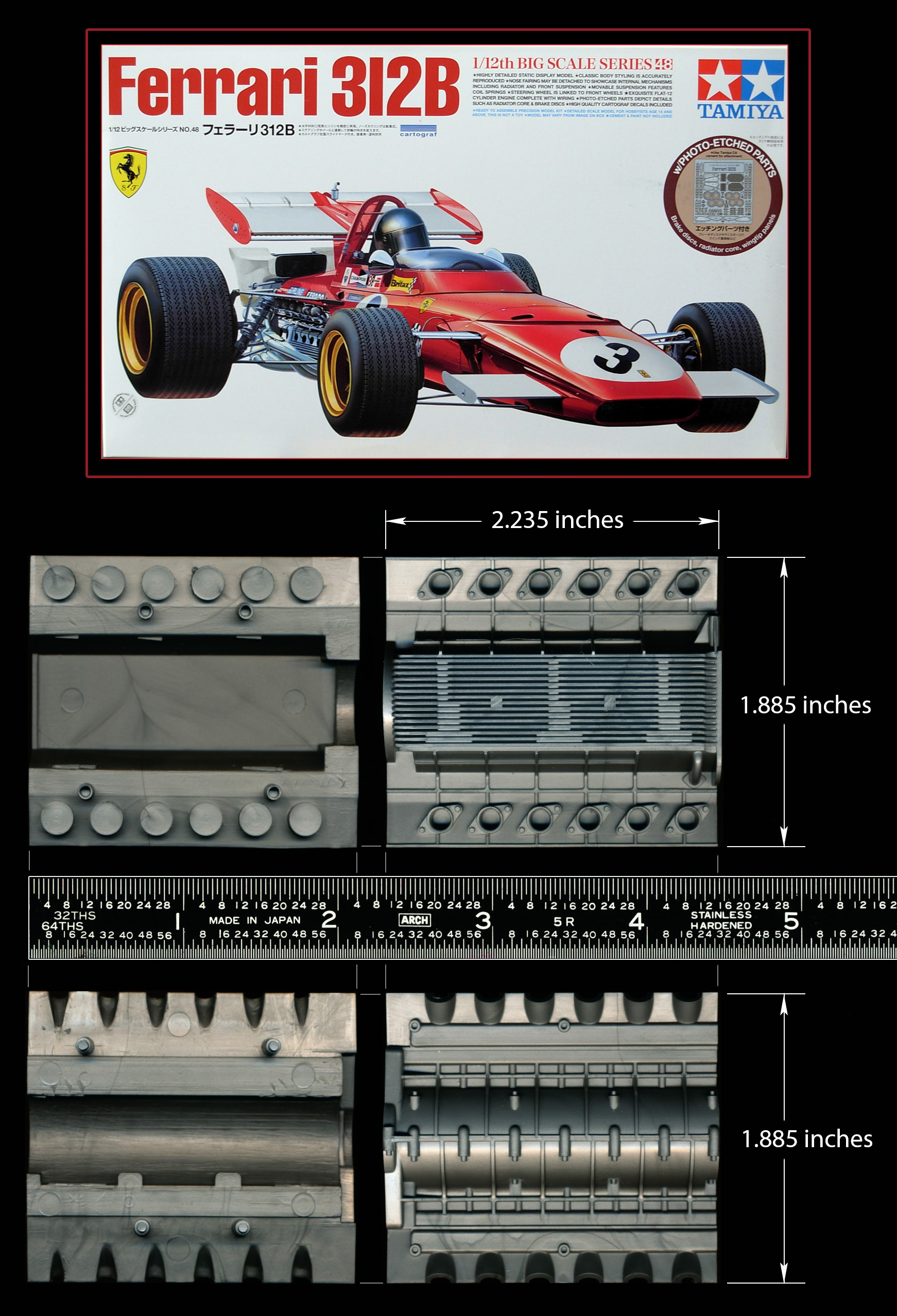

Can someone do me a favor?
I need the dimensions outlined in the attached picture of part #5 from the original 70s Tamiya Ferrari 312B kit (12007).
I have the re-release kit (12048) and after having CG modeled the part and attempting a 3D tracking line-up - something is amiss.
I might be seeing a slight tooling difference between the old part and the new...?
Thank you very much.
Andre
Ok...I sorted out the Ferrari 312B issue - my CG model was slightly wider than it should have been and I was using the wrong field of view for the CG camera.

The Tamiya 1/12 Ferrari 312B (part 5) provided the initial dimensions to start the micro-survey:
I then shot a quick iPhone movement test and 3D tracked the CG model and comped it over the original part as a visual check:

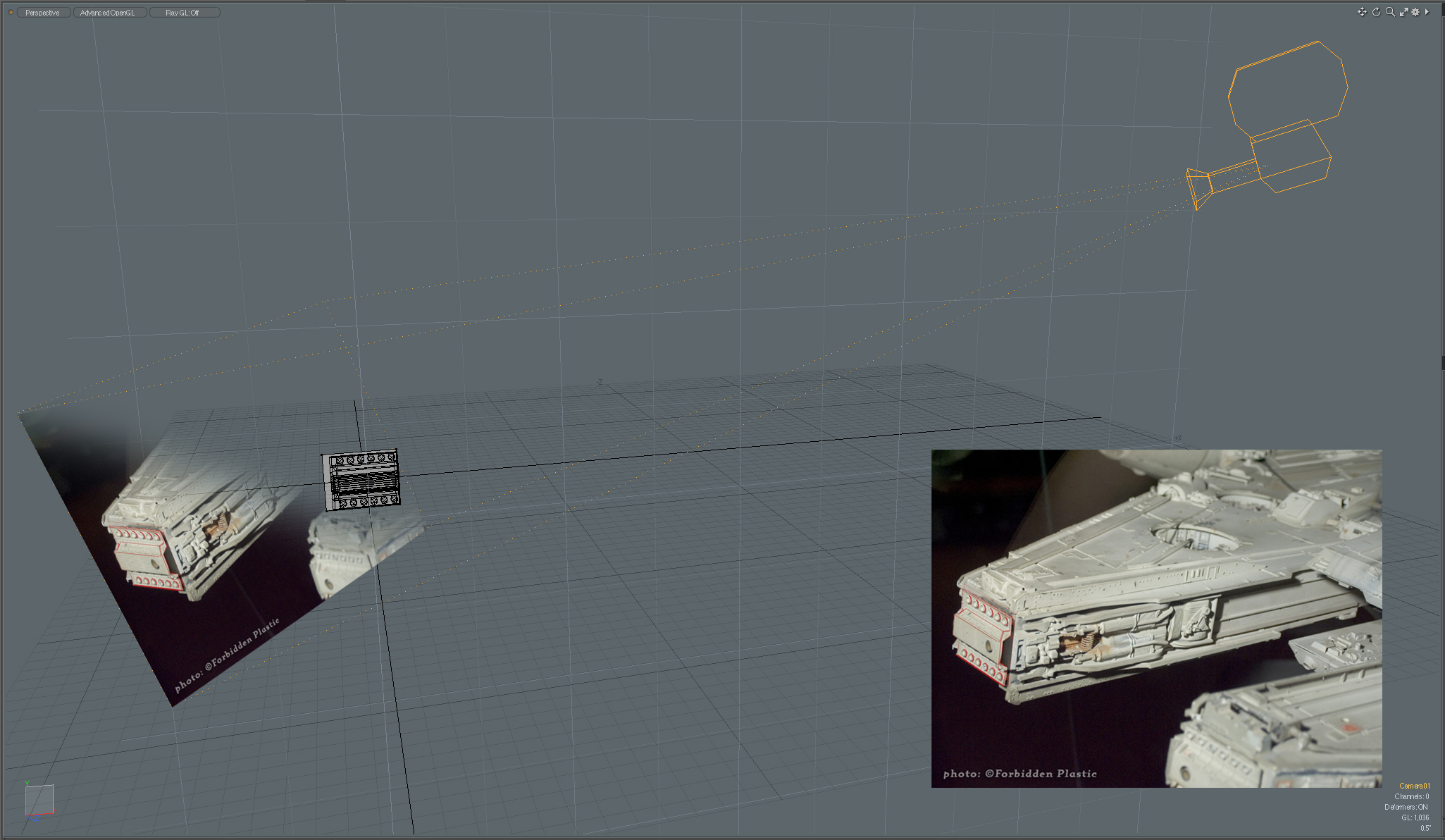

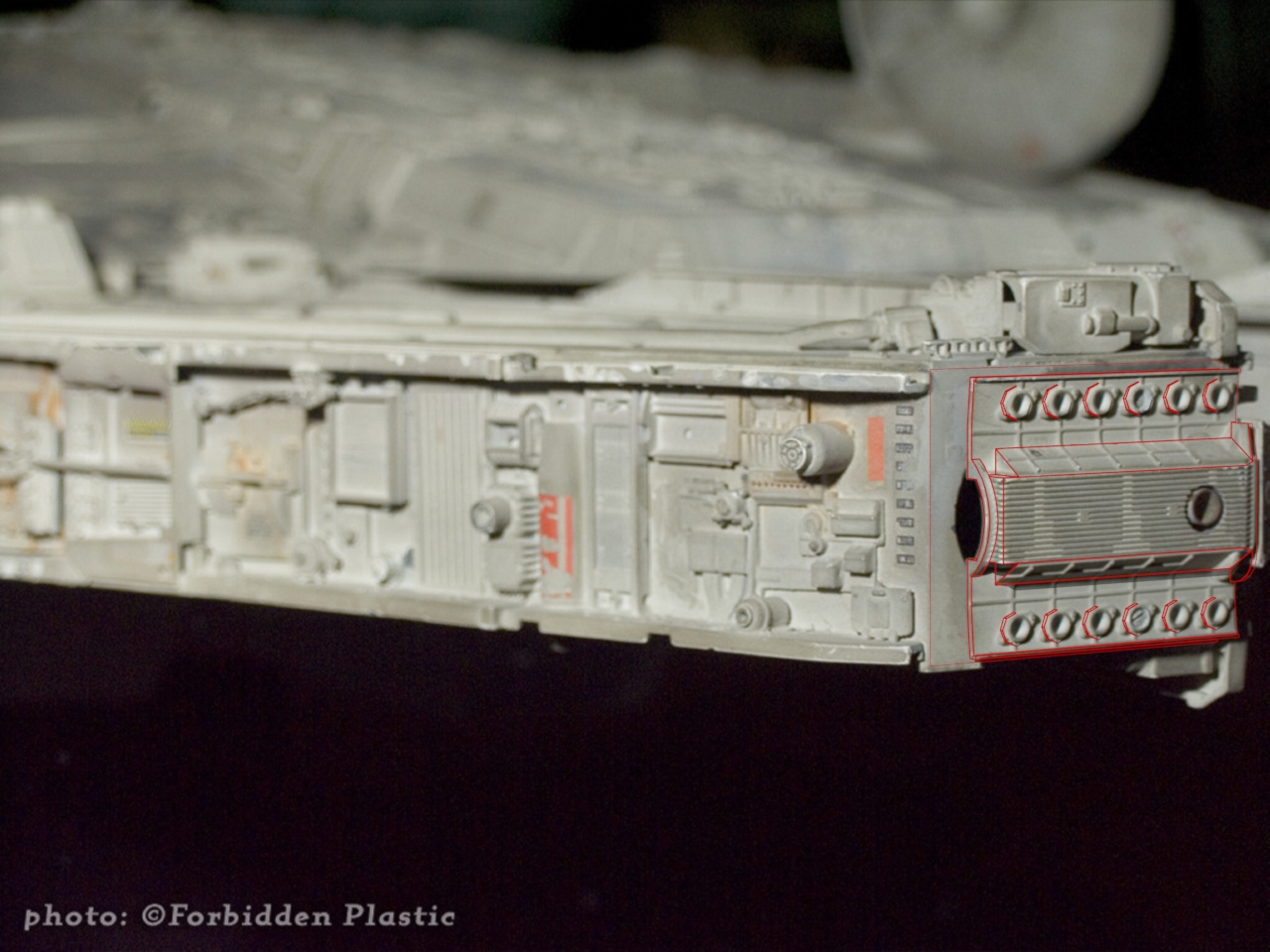

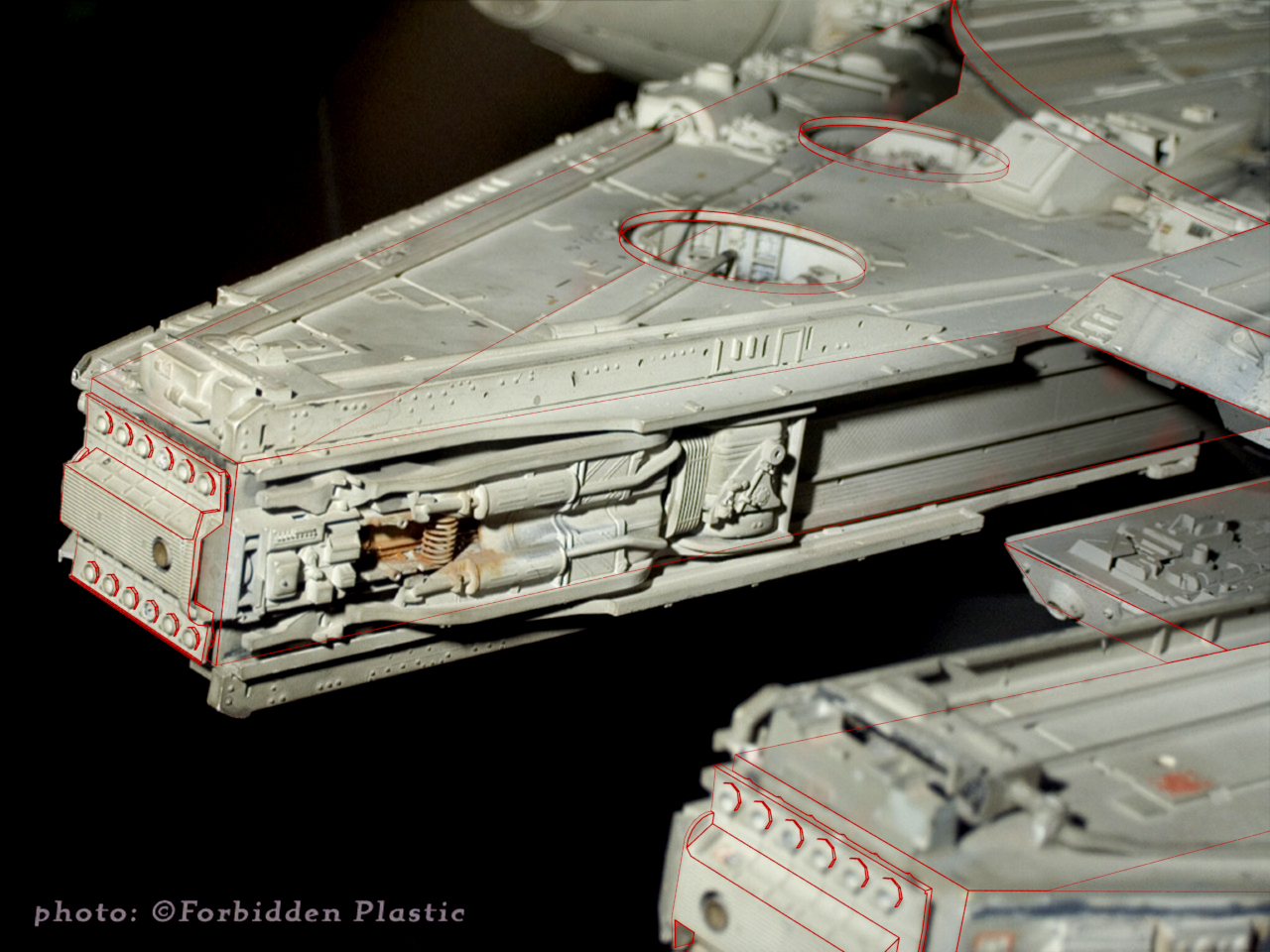

Using some image reference from the SW Exhibit and via 3D photogrammetry, snapped CG cameras to each still camera angle – first, the starboard side:
cgComp_001.jpg312B_SB_part5_frame1.jpg312B_SB_part5_frame2.jpg312B_SB_part5_frame3.jpg
Then, for corroboration, the port side:
I also assumed that the posts in back are slightly cut down (colored red) and the part lies flush on the 12 exhaust port plateaus (colored blue):

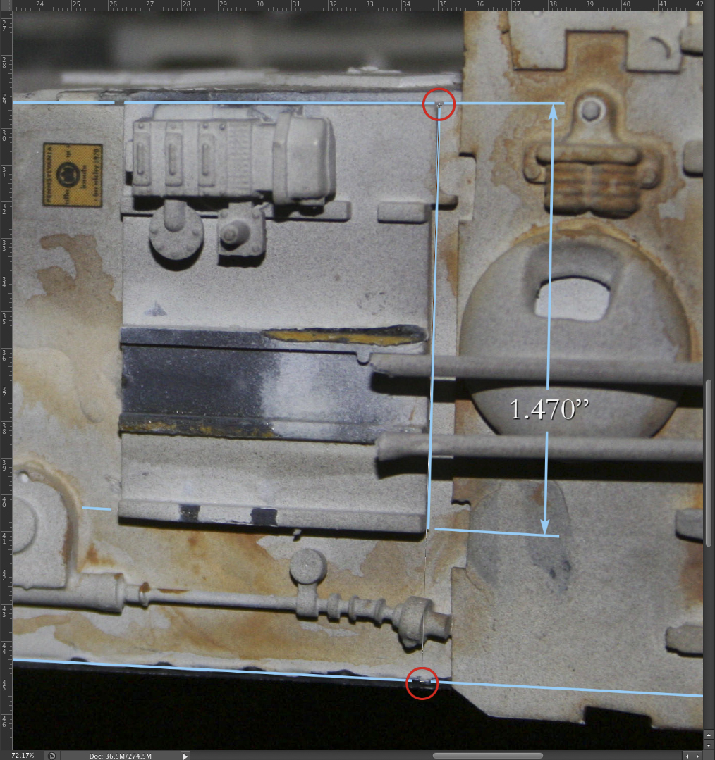

I then arrived at the following nose dimensions for the starboard plane and assume the same (mirrored) on the port side:
Finally, based on an overall 2D and 3D measurement and survey, I propose the following dimension that tie the starboard and port side together:
