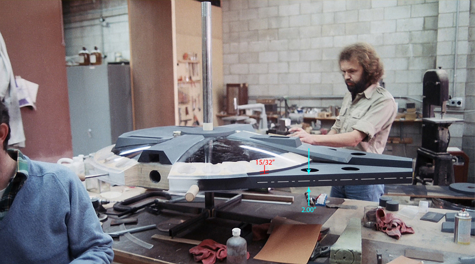

Help needed from the experienced falcon builders , I was just measuring my side walls to replace and found three depths of sidewall, outer mandibles 21 mm , waistband 25mm and rear clam shell 22mm
can anyone help with what the 5 footer wall measurements were (and what scale that was (I seen the 5 foot model representing 34 metres long) ) and was the side wall consistent all the way around or did it have different depths

Vacformedhero,
I trust I understood your question and hopefully, the following image reference answers things:
The mandible walls are 2" high (1" up and down from the center line datum) and the core hull cylindrical form extends an additional 15/32" up and down off the mandible horizontal surfaces to meet the upper and lower dome form surfaces, all the way around.
Please let me know if you have any further queries.

Thank you so much for the answer Andre , and this brilliant shot also confirms that the rear sidewalls match the front sidewalls ,
appreciate that answer
Brian

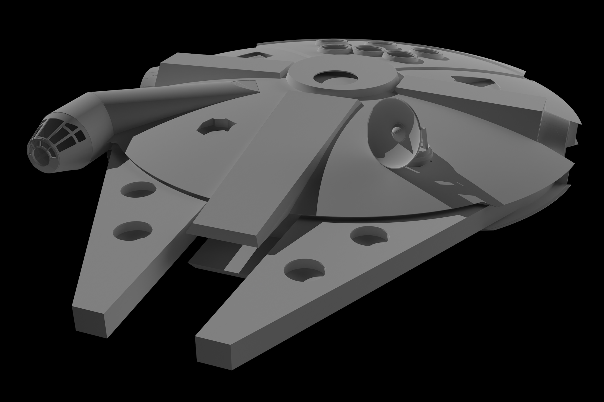

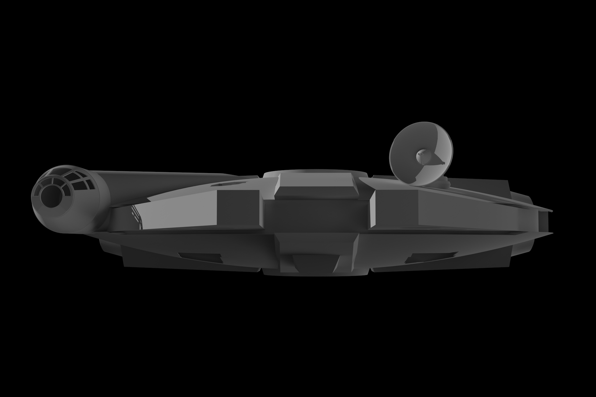

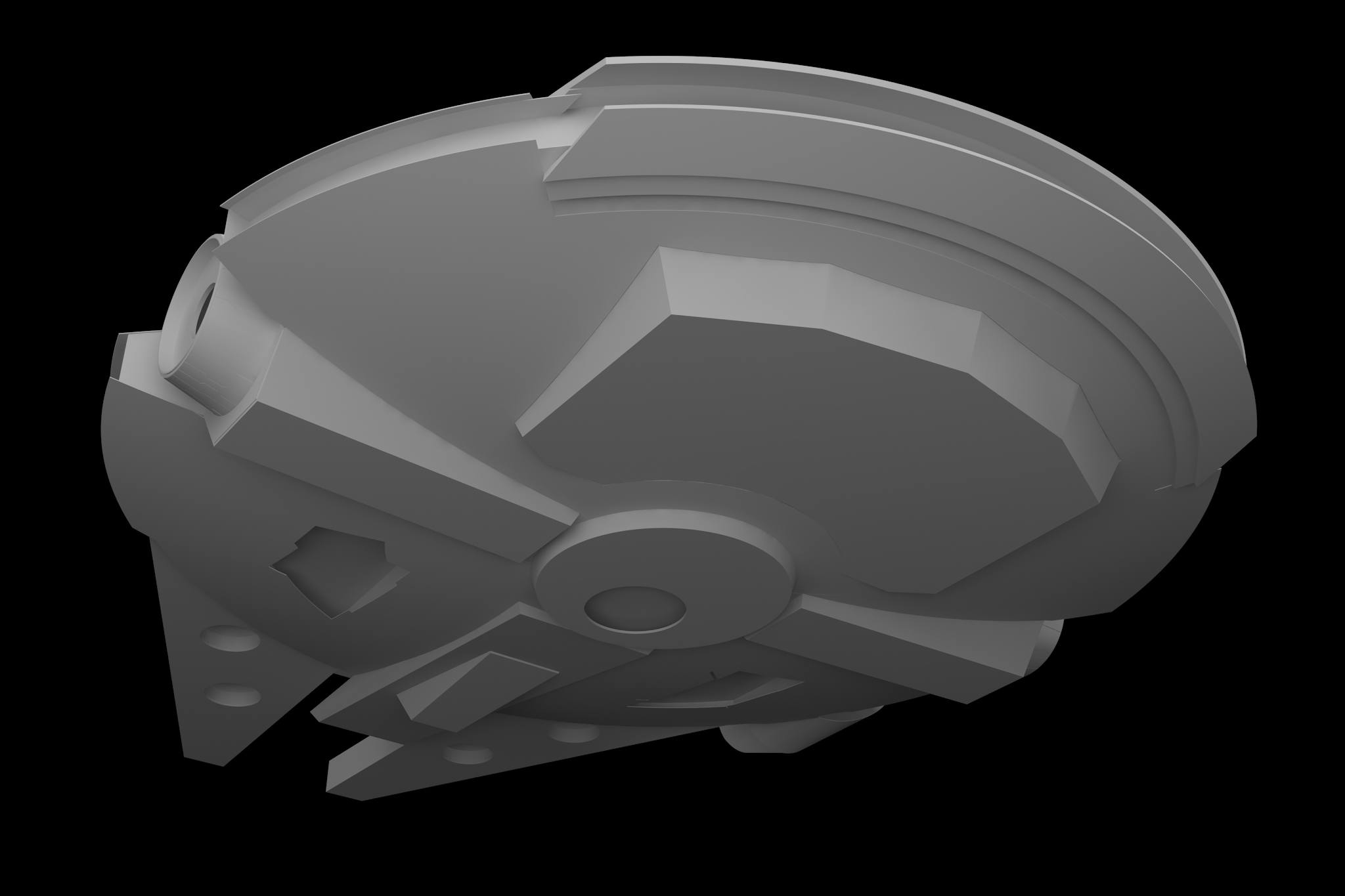

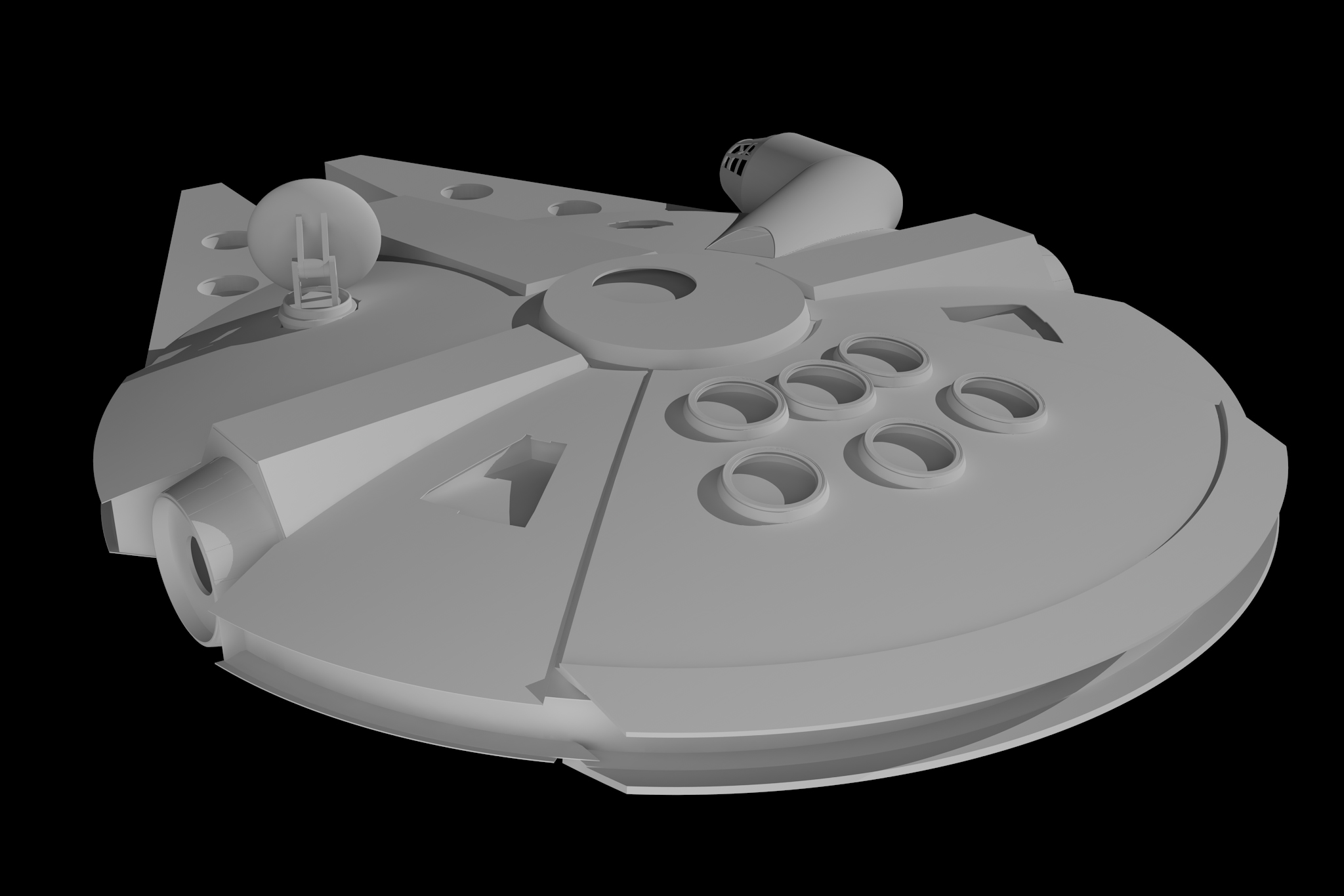

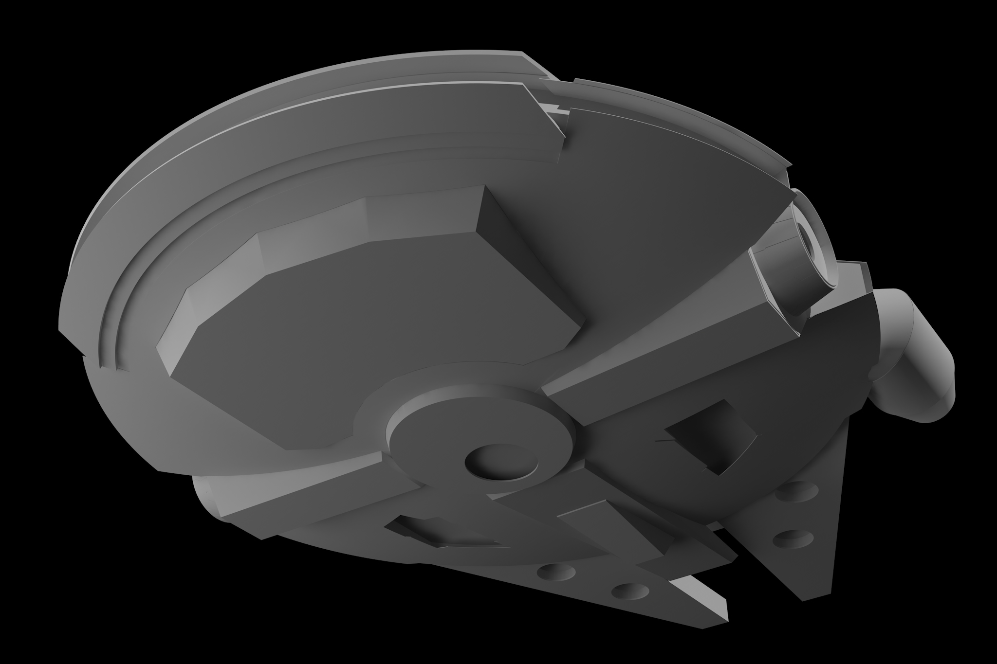

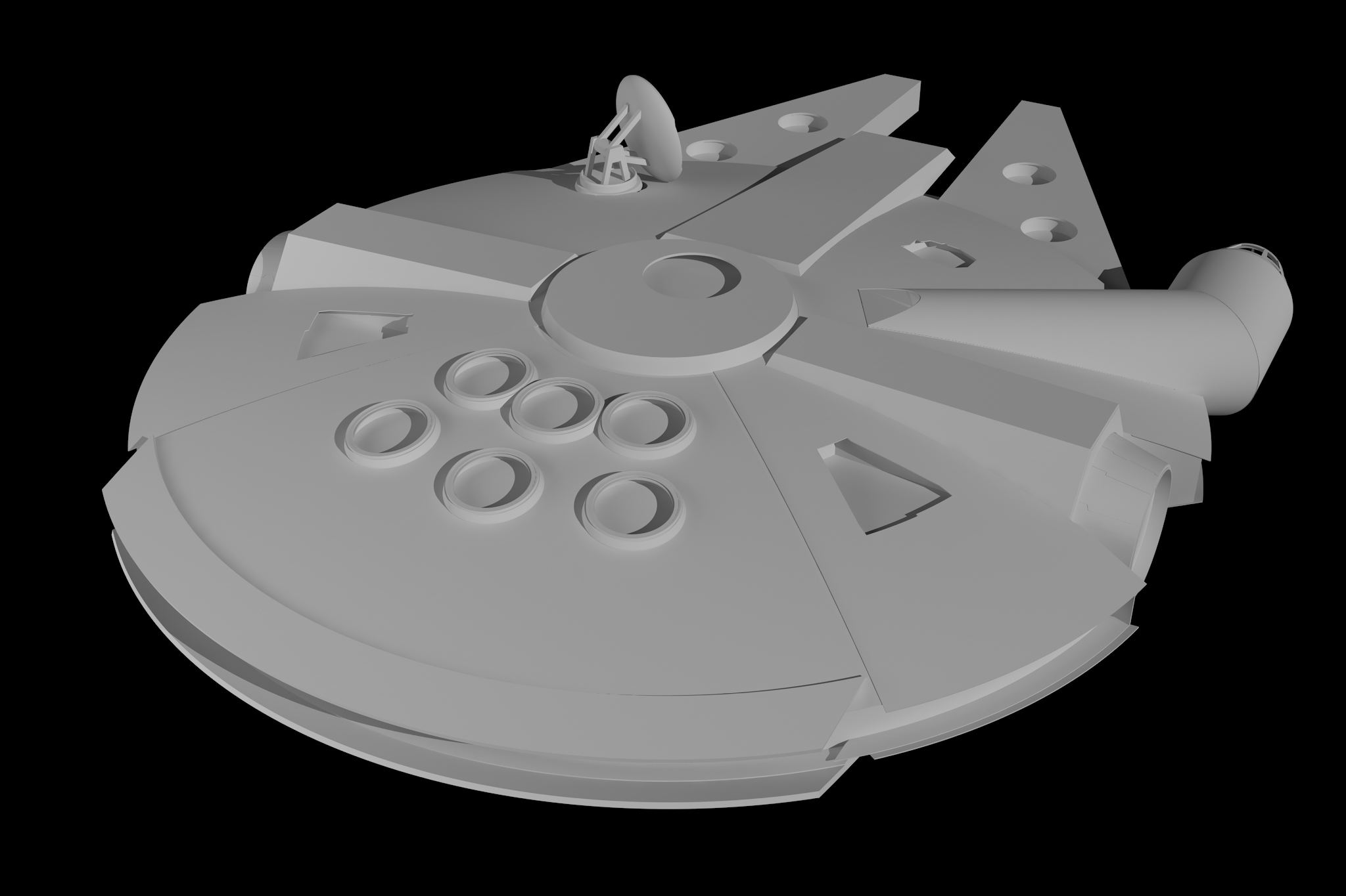

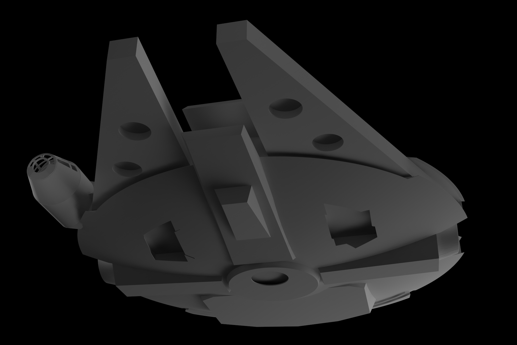

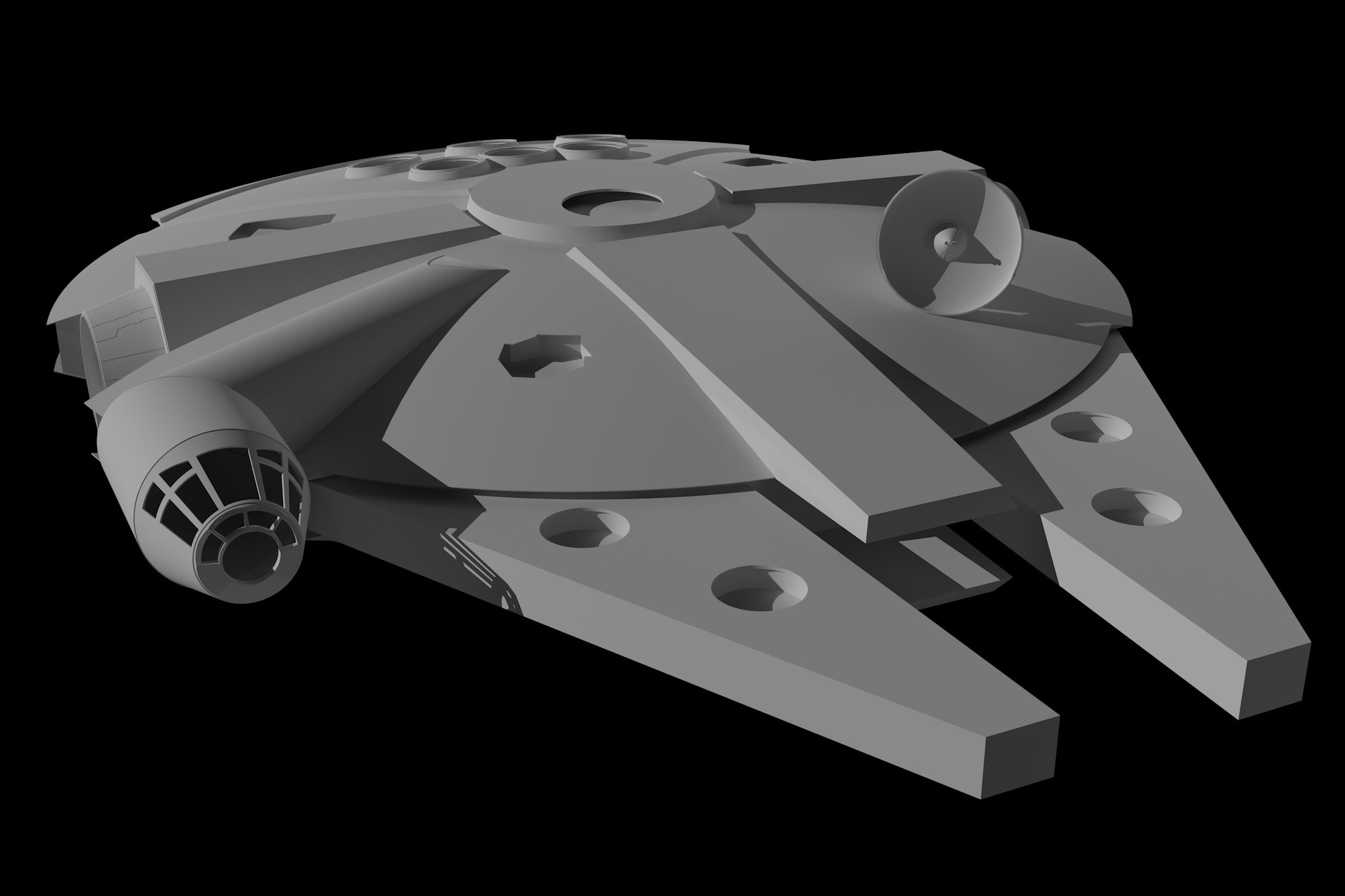

Our ANH 5' Millennium Falcon CG core form model, is done.
Revised blueprints and CG assets are coming next, but in the mean time - some preview images:
This could not have happened without the collaborative efforts of Stuart Brown and Joshua Maruska.
Gentlemen, thank you very much...saluto!
Regards,
A
