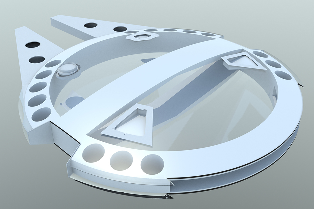

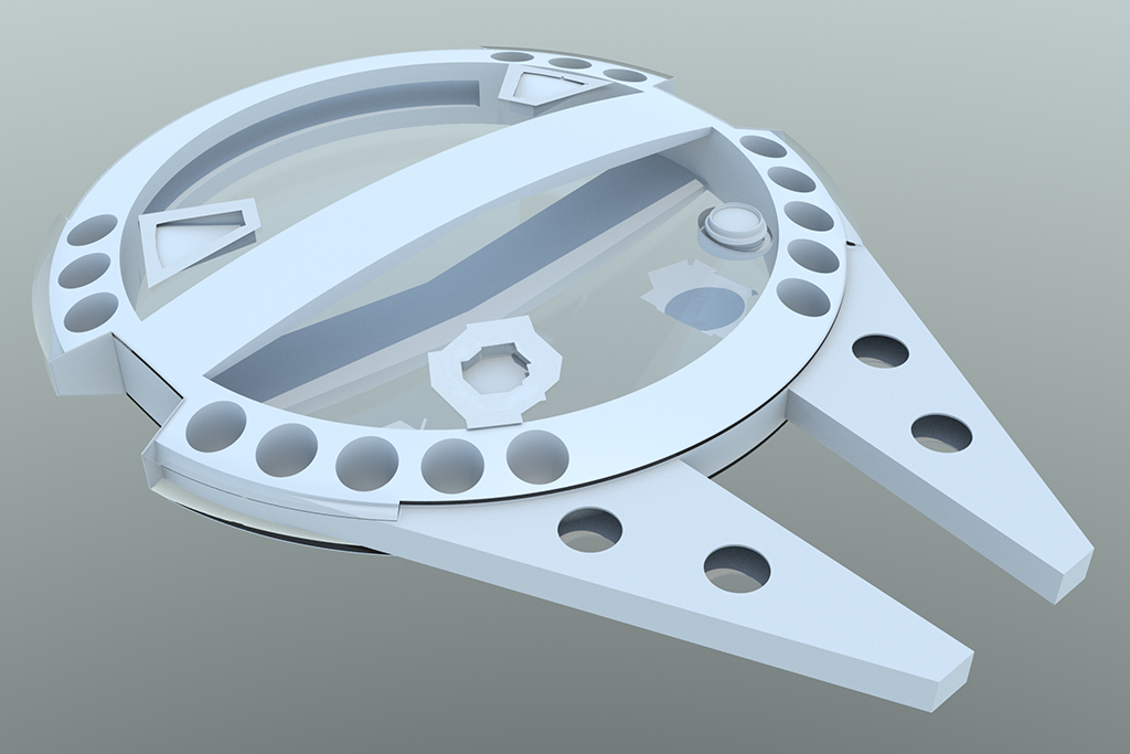

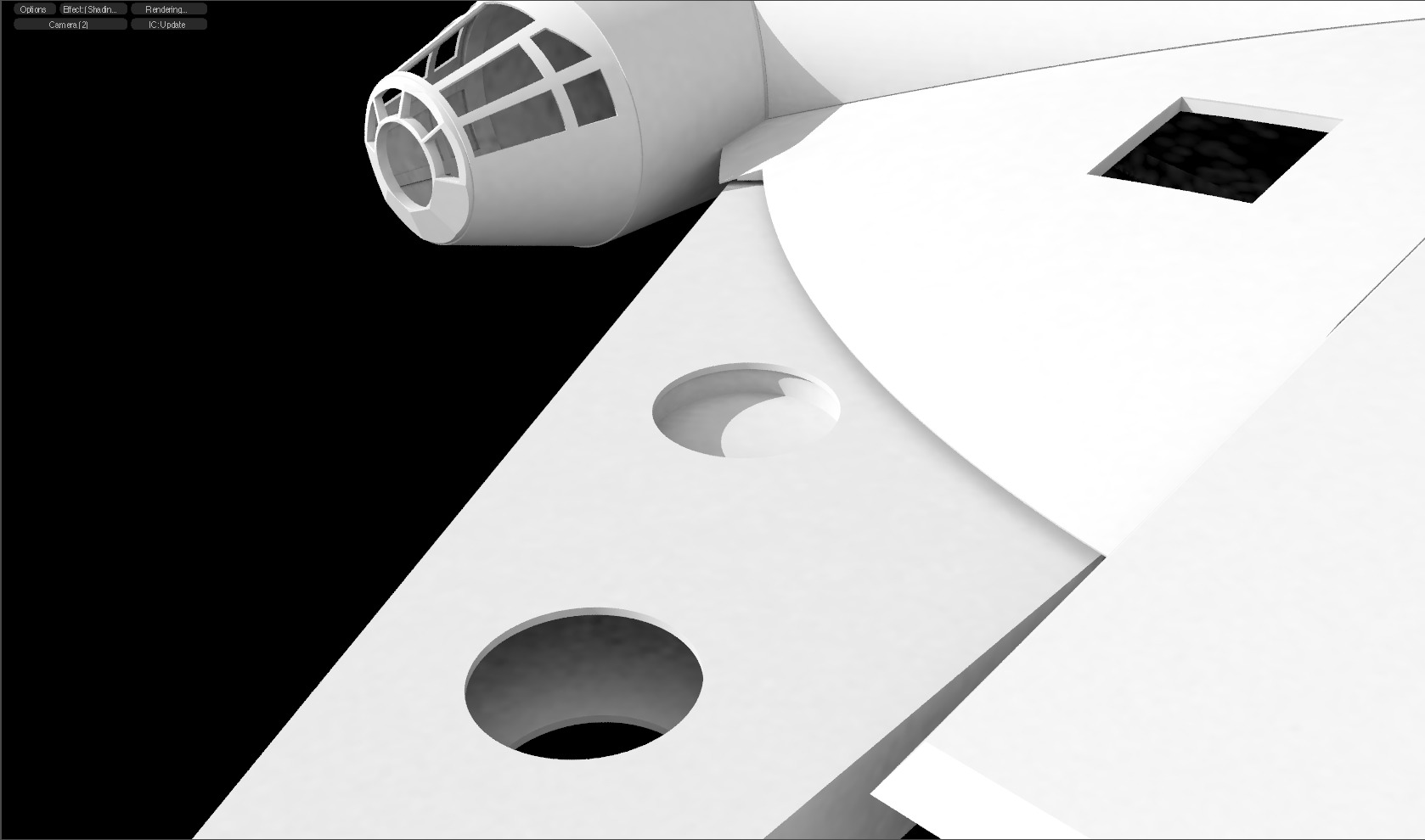

Circle gets the square!
Using a similar camera projection mapping technique as we did on the docking rings reveals that the access pit is actually a square...
Here it is roughed-in...
We'll use a similar technique to locate and shape the rear access pits.

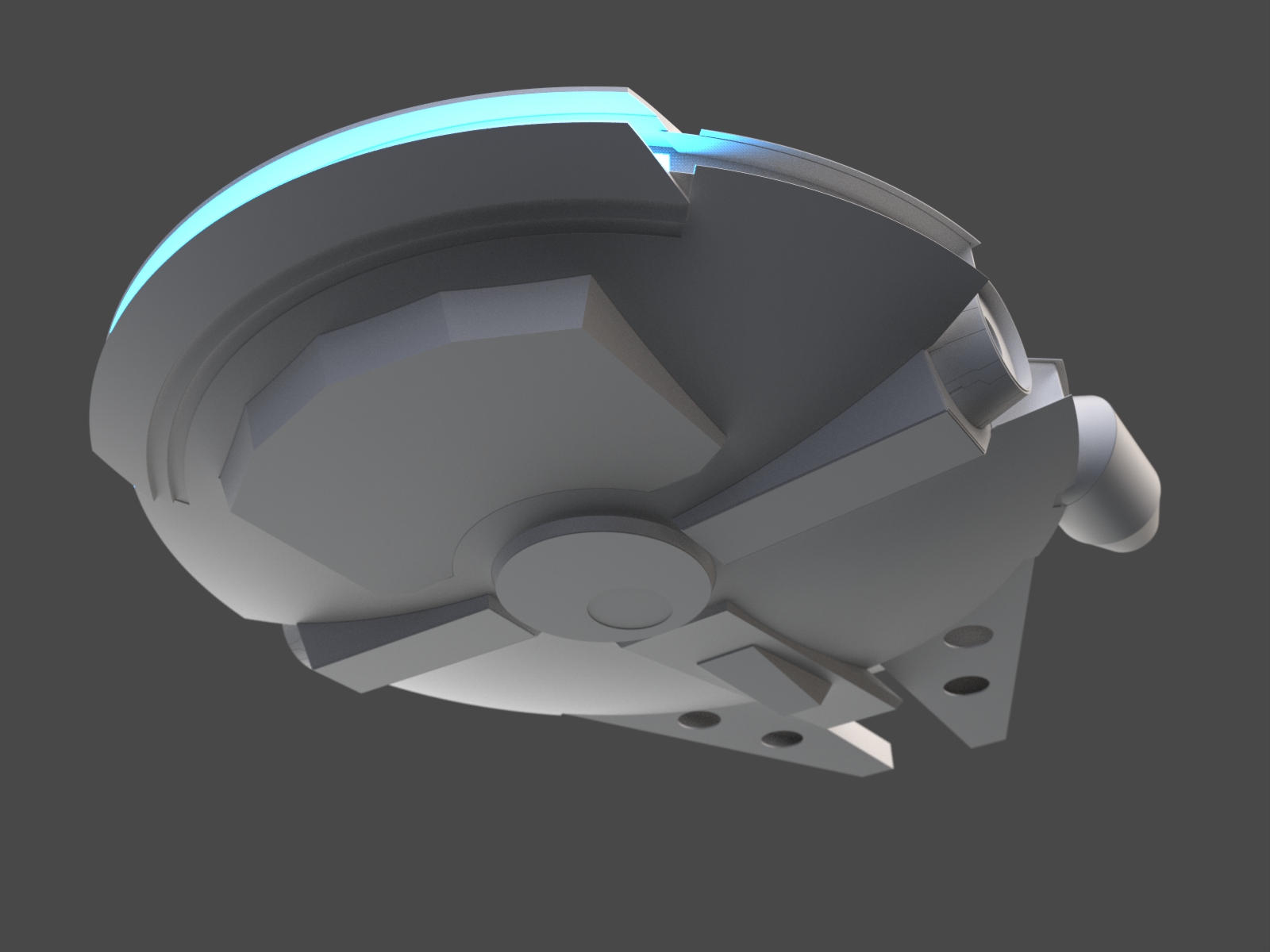

And a bit more work on the underside. This has been updated with Andre's latest photo-match efforts.
cheers,
J.

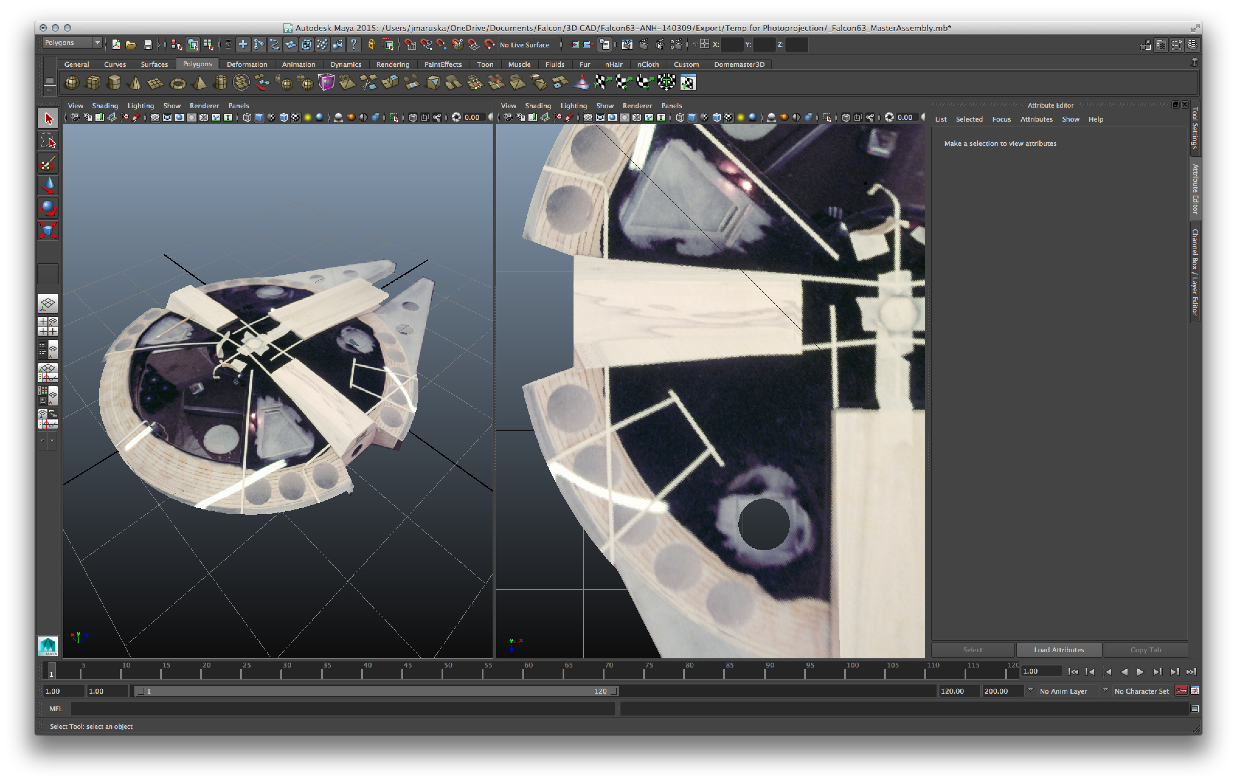

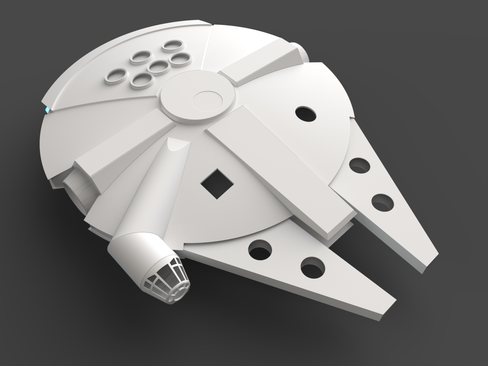

Some interim progress below:
This is one of the first 3D track line-ups that we've done to the latest CG model. It's not perfect, nor will it ever be - but it is close. We are currently tweaking a bunch of details to get things even closer (i.e. mandible well positions, radar and dome well shapes and placement, cockpit/tunnel position etc).
After that, we'll be updating the proposed blueprint dimensions from earlier in this thread.
Regards,
AB, JM, SB

What have you guys found from the solve regarding symmetry of the body? Any anomalies you didn't expect?
Rob
Rob
Yes...one that I've found is that the mandible wells on the starboard side are somewhat closer to the hull dome in the Z-axis (fore -aft line) relative to the port side wells. The new blueprints will reflect this difference.
I think Stu has found others but I'll defer to him on that.
I think at least for me, I'm going to wait for the actual donor kit build, to deviate much from our current "mostly" symmetrical model. I need the actual vintage part and part assembly relationships to confirm or, more importantly, deny what we've derived, divined, theorized or subtly guessed so far...
"Your mileage may vary...", as the commercial went.
It ain't over yet...
Andre

Only actually building the piece, with vintage donor kit parts, will be the final say.
And I suspect that we will need to adjust our 3D master assembly model based on future findings. In fact, I expect it.
Thankfully, the current digital asset is in a parametric modeling package as opposed to a poly modeler. As we make adjustments based on the build, other constrained/related forms will adjust as well - a real time saver for sure, as the overall form evolves.
Before I started this thread, I was struck by something that many people seemed to be struggling with. In a search for accurate blueprints, measurements or clean top/bottom/side views of the Falcon, image perspective seemed to be an impediment to getting accurate measurements from the images alone.
Having worked with 3D tracking tools and image-based modeling tools for years in my day-job, it struck me that some of those tools, in concert with images replete with perspective, might be of use. In fact, to work accurately (or at all), perspective is an absolute necessity.
Further, the more images – the better. Contemporary images, moving images – even images from back in the day are of great use when trying to divine something you don’t know from something you know (i.e. a donor kit part dimension).
But, not all images are created equal. Composition, exposure, depth of field, focus, focal length, lens distortion etc. are all issues that need to be considered when producing images for this particular pipeline.
So, I wanted to present a specific set of 3D techniques as a workflow that I use, that may be of use to others on their projects. Not as the only solution, but as one that dovetails nicely with techniques that have been around for hundreds of years and are as vital as ever.
Regards,
Andre

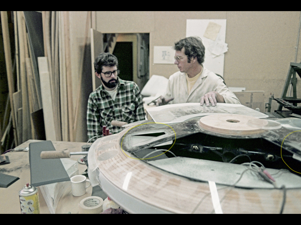

do the rear quarter access pits really have horizontal floors? I love the way that looks, but the way the greebles sit in the recesses, they seem to be at an angle flush with the rest of the exterior.
Based on this reference:
They would appear level - unless that detail changed after this picture was taken.
Either way, a donor part assembly and fitting will be the final say...
