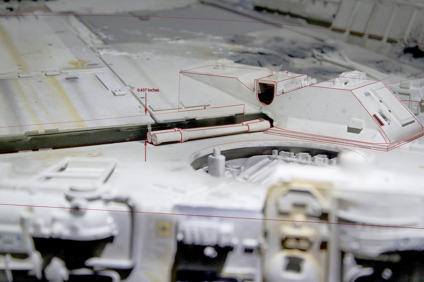

Here's one, I hope solved...
Below, please find my new measurement for the vertical wall extension above the upper non-armored mandible surface:
Using a surveyed, measured and CG modeled Tamiya 312B donor kit part (plus a .040" styrene plate sitting on the mandible surface) and snapping my CG camera to that, I extrapolated nearby relationships (i.e. the Duster barrels) and ultimately the current wall height - thank you shadow lines!
If the .437 inch wall extension dimension is true, then I am about 3/32" too big in the Y-direction per the current published blueprint, from the mid-line datum.
What is interesting is that my latest photogrammetry textured mesh has the overall turret heights (from the mid-line +/-) approximately that much less. In other words, the current blue print dimension might be slightly too thick from turret face to turret face in the Y-axis. It might be approximately 10.5 inches not the current 10.75 inches. That wall height dimension affects so many other things and ultimately affects the curvature of the big domes and how they mate with the surfaces making those curved arc intersections.
Finally, I've seen that .437 inch dimension before, not sure where...possibly on that first ILM Lorne Peterson "naked Falcon" image solve approximation, way back when at the start of this thread...
We'll be updating the overall blueprints soon to reflect the new discoveries.
Regards,
Andre
Regards,
Andre

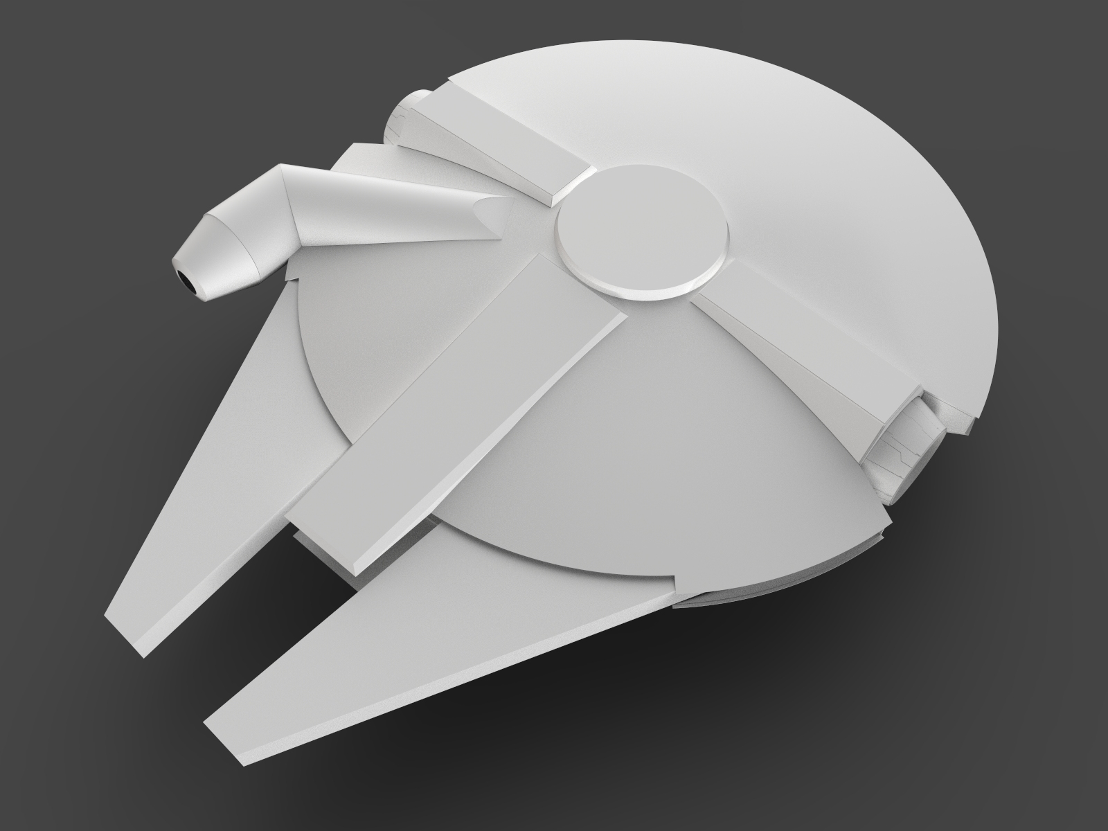

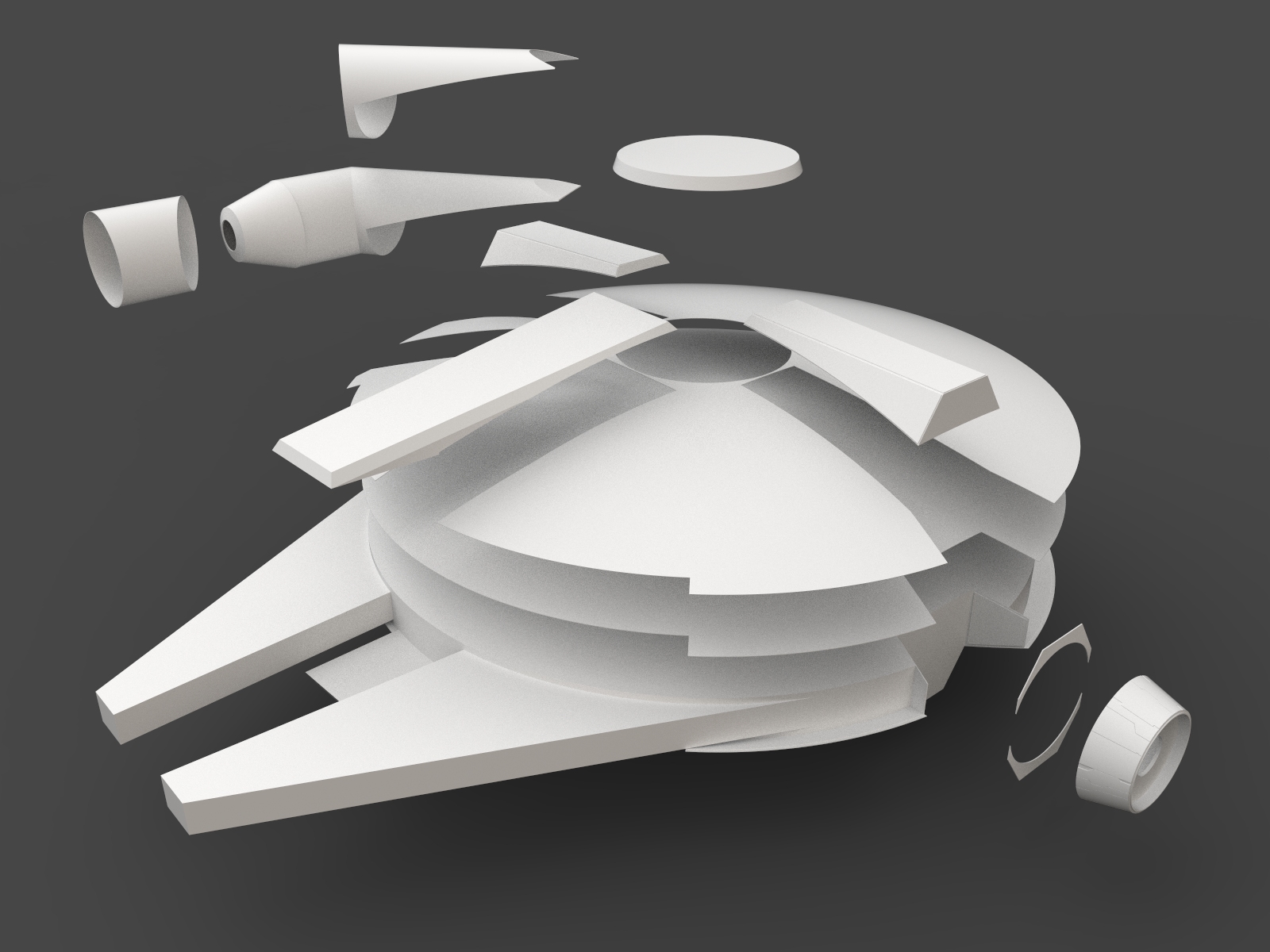

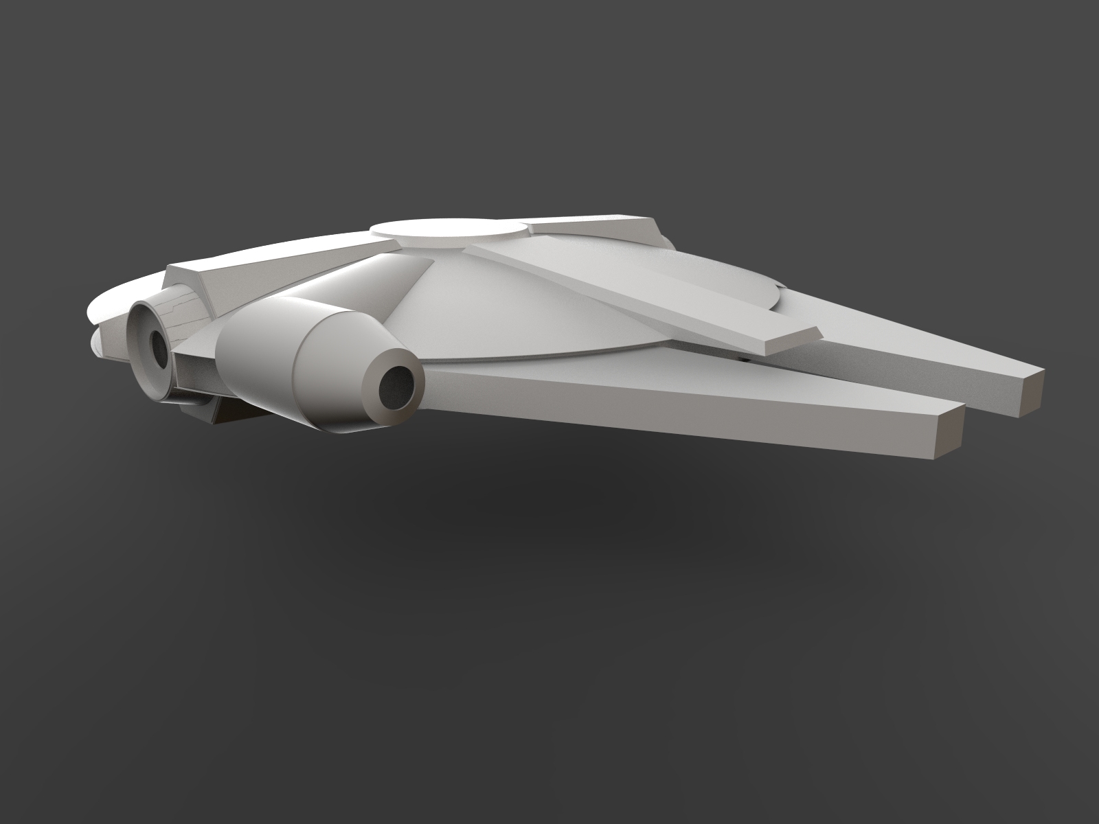

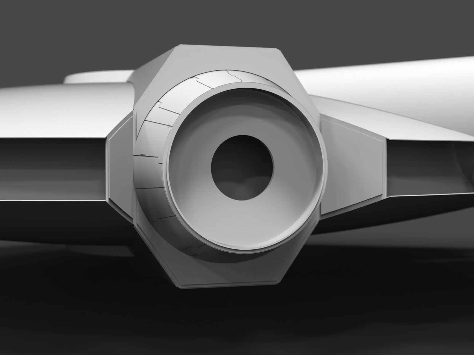

Andre and I have been tag-teaming the base 3D model for the 5' Falcon. Here are some of the recent images of the model thus far. Not quite ready to publish "official" blue-prints, but getting there. This set takes into account the above mentioned .437 vertical wall. We've also been building the model to be somewhat elastic in the sense that we can easily modify a single dimension and see how that effects everything else. In particular, I've been experimenting with different dome radii and watching how that cascades throughout the docking arms and the cockpit tube and jaw boxes and comparing it against the 3D photogram Andre made by stitching together his photos.
I've included an exploded view to show how we're looking at some of the materials and construction techniques used on the original model to act as a guide to our solution.
Next step is to cross verify this model against the frames from the movie and other photo references, tweak, repeat...
Cheers,
Joshua
looks fantastic.What about the engine deck and exhaust? Very curious about that area. I always have some good head-scratching back there, replicating the fullscale falcon. I'm very curious how the 5' compares.
