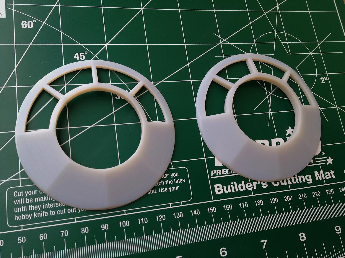

Evening, folks...been a while. More to come soon, now that I'm back at it.
For now, progress on the cockpit area. Parts ready for printing...

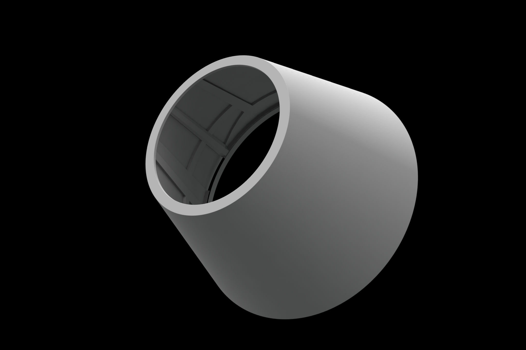

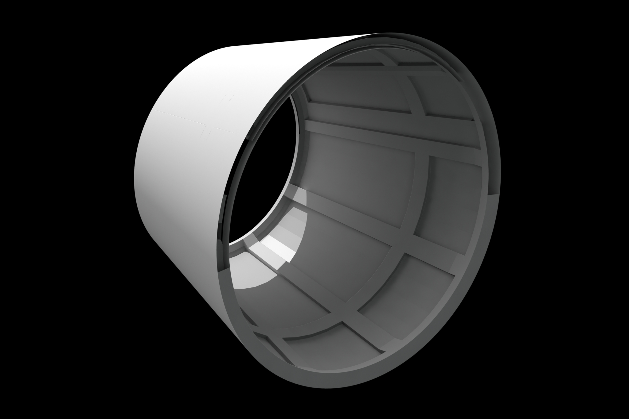

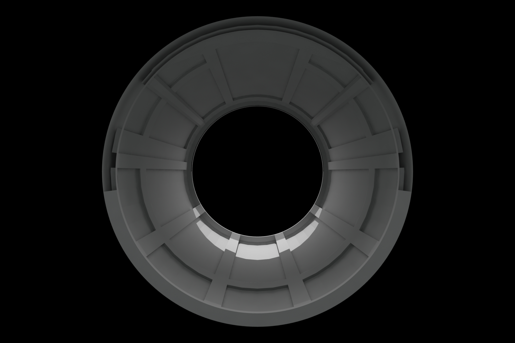

Been thinking a lot more about the cockpit's structural design. I've modeled not only the outer shell (without plating, T-rails, kit details etc.) but an inner rib structure as well. Whether I RP the whole thing or do a combination two-part mold resin pour with an RPd core - I want a structurally sound form that mates with the frontal face plate and the 5.75 inch diameter tunnel.
A work in progress model rendering:
RP test print(s) to follow...
I've been thinking a similar approach, Andre. Have you considered a photo-etched brass part (at least the window from a assembly) with RP details? I'm super worried about breakage in this area - especially on my smaller build.
J.
J.
Interesting thought. I had not considered brass. Photo-etch it flat then roll it into a conic shape?
I do agree that at your MF 32" scale, thin sections like the cockpit walls/window areas could be problematic - especially at the sharp corners.
