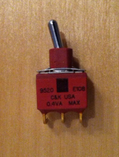

I have been doing some computer cleaning and came across a photo that might help, perhaps you can add it to your list. When I built my EMF, I knew nothing about electronics so went looking for parts just by what they looked like. There was a huge electronics surplus store in my city with hundreds of bins and drawers of parts. I was able to find almost everything including a red toggle switch that looked like a good match. I went back a few times but they were never there again, that's how it was, they had surplus stuff until it was gone and that was it. It says 9520 / E108, C&K USA, 0.4VA MAX.

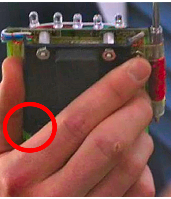

Looking at some reference photos it seems like only in few cases the back plate covers the battery holder (if at all), in most cases it doesn't.

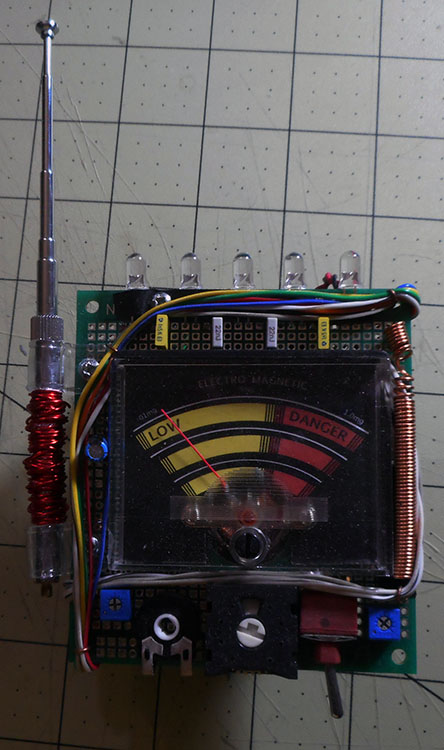

So, after a little break I've finished one (actually two, but I had to disassemble the second one for the pictures and a new needle). Unfortunately I wasn't able to find transparent P-clips or the correct antenna without excessive shipping costs. I think I will replace the toggle-switch, it's too short.
Anyway, I continued my plan of using a 9V battery. I ordered the battery holders I mentioned above and they are a perfect match in my opinion.
I also ordered some voltage transformer boards (MP1584EN DC-DC buck converter step-down module. You can find them on Amazon) that I glued to the electromagnet "cover" (I just cut it off the multimeter and snipped away the excess material. I think thatdecade is working on 3D printed covers). Underneath that I hot-glued the battery holder.
Connect the board to the 9V battery holder and then measure the output with a multimeter. Turn the screw until the output is at about 4,5V. It's a bit fiddly, because the screw is very small (left of the red wire). You don't have to move it a lot to change the output.
Later when everything's connected you can easily tell if somethings wrong: The voltage is too high if the speaker is buzzing or making static noise; the voltage is too low if the indicator light of the soundboard is dim.
I also soldered a switch between battery holder and voltage transformer, that I glued to the battery holder itself, so i can turn the whole thing on and off.

I looked at some screen grabs and you can see the curve of the edge between back panel corner and battery holder on the third image below.
