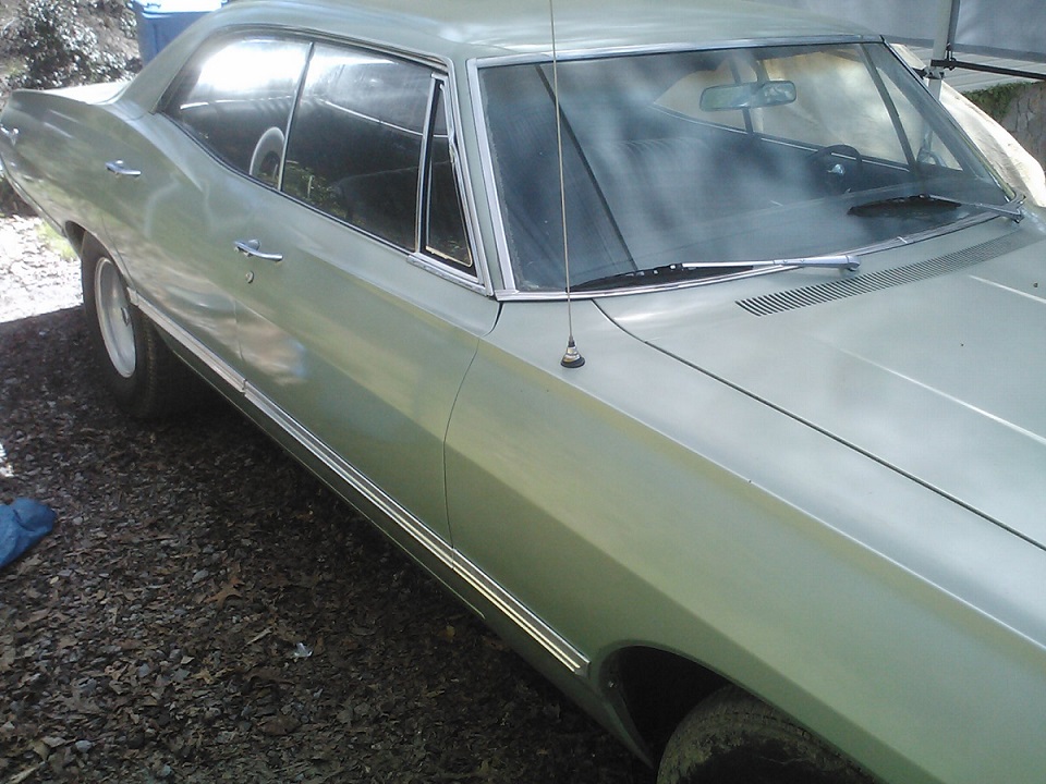

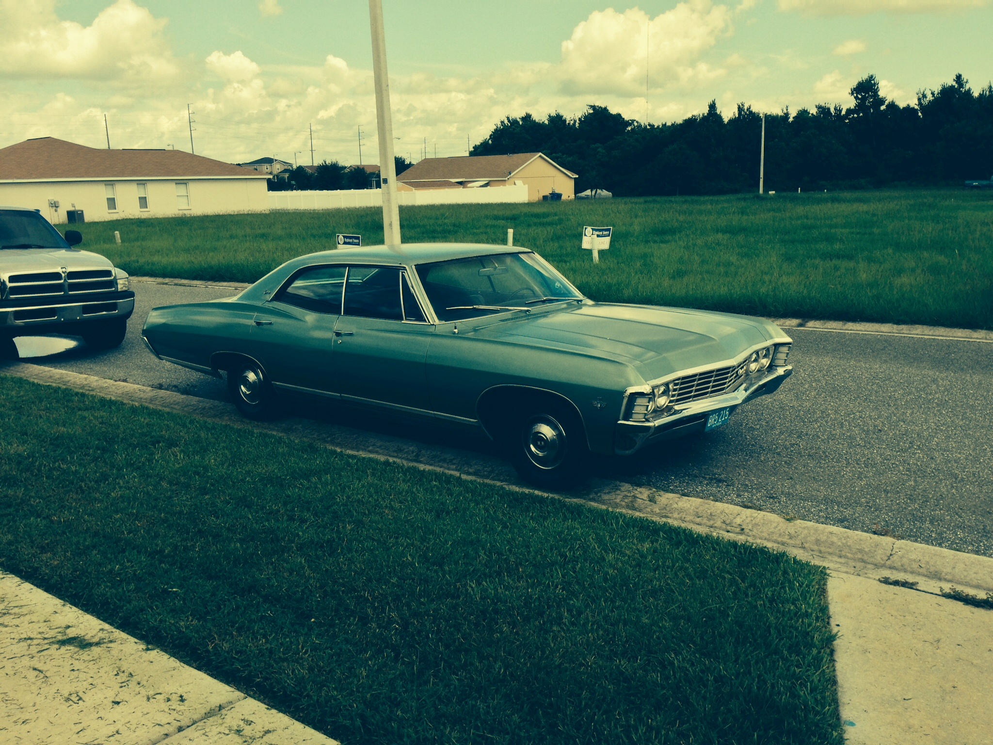

This forum is getting a little quiet. What happened to all the updates? I didn't realize until I bought and started working on my impala how much fun it was. This is a must read for any restoration to supernatural. jpeg2.jpg

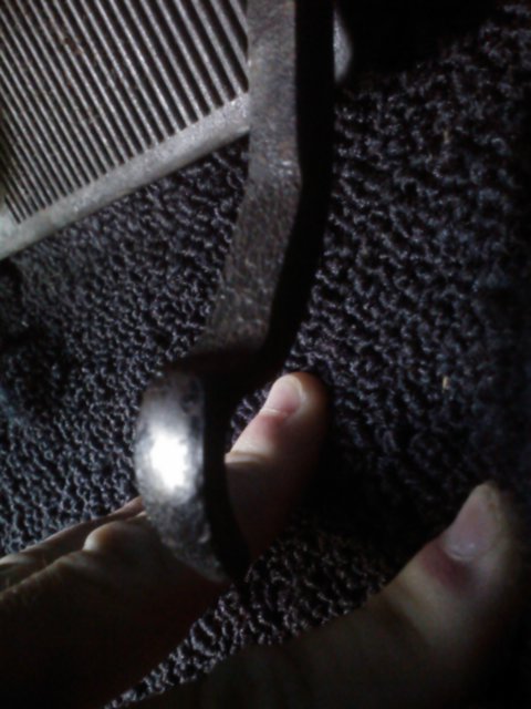

I actually like this color. The interior in in great shape. The only problem I'm having is the gas pedal. The metal accelerator rod seems really close to the firewall area. Is there a way to adjust it to come out more so I can get a pedal that will actually push it. I'm not sure if it's in the right spot or not but seems to be really close to the wall. Any help or advice?????

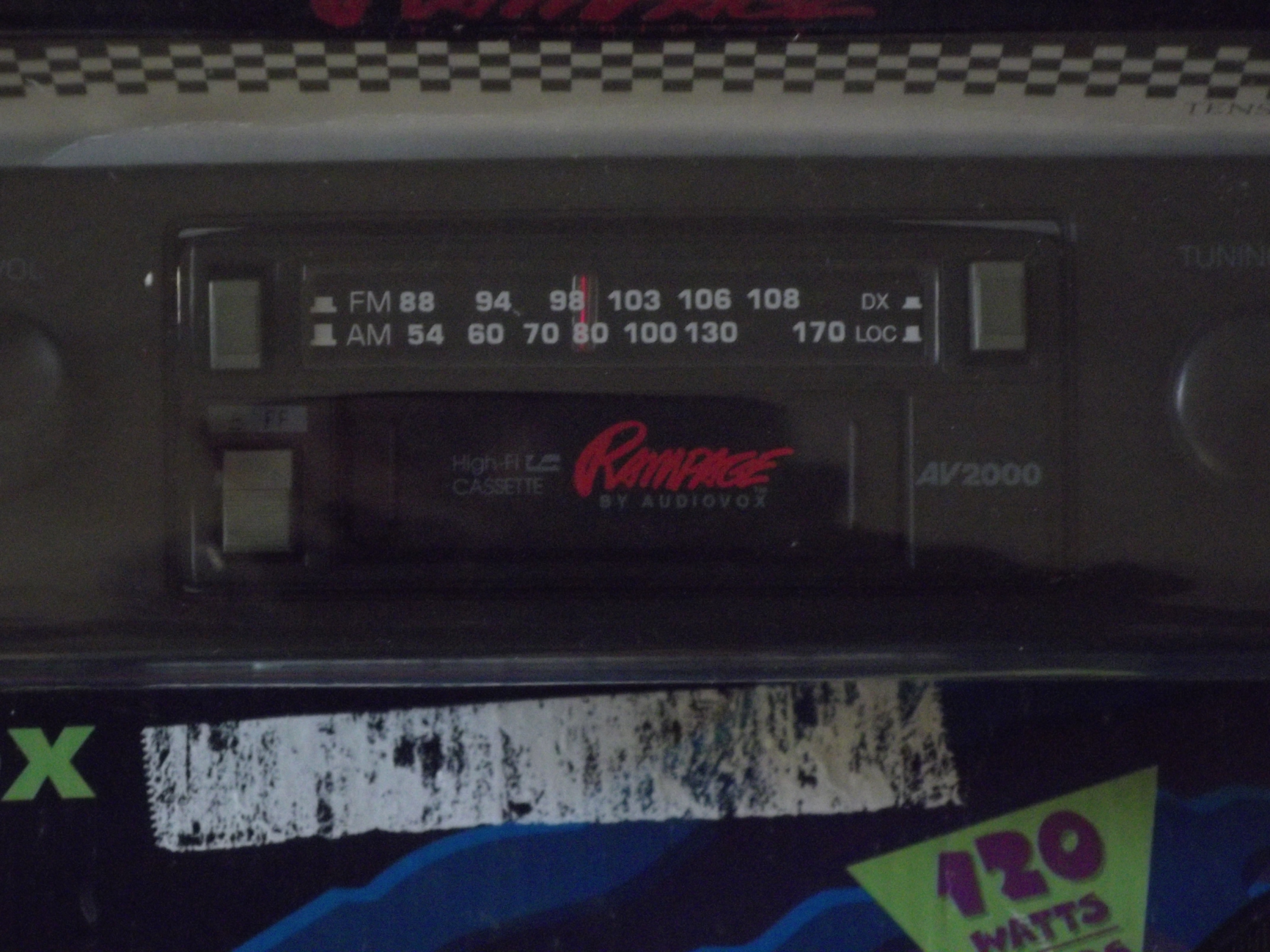

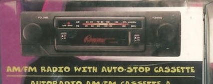

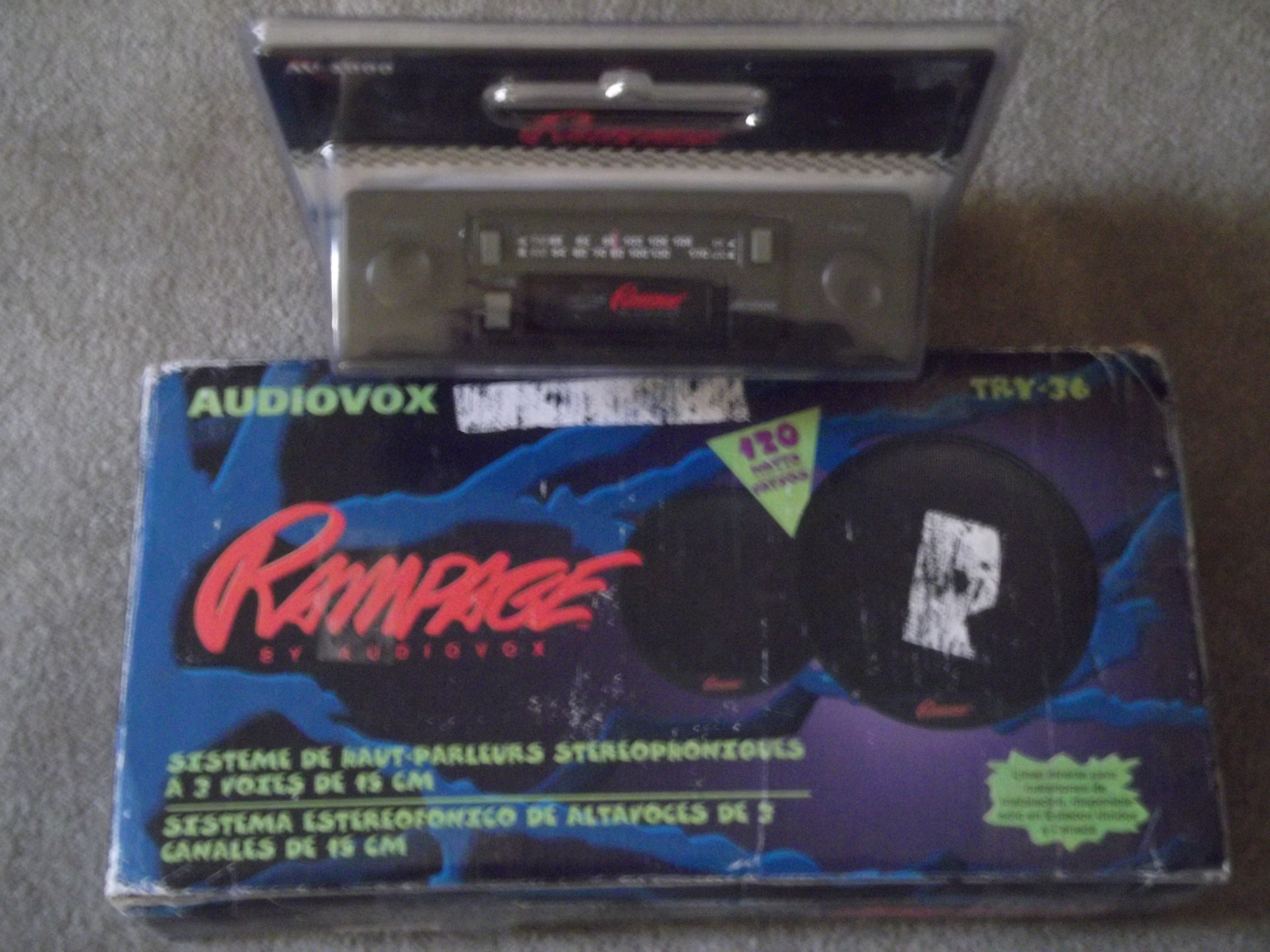

For anyone interested in the radio for your car there is one on ebay. VTG 1999 Rampage Audiovox AV-2000CS AM/FM Car Radio Stereo Cassette Player Current bid $30
Haha, some dude's going to get a bidding war on what he thinks is some random old cassette player. Will be fun to see what it fetches.
Here's the link for the lazy: Vtg 1999 Rampage Audiovox AV 2000CS Am FM Car Radio Stereo Cassette Player | eBay
There is a difference is between the actual model they use (AV2000) and this one. Buttons on the upper part are not there on this model. Its great if you want something close but its not perfect. I bet that guy is going to be like crap I should have put a reserve on it lol

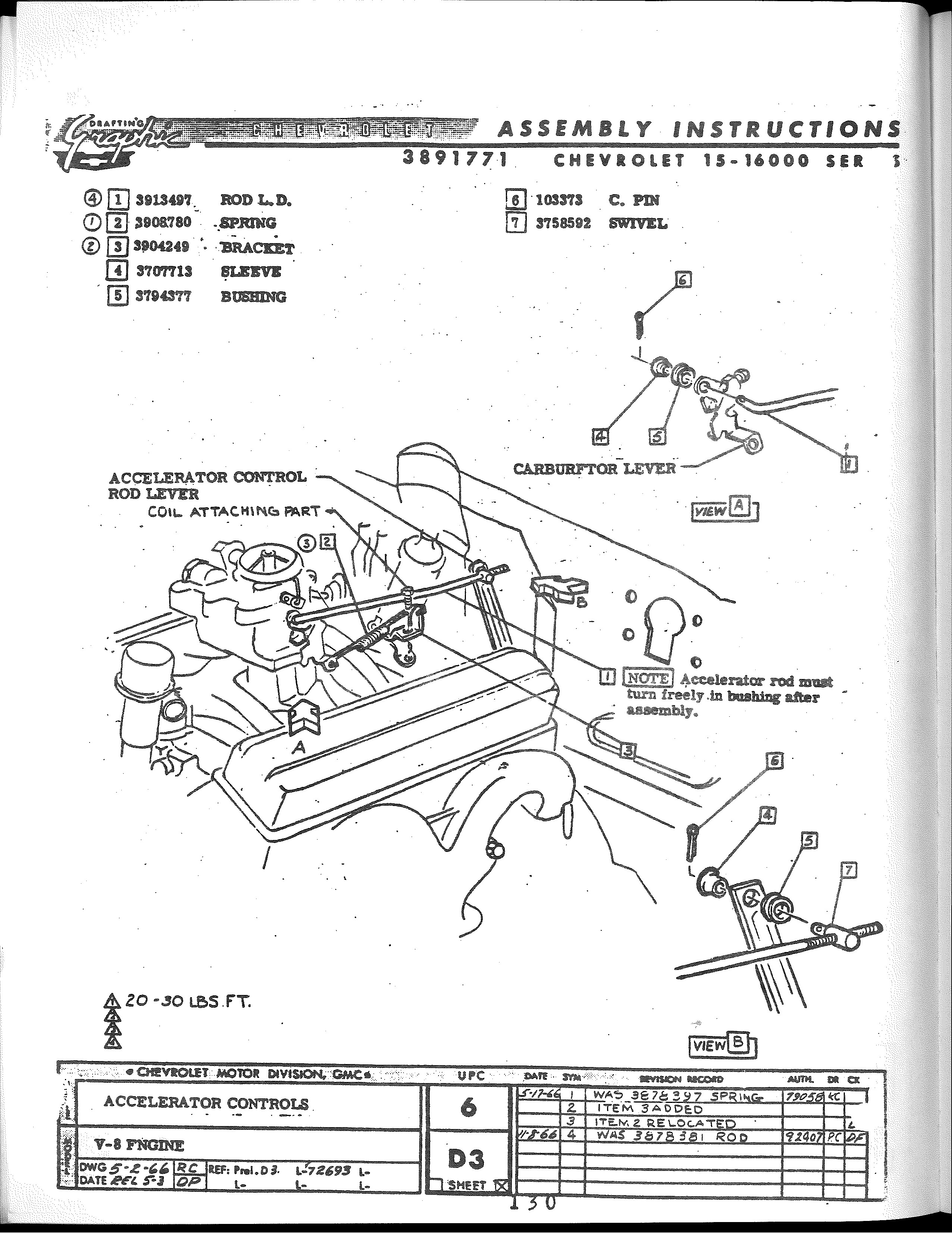

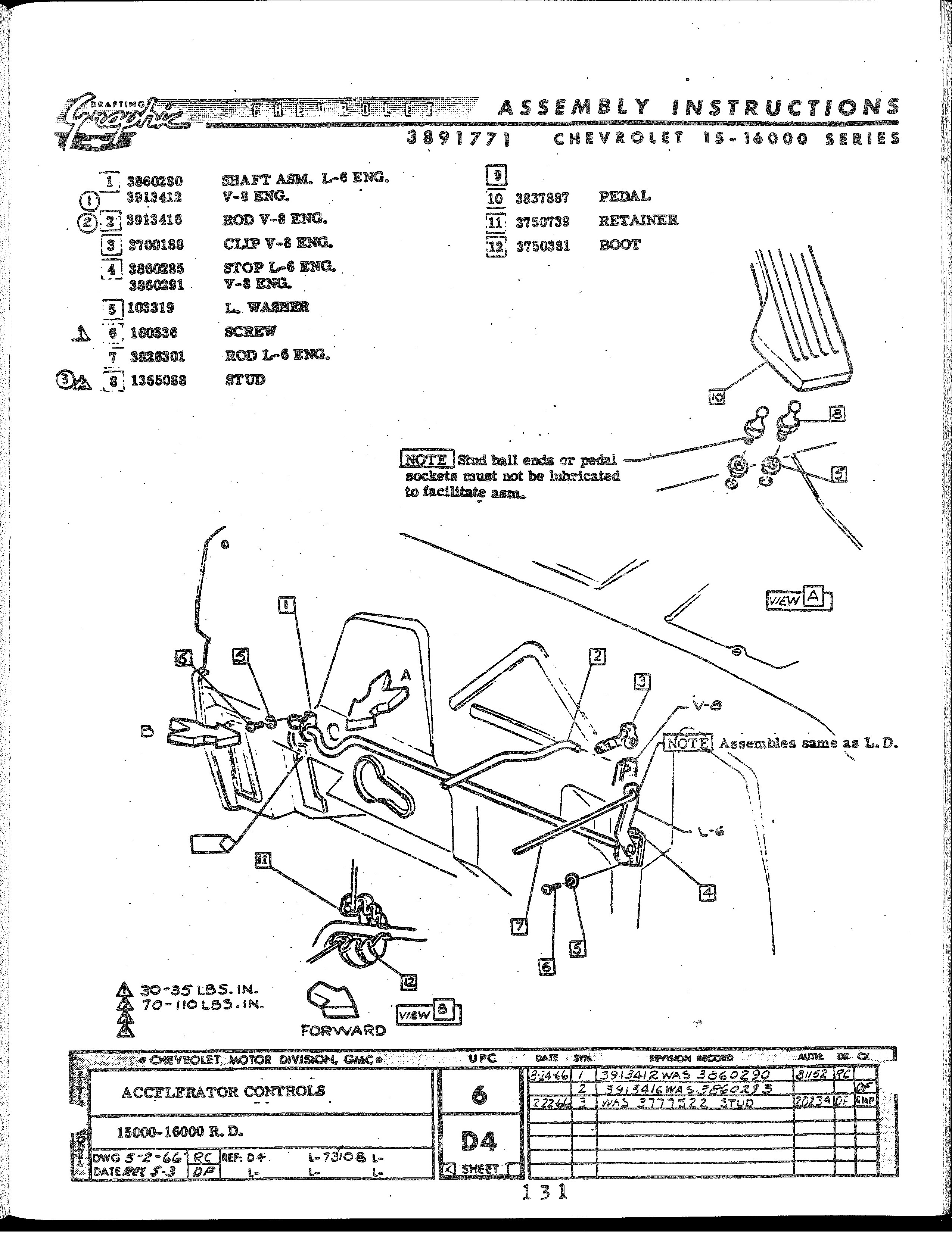

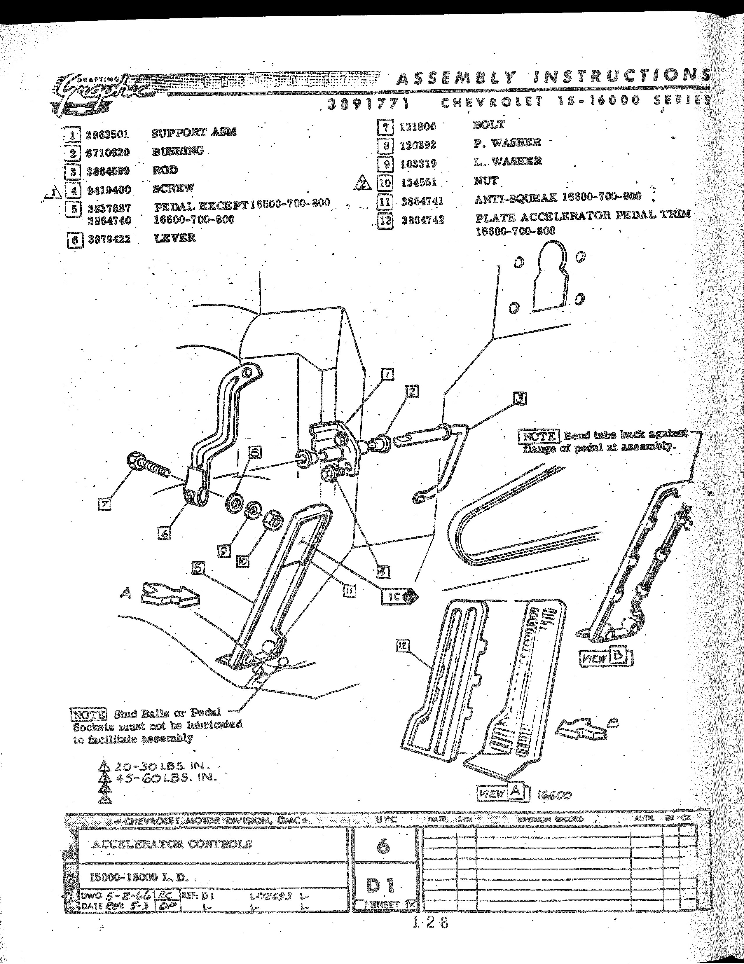

I've never had to adjusted my gas pedal. Maybe this will help. Maybe you could post a photo of the problem your having. Having a factory assembly instruction manual helps.
accelerator controls1.jpg accelerator controls2.jpg accelerator controls3.jpg
