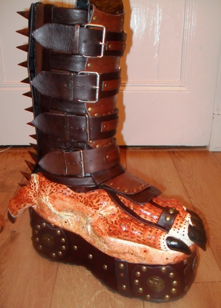

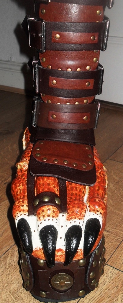

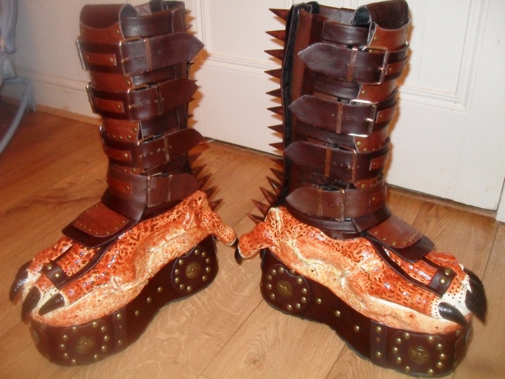

sulaco1967 said:
Yay..finally finished the feet....
It seems to have take forever to complete them, the worse part was working out how to get materials to bond to the PVC. I found out that by sanding it this gave a key to attach the leather etc. Once again thanks to Starbeast62 for skinning the back of his leather couch to use on this. The detail on the feet is mostly womens belts i found in local charity shops and I used antique upholstery pins for the rest. The spiked strip at the back is a collar i found at a local costume store and this is attached with velcro and hides the zip at the back. The straps at the side can be adjusted and this will allow my leg with the skin to fit securely inside once created.
I think they look very steampunk and would looove to get my hands on the steampunk bio. I think I will continue this theme on the rest of the armour.
Cheers thanks for looking..
Sean

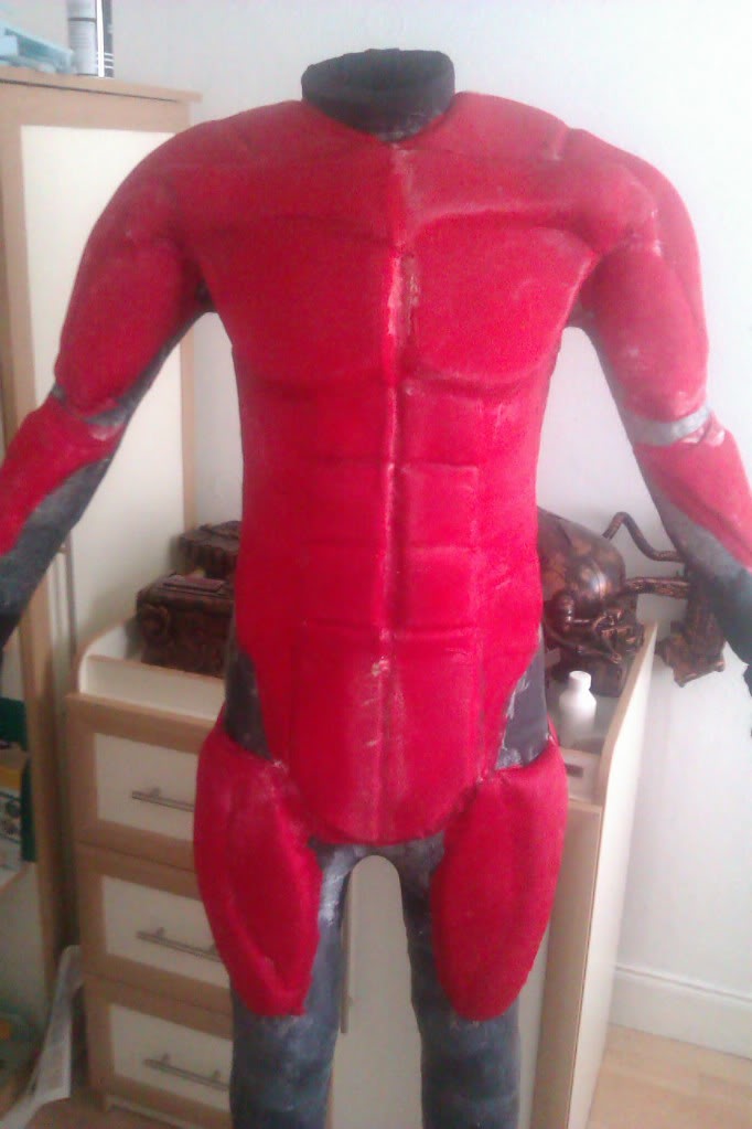

Well...had a few traumas today...
Okay..all the muscles are on and have not posted any pics as there is not much more to show..unless anyone wants some butt pics..lol
So over the last few days I have been applying layers of latex to the suit to encapsulate the foam.
I started the third layer and tried to use the HLVP gun with latex and tint. However the gun choked instantly. I had added the tint and maybe added to much..After cleaning out the gun I used a sponge to apply the latex (with the tint) and found that after a little while it was creating lumps.
Persevered and think I was not getting the consistency right.
So I left the latex to cure and am finding that the foam has a really rough texture and will basicly look like S##t once painted.
Am so kicking myself..I wish I had covered the foam in cloth and then latexed...
I plan to cut up a Mr I suit tomorrow and apply to muscles areas...
The joys...lol...
Sean

Well bit of progress..I cut up a Mr I suit I had lying about and jigsawed the pieces of fabric onto the foam muscles.  It's a lot better than it was and I feel a bit more confident that the suit is not totaly ruined.
It,s not perfect however paint and armour will hopefully cover up the imperfections.
Cheers
Sean

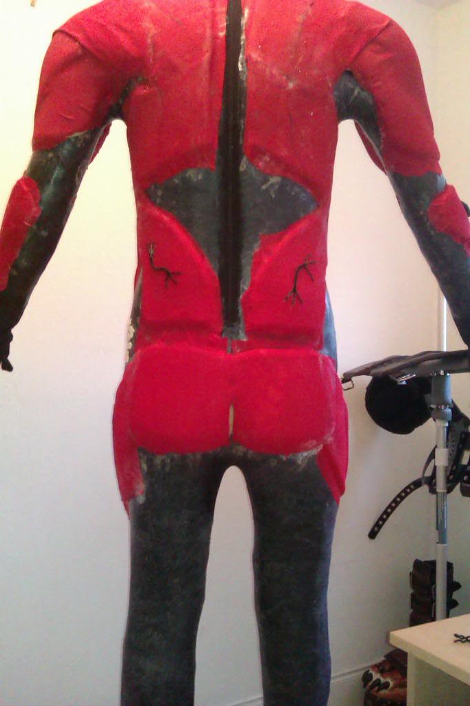

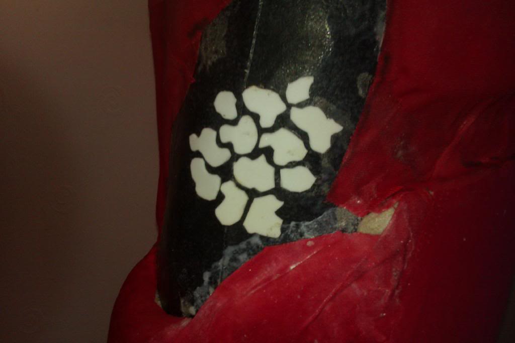

Thanks for the comments Micah and for the tips regarding the brushes and ammonia...nice 1.  I plan on using a belt with loincloth around the hips so hopefully it will look ok.  I wanted to leave some area free from foam and plan to put texture on using foamies to create a reptile looking skin on these areas (pic below) and have posted a pic of the back as you requested.

I just sprayed the foam with spray adhesive and it worked a treat.  Very tricky to get it to shape around the muscles though Steve.

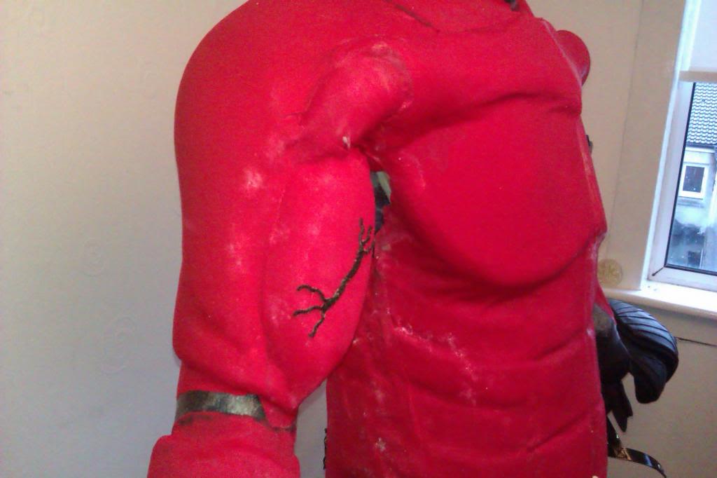

So today I added some veins, using the same technique I used on the feet.  I also created a bellybutton.  I made this from a balloon, I blew it up, tied it and then cut off the top and voila one ready made rubber bellybutton..lol.
