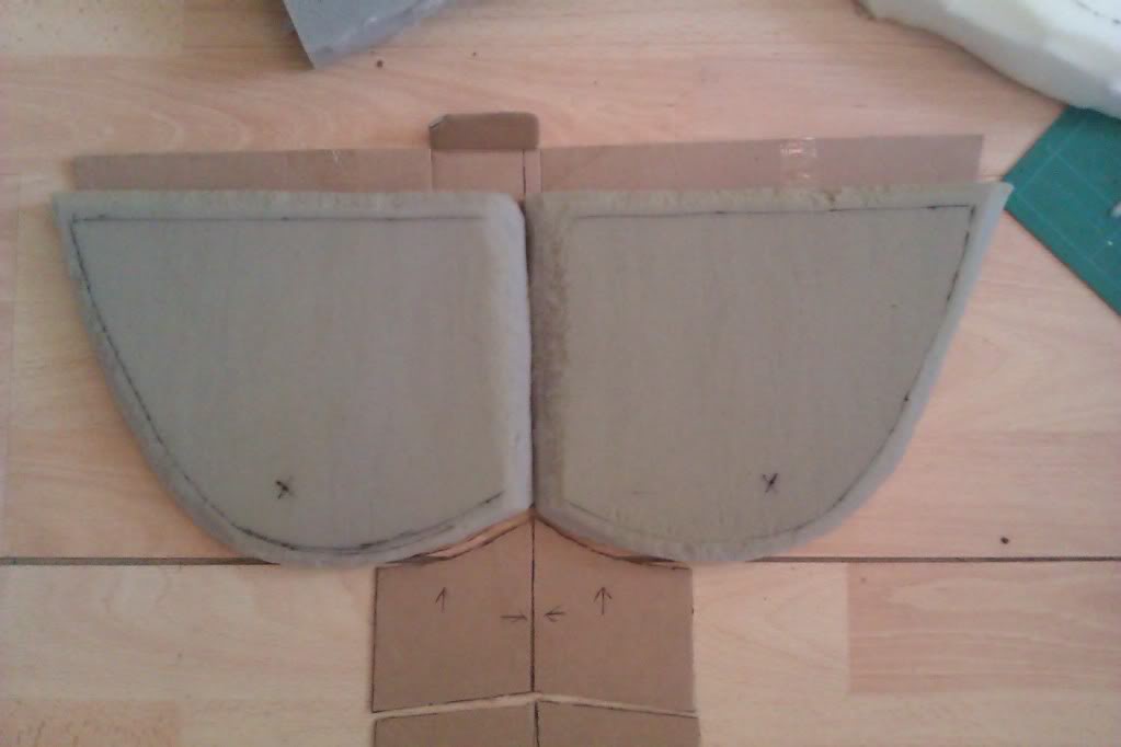

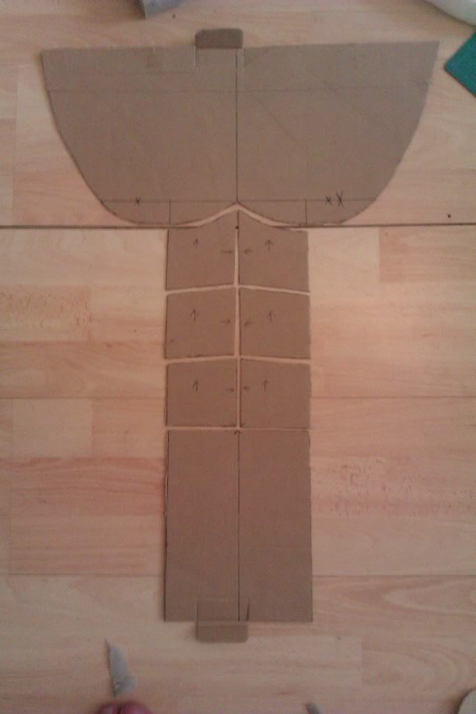

Well have had a wee bit of progress Brian. I have spent the last few days trying to create templates for the muscles to cut out the upholstery foam.
The main problem has been that now I have the morph suit on the duct tape dummy stand it is difficult to get accurate mesurements of where the muscles should be in relation to my body. I don't want to finish the suit and find that the pects/six pack are not in line with my own body proportions, just woudn't look right.
So I taped some sheets of paper together and stuck them to my skin and marked out where my nipples, bellybutton and where my pects and six pack were, if I had them lol. This was a task in itself as I had to try and push out the little muscles I have and take meseurments.
So template made and after the input of 'starbeast62' I decided to go for it. I transferred the paper template too cardboard.
I then cut out the pects roughly..
Working the foam is not easy, it rips very easy and does not produce a smooth finish. Plan to soak the piece in water and freeze then sand, have had mixed results with this, getting a loan of a rotary sander to try that.

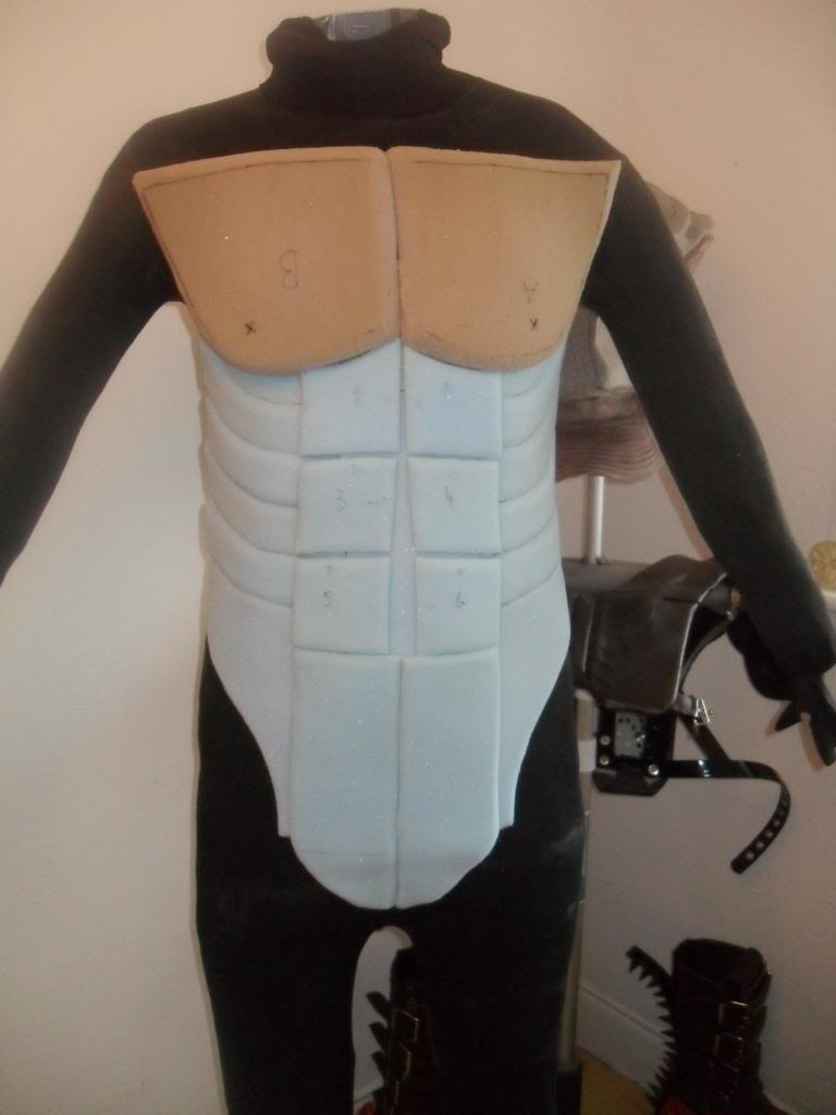

Have made a bit of progress with the muscles...
Freezing the foam is fantastic to get proper smooth rounded edges.  Some of the pieces of foam required to be soaked about three times to become totally solid.
I messed up a couple of times getting the shapes for the arm muscles, however I think I'm on the right track now and am waiting on a piece freezing as I write.

This is looking really good there Sean! I am very interested to see how this turnes out. Maybe you are the Willy Wonka of frozen foam shaping... ;) Keep at it good sir.
Steve
lol...thanks Steve, got to admit it is very satisfying carving and sanding the foam, I had a little production line going on in the freezer. Good job we have two lol...
