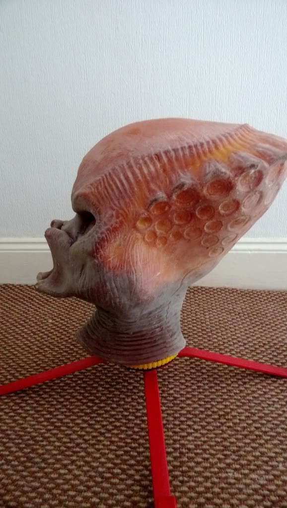

Thanks Lflank I think it looks really cool.  It was a bonus that the Bio was custom made to fit the mask I purchased from the same seller.  Was kinda worried that if buying pieces separately, they would not fit together.

Thanks Brian here is a picture of my mask.  As mentioned above the bio and mask are custom made to fit like a glove.
The dreads and rings were bought from a UK based seller..

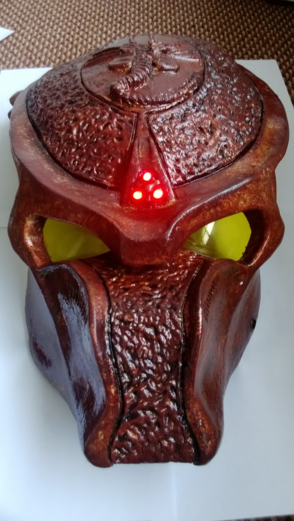

Well i'm calling the bio done..
I used tinted  safety glasses for the lenses and built up the inside of the eyes with 'Milliput'  to give them some more purchase to stick.  The LED's were a nightmare, it's only the second time I have tried soldering and it was really fiddly, however after a lot of swearing I managed to cobble them together.  The Paint was sealed with three layers of Yaught Varnish.
Very pleased with how it turned out.  Soooo.. just the hands, skin and mask to paint and that wlll be me more or less finished,,,yipee..

Top notch Sean, very well done.  I like the yellow lenses, and the paint is superb!  I'm excited to see this done!  You see that light?  The one at the end of the tunnel?  You're not far from it at all!
Brian
Damn, i haven't seen this thread in a while. Great job on the layering effects on that bio, great colour scheme with an excellent result.
Thanks for the comments Brian and Mark I'm glad you like. I felt the bio would have looked out of sorts with the rest of the build if I had made it any other colour. I was hoping to start on the hands today however I have had the motivation of a carrot and lazed about watching Dr Who.lol.
