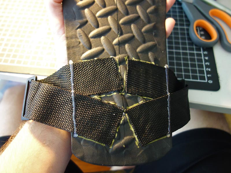

I will mount a number of straps on the rear, but where possible I try to insert a small cut in the armour and slip the straps through from the front to the back and then glue on the back/inside. On occasion some straps can be sandwiched between the layers within the armour as that provides strength and protects the straps (ensuring greater longevity).

The 2 metal clips on the front of my body armour have their webbing sandwiched between the backing and the armour plates. The back piece wasn't sandwiched - just hot glued onto the back of the backing.
Beads of hotglue where the strapping might be under stress is also a useful thing (a tip I picked up from Punished Props).
All of these strapping points have held up quite well.
