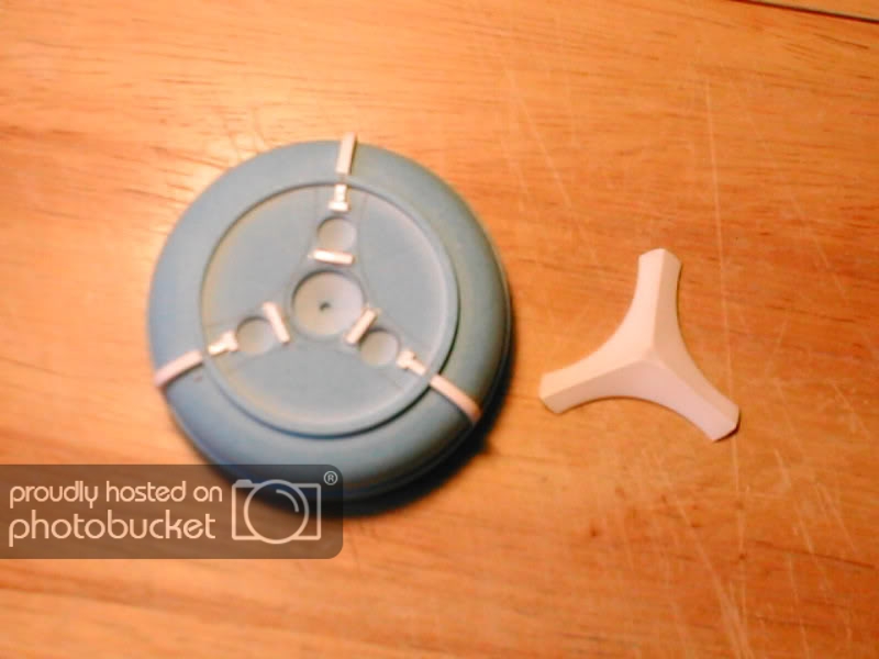

The Forbidden Planet end cap I made. The blue part has white strip styrene bent around the curve. The white 3 pointed part is carved styrene.

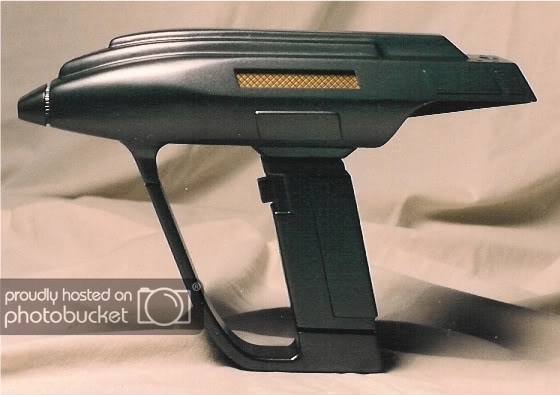

This whole Romulan gun I made is entirely made of styrene.

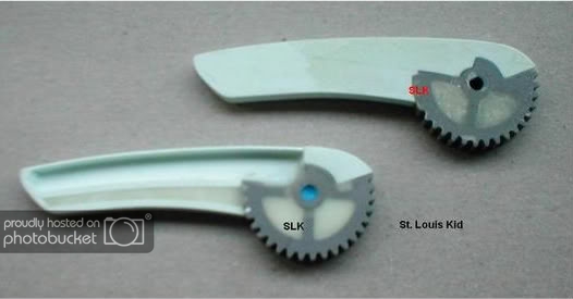

My PKE wing master patter in styrene with geared bits in ABS.
My Forbidden Planet insignia master pattern before completion in styrene.

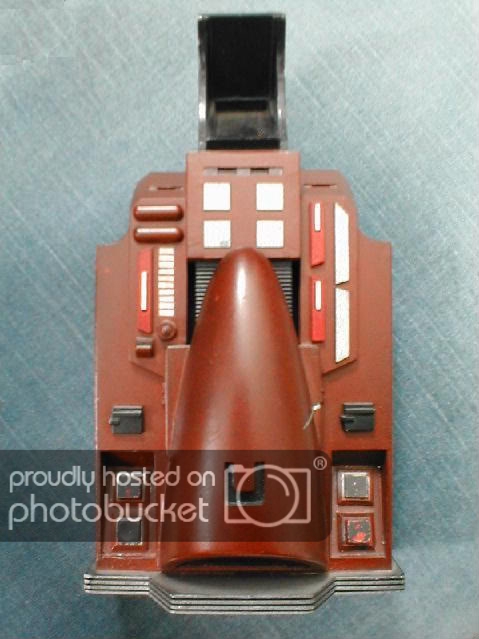

Scratch built Klingon Tricorder I made back in the late '80's based on the concept artwork...made entirely of styrene.
