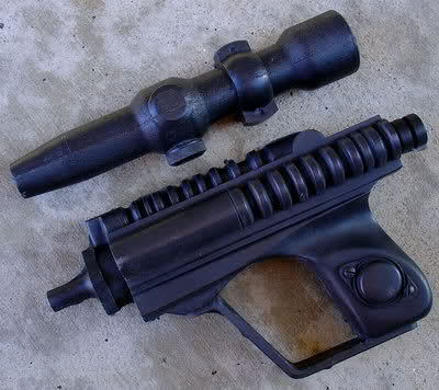

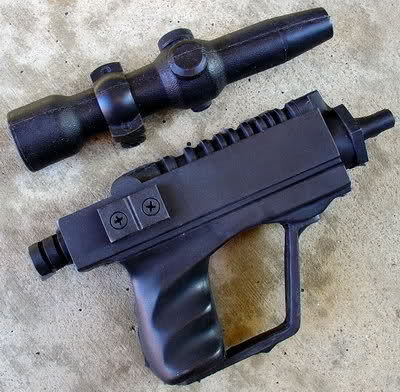

Cris of Kim and Cris fame fabricated a master, I helped mold it and it was offered up in hyperfirm a couple years back. Wasnt a big seller but this was the hyperfirm version...
