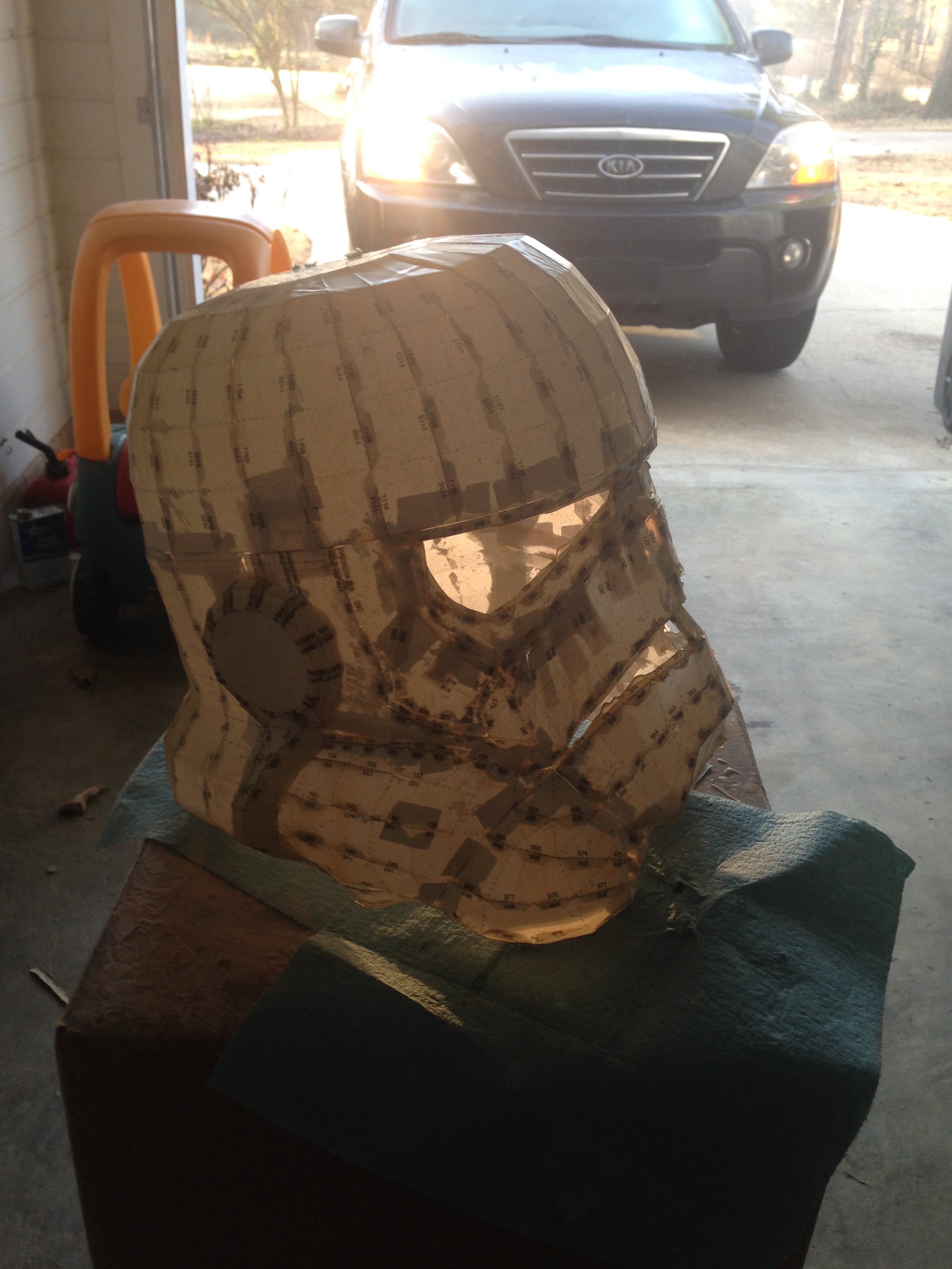

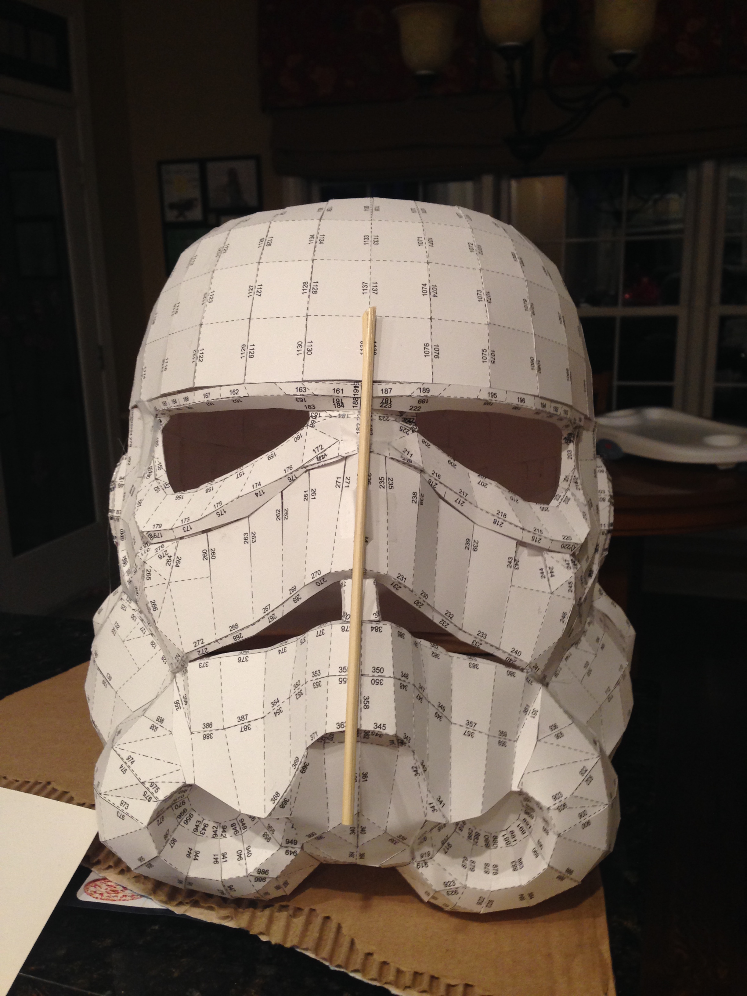

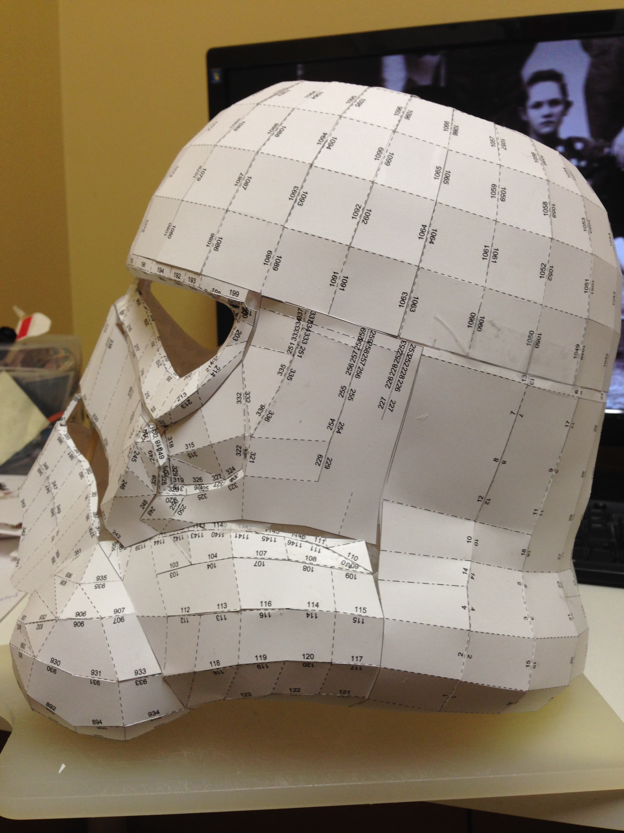

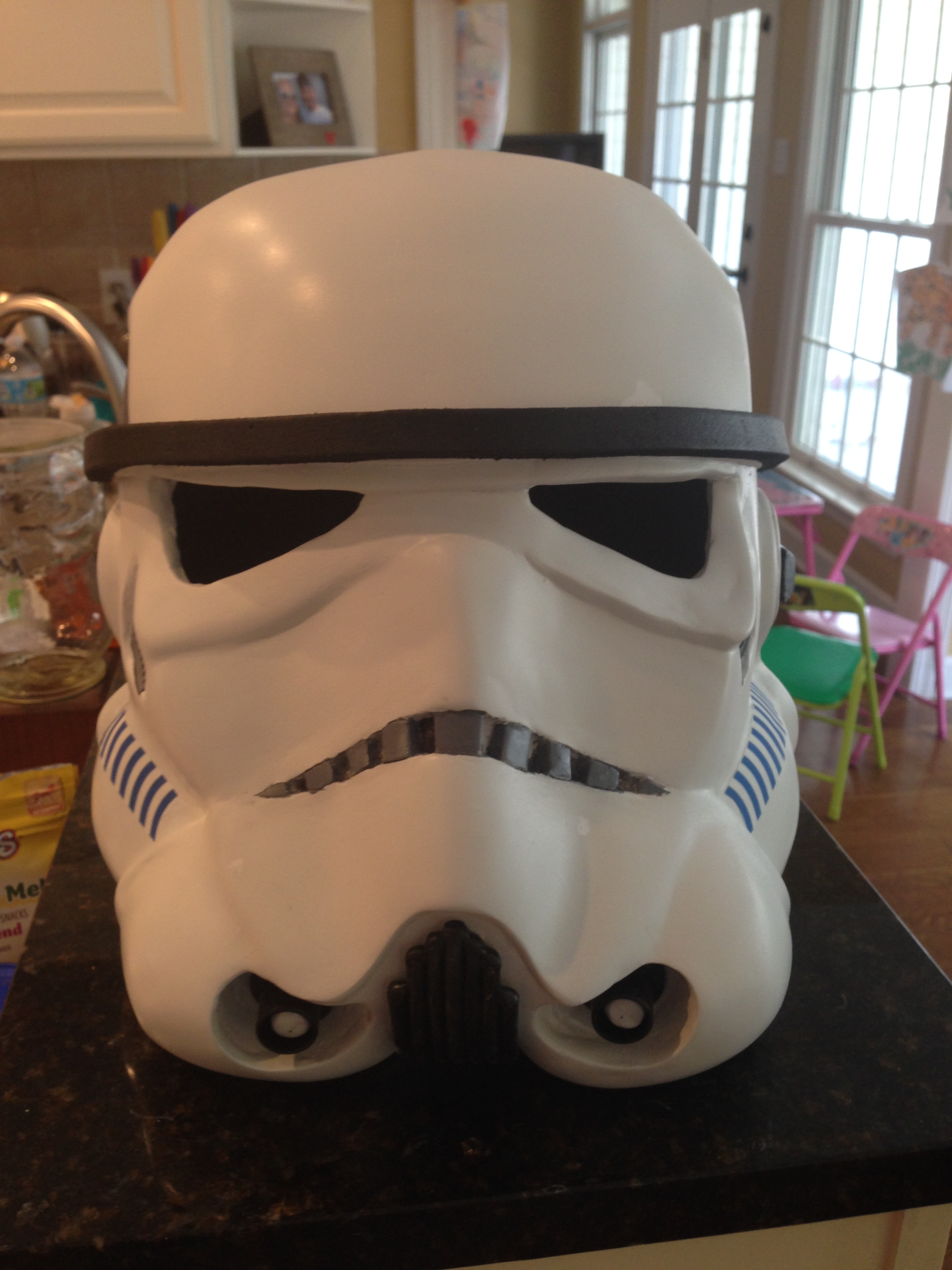

Long time visitor, first time poster (except the introduction thread). I recently started trying my hand at Pep building and probably started with a harder one than I should have. I waited until I had gotten far enough along to know I wouldn't quit at it before I posted, so I thought I'd share here.
The pep file I used was from Space Cowboy, thanks to him for providing it.
More pics coming... The main reason I'm posting is the hope that it will help someone else who attempts this build in the future. I know I learned a lot from Terra and other threads. I also may have questions in the future and I'd like to get my name on here. Any comments or suggestions welcome!
I have learned a lot just by diving in. Mostly, that it was more expensive than I thought when you don't have any of the supplies to start with! I'm loving it though. More pics to follow...

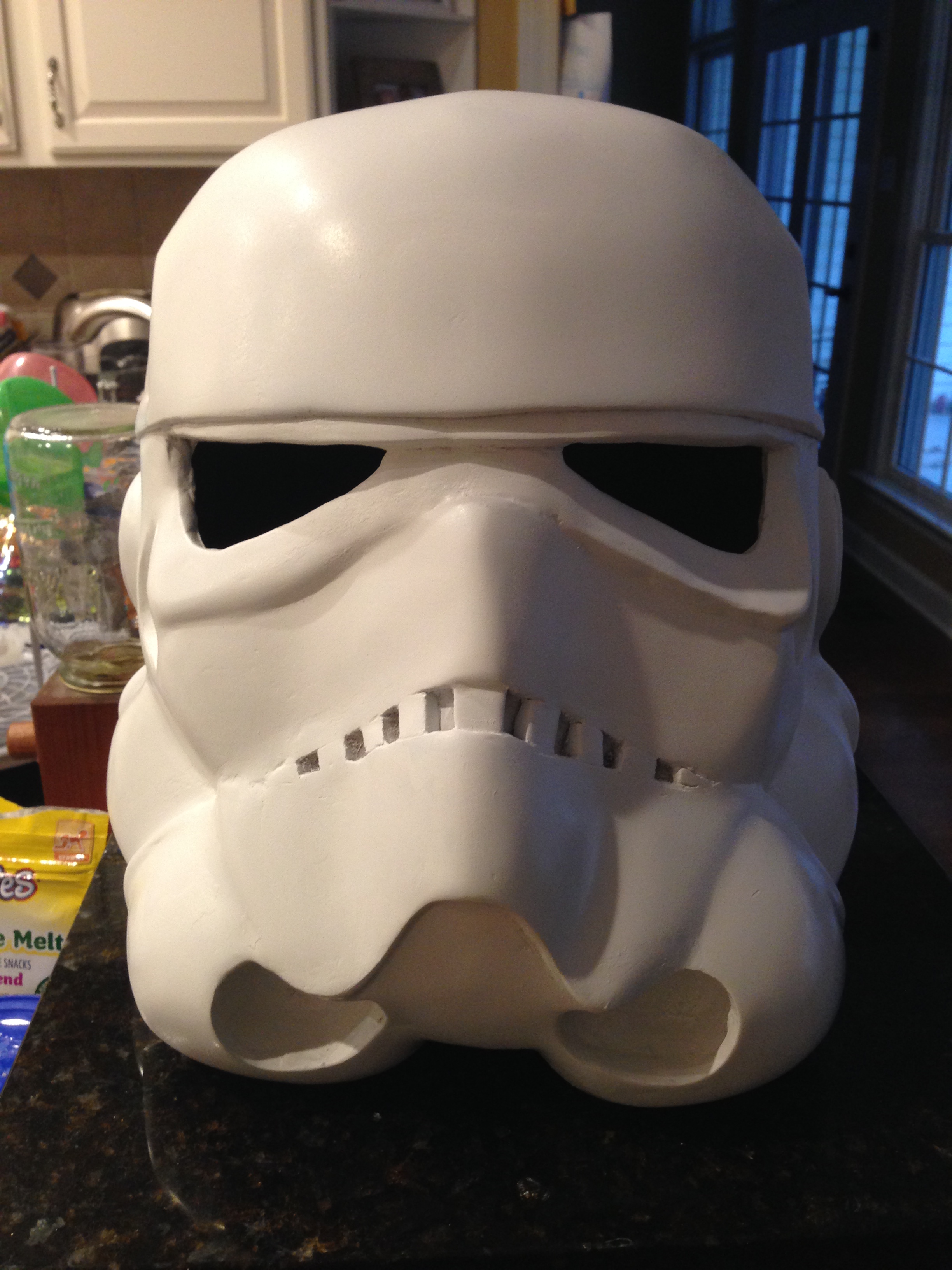

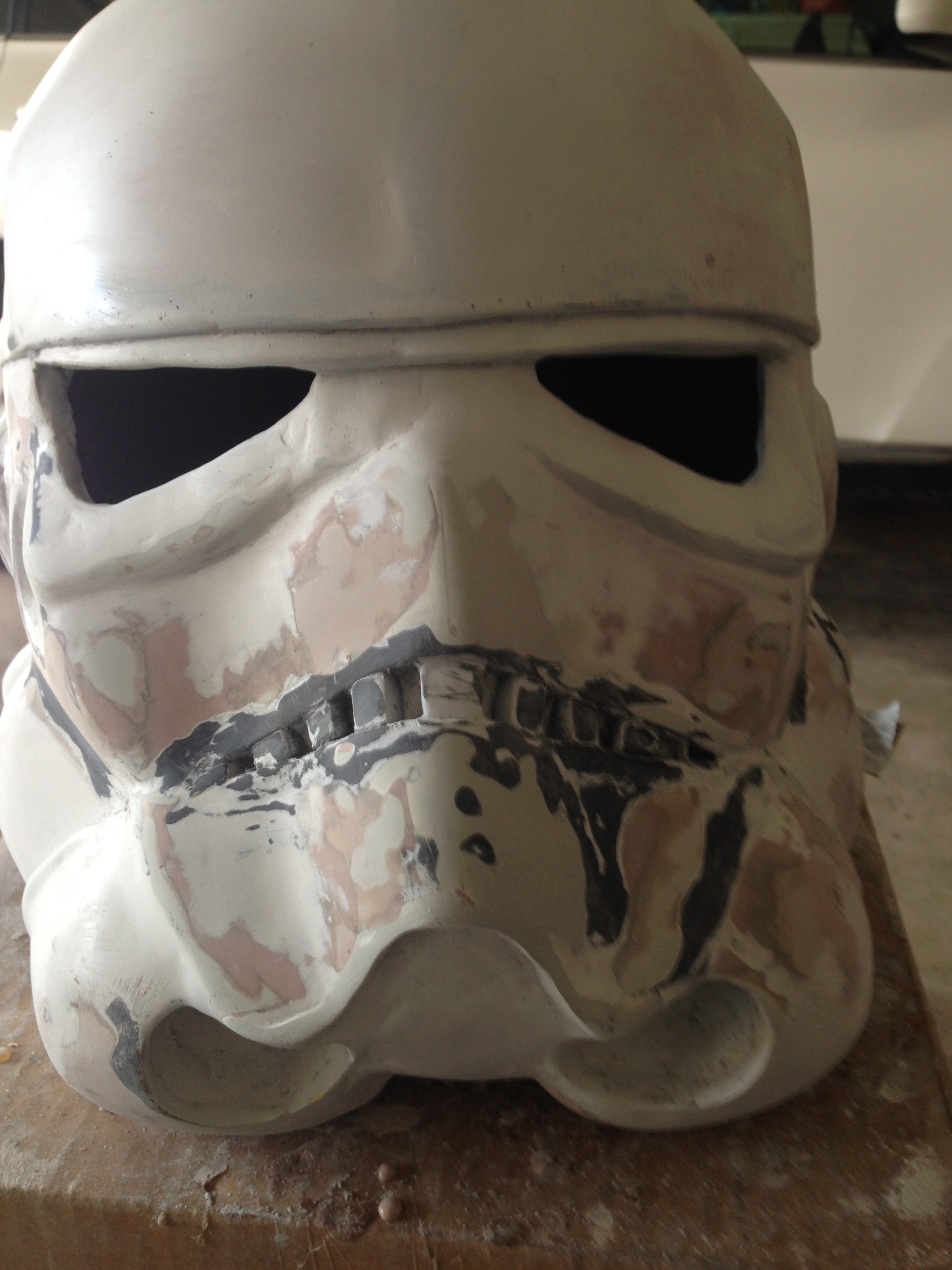

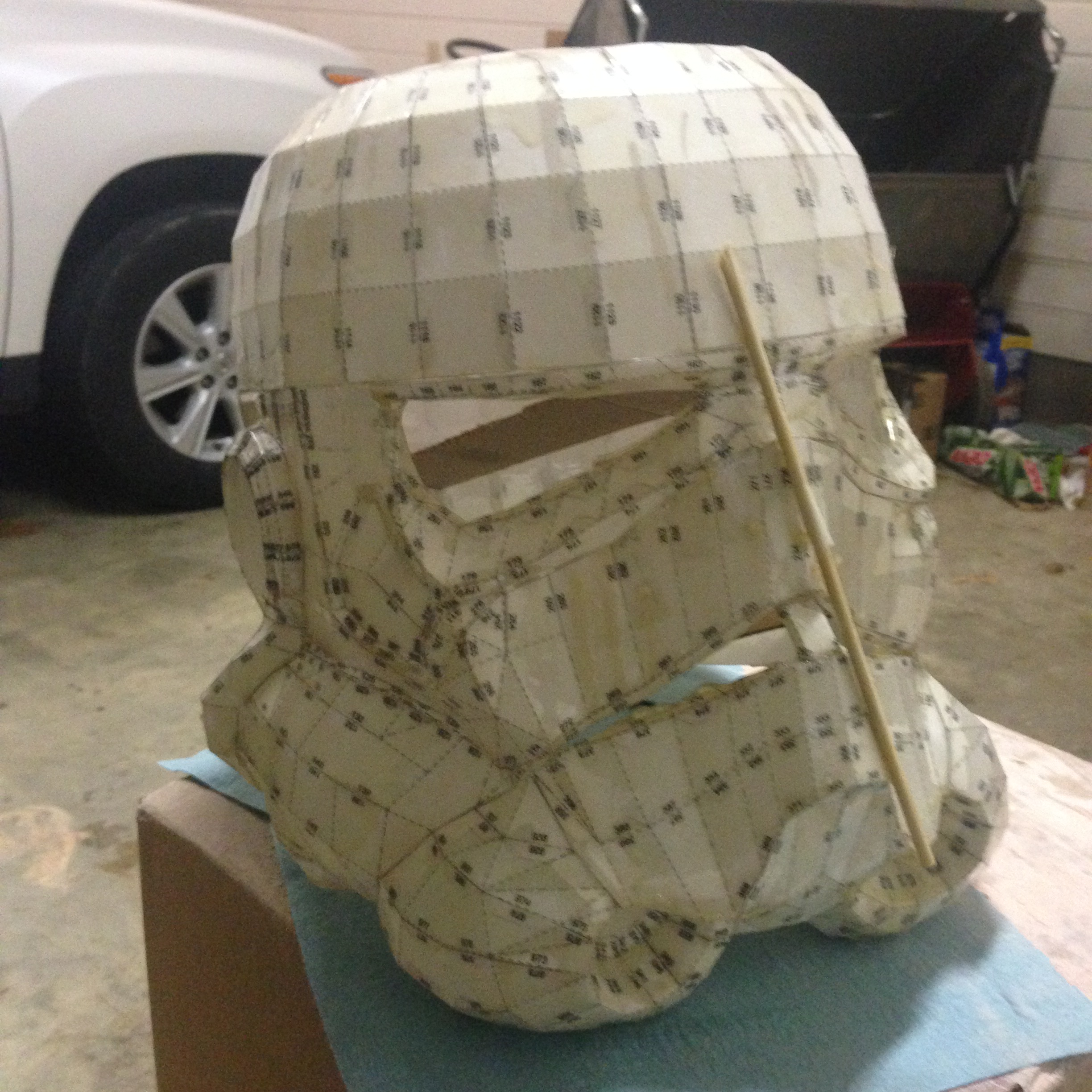

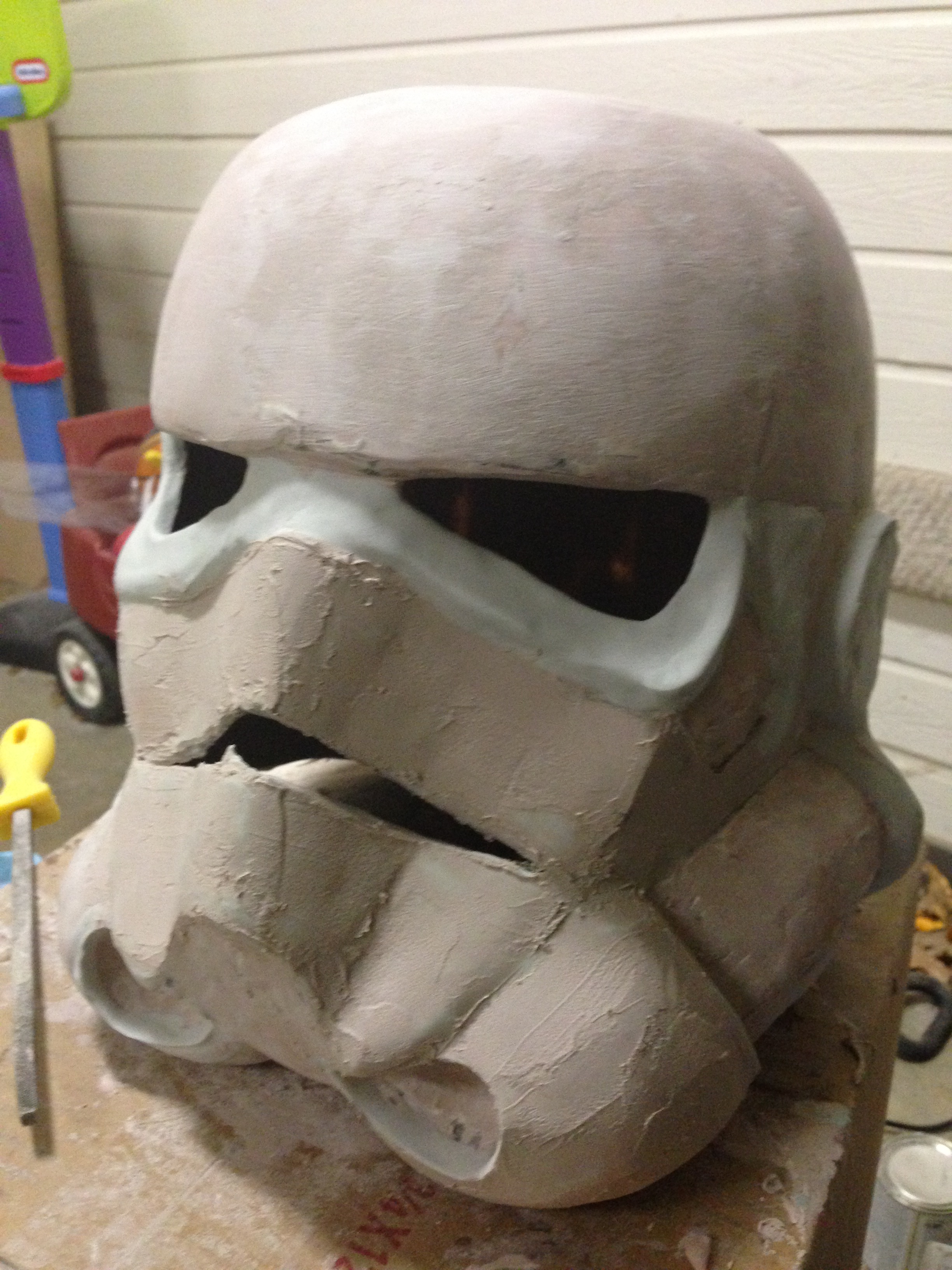

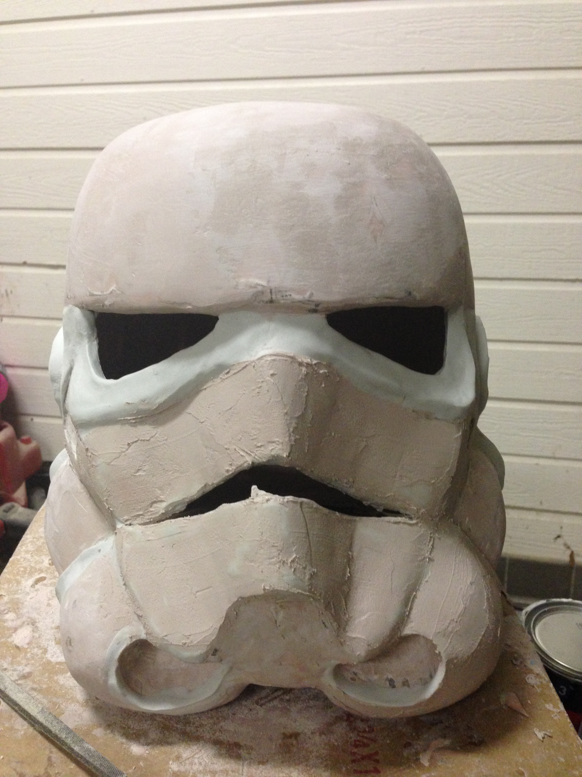

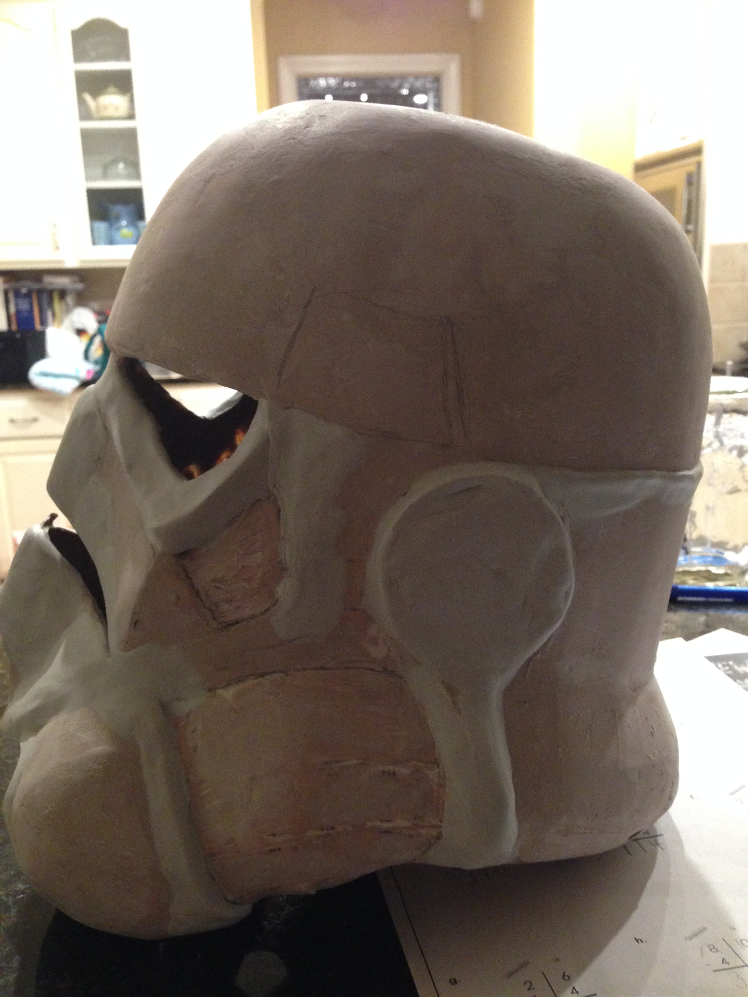

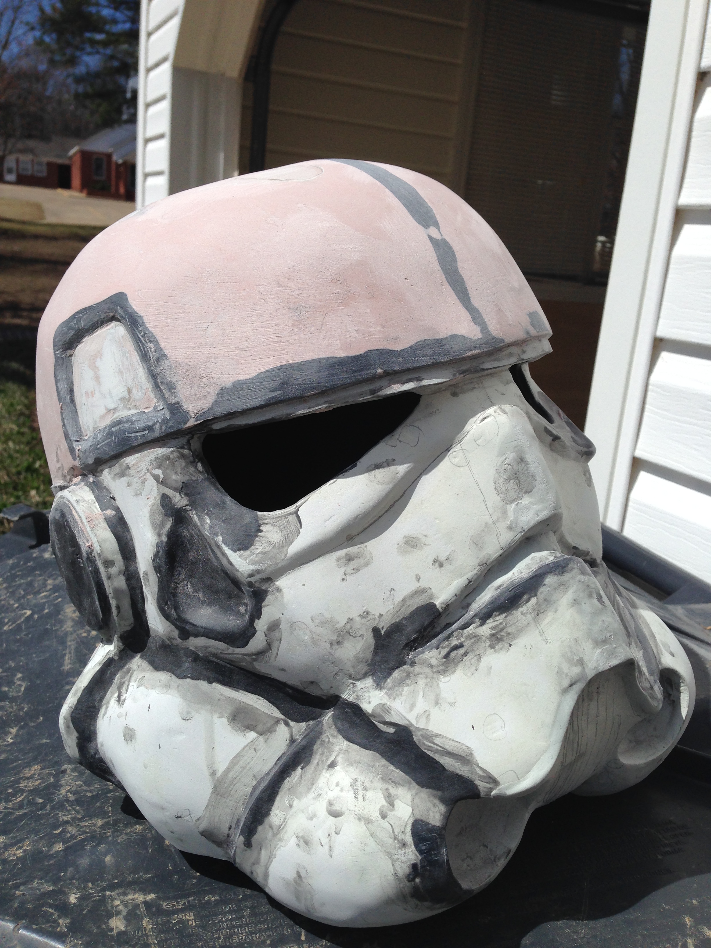

Here's where I am currently. Even though it doesn't look like it, it's getting very smooth with all the sanding. I still have some spots to fix and smooth out but I'll probably throw a coat of primer on it soon to find all the small holes and start with the spot putty.

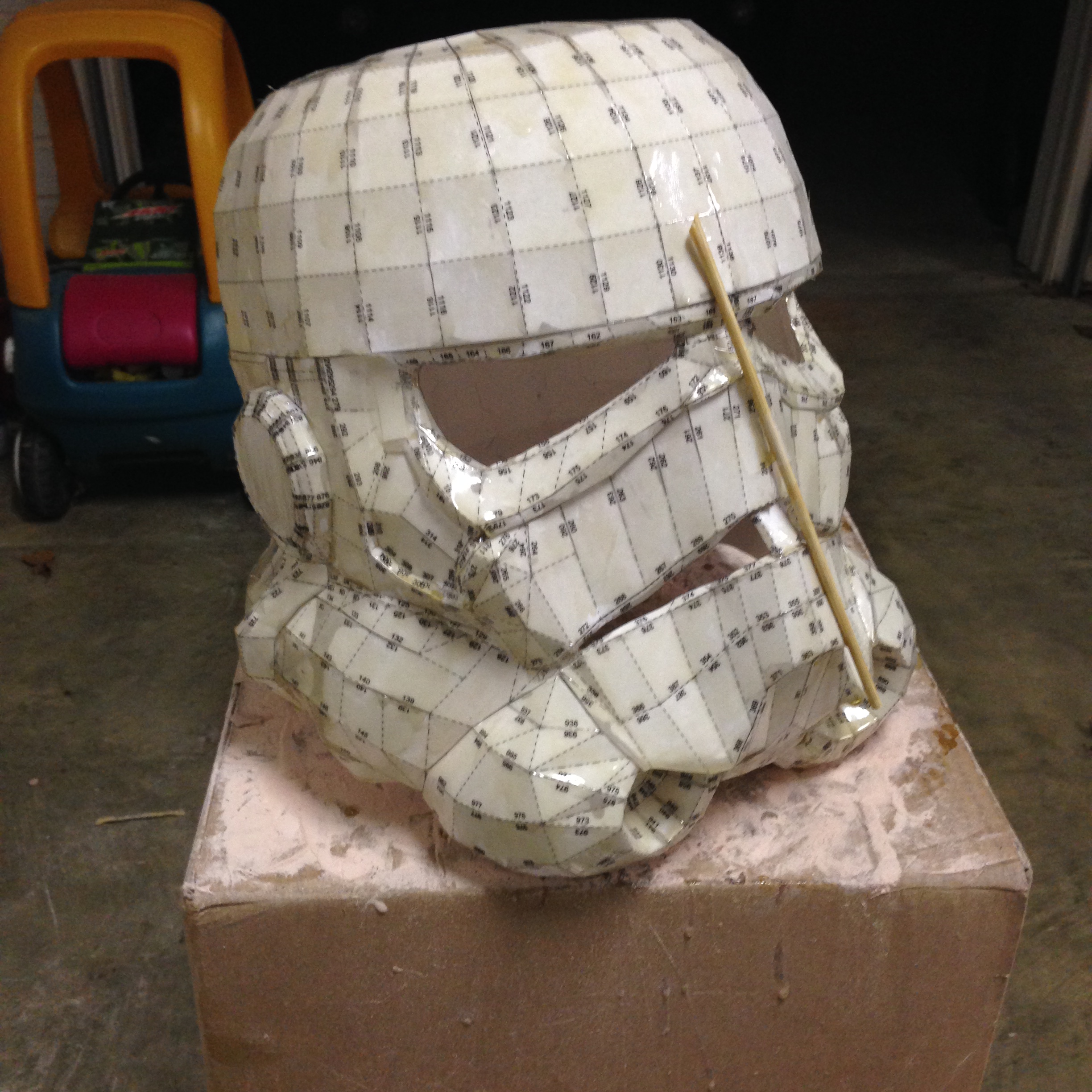

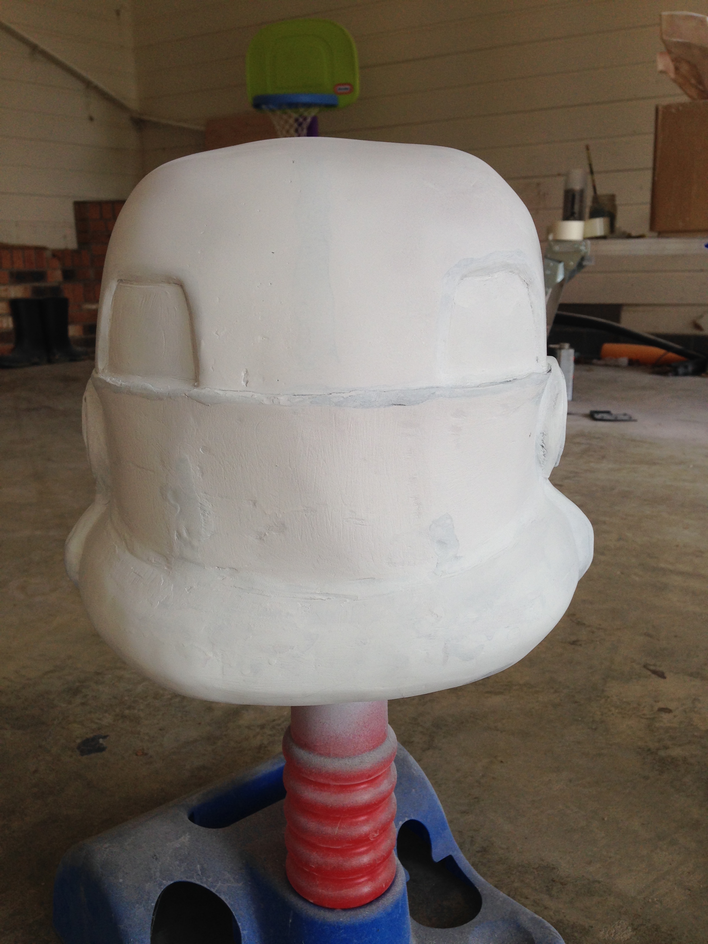

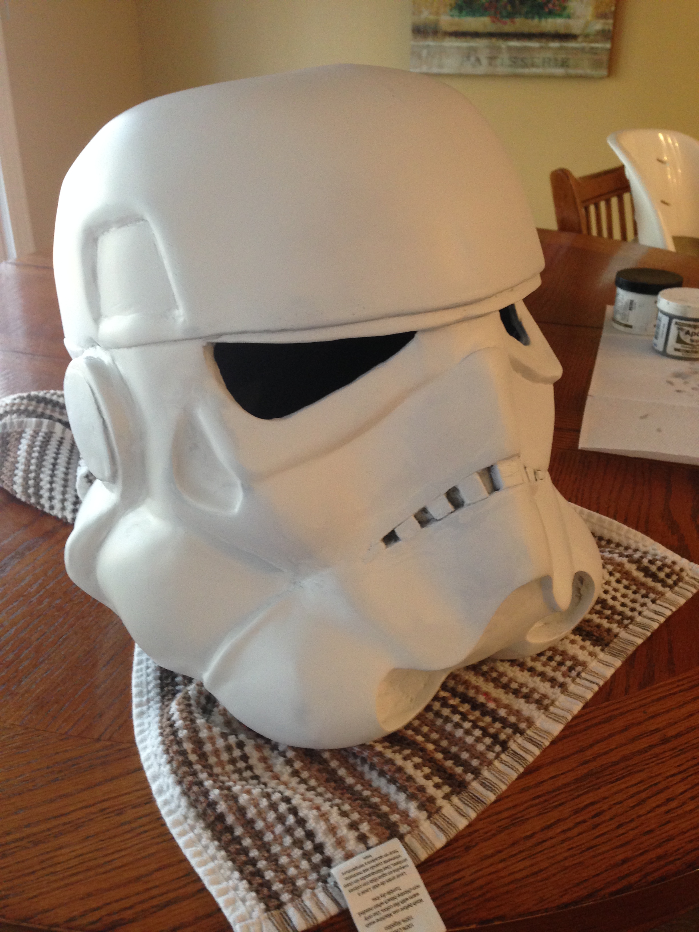

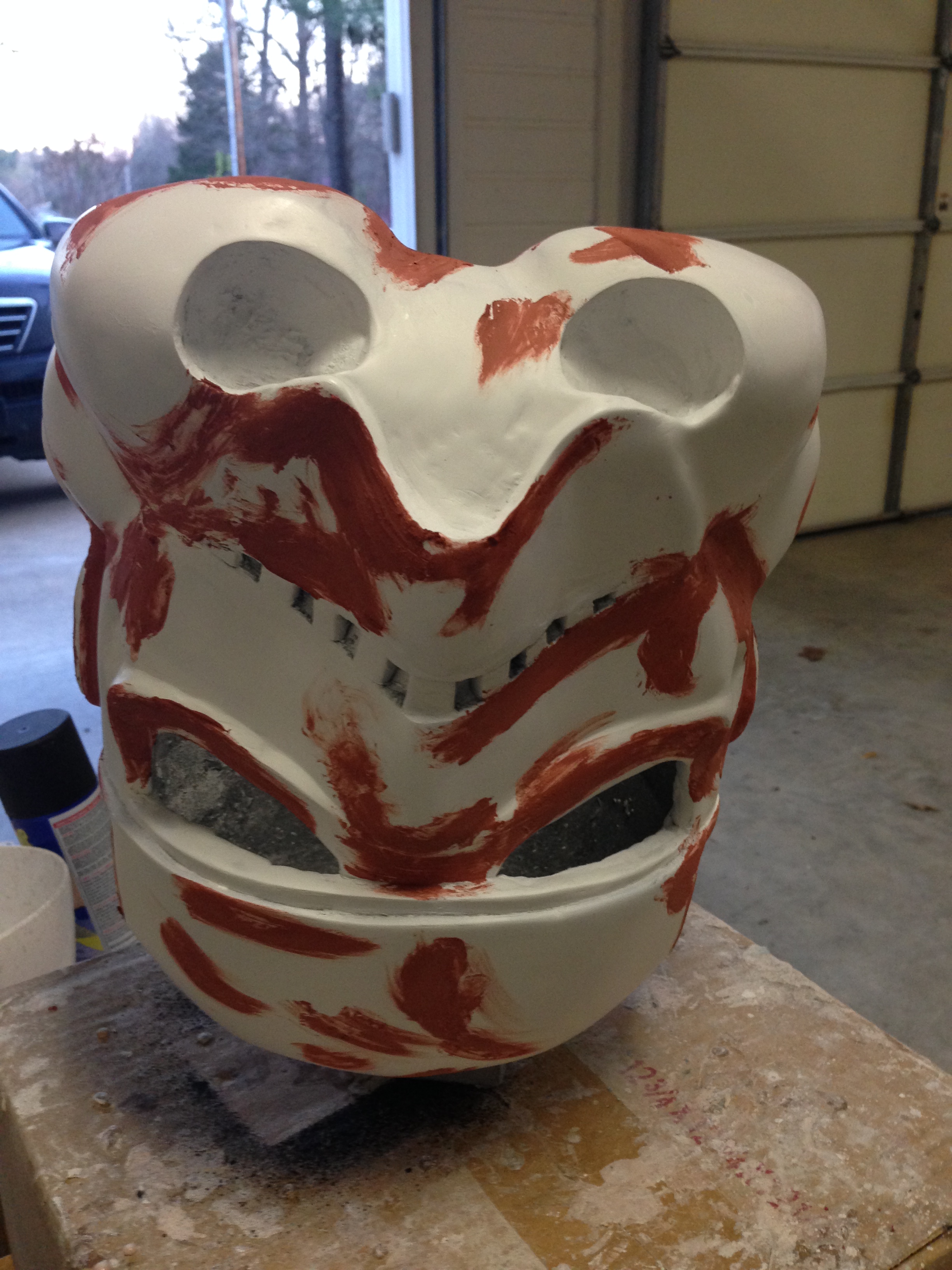

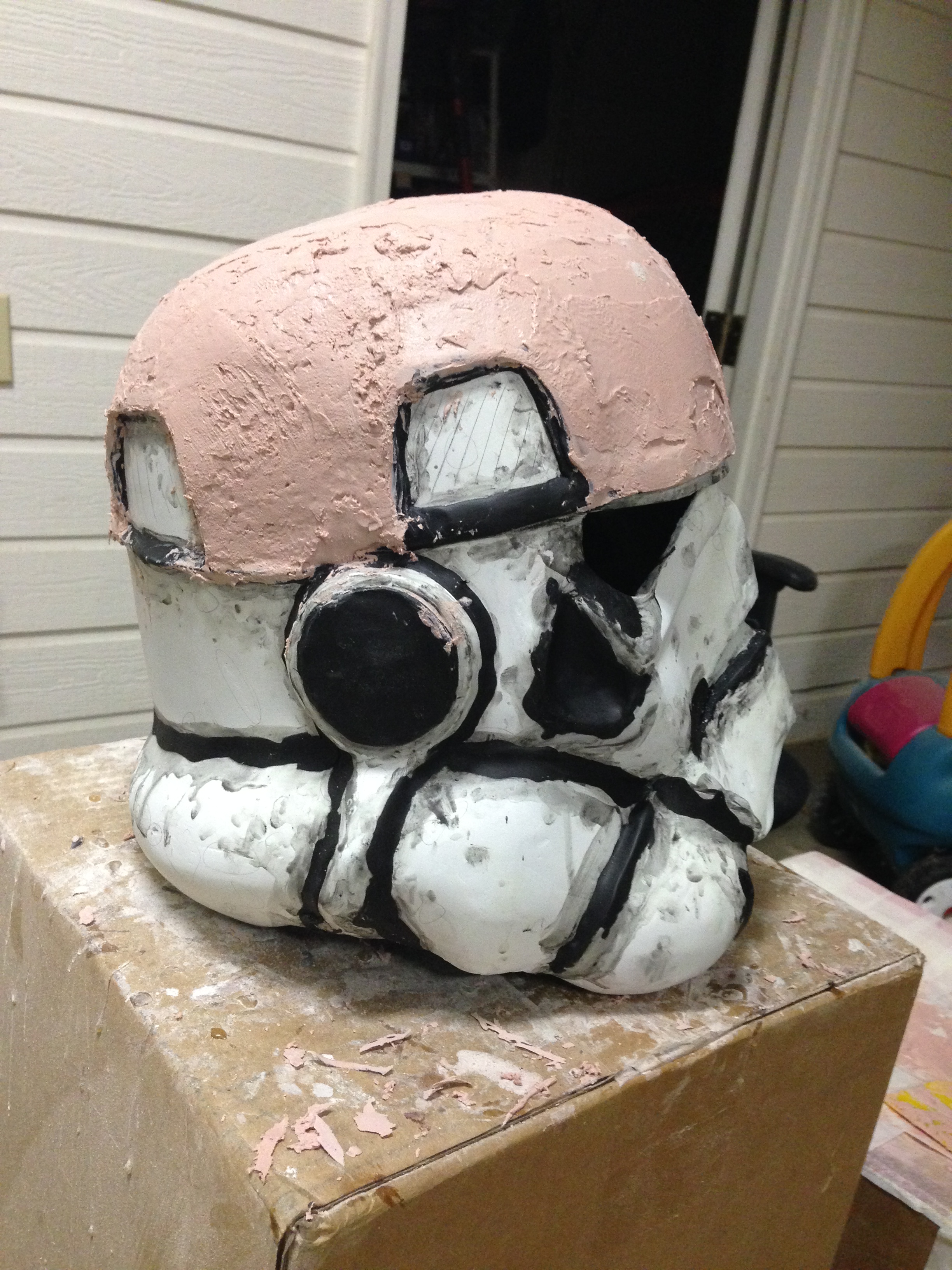

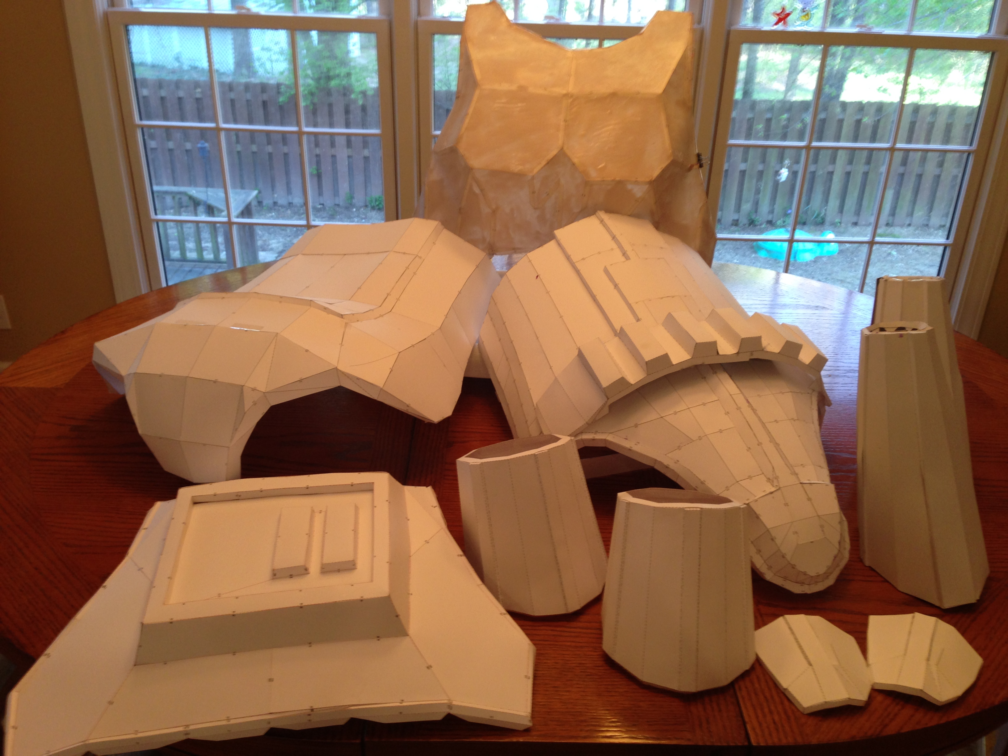

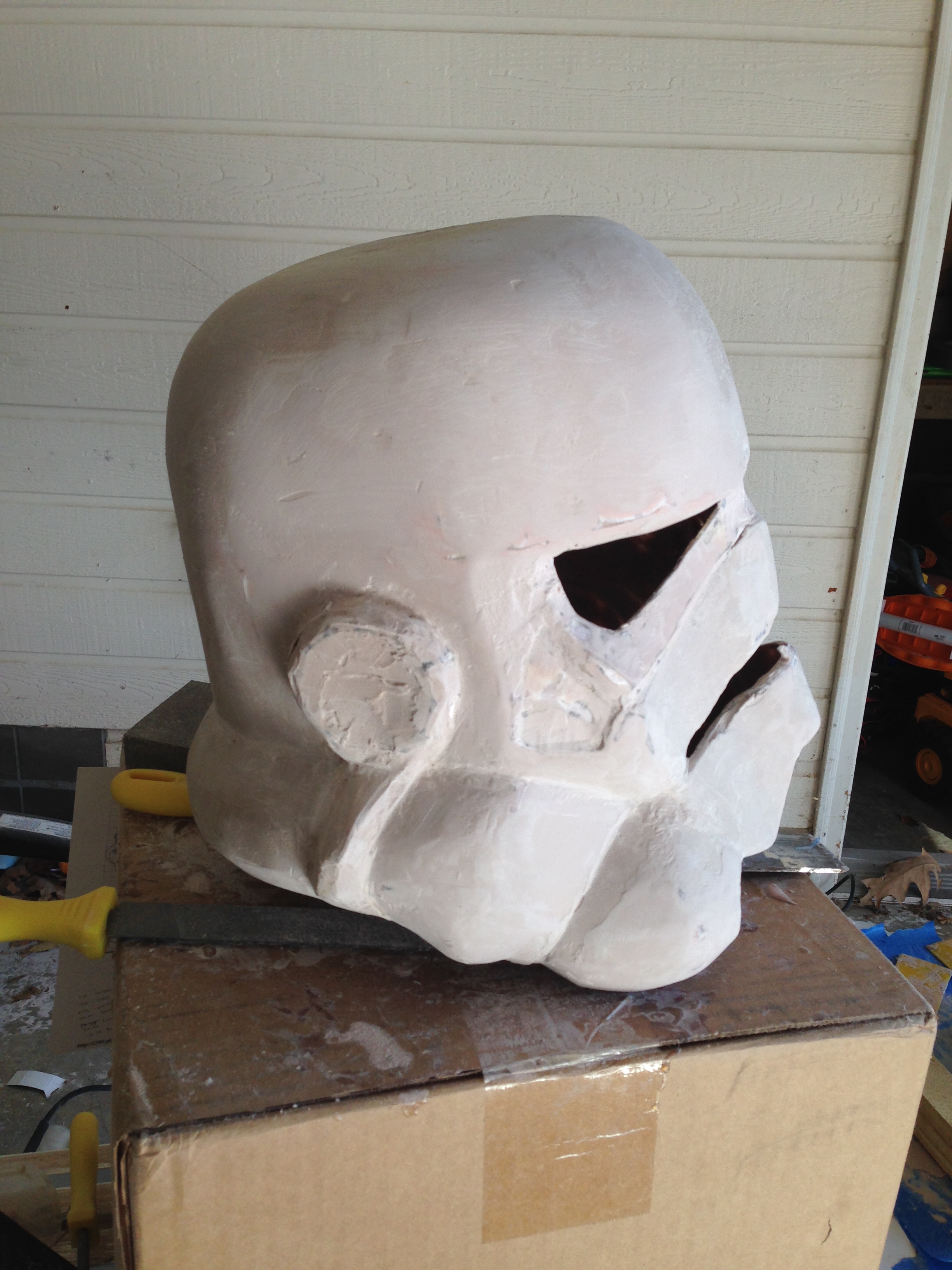

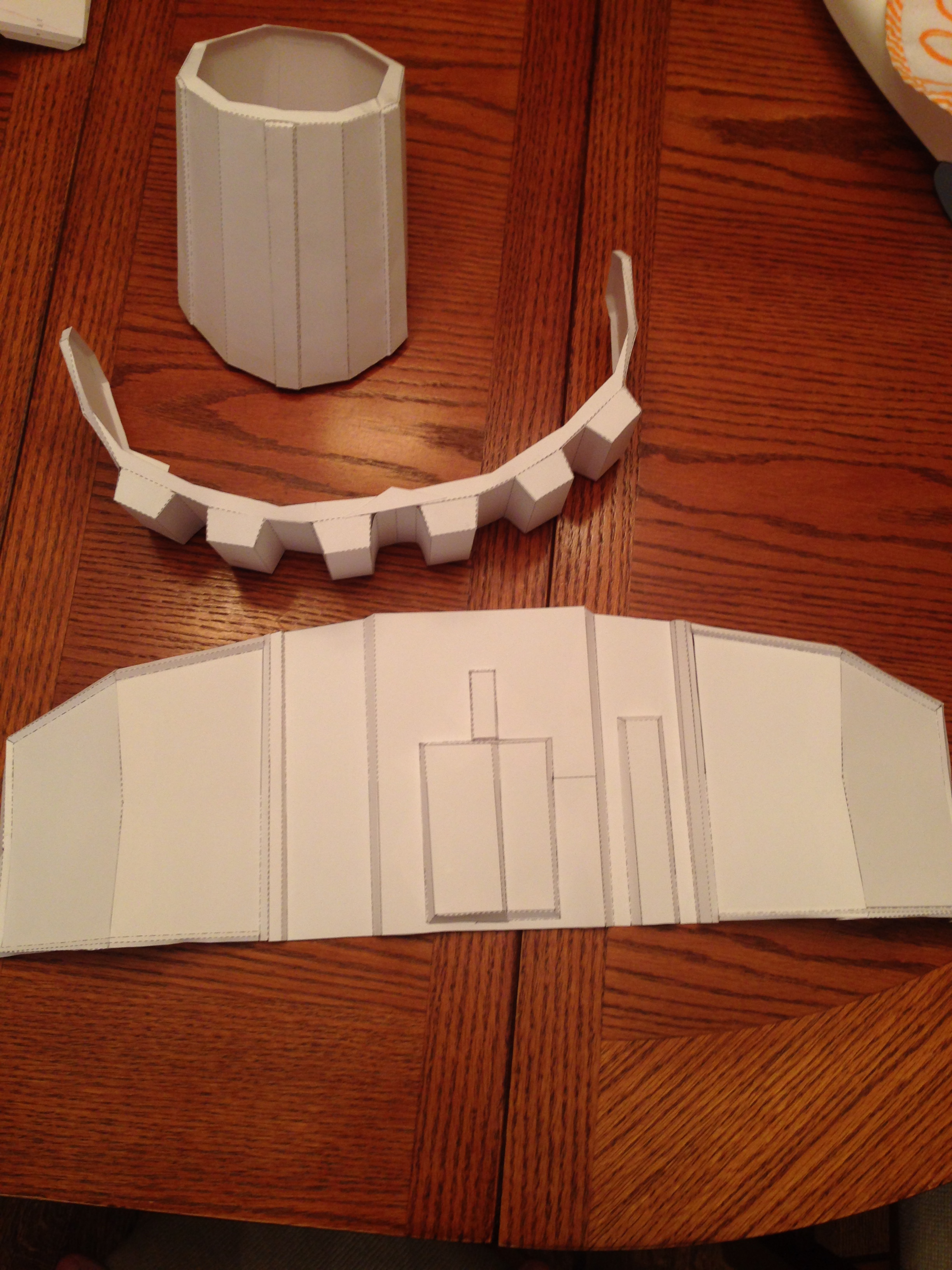

Thanks! Yes, materials. I used 110# paper for the pep build, then fiberglass resin inside and out (no cloth), then rondo'd the inside. Started with Bondo on the outside (I think I've had 4 layers or so so far), and in the middle I used Apoxie Sculpt for added detail. I just hit it with Primer today after more sanding and I dremeled out the "teardrops". Also started on the armor pep builds. Here's what I got so far.030.JPG028.JPG027.JPG026.JPG014.JPG089.JPG
Hey again, those look like Fierfeks' pep files aren't they?
Just check the sizing of the parts against your body, in my case I had to do some serious upsizing and wasted SOOOO much time folding and cutting and resin on parts I couldn't use in the end.

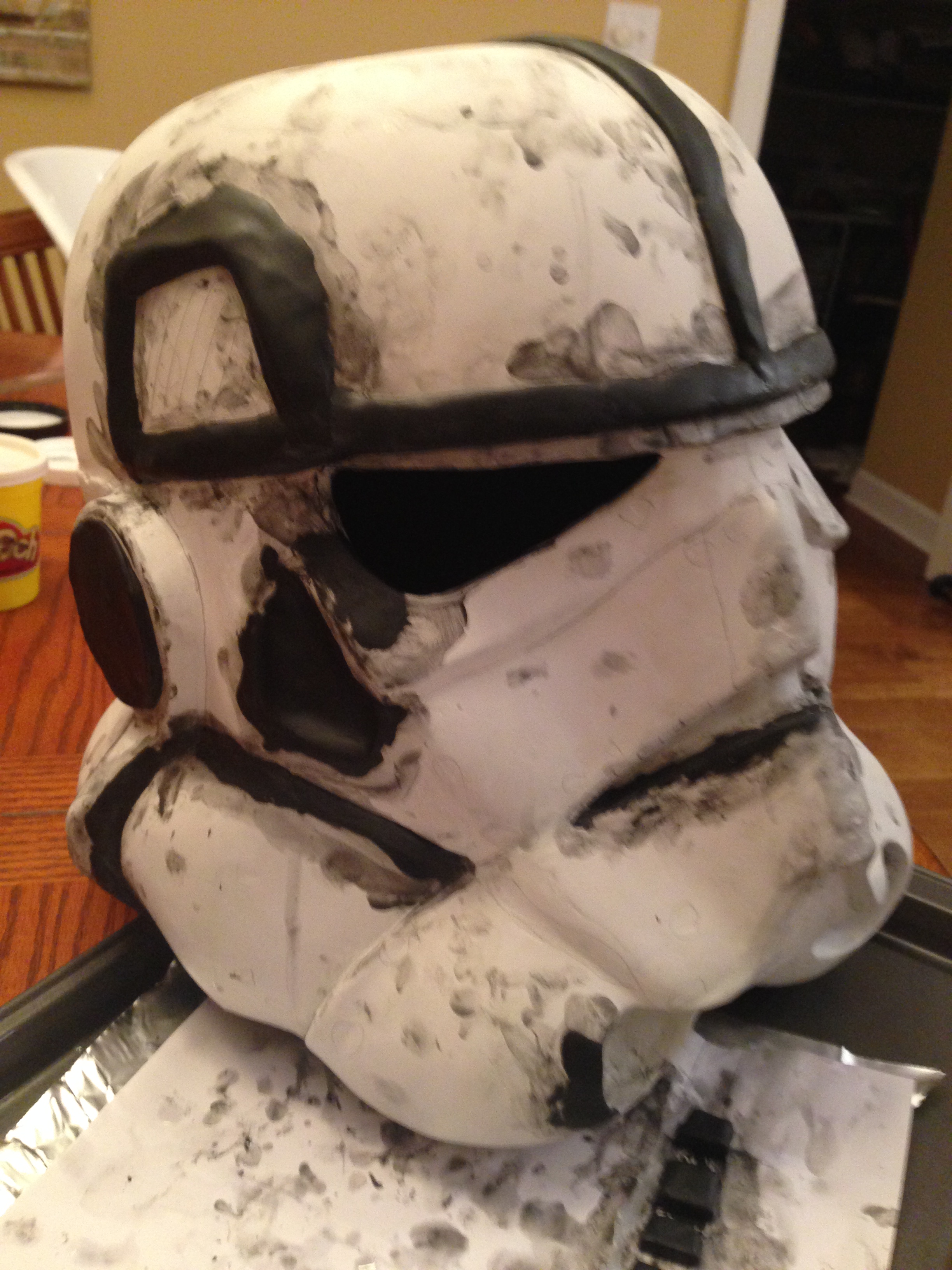

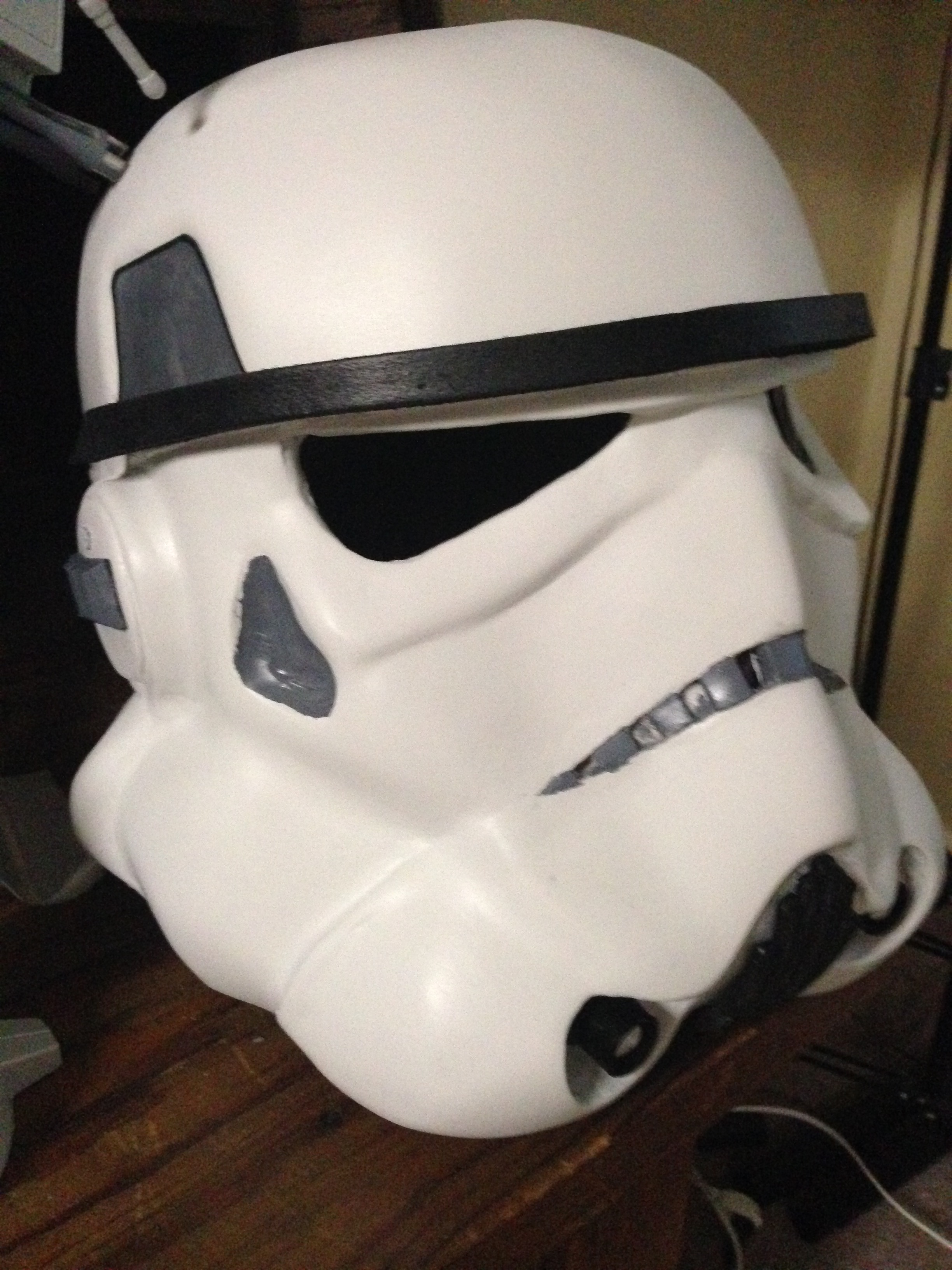

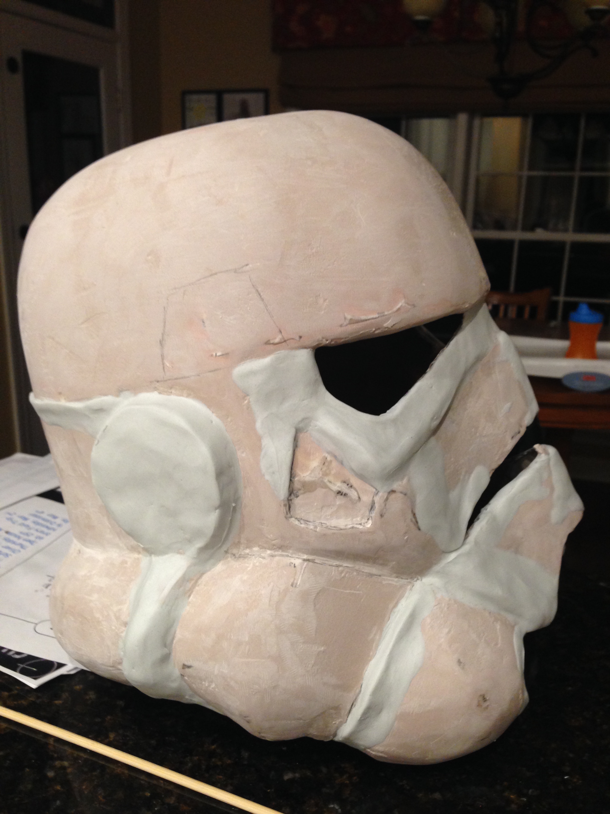

Yes, they are Fierfeks files (thanks to him), ive been trying them as I go and the belt and bicep are the only ones that seem a bit small. I can wear them but may be more comfortable upsizing. What do you use for the oil cap? I have a new pic but cant upload it from my phone. Basically, i ordered new Apoxie Sculpt and it was the black kind which is super messy. It looks like a wreck but Im making it better I think! One step backward to go two forward right?...Right?!

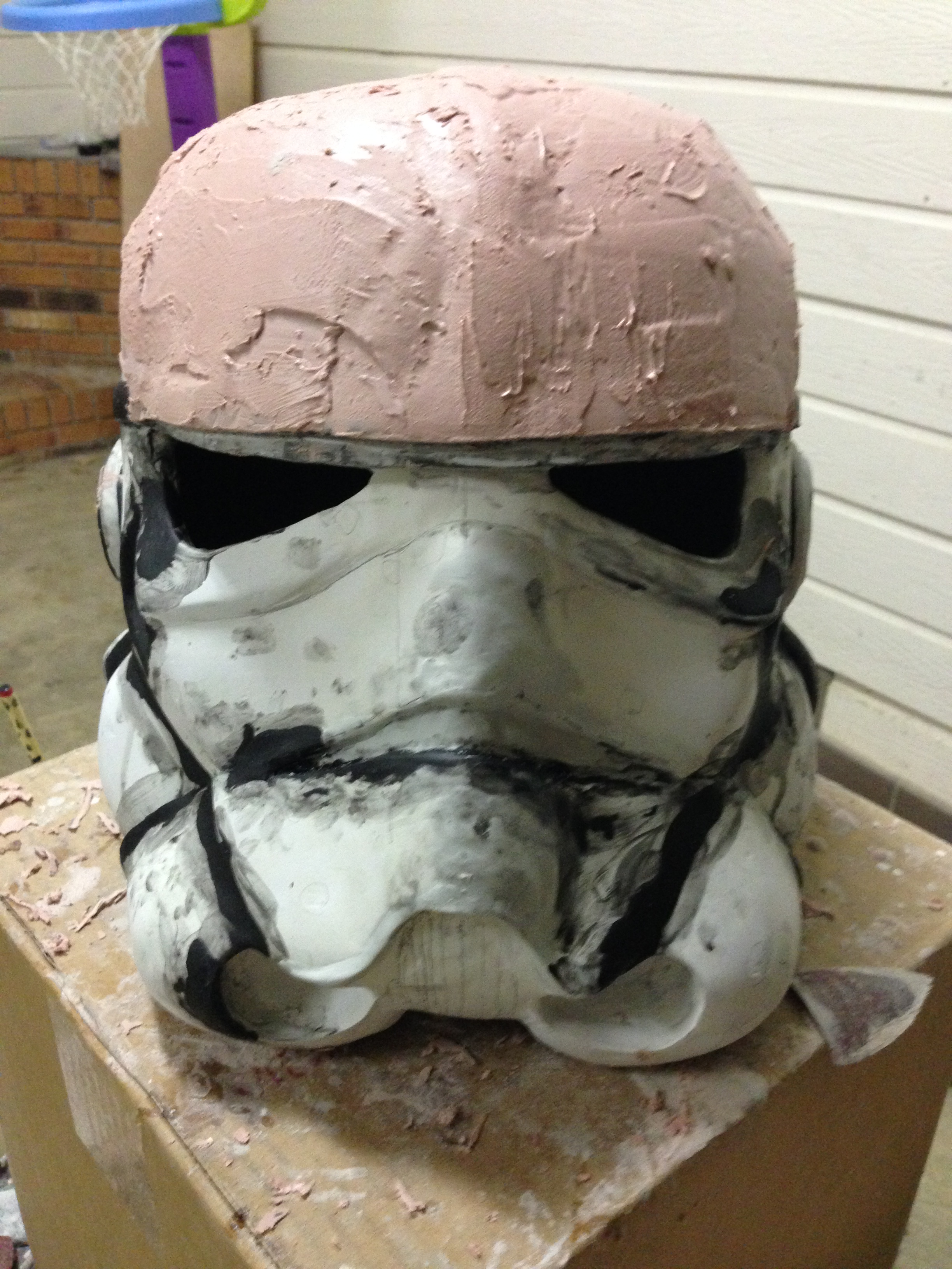

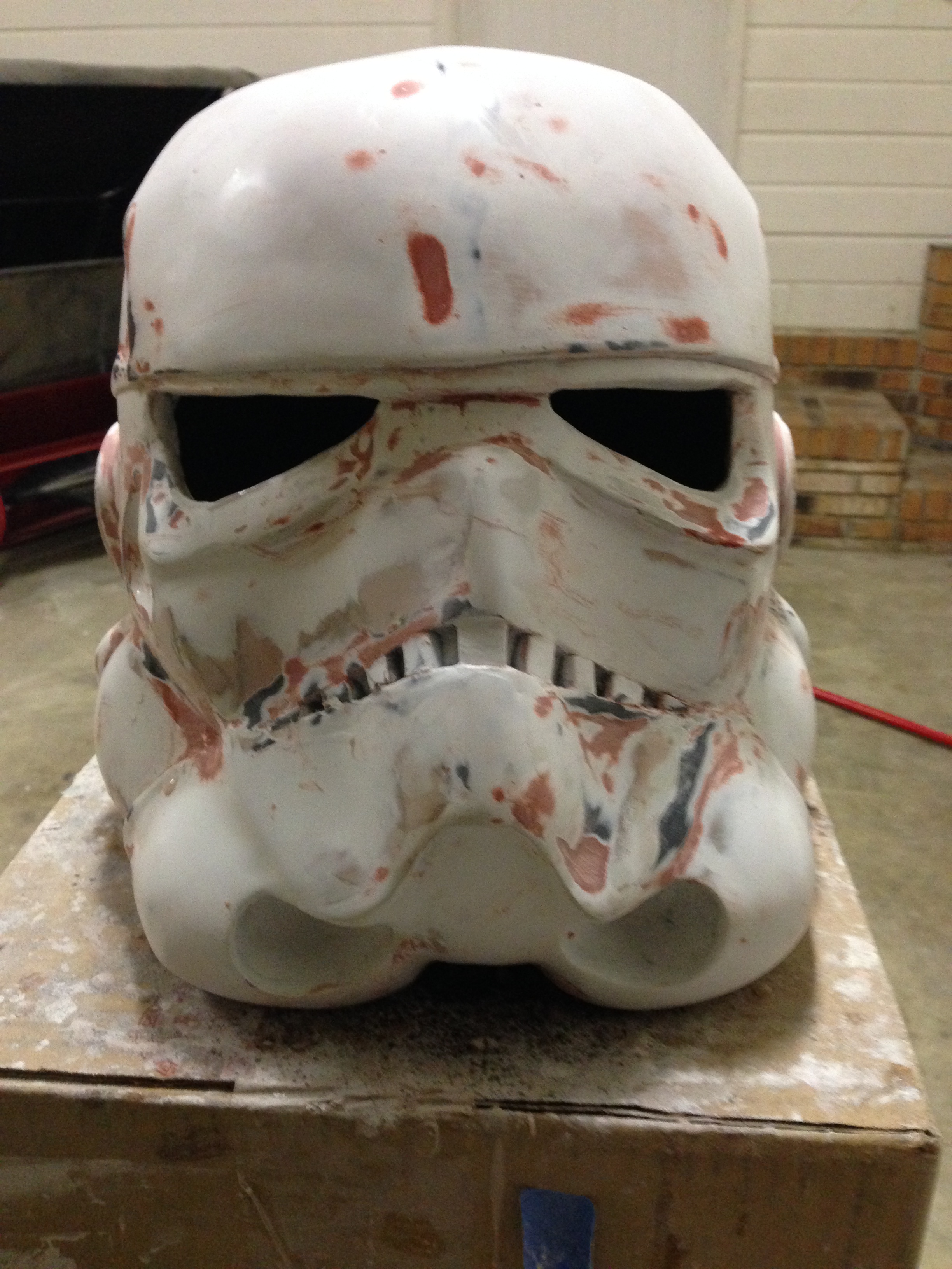

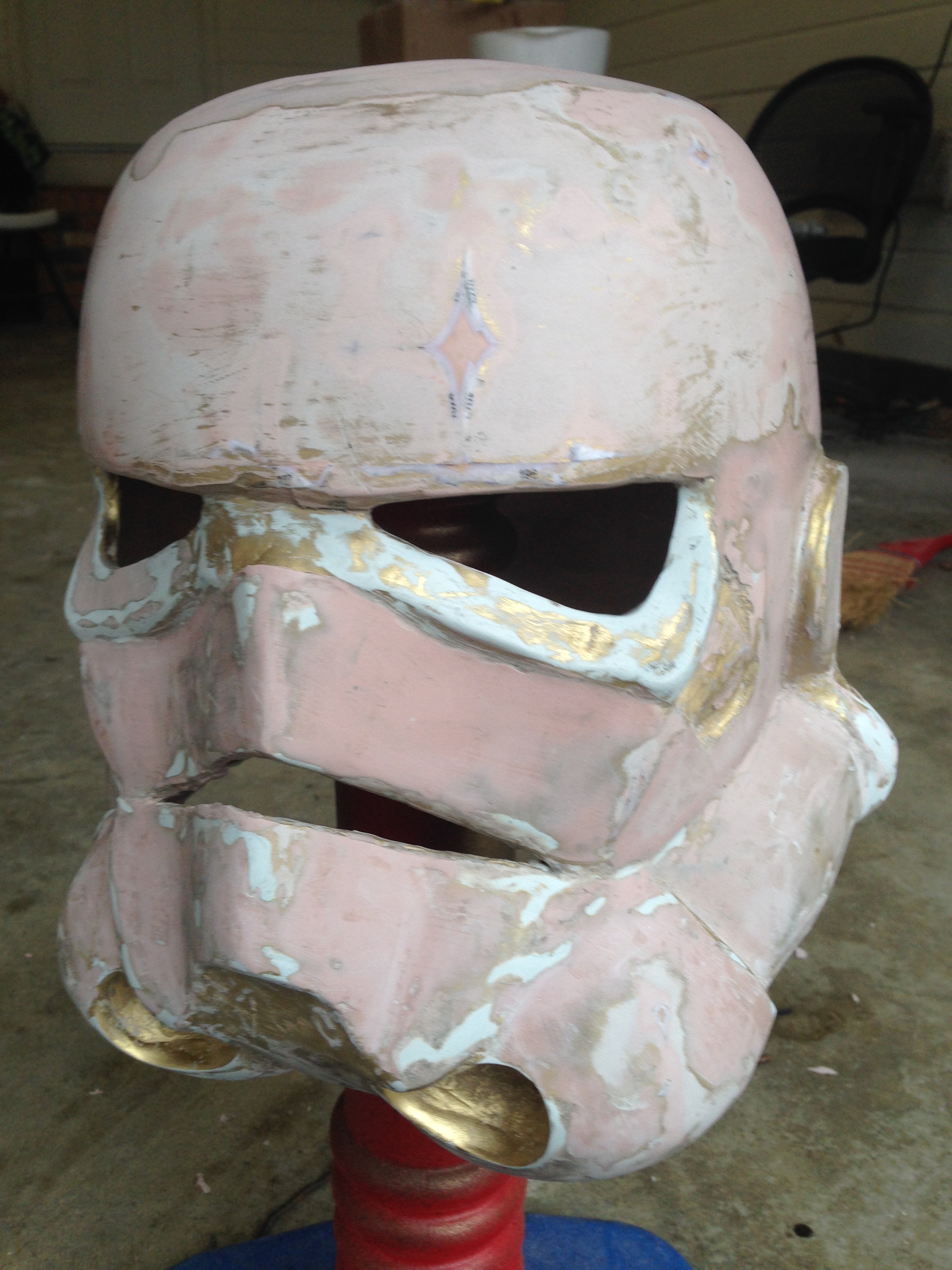

Taped some printed out labels on to get a feel for what it would look like...then got messy with my new black Apoxie clay and made it look horrible. But once it's sanded and primed again, I think it will look better. Also added a fresh layer of bondo to the rooftop to try and get the roundness shape. Sanding tonight...
