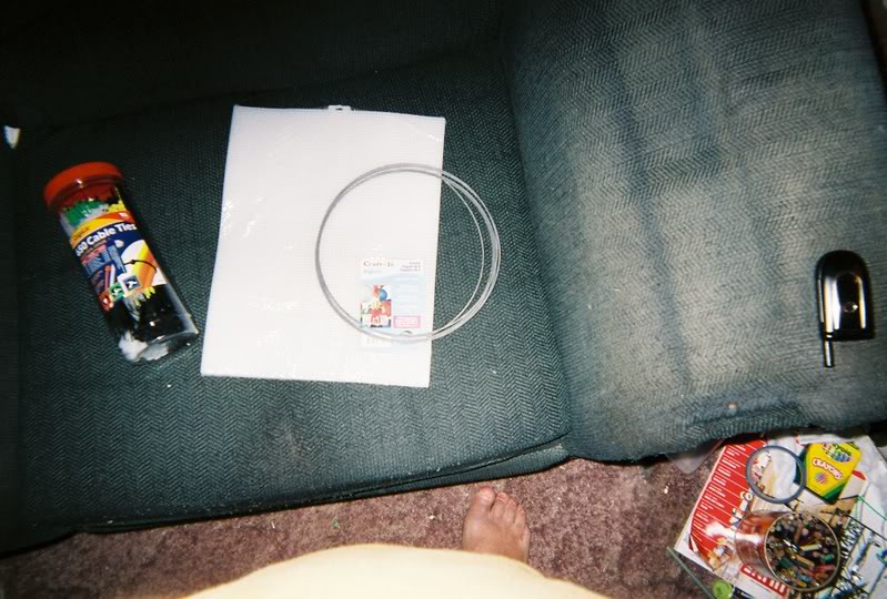

parts i used, to get started, zip ties, knitting sheets, fence wire , orange duct tape not shown yet, and clear page tape not shown yet.

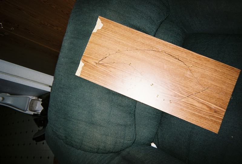

the wire bending template, made from old video cabinet, with tracing of pred mask for outline, with small nails outlining the
tracing as to bend wire to form.

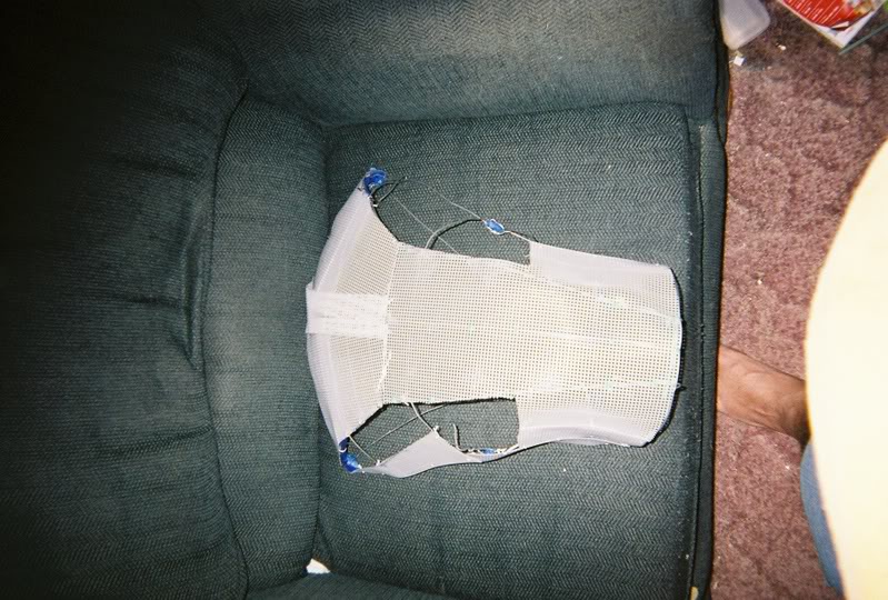

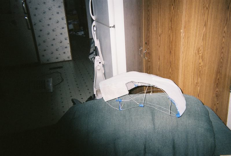

right side of armature, partially covered in the knitting sheets
down shot of partially covered armature
left side

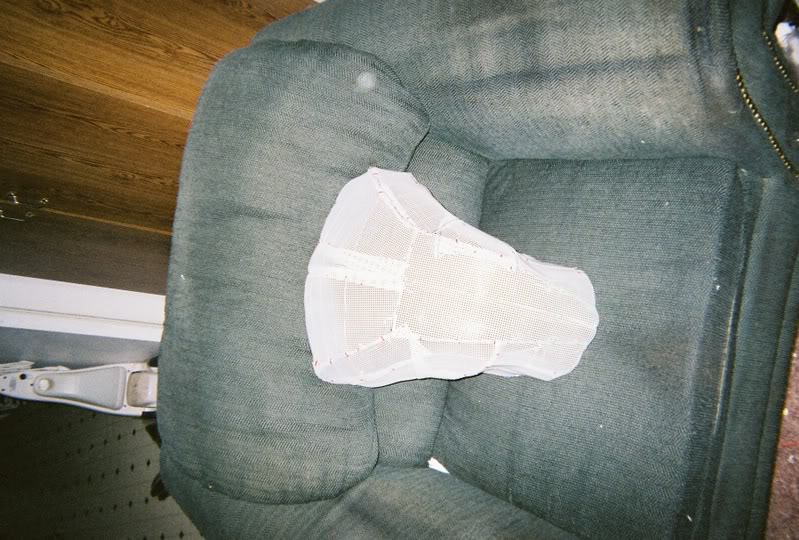

down shot of completed armature

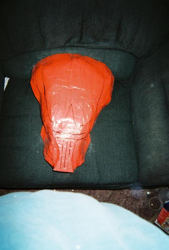

finished and covered in orange duct tape wire armature
......basic idea and thanks go to URATZ for the insiprational tut, thanks man.
ugly chair, but confortable as heel!lmmfao! hope you predas and predettes like, and use URATZ'S wire undermask armature tut, as i have done, it was fun , took at most four hours to put together. if you look closely you can see my predator bio doodle on the orange duct tape. the really shinny layer is the packing/shipping tape. hopefully in next week or so, i can get this big tangerine covered in plaster cloth, i'll take pix when i get it plastered.
i didnt go the flat top head , i went more of the upper sloped head like pred2, anyways, a tut put out by URATZ, and a project worth doing. it was fun, and relaxing .
Wassup Bane
Your stuff is coming along pretty good. Glad my idea is useful to someone, like the wheel idea - keeps improving. I like the shape you've achieved in the orange tape picture, the shape is closer to the mask than mine Keep posting man. We all can learn from each other :)

A quick tip, Just when I was on my final stages of sculpt I realized some big things taht were uneven and not symmetrical and I realized that my plaster underform was a little warped in the back and tilted down to the right side.
;) Make sure your plaster form is even where you need it to be before u sculpt this can save u some headache
Always check it for balance esp in the wire form and the plaster form. Otherwise very hard to correct the mistake later on.

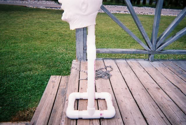

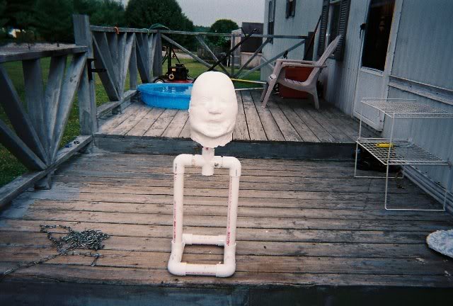

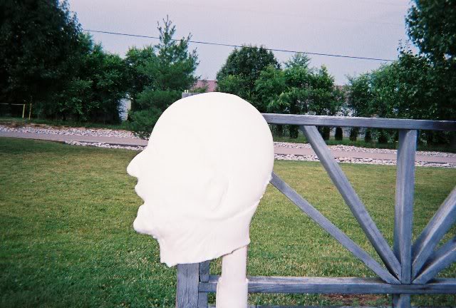

when i get a pic of the plastered head and pvc stand/armature you'll see it was pretty easy, the pvc pipe was used originally for a star wars prop ( jawa) but the years have played with the costume, so i took the skeleton of that prop and used it for the head armature, i think the pvc pipe is either 1 1/2 inch or 2 inch think it's 2 inch pipe and joints. mix the plaster kinda thickbut alittle runny, pour the plaster into layers using th pollyfill as you go, make sure each layer is still wet and plyable so you canget the polly to matte, i continued pouring the plaster until i had a decent amoutn, say from crown of head to a partial neck . this tor johnson looking thing weighs around 20 - 30 pounds, but that was directly after i pulled the rubber head and mask from the plaster, as i type this it is drying, if plaster is hot to touch it's still curing, if the plaster is cold and damp, it has set up and the water is trying to escape, which is a great thing , touch the mold no cold or dampness, you're ready to slay it up for your sculpts. sometime this coming weekend i'll get pics of it up for you guys and ladies. NO PIX YET BUT THEY ARE COMING, PLEASE BE PAITENT.lol!

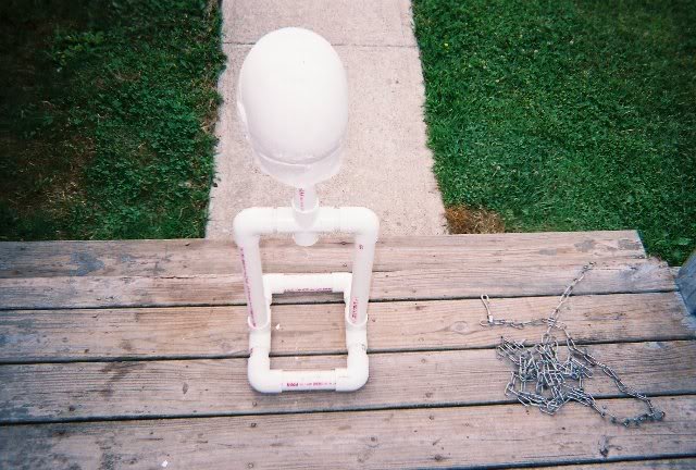

sorry it took me so long to reply to the last post i made in this thread but here's the plaster head i poured from the rubber ripped off head, and the stand i am using to hold the head, i'll have to measure out the stand, but i'll do that in a day or two. so here's the pix........
another angle......
another angle.....
so now i have a sculpting jig, maybe i can start doing something on a pred head.
i'll get measurement on the pvc stand, the overall smaller lengths . the pipe is 1 1/4 inches, as well the elbows, and t sections and + section
a ten foot pvc pipe 1 1/4 inches in diameter maybe 3- 4 dollars at local hardware store lowes, home depot, places like those. other parts you will need to ake the stand are, 6 1 1/4 inch elbows, 2 1 1/4 inch T joints, 1 1 1/4 inch + .
for the bottom of the stand ( the base) mine is a little over a foot square, for stability make the base abit larger, to your needs, okay on the base you will have 2 long peices these will be front and back, 4 smaller peices these will fit into your T joints, which will hold your uprights (legs) on this base section 4 90% elbow joints are used, my legs on the stand are 22" inches long, they are to be placed into the 2 remaining 90% elbow joints, then two smaller lengths from these 2 elbows , connect these 2 peices to the + joint, this will become the section that holds the neck peice of pvc. the length i used 18 inches long, you may want to go shorter or longer depending your work area. dont place the neck length in the + joint until you have poured your duct tape dummy head with plaster, as the plaster begins to stiffen around the dome of the head and brow region, now place the neck length pipe here, continue to pour your plaster until it the neck pipe has become a rim one peice object, let the plaster firm up abit, if plaster is giving off heat, that means it is drying, let the pour firm up about two hours before you take the duct tape off of it, it will be hot and heavy from the water in the plaster, once firm place the neck pipe into the + joint. let stand for acouple days to let the plaster harden further and dry out, when the plaster is cool to the touch it is cured just fine. now it's ready for your clay and designs then.
i'll get the smaller measurements of pipe and i'll post those in here to make it alittle more understandable. i do appologize for not measuring before hand.
JUNE 27TH 2008 UPDATE, here are the measurments i promised to put up in a day or two, remember these measurements are your pre elbow applications and plastering in the neck peice.
front and back peices 6 1/2" inches, back 6 1/2" inches, sides 2 1/2" inches x 4 peices, legs 14 1/2" inches X 2 peices,
nech is 14 " inches before you make you duct tape dummy plaster head. shoulders 2 1/2 " inches x 2 peices. connect these peices into the elbows, pvc glue maybe used to solidify the stand, but not needed, not if you tap the pipe peices snuggly into the joints.
