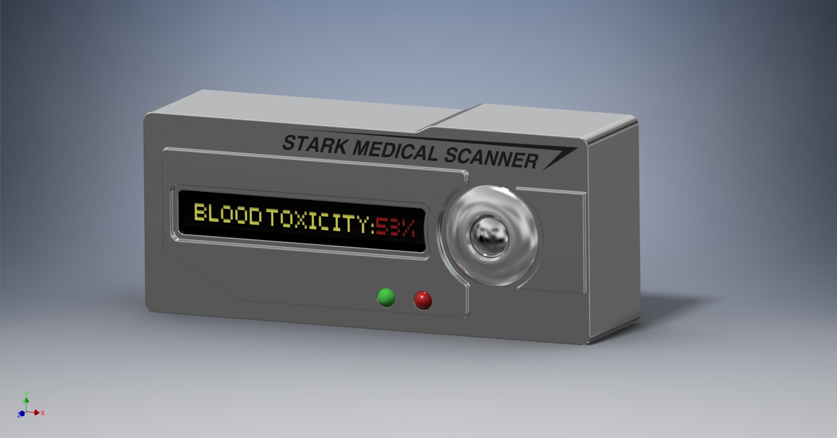

Stark Medical Scanner

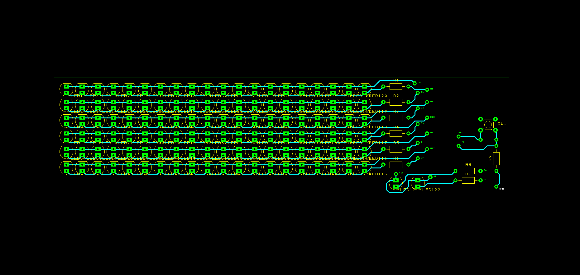

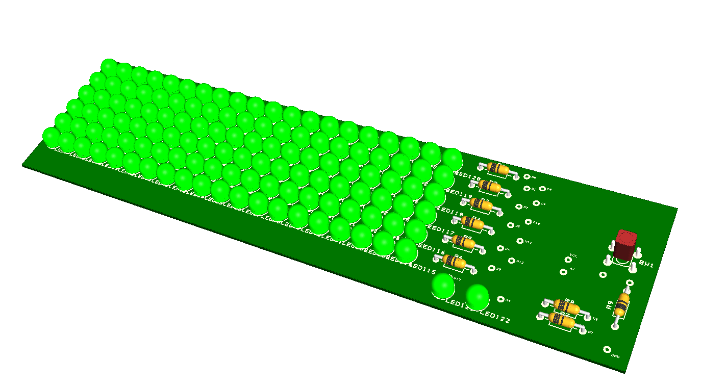

Currently, Yes and no. What I have been doing is trying to have a display made for this. I made a new circuit using a pro mini to light a led matrix on button press. That new led matrix can be made smaller, but the leds would be surface mounts and would be easier to have the board made than to do it myself.
Right now, I am just doing the waiting game. I ordered some boards for testing and was told that it would take 2 weeks and I failed to look at where I ordered from and it is coming from over seas. According to the tracking it has been sitting in California customs for about 20 days now. If it doesn't release here soon I will use one of the US based manufactures.
Here is the test board after I designed it in designspark.

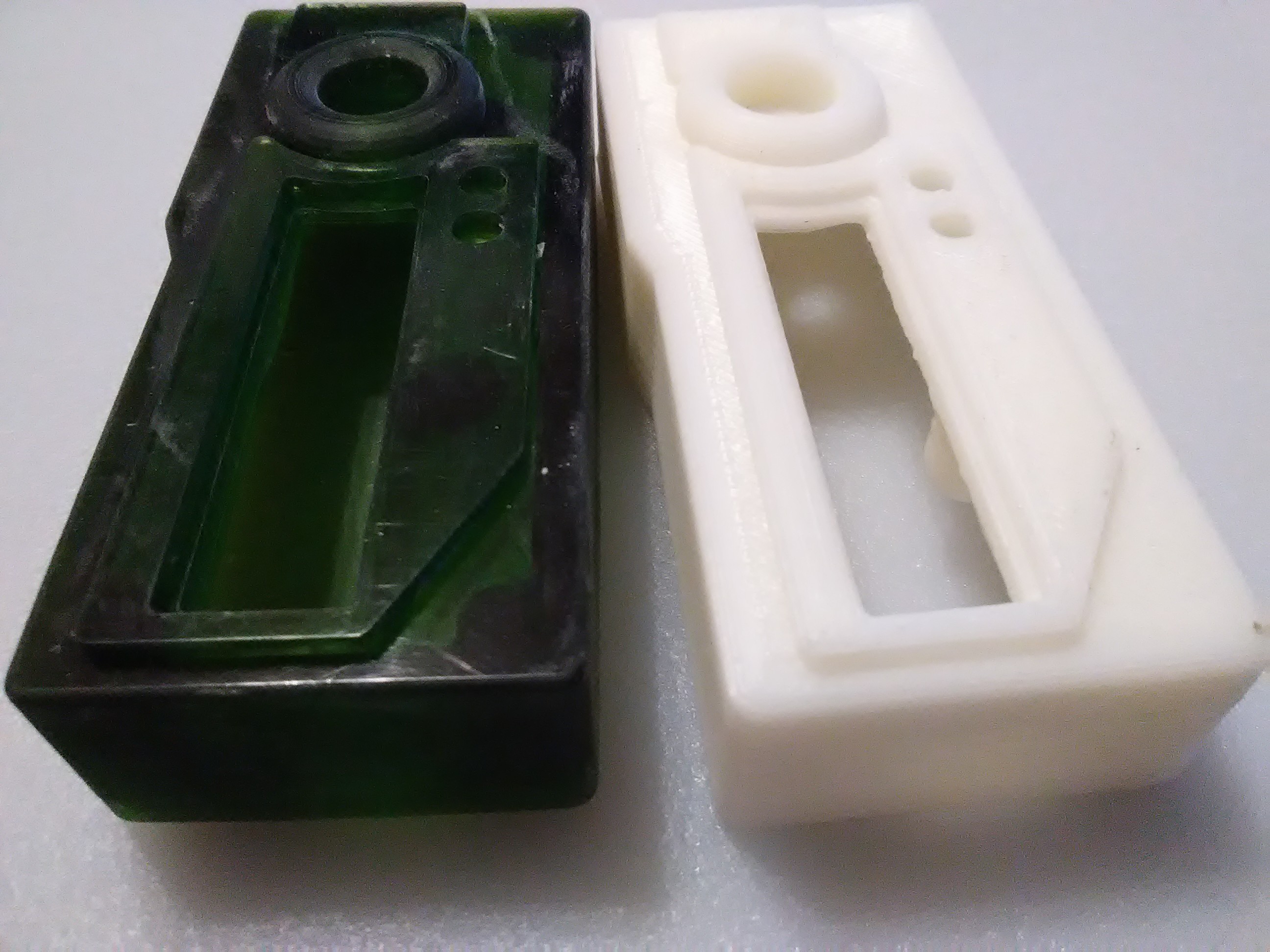

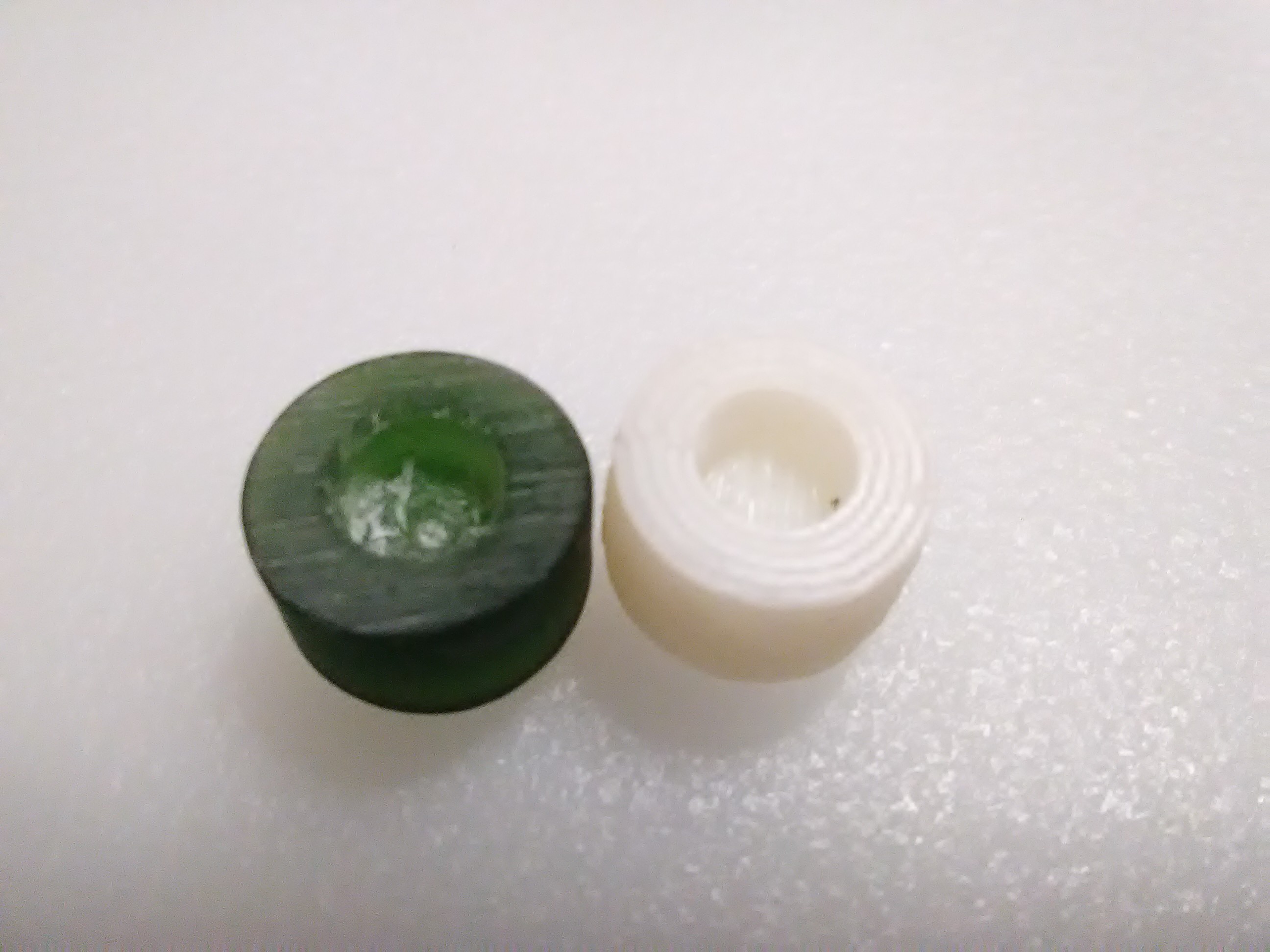

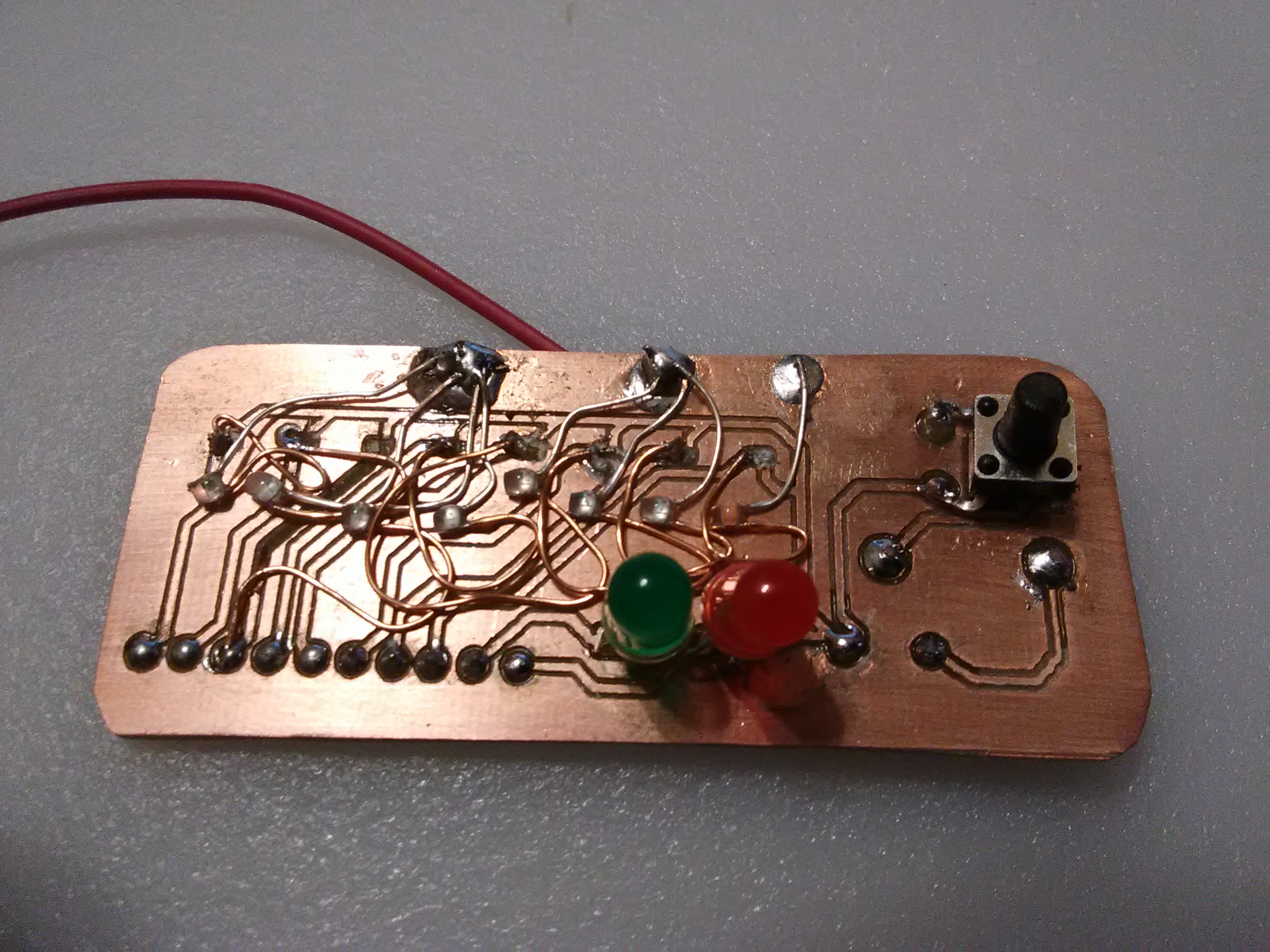

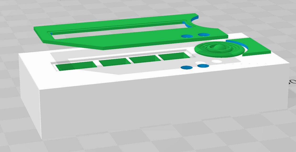

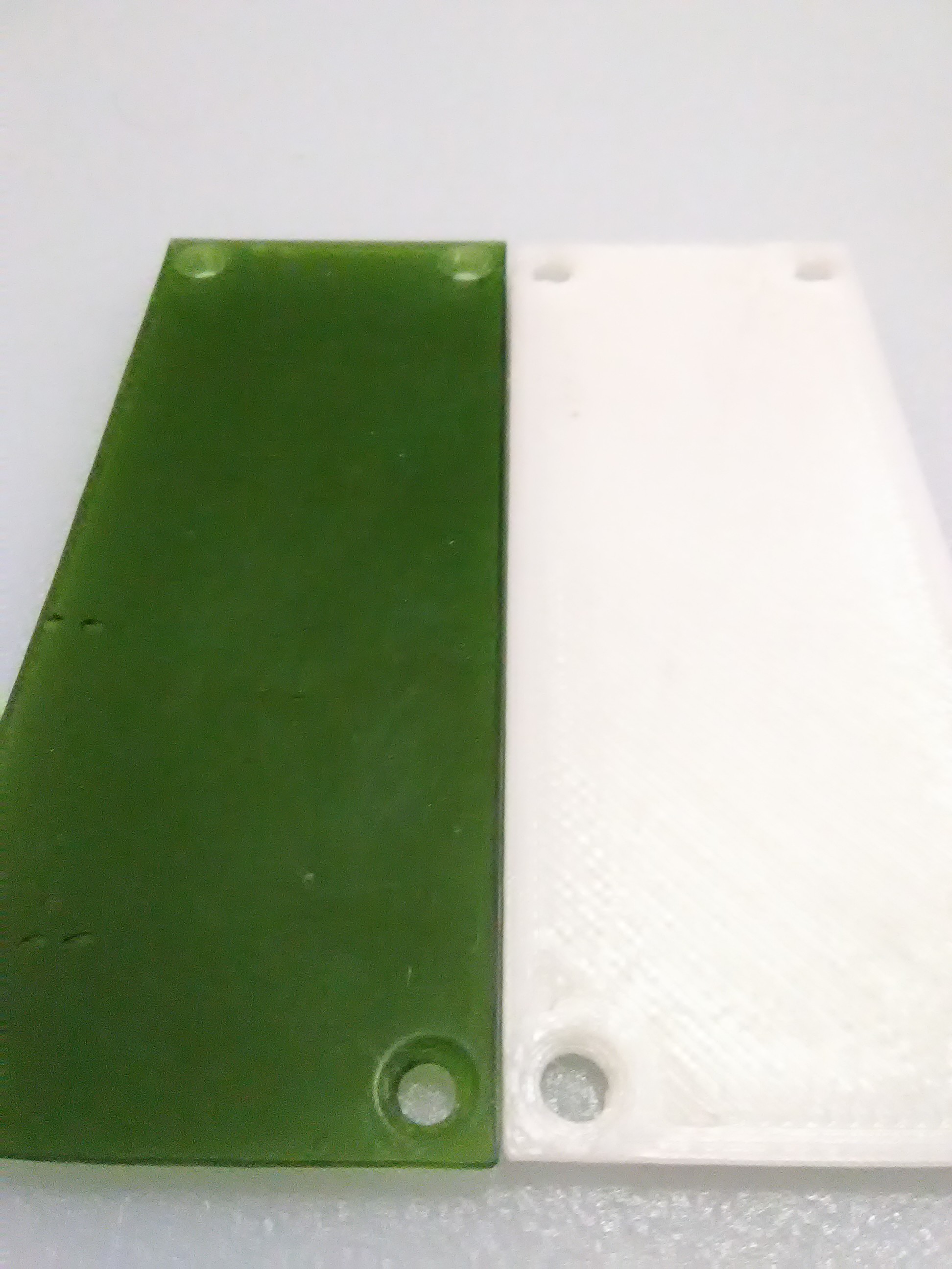

Small update! I was able to print out the models on my new resin printer. Also did a proto circuit board that works with the pro mini. I printed the models out in both resin and abs, mainly to see the difference. Even though I printed out new models, I have new models that are improved versions to accept the pro mini, battery and circuitry. Enjoy the new pics!
Had to go back to the drawing board, but I have a finished circuit with arduino code. Now I just need to put it all together. In my test I used a arduino nano, but the final version will use a pro mini. I think you all will like the final result.

I believe the 'window' (opening) is 12mm x 45mm (so roughly .47in x 1.77in)
I found an OLED screen that has dimensions of: 43mm x 18mm
