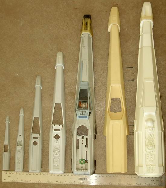

And now the moment you've all been waiting for... presenting the Maxi Brute fuselage. Here is a comparison with a V3 and the studio Red 3.
Look at this nosecone and tell me you don't feel that wave of familiarity wash over you.

The fuselage comparison shot posted above appears to explain the slight but definite feeling of shortness the V3 has always given me -which the V2 didn't.
I say feeling of shortness because the overall length is probably good. What's going on is that the cockpit rear seems to be considerably further forward than on the ILM Red 3 (about 6mm on my screen image). Which means the distance from the canopy rear to the nose is too short. Compounding the trouble is the fact that the canopy front is not shunted forward by the same degree as the rear - which leads the canopy top pane to be slightly squashed up, shortened.
This is why I've been obsessed with dragging the nose forward - just to get a better distance between canopy rear and nose tip. Meanwhile, the canopy front edge is thicker than the ILM Red 3 too (by a couple of mm on my screen) - giving the V3 a wider-looking canopy than ILM, which can only 'fatten' and 'shorten' the fuselage, since the canopy front determines the width of the forward fuse top plane.
BUT IT'S STILL A STUNNING KIT. Obviously. Forgive me, Moe and Mike and V3 fans everywhere - I'm just an over-sensitive general-shape perfection freak interested in gauging exactly where the V3 brings us to in the quest for the ultimate X replica. Anyway, back to the Maxibrute - which is coarser than the V3, naturally, but does appear to be a bit more on-target re this issue of canopy length, width and positioning...

I hope incrediPaul does not mind us discussing the x wing in his tread but it seems like a really cool thing to discuss this again...so i apologize in advance if it's inappropriate. I am always happy to look at the differences in the x wings, and to be honest, I have forgotten some of this stuff after moving on to other projects. Anyway i think this is a cool study in what must be the differences between the different models (ie red 3 to red 4 etc).
The V3 fuselage is based off of what i beleive became Red 4 or Red 6 (or both), the interesting thing is that the V3 canopy is actually about 1.5 mm narrower than the this canopy, and that the forward part of the canopy is about 1mm further back from the nose than the actual. Both of these measurements are IMO nearly invisible.
I do agree with Colin that it is different than Red 3, and all the others, to what degree i am not sure.
I do think all of this is interesting because I know in my minds eye I likely gravitate to certain features from each of the models and i wonder if i have at this point mishmashed them all together..

No worries gentlemen. Please, post away, that is why I posted the comparison. PHArchivist, me too... was thrilled to find that catalog article. It almost feels like this is where all the rumors started. Keep in mind some of those master patterns are for the smaller Estes release of the X wing... the Maxi has inaccuracies that you can barely see in the photo, which lead me to believe it is not from an original. They have used stepped transitions to create the lines of the cockpit. The line below in front of the canopy window is actually a step up from the rest of the fuselage. Here it is in profile:
I am reminded of the Tenacious D HBO series when Captain Ed says "Its like when you believe in the easter bunny or the sasquatch. Let the dream die..." But hey, IMO Sasquatch is real. Even if its not truly from an original, I say the dream of the PERFECT fuselage is still alive.
Also, we can tell from reference material that the top of the ILM hero fuselage does not have any of the nose detail attached. The nose cones were solid resin and attached later... this could result in varying length of the completed fuselage from model to model. Furthermore the nose cone would be cut in two, to allow access to the moutning point resulting in a 'cap' and panel line. Another spot where we see variation that would effect overall length.:wacko
IMO the comparison is a testament to how well Mike and Moe did with their master pattern. The V3 is very very close! Considering the Maxi Brute X is nothing more than a thin simplified form, the choice seems obvious if you're building a replica. But I'm like Colin and obsess over the tiniest of details. So much so that I will be separating the MB fusleage top and bottom. My plan was to do it like the originals, vac formed bottom and all. One step at a time, though. First things first, using the nose to create a master pattern. Any tips on cutting this thing up besides go slow and use light pressure?

Mike, thanks so much for the fascinating reply - and I'm relieved you didn't take my comments the wrong way!
So the V3 is based on the Red 4 pyro. I'd heard it was based on Red 3, and have been puzzled ever since as to how those canopy/fuselage differences arose! The scarce Red 4 ref I have does indeed seem to correspond to the V3more closely than the hero ref. I suppose if people want a hero-based fuselage to go alongside their Red 4-styled fuselage, then those people should pester any master X-replica kitmakers they know of to perhaps one day in the future take on such a project....? (Incredibly cheeky hint - apologies!!)
Meanwhile, looking forward to seeing what can be done with this Maxibrute beastie...
