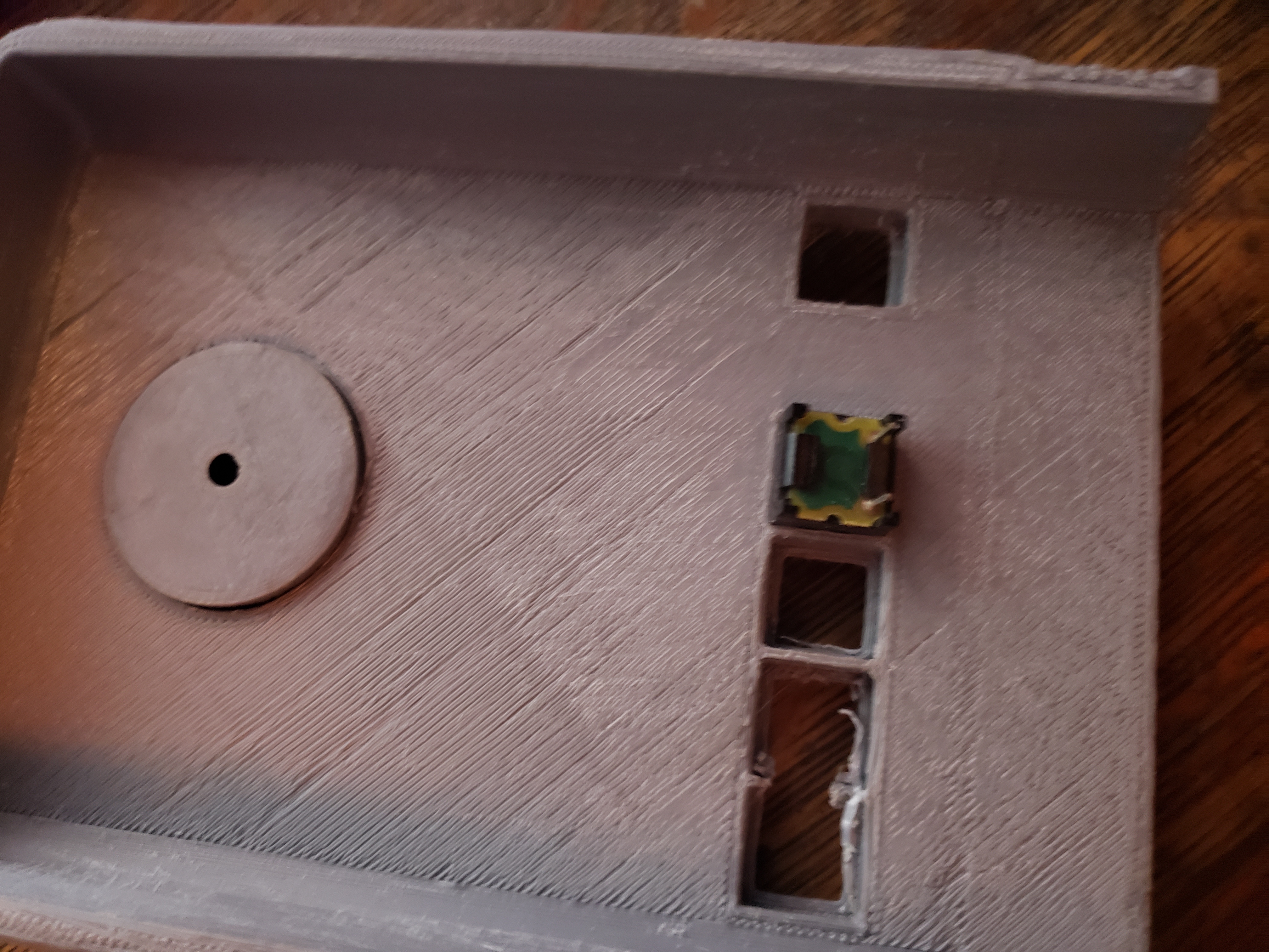

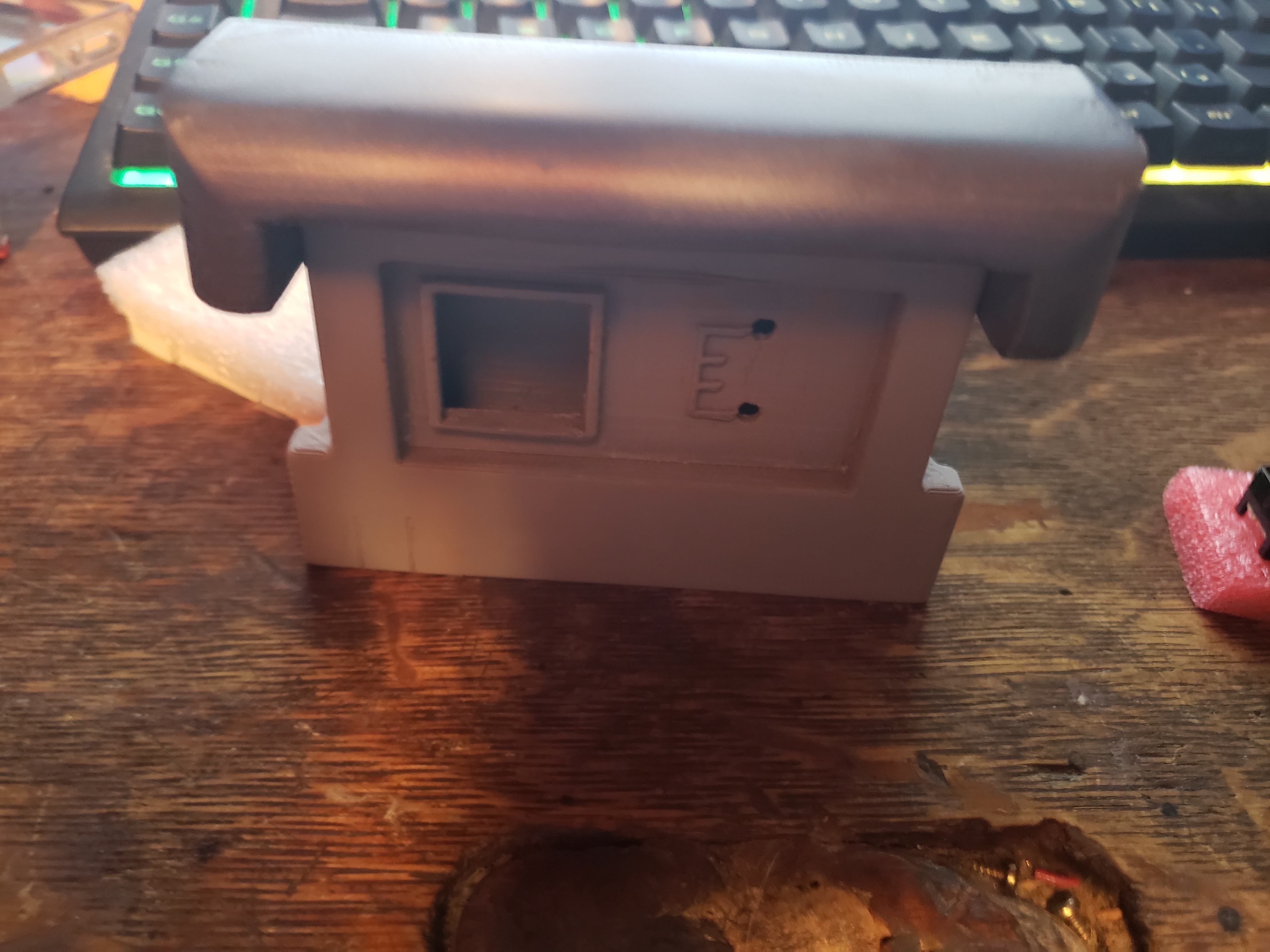

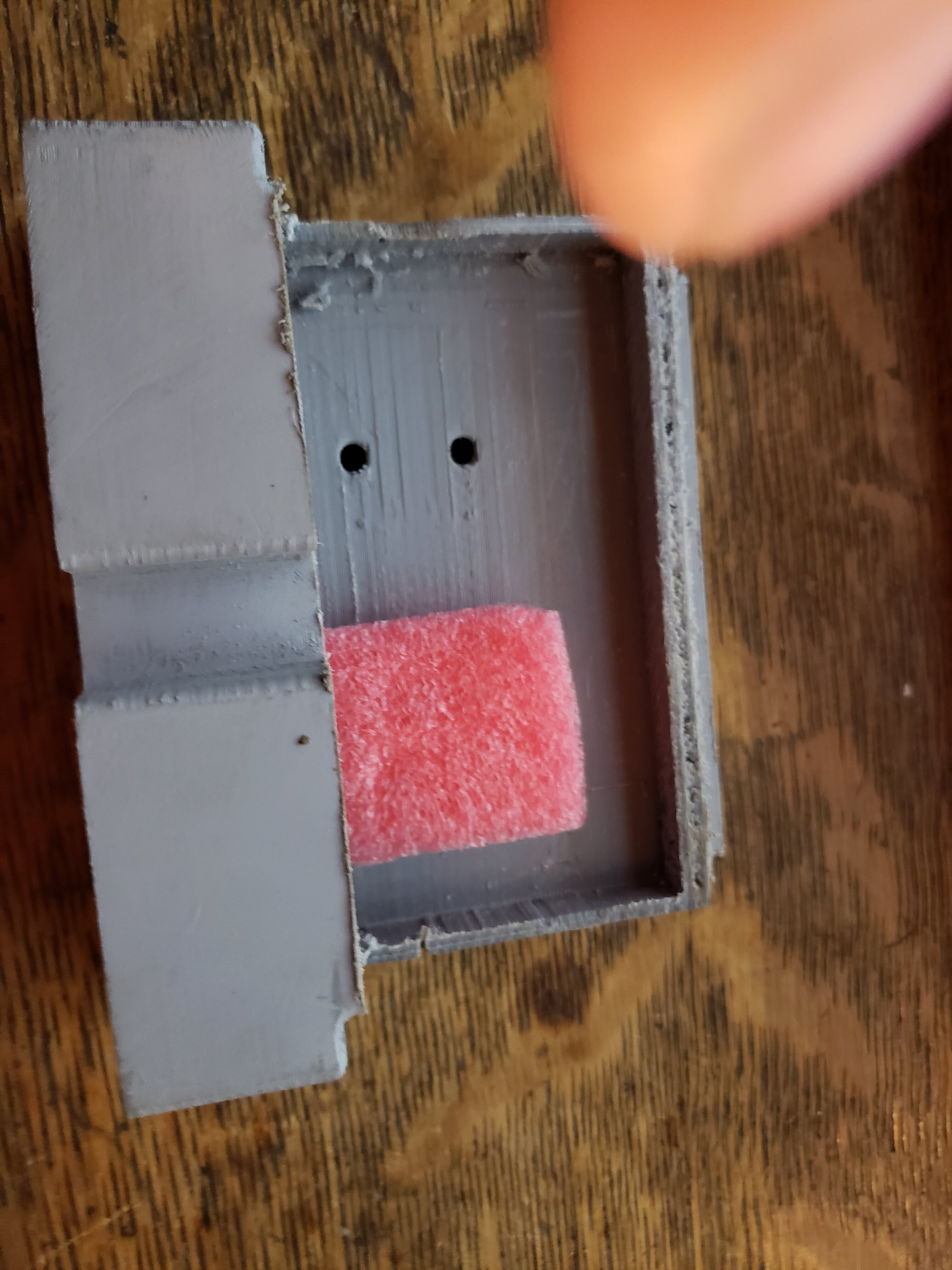

heer is what i have started so far any sugestion would greatly be apreaciated. steveView attachment 999299 View attachment 999300 View attachment 999300 View attachment 999301 View attachment 999303
I have the same 3D printed tricorder that I am working on now. Did the Grayhill buttons slide easily into the slots or did you have to make major adjustments to the model? I am debating on whether to use the 3D printed buttons or use Grayhills. Also, what were you planning for the rear display screen?

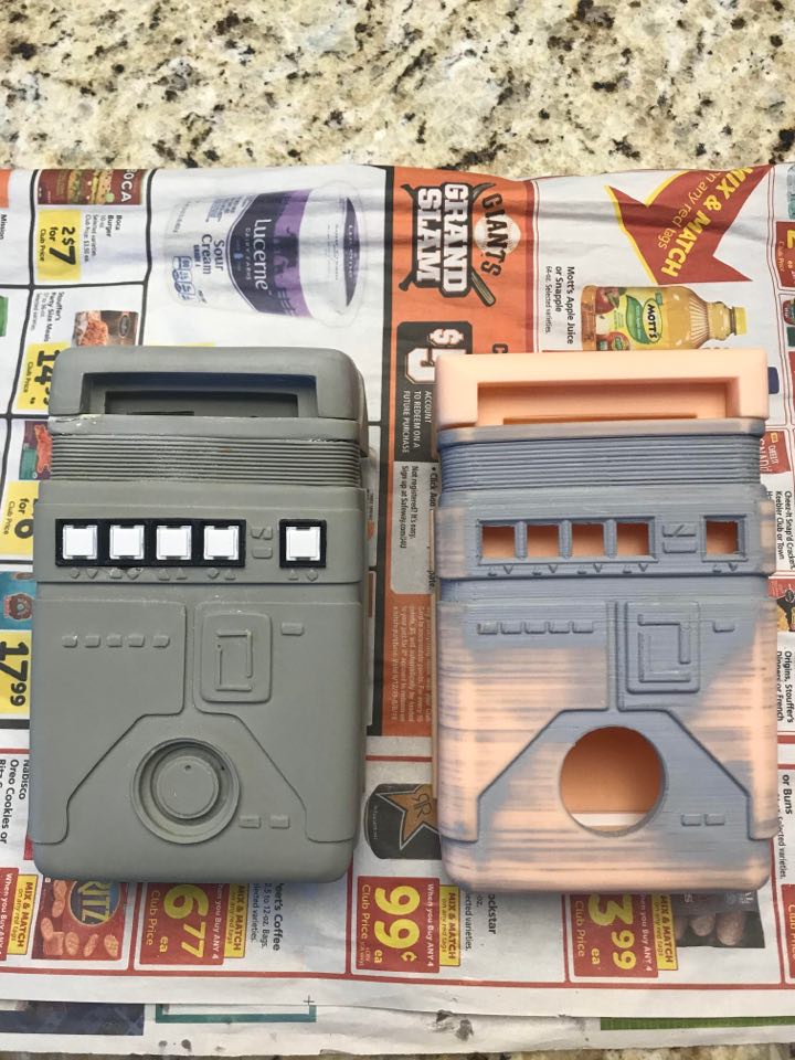

Resin versus 3D in my unfinished collection.

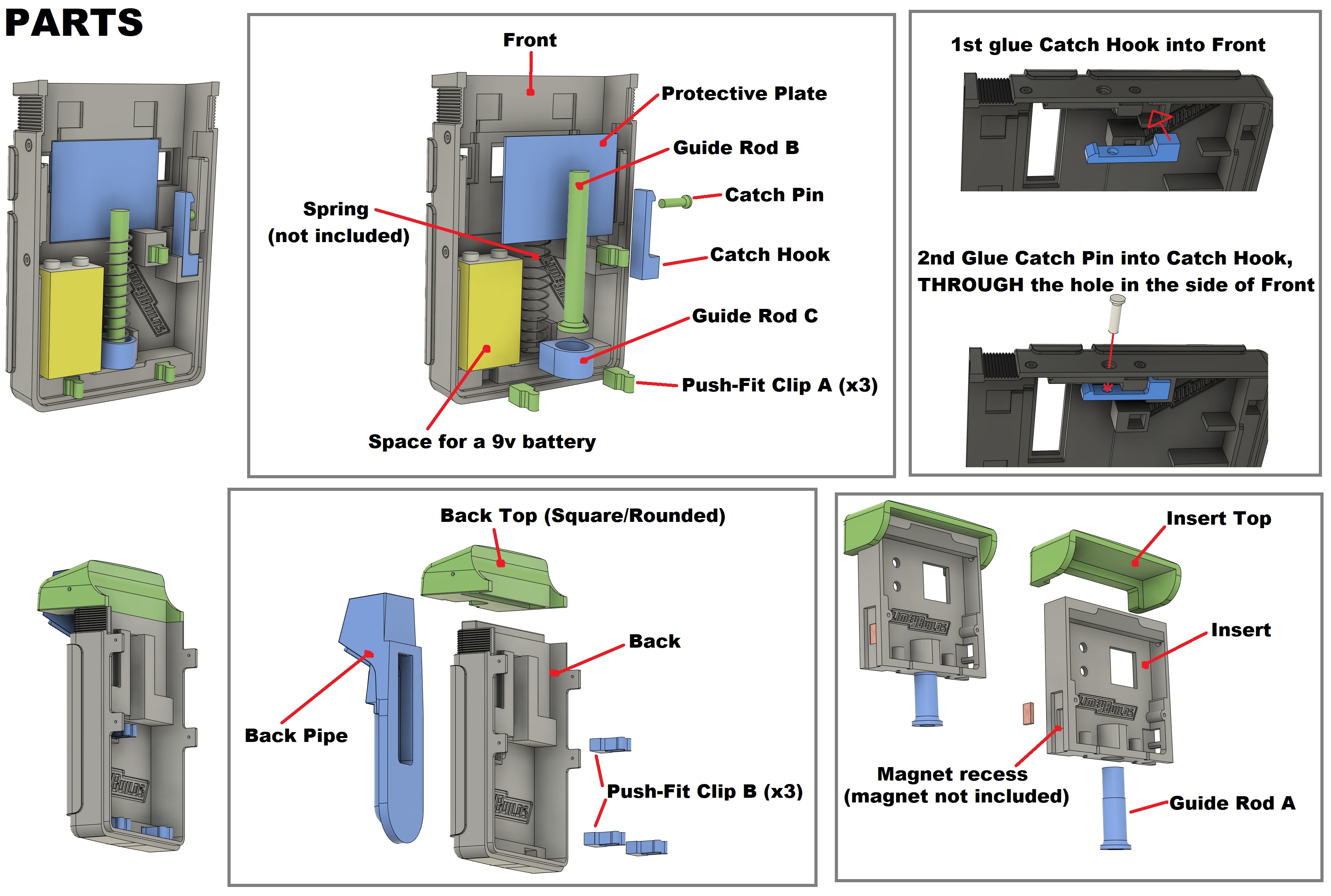

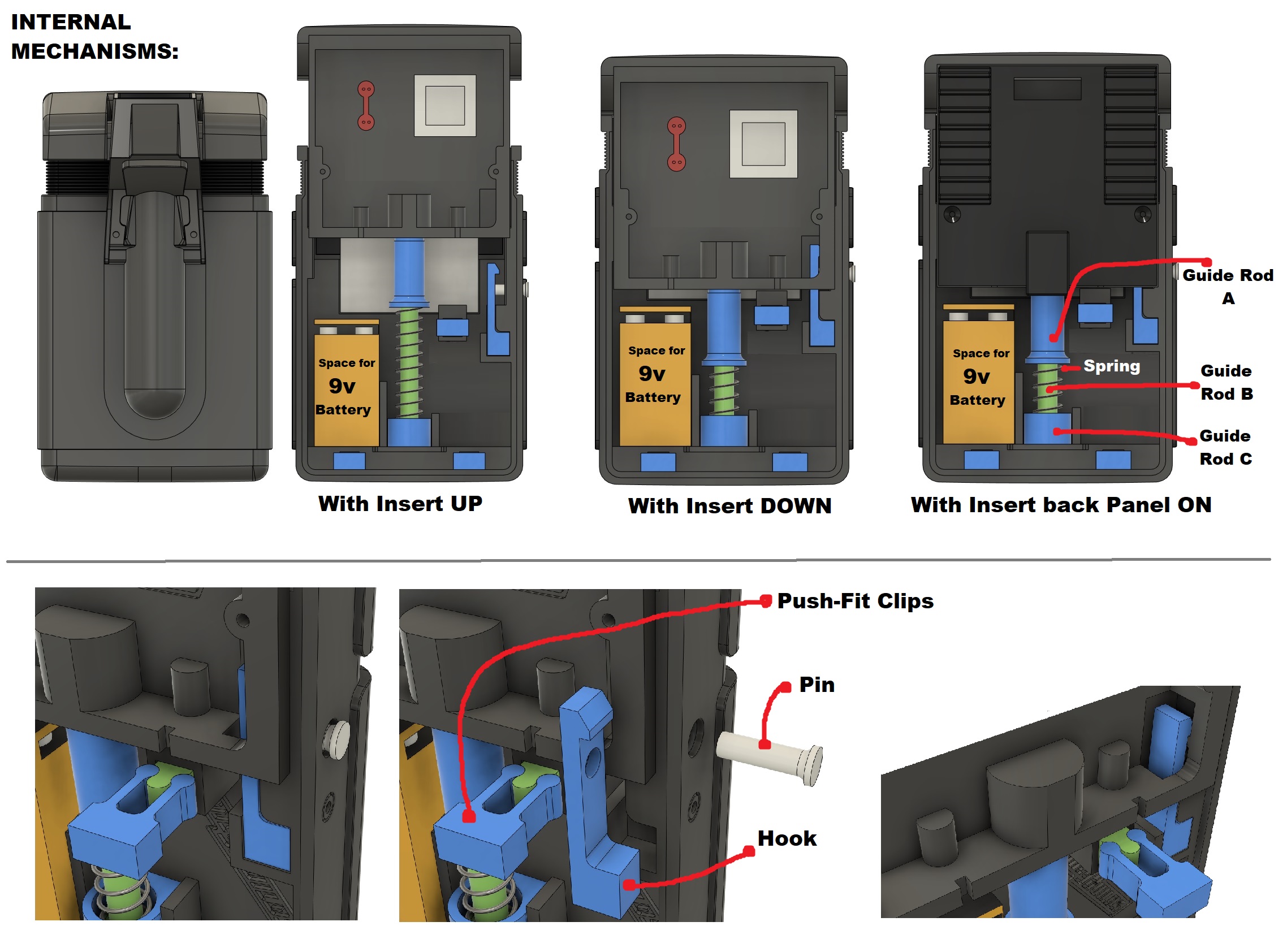

I made my own 3D printable files using measurements and reference photos of screen accurate version of this! I cannot advertise here but I think it's ok to share some images of what I made:
Your design looks great and I really like how you engineered the interior mechanism. Also, congrats overcome the mistake nearly every custom reproduction makes, you seem to have correctly rendered the hood curvature/shape/rounding. I have some unsharable photos of the actual ST3 prop and a resin cast, you're looks great. -- Well done. I hope you print and share one so we can can all see a finished replica.
