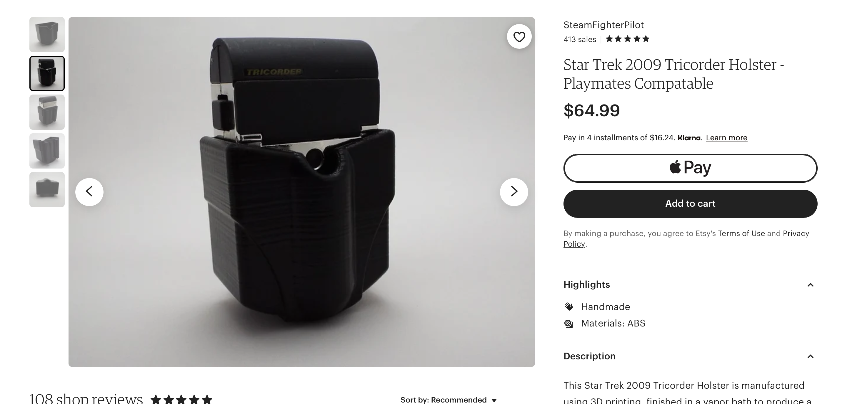

Lastly comes the plastic holsters for the communicator and the tricorder. These two seem to be relatively simple designs, and I think modeling in CAD and 3D printing would be the best way to get them to work. I've model a communicator holster that matches the dimensions of the Playmates communicator and leaves room for a layer of 1mm craft foam inside to make sure it's not going to get scratched up. I think it turned out pretty well overall and I plan to maybe sell the file, but I'm not sure yet. Obviously sanding and filling would happen to bring it closer to the original. The tricorder is the same style, and someone has already modeled a very nice one that's available on eBay and Etsy, but not as a file, just the finished product. It's great, but I've been considering modeling my own to sell with the communicator holster and the pattern for the utility belt. It would also have the craft foam insert to make sure it isn't getting scratched up.

The tricorder holster from Etsy
