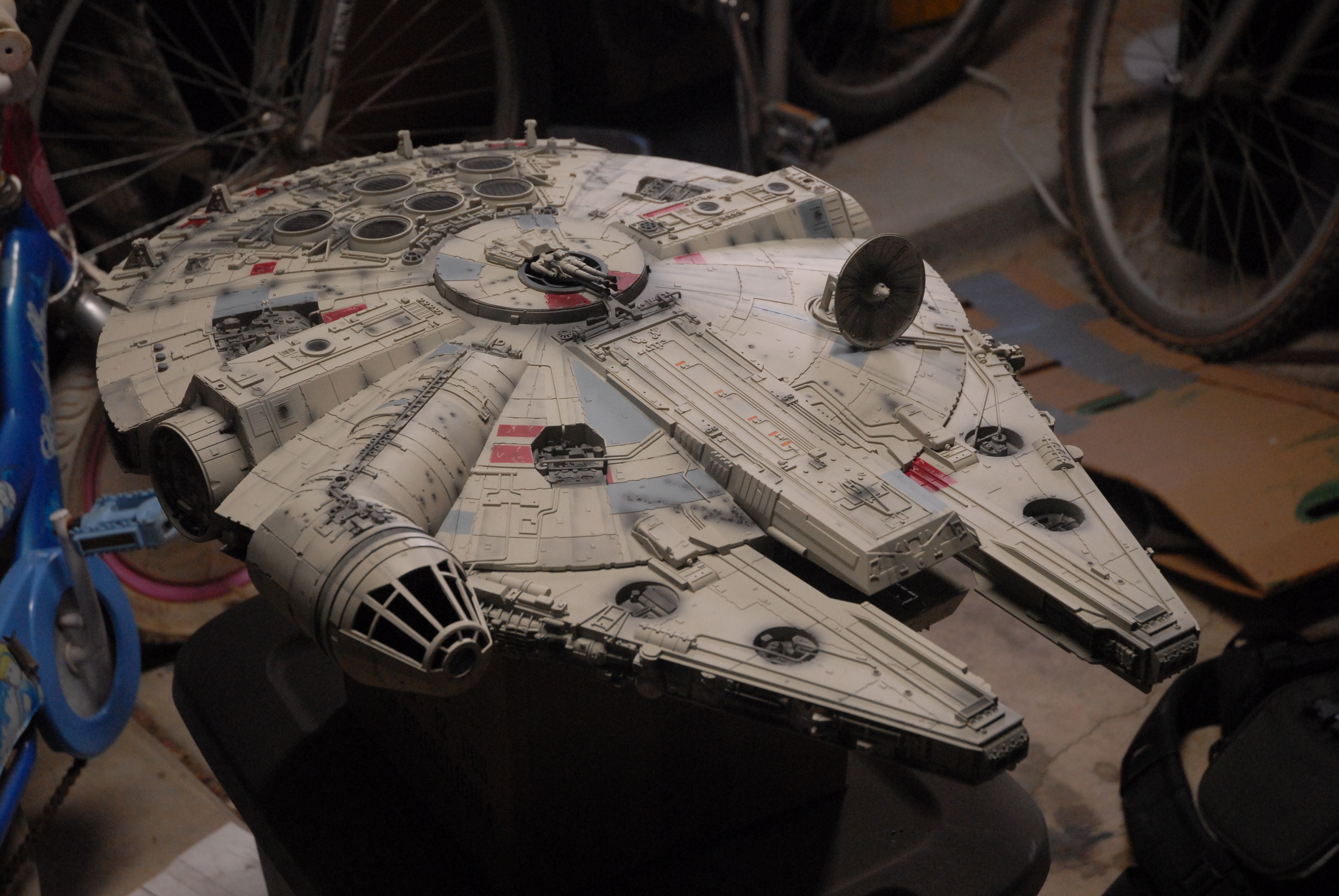

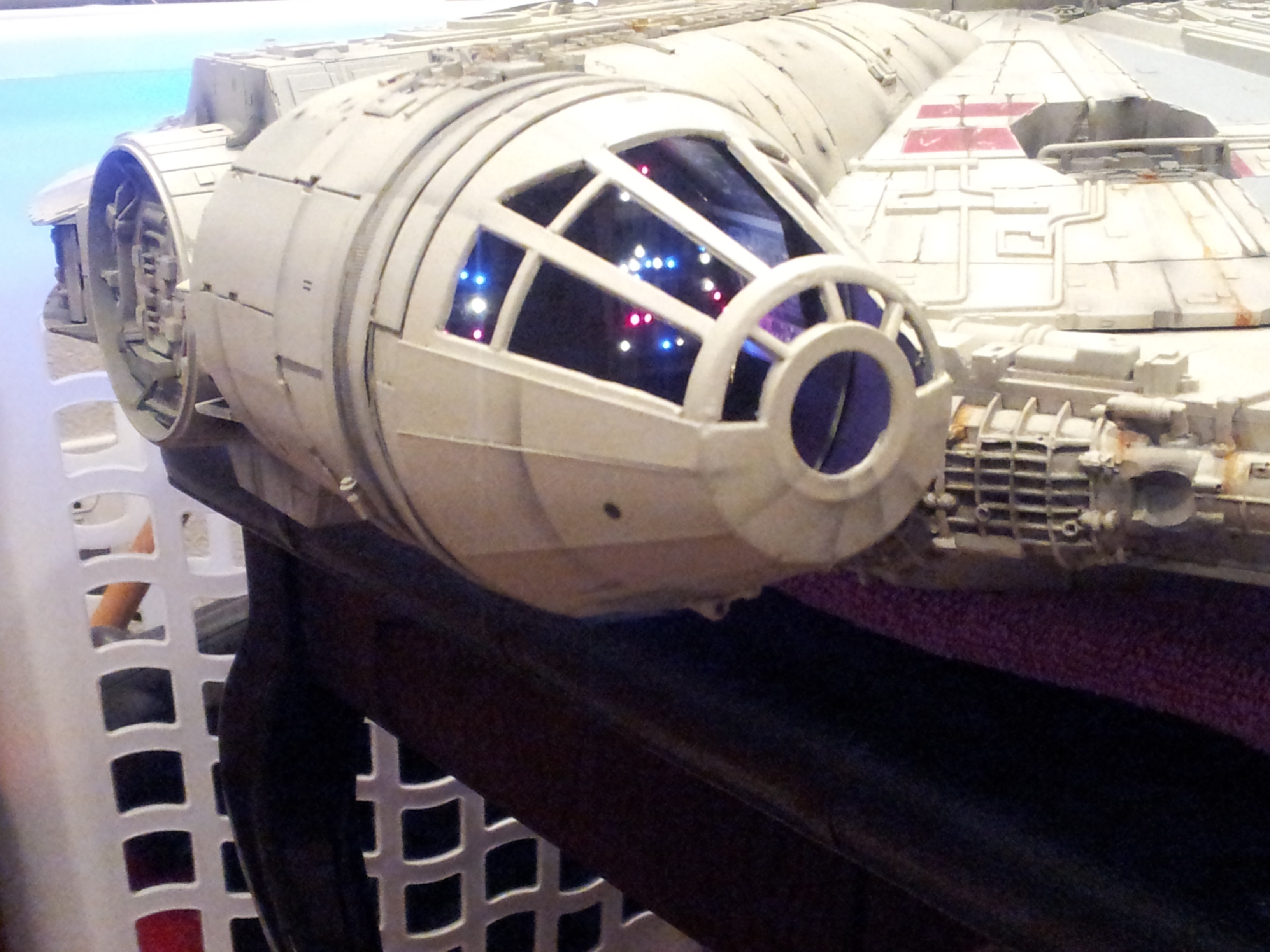

I've been working on a new Hasbro conversion and so far I'm much happier with the results. I have a lot of painting left, including streaks, rust, etc... This time I was going for more of a prop replica accurate version. The first thing I did was thin out the side walls (which drove me crazy that I didn't do last time). I cast many parts using molds from my master replica falcon and this time made a cockpit from scratch. I did a lot of my own lighting this time including cockpit mandible, and engine lights while keeping some of the original sounds from the toy. Not done yet, but tell me what you think.
WOW - my first thought was "...that's no Hasbro..." ;) It looks outstanding.
So, PLEASE show us some "making of" pictures of the conversion process.
You're one of the best Hasbro Toy modder that I know :thumbsup thanks a lot for sharing

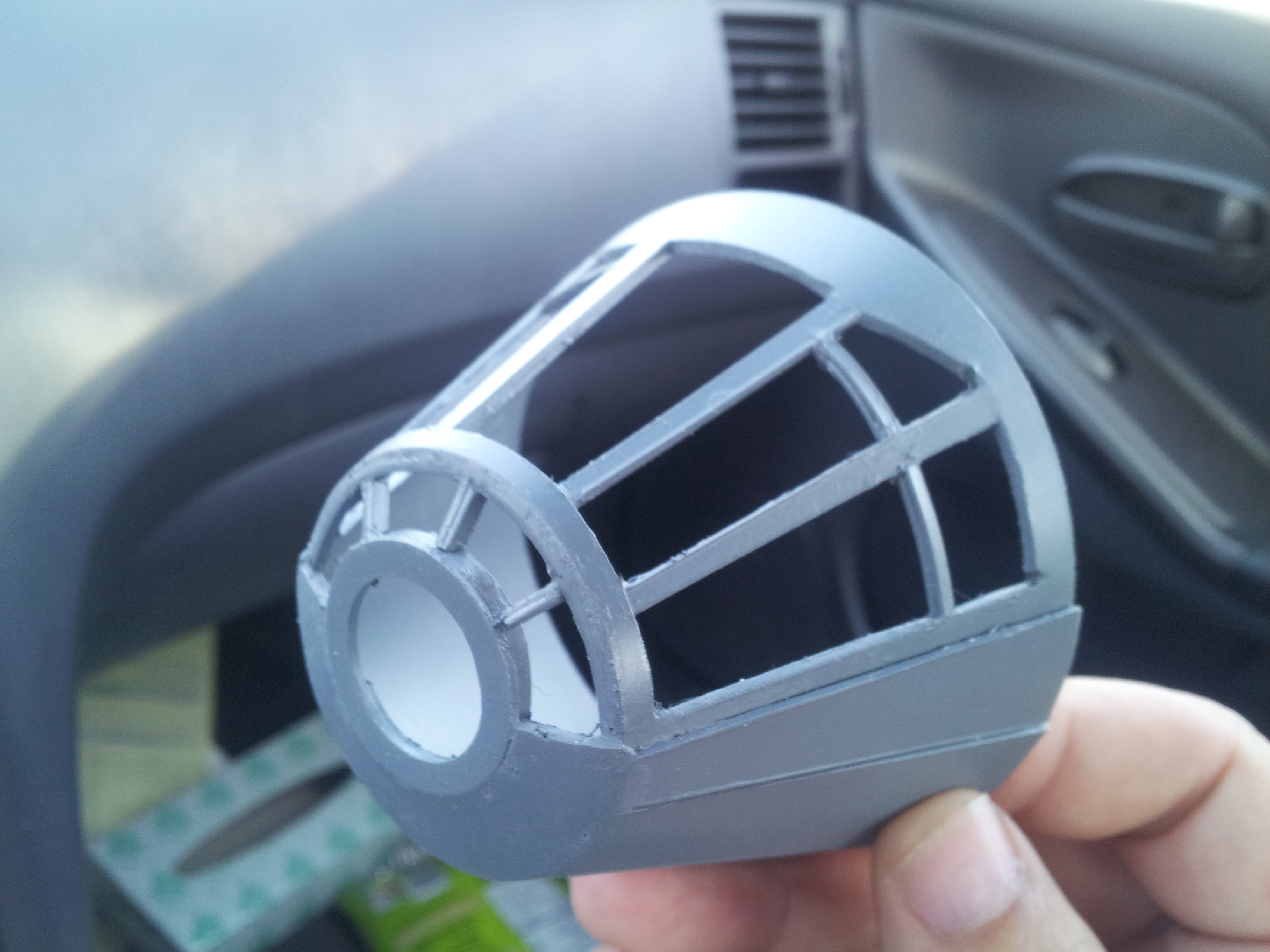

Thanks Homecine. Here are some early pics. I was anxious to start even before I got my hands on a Hasbro Falcon off Craigslist. I started off with an oil funnel that fit perfect for the nose cone of the cockpit once I cut it down. I then added some styrene for the cross bars and armor plating. (photo is of the ruff before sanded version) I then started fitting it with some 3" mail tubing.

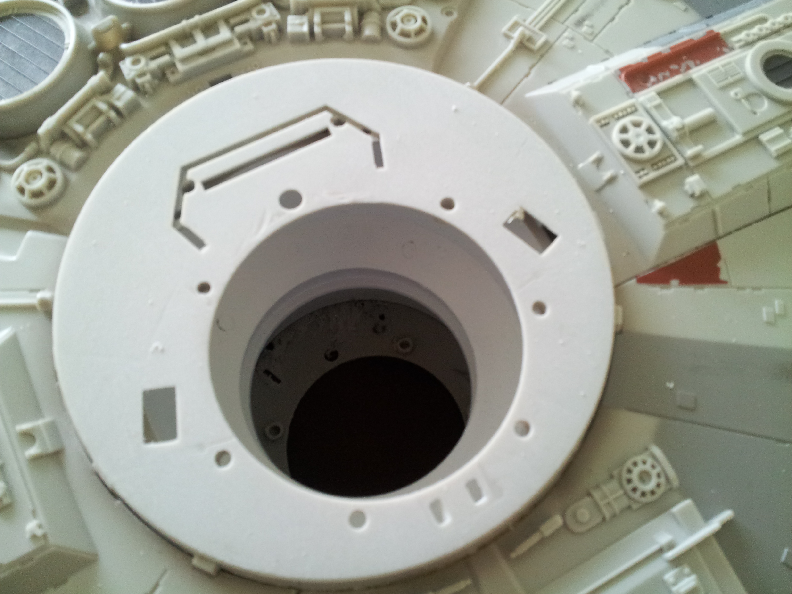

After I cut down the sidewalls, mandible height, cut out the cockpit/landing pads, and gutted the Falcon I started finagling the mandibles so they turned in. See below. ( You can also see the beginnings of the new upper gun turret.)
I then added inner support using plumbing parts I found at the hardware store then cut down to fit inside. This was also to become the support to mount the Falcon on a stand.
View attachment 206230View attachment 206231
View attachment 206232View attachment 206233View attachment 206234

It would be great if you can post some pictures how you have done the "new" sidewalls, cockpit-tube, the short new "side-Tubes" and
from the underside of the (nearly) finished model. Thanks in advance and again ;) it's so impressive what you've done with the BMF...!!! :thumbsup

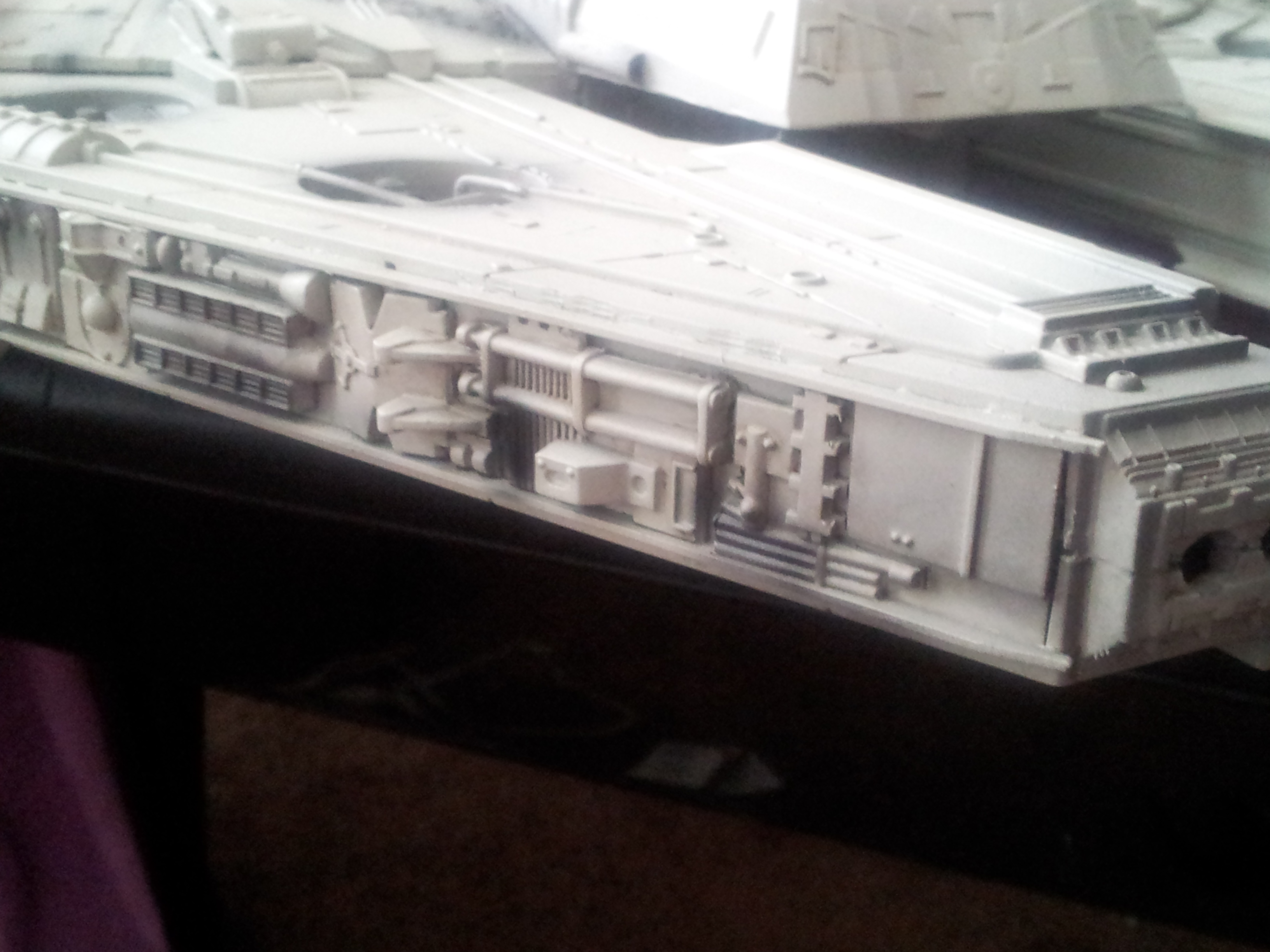

Here is what I have as for pictures of the side walls I made molds of some pieces such as the car transmission parts, but for the most part I reused the ones from the original toy. It is surprisingly accurate, just out of proportion. I sanded off the base plate they were mounted to and glued them on individually. Not perfect but pretty good.
As for the cockpit tubes I just used 3" mailing tubes and mounted armor plates and details to it. I only have the one picture of the construction of this in the previous post. They are very strong and light. I mounted the tube to the hull by cutting a slit in the end of the tube and sliding it onto a plastic plate I mounted under the the top of the hull. Then I reenforced it with other pieces inside.
Hey kokkari great looking build! For the oil funnel did it just fit or did you have to cut it down to 3"? What is the overall length of the filter and smaller diameter?
Thanks. I would say the hardest part was finding an oil funnel with the right shape. I don't remember the dimensions, but it was short and stubby. I had bought a few and tried them out before I happened to find this one already in my garage. I did measure the fat end out at 3" and then took the length off the master replica version which was about 2 1/2 inches. (cone only) Sorry, I know, not much help.
Thanks Kokkari. Wow only 2 1/2 inches i thought it was a little longer but that could be why Im not getting my shape quite right I will have to go pick up a few funnels and mess around with them a bit. Did u scratch build those front boxes between the mandibles or just cut down the one on the toy?
Just keep in mind the 2 1/2 inches is the cone only where it starts tapering down. I just cut down the boxes and used the toy version.
