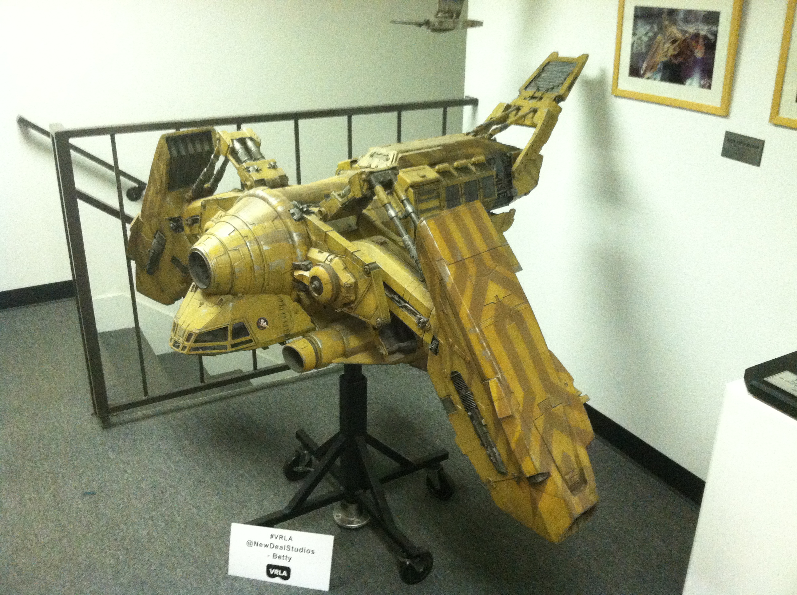

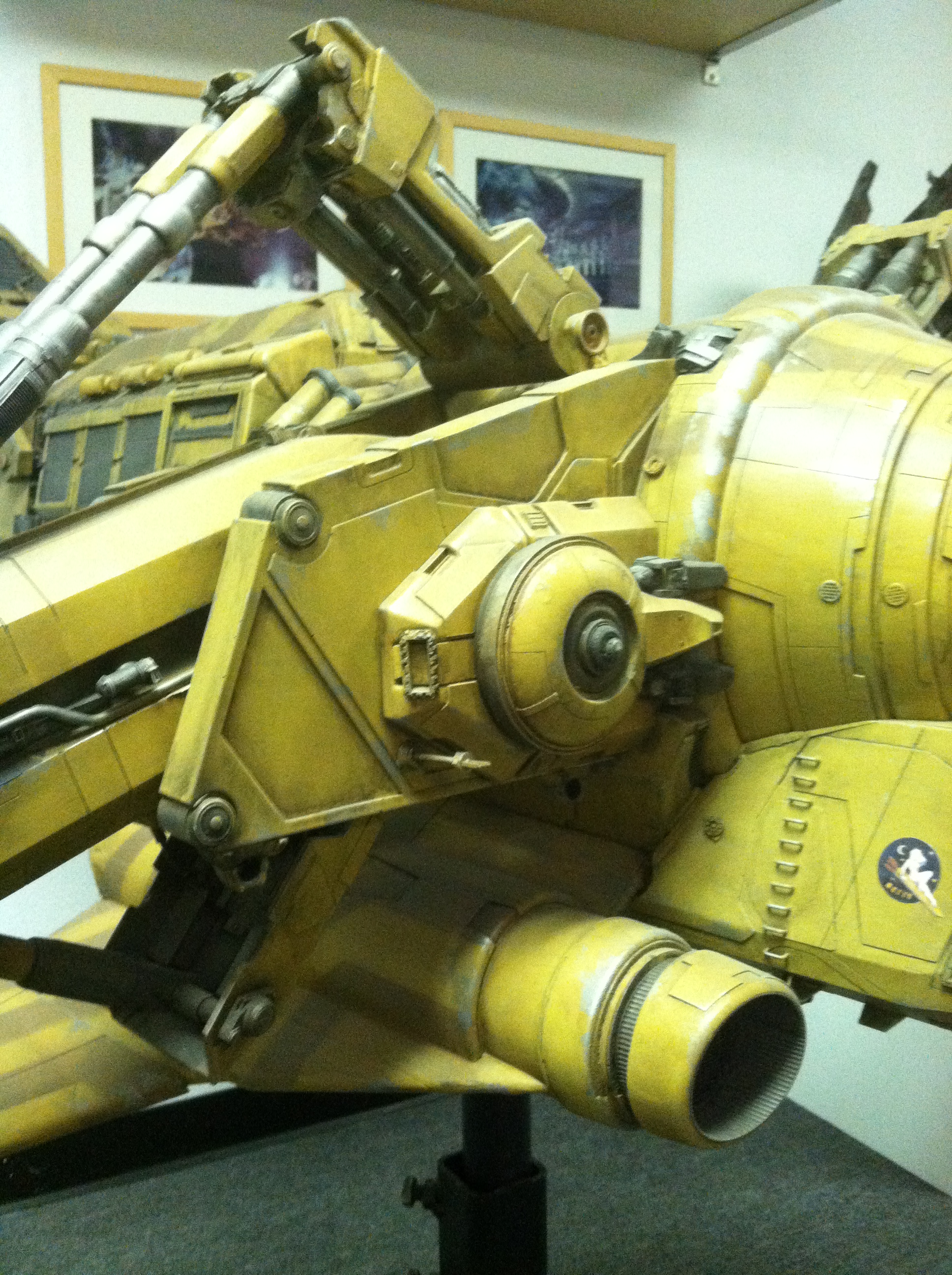

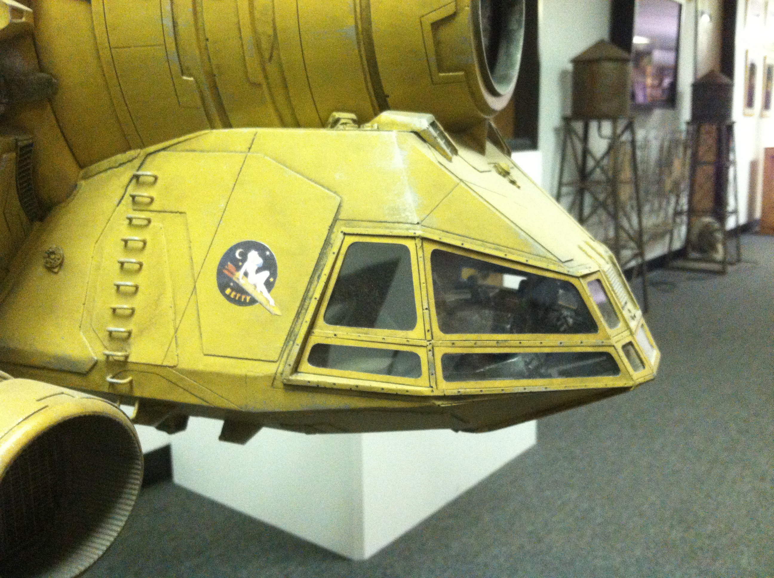

I was at New Deal Studios for a tour this year and got a few photos from the tour. I don't know the history on this model but I thought I'd share them, in case they are of use. Sorry for the crummy camera phone action.
Thanks for sharing zookone! Pics are just fine. That must'v been a really fun tour. Was this a public invite or did you have an insider pull you in?
