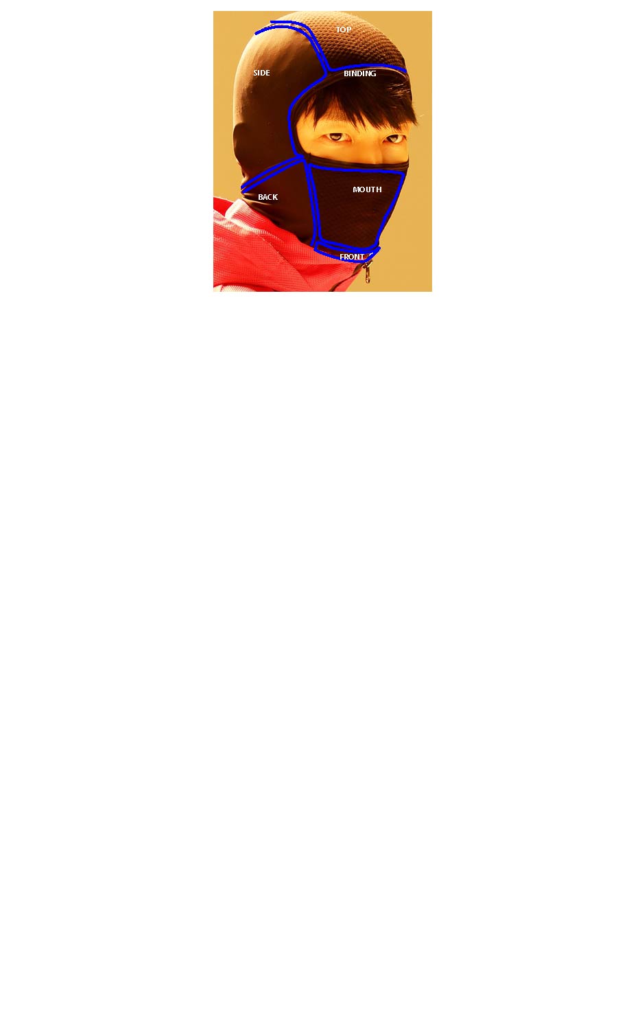

From the analysis of existing images I have identified the following separate pattern pieces and have applied “names” to each piece with the hope of providing a common, if perhaps not precisely correct, terminology to aid in our group communications. A labeled image will be provided to support this terminology. Those pieces and their composition are;
Center Top Panel (Top) – stretch fabric with mesh overlay
Mouth Panel (Mouth) – stretch fabric with mesh overlay
Front Neck Panel (Front) - stretch fabric
Back Neck Panel (Back) – stretch fabric
(ASSUMPTION: This is a single piece patterned to fit, complete, and fill, the puzzle-piece hole produced when all other pieces are joined.)
Side Panel (Side) (2 separate pieces Left and Right) - stretch fabric
Eyehole Binding (Binding) – stretch fabric
Two additional garment elements are not pieces at all but instead are “negative” spaces created by the garment. These are often not specifically called out in a design, but they exist and have important characteristics necessary for the proper use and function of the garment. The first is perhaps the most important element, the Eyehole. The second is the Hem of the balaclava, which like the hem of a “hoodie” allows the wearer to put their head into the garment.
My next post will provide an overview of the pattern pieces and their relationship to one another to form the complete garment.
i'm in for balaclava. Still didn't find informations about the mp5 straps. Can't find yet the exact buckles and carabiner
Here is an image of the balaclava with my terminology for the individual garment components.
