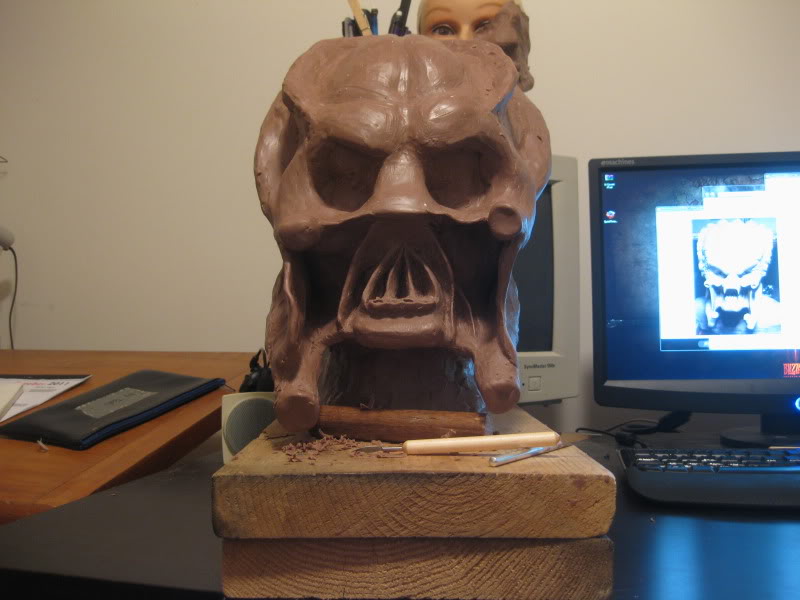

Ok I suppose I shall post my progress pictures. I got my clay a couple of days ago and I started layering on the clay. This is the first time for me sculpting not digitally so advice from you pros is recommended.
Thanks. Having a tough time with the mandibles at the moment. Decided to move to another area and come back to them later.
While roughing, I do the madibles last. That lets me concentrate on the head and then I move into the mandilbes. In AVP they actually sculpted the head without the mandible to add them later. Granted this was for movement isues, but they did do it.
Proportioning the suit to the wearer is the best way to go. I don't have too much to say about the armor sizes other that go with what looks right. I kindof winged it on my sons suit and some full sized pieces worked fine on him.
The mask is something that is hard for most to oversize. If your sister can fit in it, perfect. You really don't realize how big the masks are 'till your sculpting one. They also need to be bigger because of shrinkage. If you haven't worked with latex before expect 5-10% shrinkage from the size of the original. Than can reack havoc on proportions.
The mold and your wood base won't like each other. What you will need to do when the time comes is cover it with something (or seal it). My choice for a base recently has been Melimine.
This is a great start. (y)

Did some more work redoing the mouth. The mouth/mandible is just as tough as I was expecting. Seems to be going ok so far. I haven't use much foul language yet...yet anyway. And I haven't gotten pissed and punched it or thrown it at the wall. And being that there is 20 lbs of clay now that would be a nice sized hole in the wall. Anyway this is where I'm at now. Still not sure about the sizing if anyone has any idea/recommendations/tips and what not.

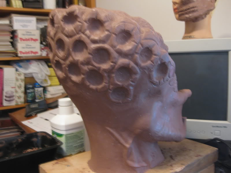

Okey dokey. Here is this weeks progress. Did some work to the brain holder area. Also did some work to the back of the head and put in the top most row of dread holes. Didn't get a picture of it though. Not entirely sure if I like where they are at but I'm gonna leave them for now and see how it goes.
Haven't updated in a while. Been working on the eyes. Then not liking them. Then doing them again. And not liking them. And so on. Eyes are a pain in the wiener. I'll come back to them. Anyway what I did get done is start on the texturing. Which I like so far. I suppose now is a good time to ask if I am going to be able to get a bio on over this fellas face since I have the mouth in some sort of open pose? Or should I rework it so it is closed before I go putting detail into in?
What I have so far. Still playing with options for texture on the dome part of the head and such. Still need to redo the eyes. Also about to start putting some wrinkles and texture onto the mandibles. Sooo if anybody has any advice on whether or not a bio will fit on this half open mouth deal please let me know. K bye.

Some texture progress to report. Still have some work to do to it. Not happy with where it is at currently but I do like the way it is going. So I am convinced that I just need to add another layer or so. And maybe in a few areas it needs to be smoothed down a bit. And the dome needs to be consistent on both sides. I dd them slightly different before to see which i like better...now I need to make them match.
