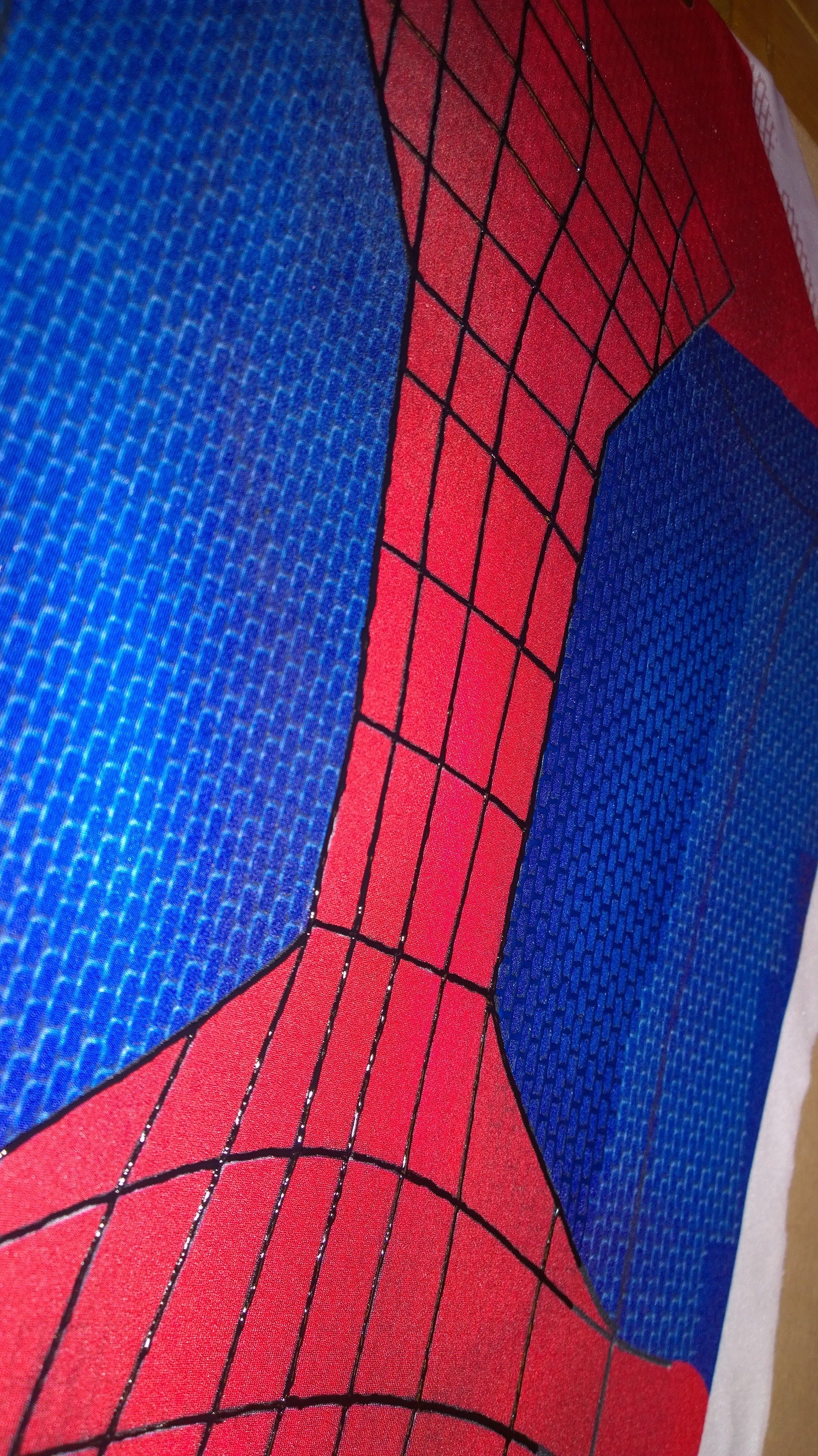

I love the contrast that the Slick paint has to the red. Where as I love how shiny the metallic paint is. It's a bit greyer than the slick paint, and feels more like the Raimi costume. So I'm currently deciding between slightly shiny with high contrast or super shiny grey.
The photos were taking immediately after applying the paint to the fabric so I'm also holding out for them to dry in case they change much once settled. I'll edit the results into this post tomorrow in case they take longer than the quoted 4 hours to dry.
It's a little funny, I snapped some shots after applying, and once the paint had died and have been comparing them all day at work. I was pretty much set on the Metallic Black paint. Then I got home, un-pinned the fabric from the board and the second it fell around my hand my mind was set in stone, it has to be Slick Black.
