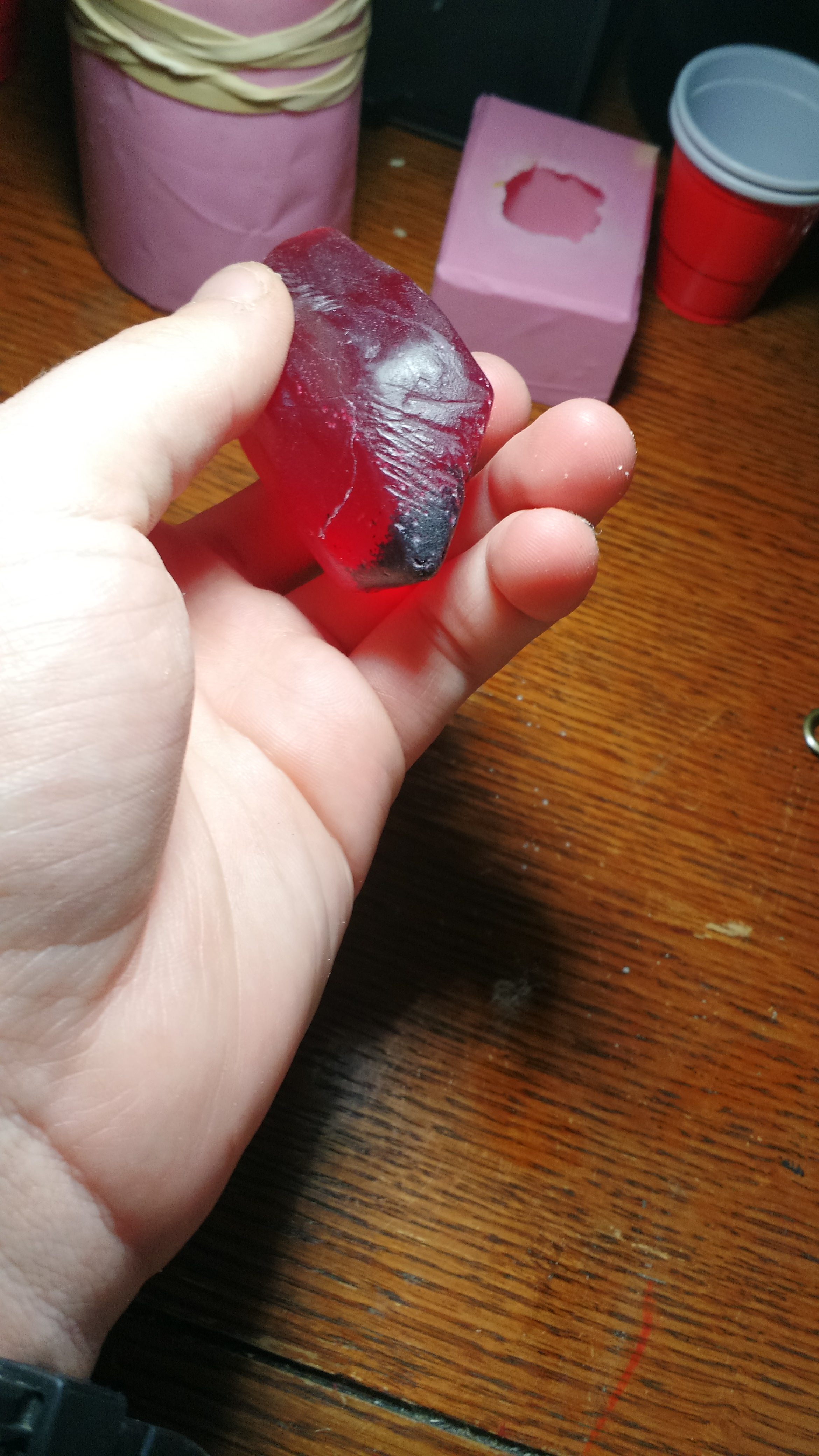

Thanks for the comment! Got home about 30 minutes ago actually.. couldn't wait to bust this sucker open! My master came out just fine and the mold interior looks amazing! For now, I've cleaned the mold up, and powdered the inside. Dumped some colored epoxy resin in for a quick test cast just to see what I am dealing with here, and will probably get a chance to remove that from the mold on Tuesday night. This project has definitely been time consuming considering I started from nothing back in December, but has definitely been worth the wait.

Pulled my first test cast today and it came out awfully nice for a first pull.. once again not bubble free, but that's the point of a test cast is to TEST so you know what needs to be fixed in future casts ;). It's obviously too opaque as well but that should be fixed when a different clear resin is used for the actual run of stones..
Note that I have NOT added the white chipping effect to the stone at all yet.. that will be done later :$

Okay, I was seriously tripping on you only have 3 fingers and 1 thumb. I had to look at the other picture. :wacko

I'll be honest, that came out a LOT better than I thought it would. Curious to see what it will look like with the white bit added but looks great as is!

Thank you! :$. Found afew different way to add the white "creeping-frost" (that's right.. I just named it ;)) look to the stones outside, and I still need to find some time to experiment with it. Once I get the time on my hands I'll be able to post pics!
