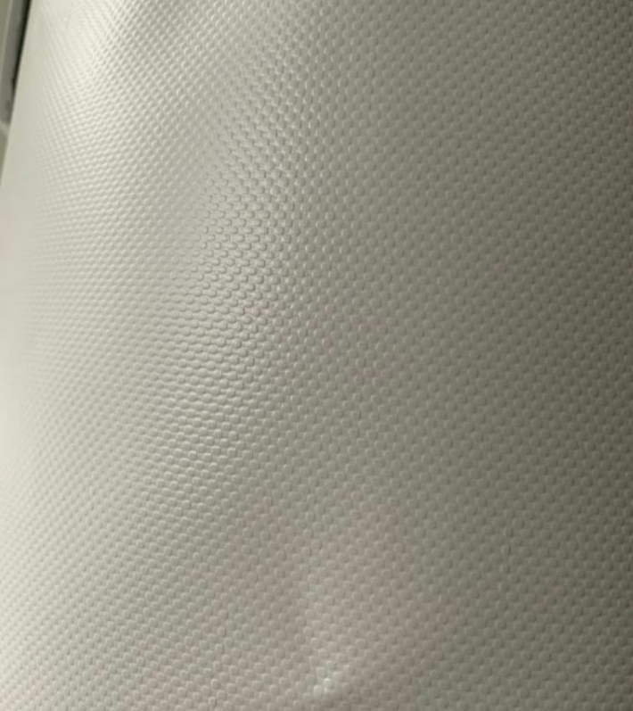

So the example sheet I got sent arrived looking like a matt white however you peel the sheet open (its 2 layers together). Once you peel it open it reveals a white shiny gloss material. Hope this makes sense.
So its left me with a dilemma, keep the matt look or peel and have the really glossy white look.

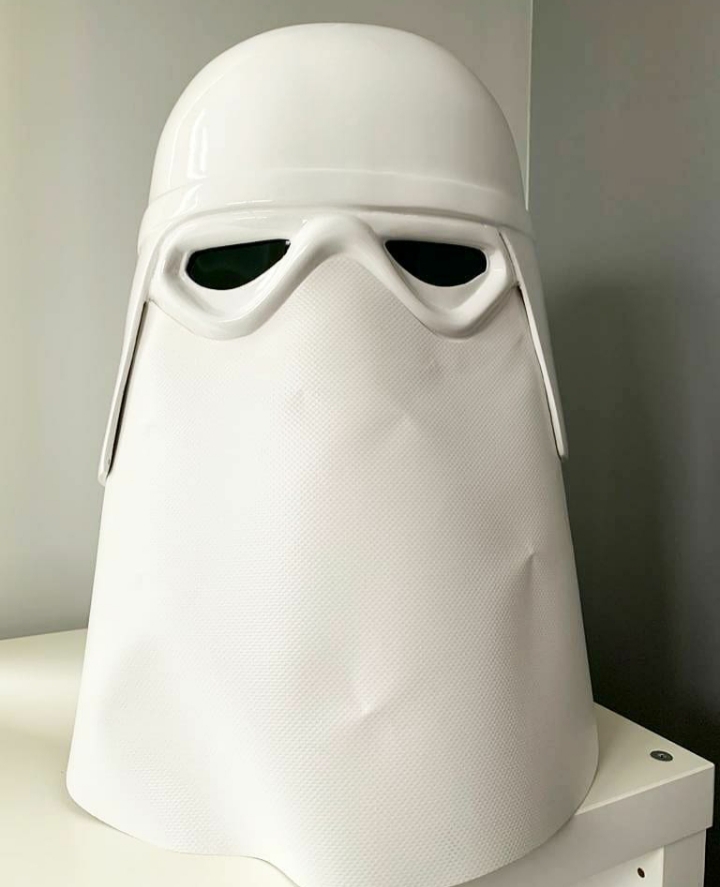

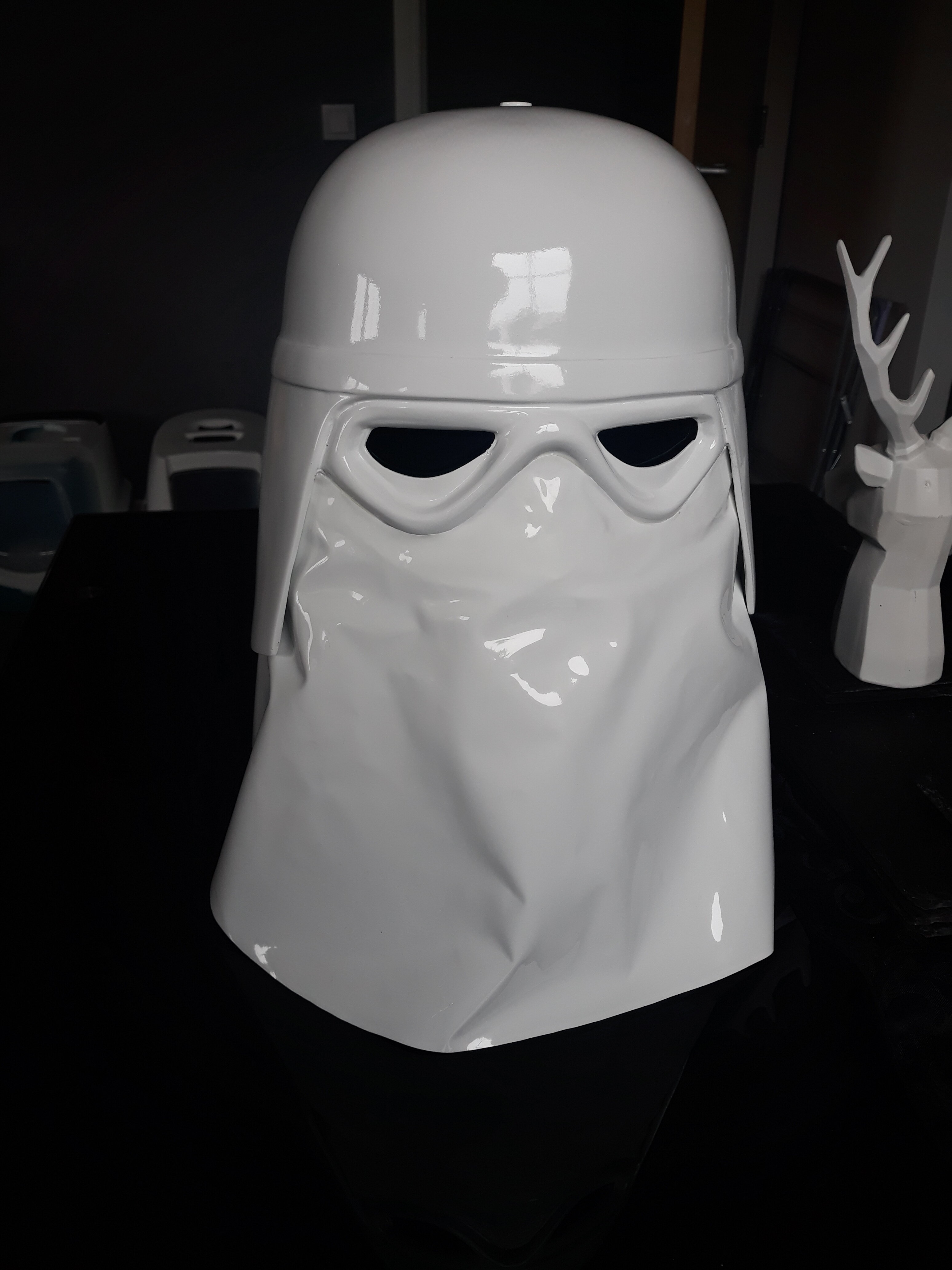

So I ordered a 1m batch of kiss laminate from fabric uk which cost me about £10. The material is actually doubled as its 2 sheets sandwiched together so you end up with (after peeling apart) 2 one metre square sheets.
Long story short, I removed the original cowl, placed it onto the laminate to draw a template then cut out the new cowl. I then used 2 part epoxy glue to stick it on.
This was my first time using material and glue so there are things I would have done differently now that its finished but I can easily remove the cowl and start again as I have lots of material left over
Photos attached show the horrible original cowl v the new kiss laminate. It's not going to win any awards but I love how it turned out v how it arrived.
I may decide to weather it in the future.

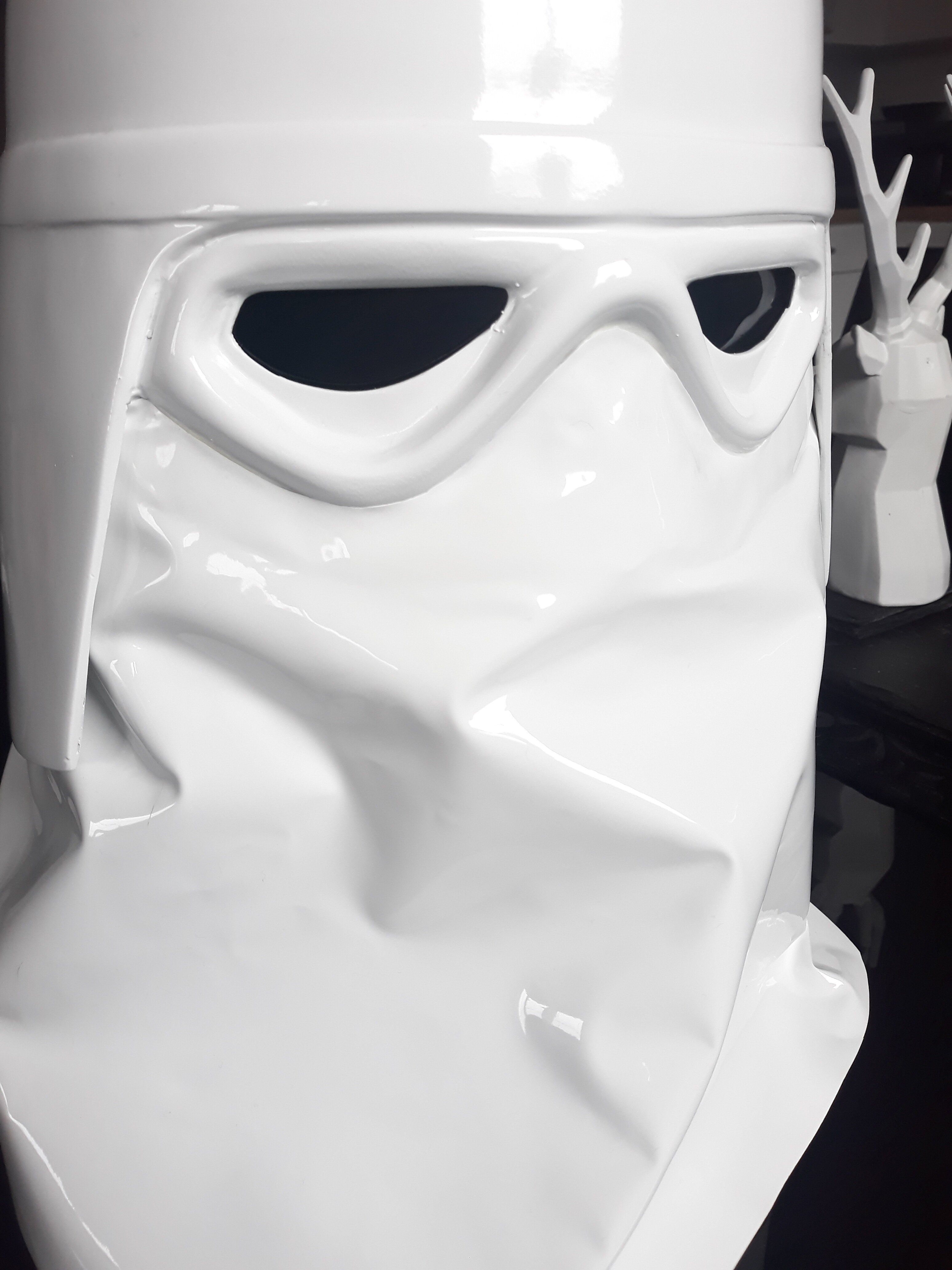

To clarify this for folks who may be reading this in how to prep the kiss laminate for your helmet- when you get it, it's stupid thin and may appear to be only one single layer, however, there's 2 layers there. I usually split this at a corner.
Before you cut the material, you must adhere both sides or else you risk getting permanent creases or a "crackled" appearance (this is present on at least one helmet). You lay the entire section of the laminate on a work table (assuming it's a single square/rectangle shape), peel the top layer from left to right about half-way. Using a spray adhesive, like the 3M stuff, follow the instructions, spray the exposed side and then carefully lay that top layer back down over the bottom. Repeat this on the other half of the material and let let it all dry before you move forward with cutting and fixing to the helmet.
As I mentioned, if you do not adhere the 2 layers w/ the adhesive, you risk a crackling texture or pattern to appear that is permanent when you're handling it. I only learned this tidbit after I realized that the kiss laminate I was sent was not prepped (I assumed it was!). One the 2nd helmet, I prepped it as described above and I have had absolutely no permanent creasing or anything like the crackled texture I described.
I was fortunate that RS sent me 2 unfinished kits to let me assemble myself, so these may appear constructed a differently from their product.
On the left is the first helmet I put together w/ the "crackling" as I call it, the 2nd helmet (current trooping one) is on the right.
