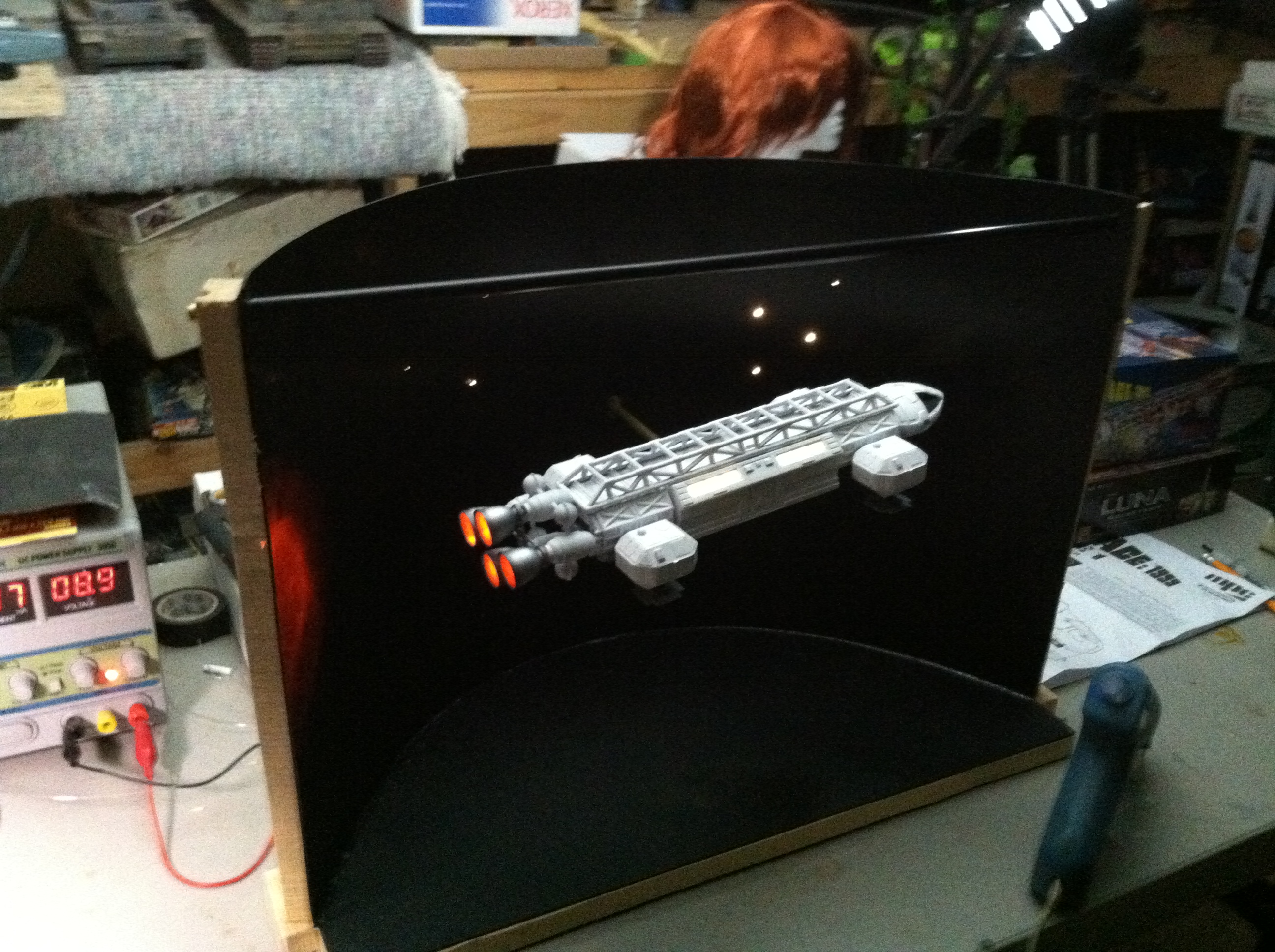

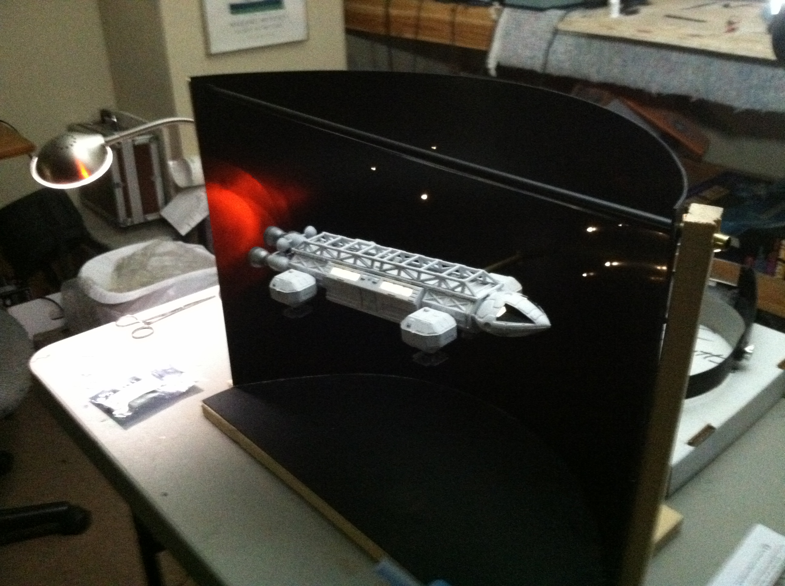

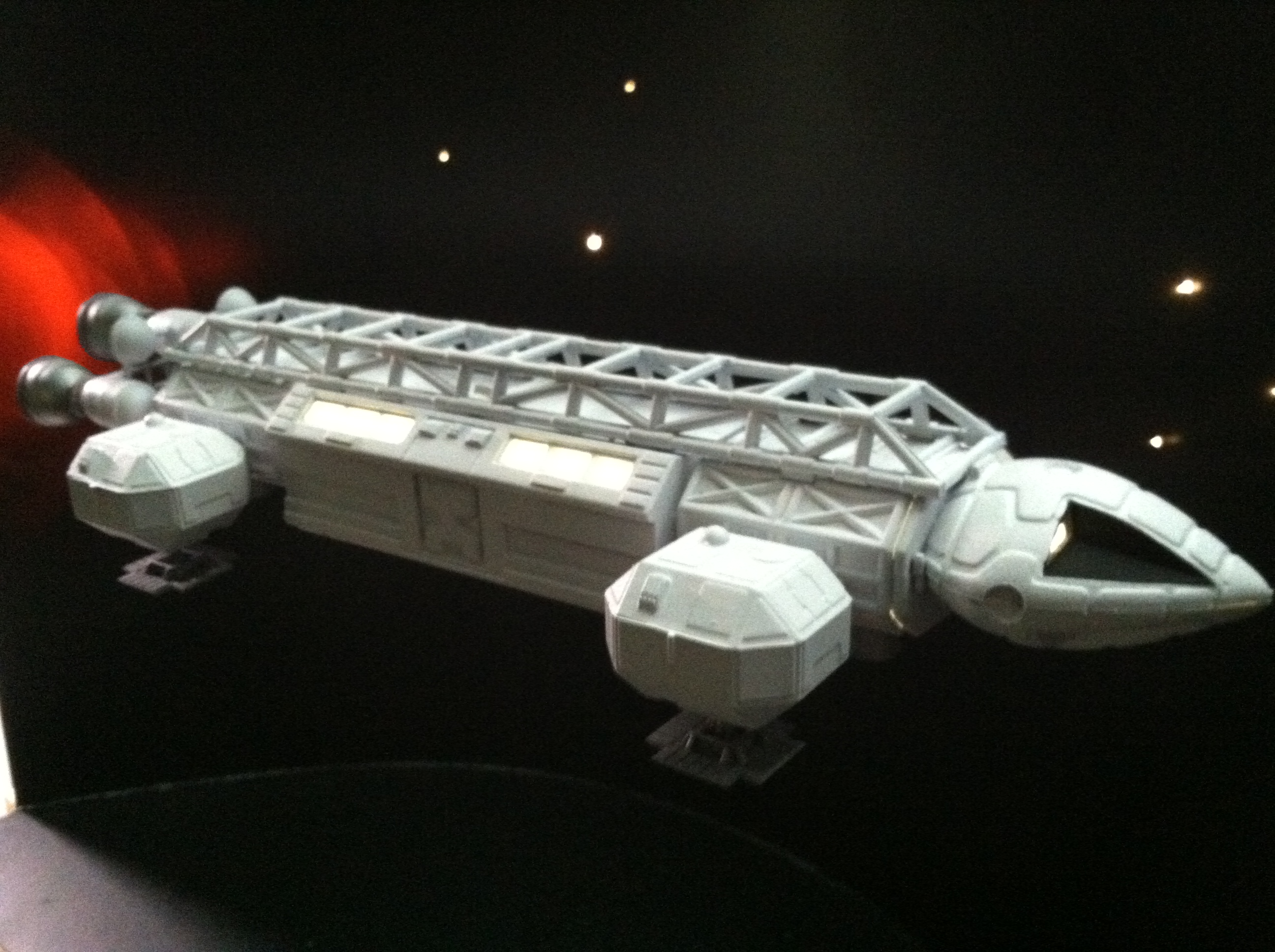

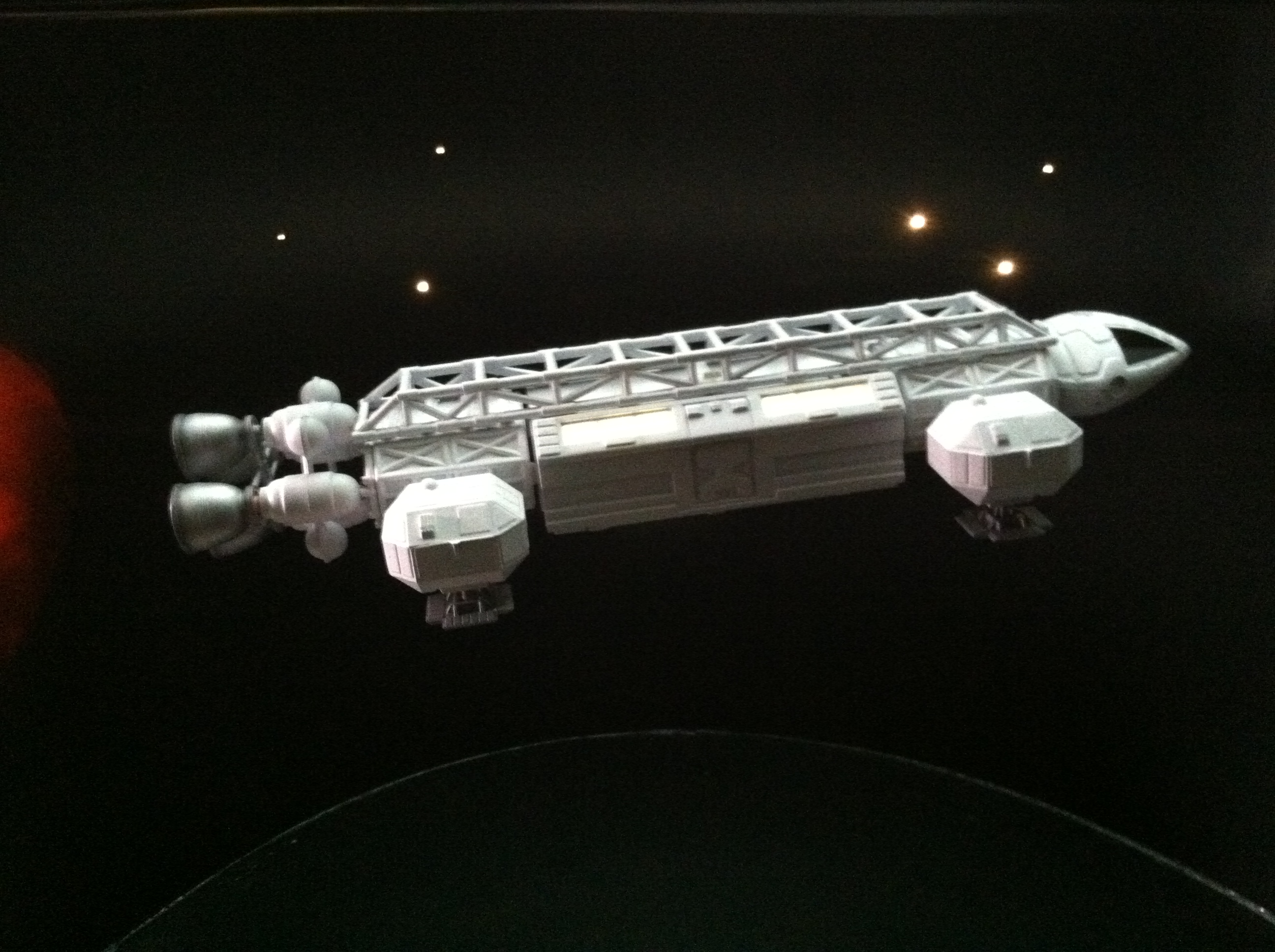

Lastly I worked more on the Eagle. I worked on the diorama a bit more and stared adding the fiber optics for the stars. Soon I’ll start making the Moon’s surface. I also plan to airbrush the star field.

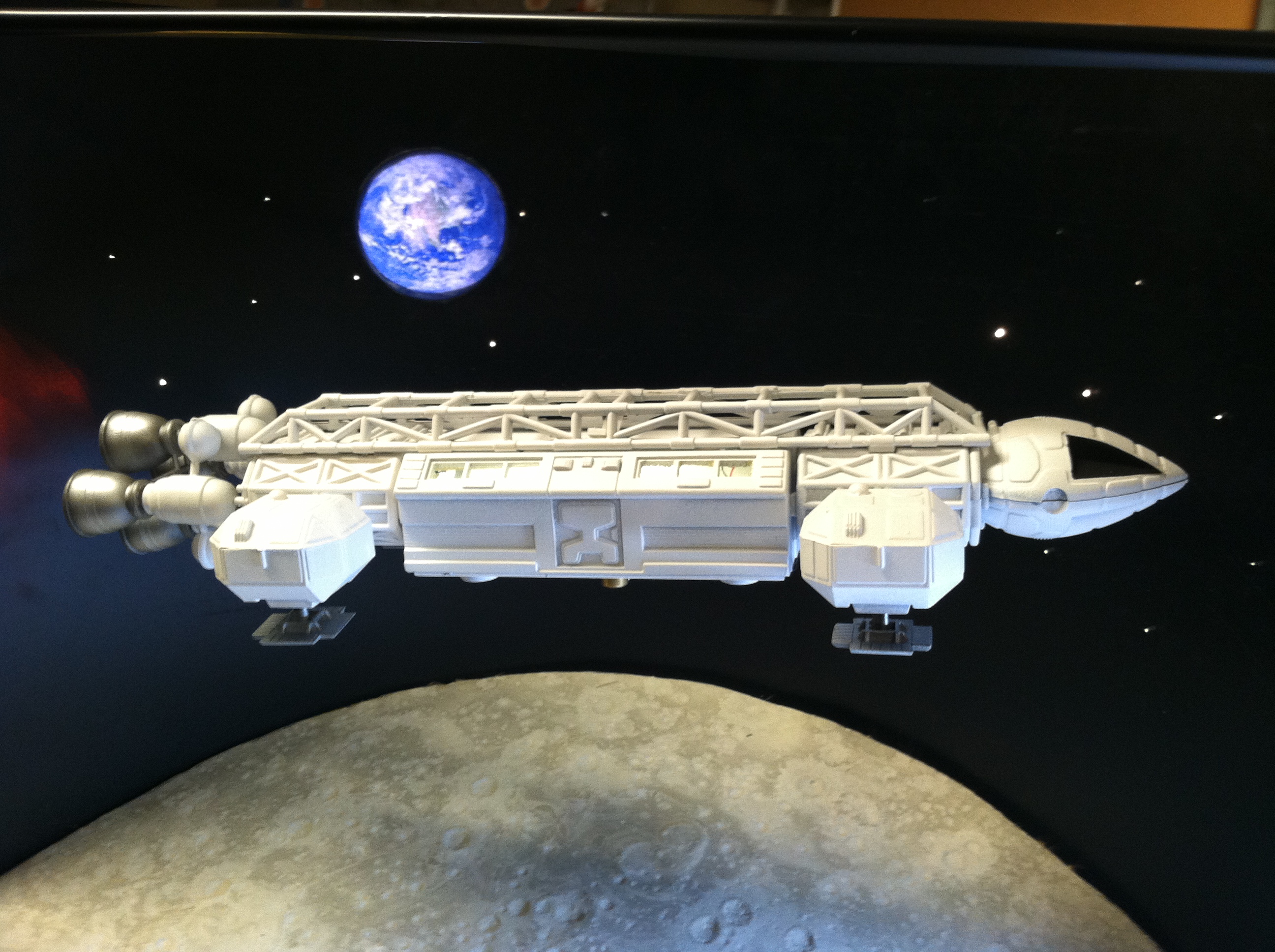

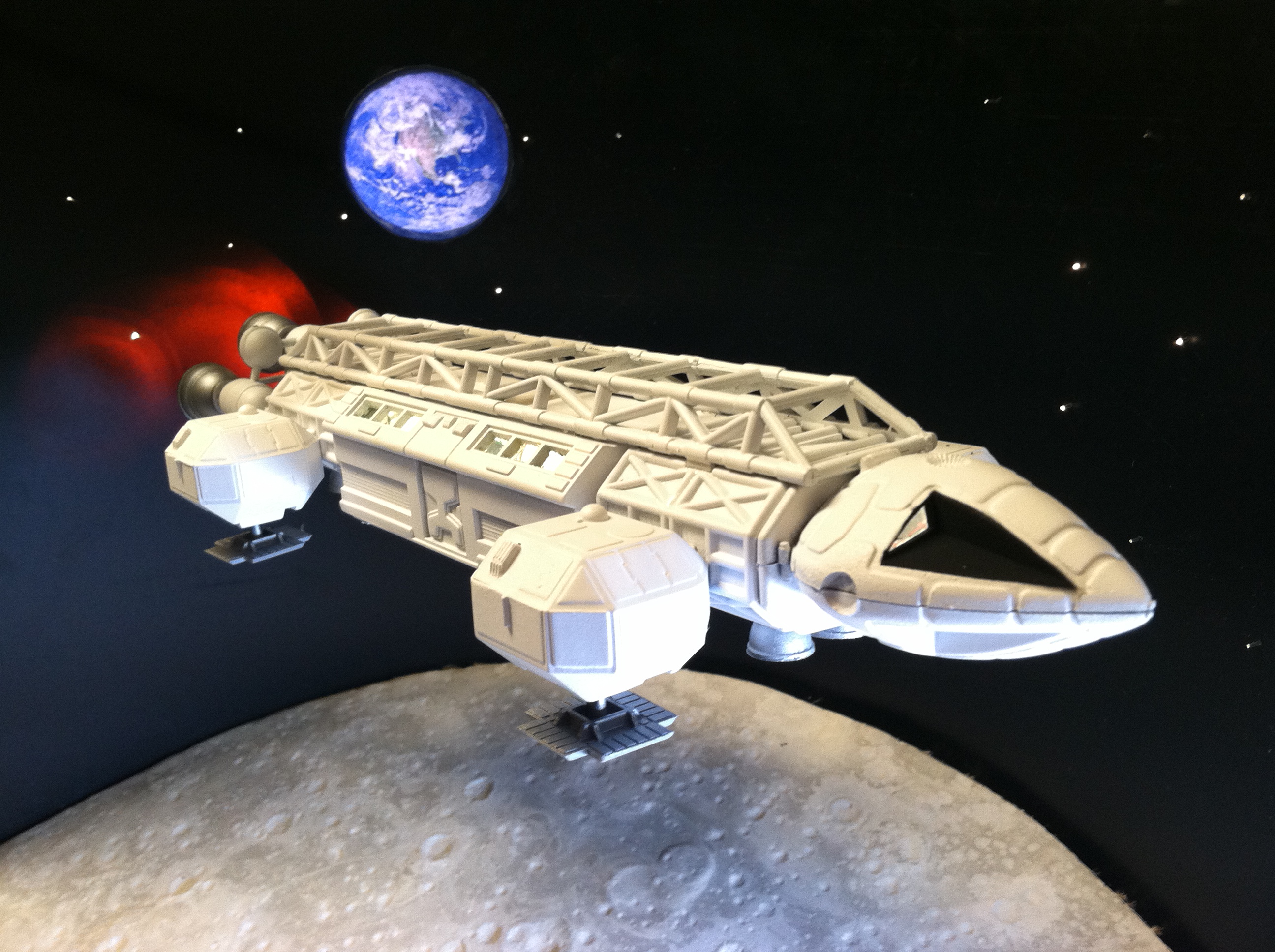

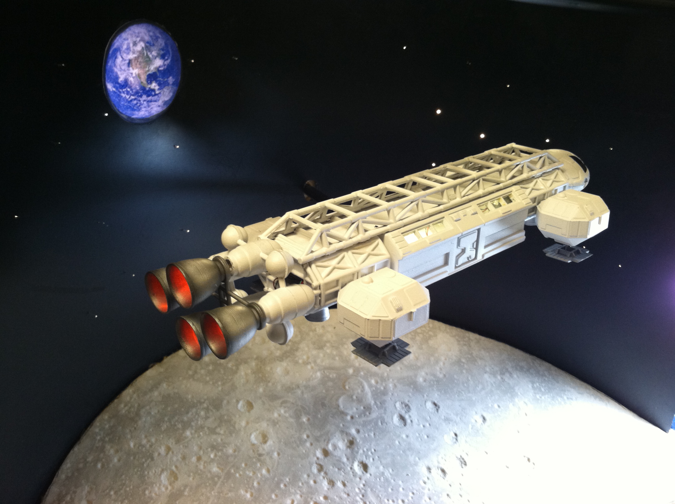

A lot more progress was made on the Eagle and keep in mind that there will be a special SNG video on this build when its all finished. I have been filming every step of the way on B camera. ;)

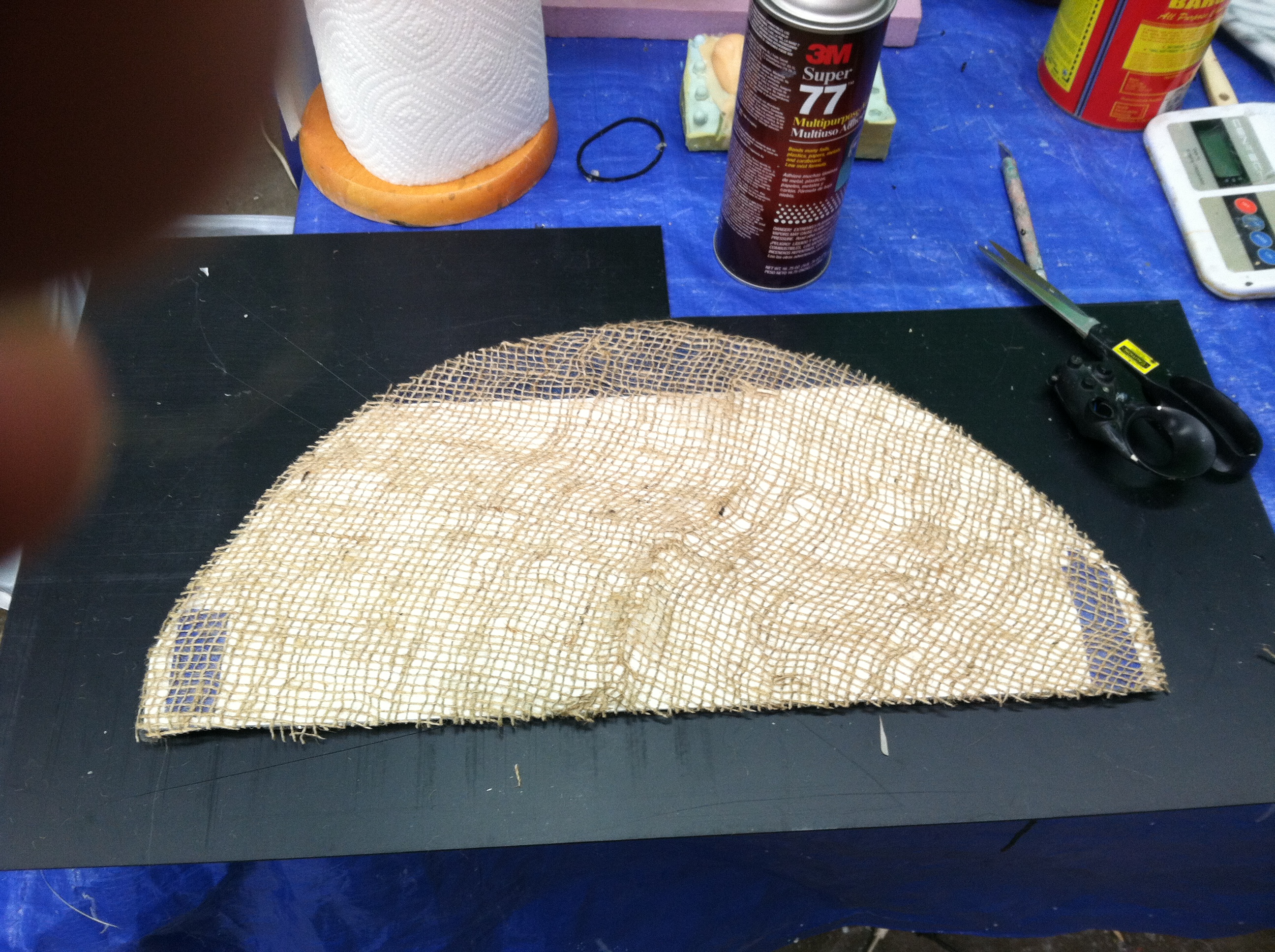

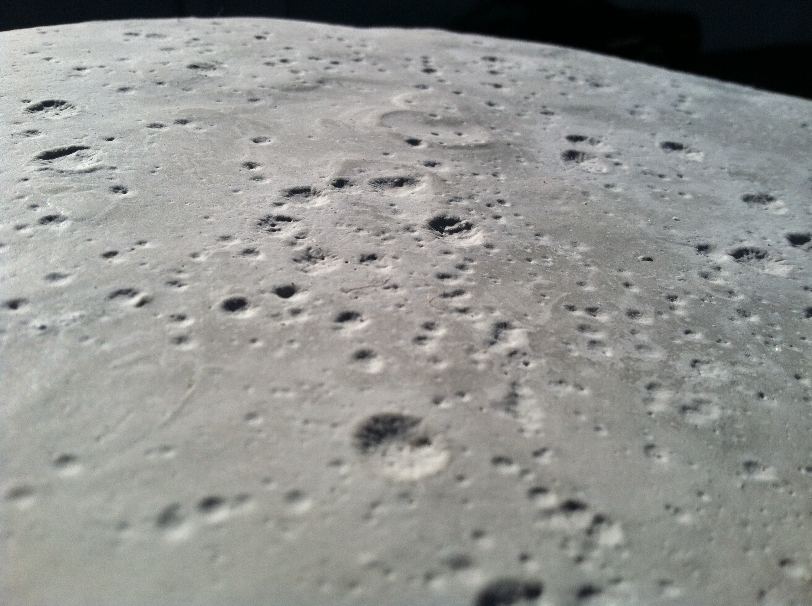

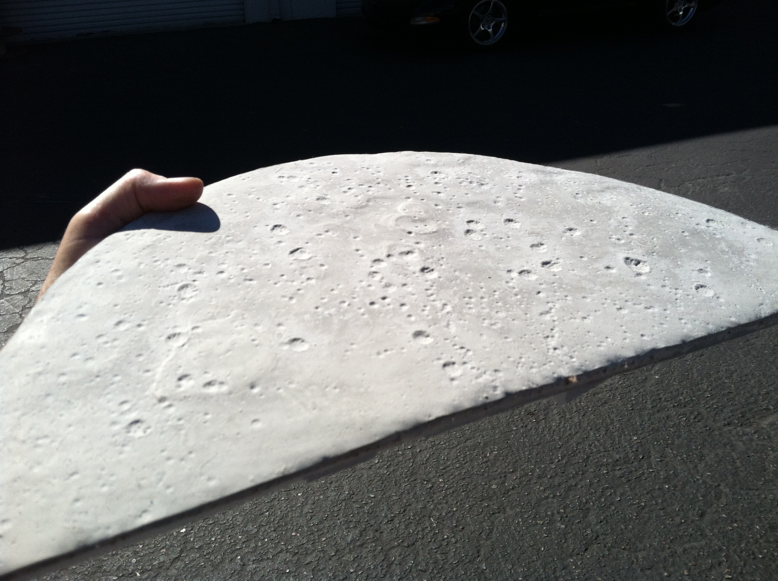

Mary had the great idea to add the Earth in the BKG which is lighted or back lite. The Moon surface was made using burlap on foam core and Ultracal 30 although you could do the same thing with plaster the color of the Ultracal is exact to that of the Moon. I didn't have to paint it. The craters were made while it was still wet. I splattered it with drops of water getting real craters.

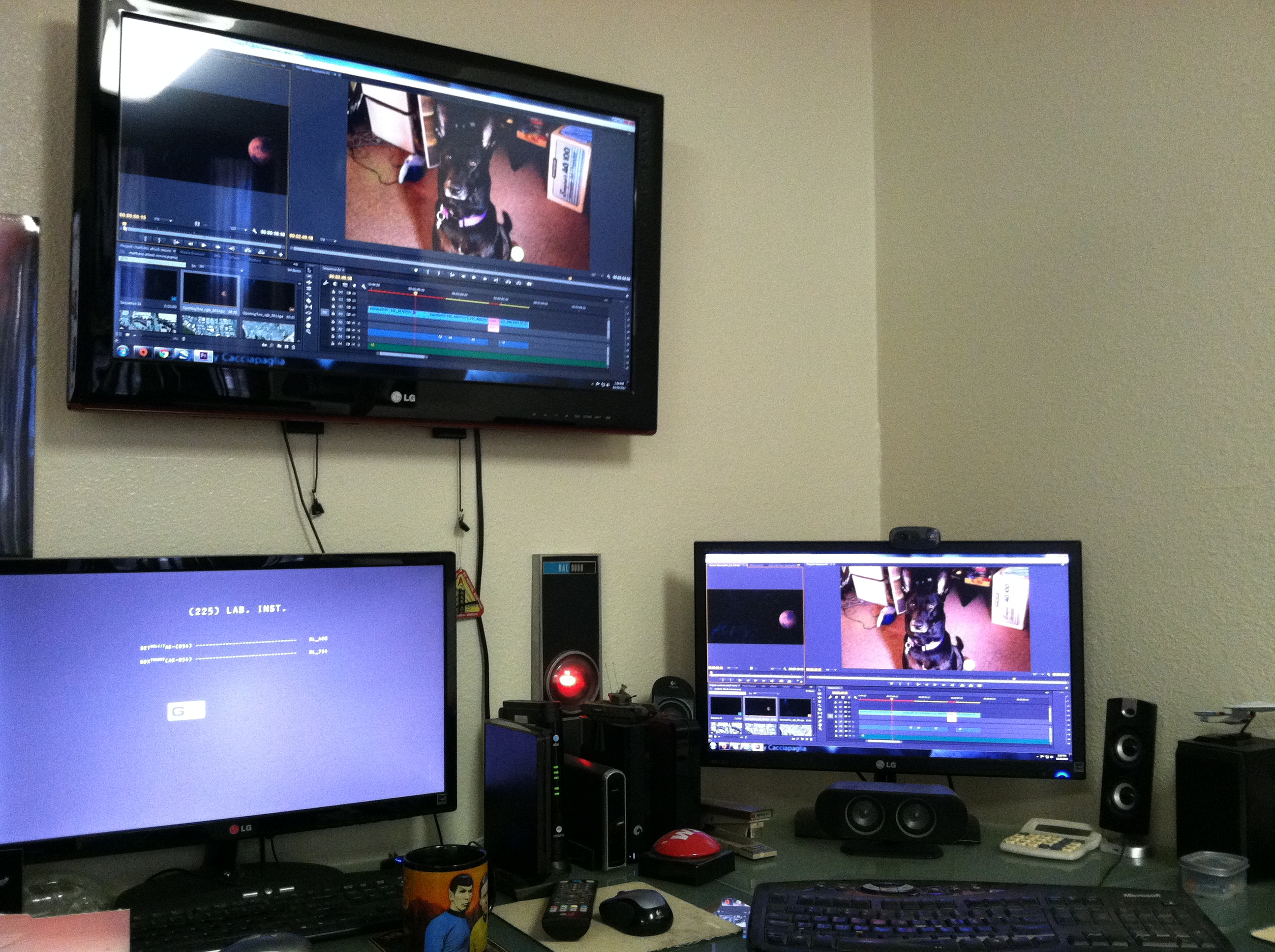

We shot a bunch of scenes yesterday for "Martians Attack SNG" with Rosie. Peanut butter and trial and error got us many of the scenes that Bill and Heidi Hughes wrote with Rosie in the movie. We are bit by bit getting a movie made and it's so cool!

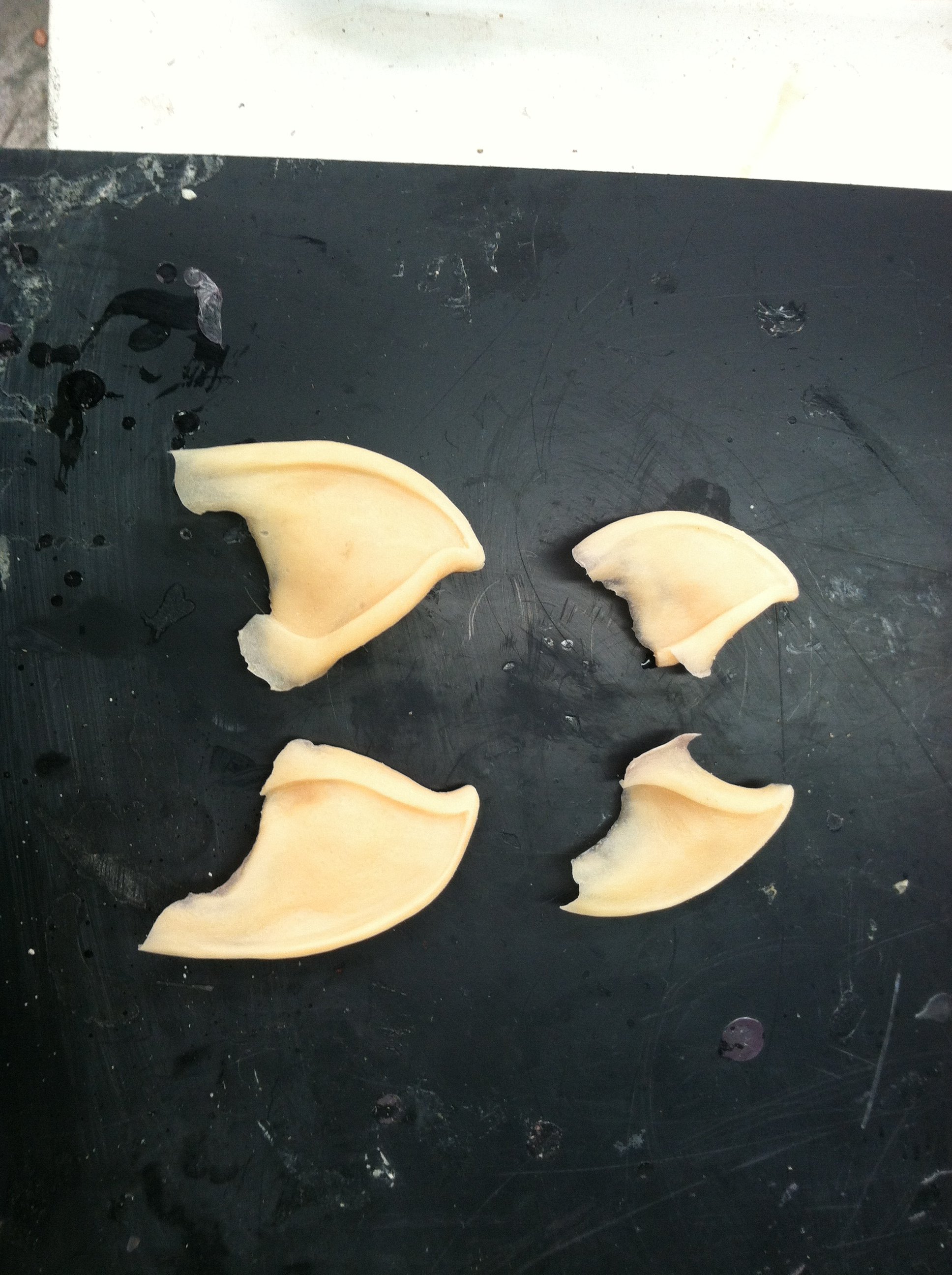

In addition we cast up another set of ears fro Tammy Klein and Glenn Campbell.

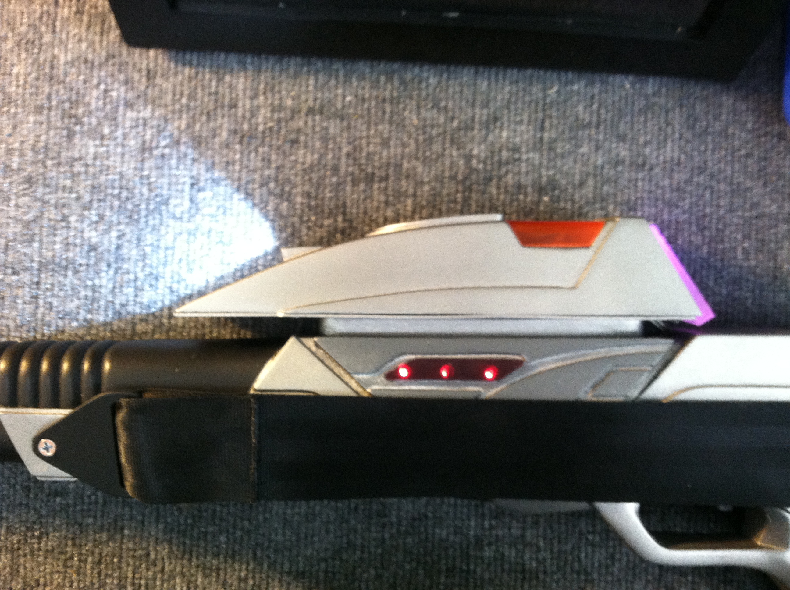

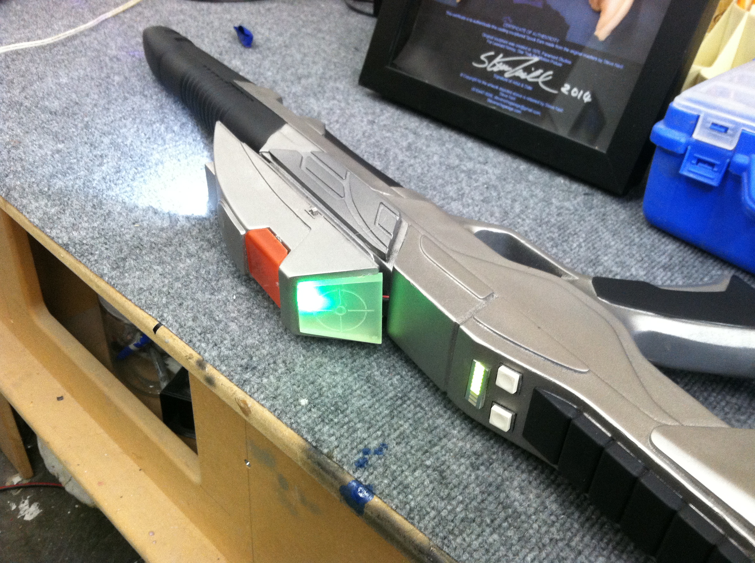

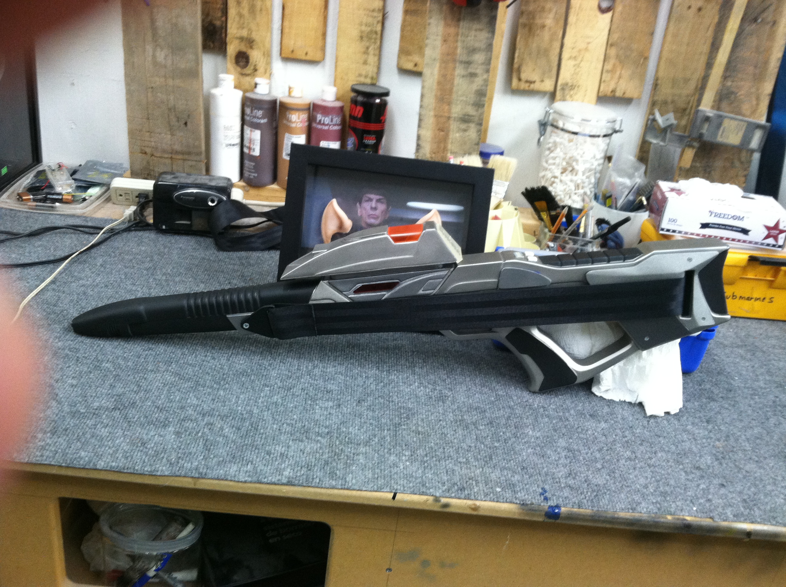

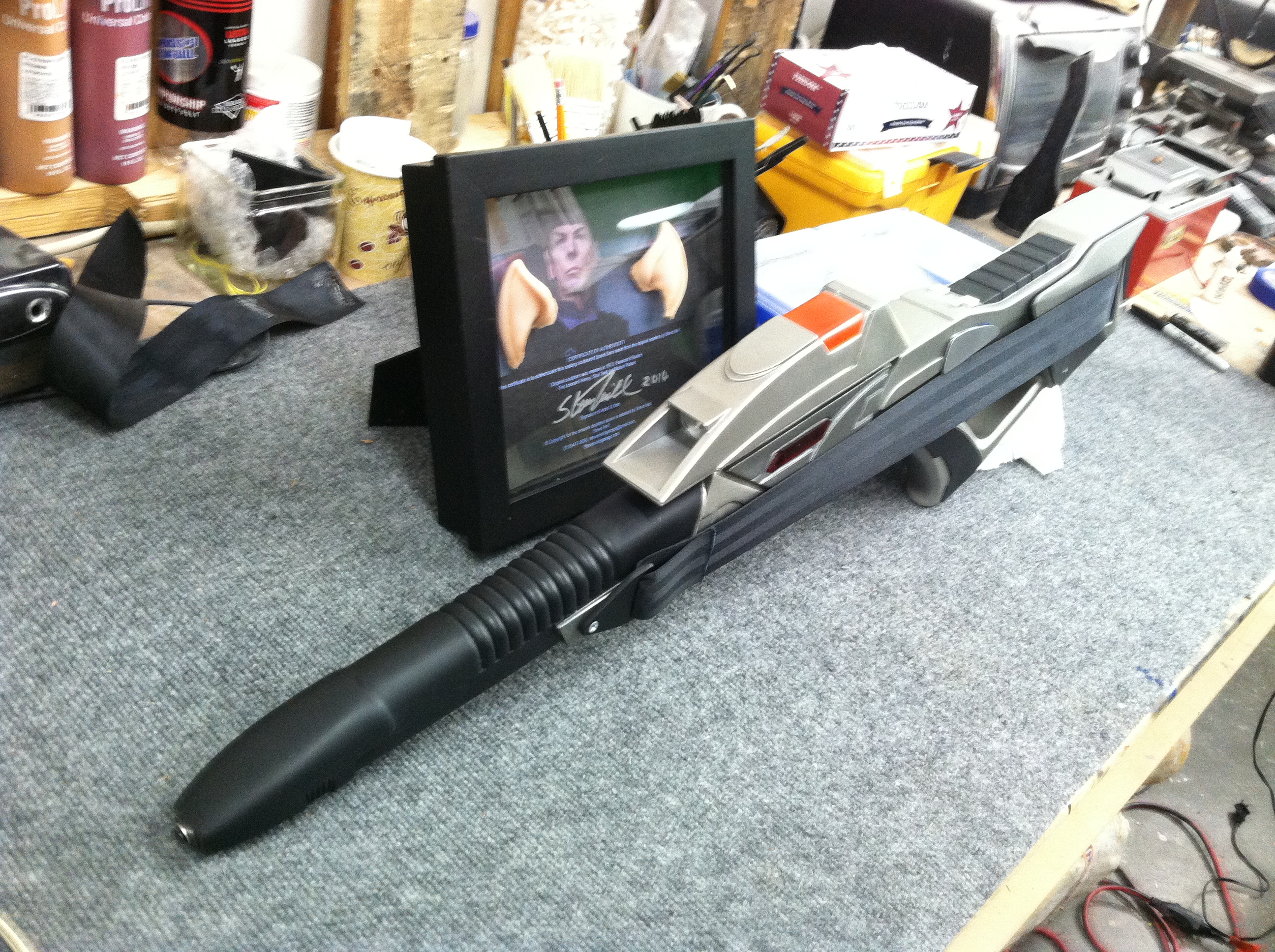

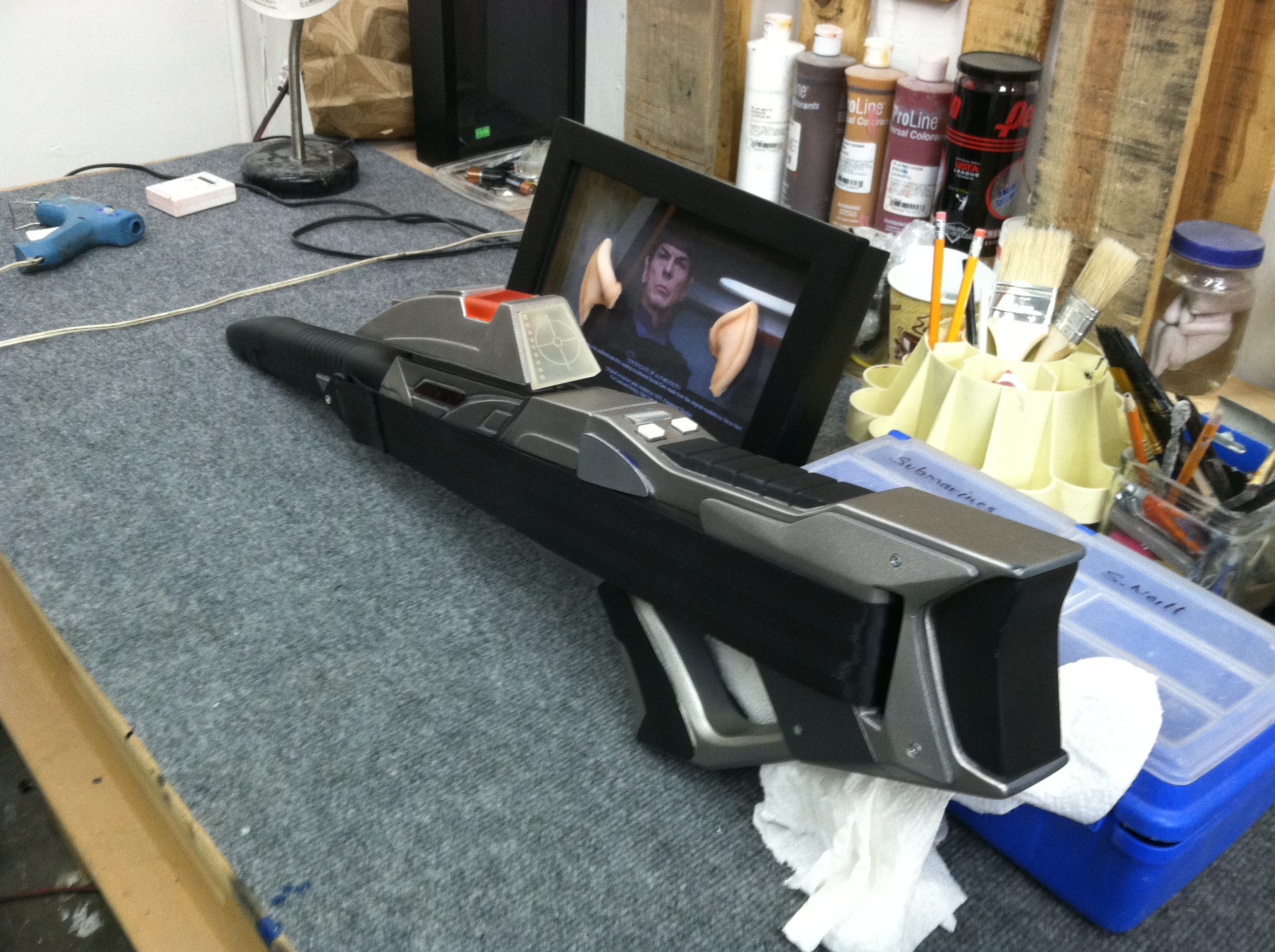

I spent the entire day working on the “First Contact” Phaser rifle that Hank Zimmerman gave us at SNG.
I could not find the recommended paint base color that HMS recommends in the instructions on Roddenberry.com. They said something about Plastic Coat metallic gray. But I did find Krylon Stainless steel. The same color as it turns out. I was unhappy at first with the results as the paint had a textured dark fleck look to it but I later found out that it was a dust and it buffed out to a beautiful stainless steel look.
I did a lot of masking and painted some of the areas of the rifle gun metal. The rest a buffed out flat black to give it a semi flat look.
It’s a beautiful piece and it is nearly done. Another couple of hours of tweaking and she can be hung on our wall and used in the film. Complete with lights and sounds, and let us not forget and blue laser.
