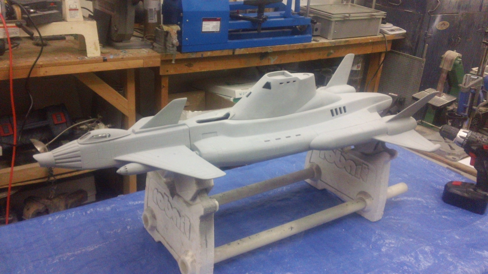

I had a quiet day at SNG. I worked a lot on putting back the missing details on the Skydiver. Think I got much of it back again. My eyes are crossed and need a mule to kick me in the head so they go back again. ;) I know you guys will get that one.
But seriously Monday I need to coat over the chart tape with high build primer most of the day and Tuesday I can remove it and we have panel lines once again. This is really starting to shape up.

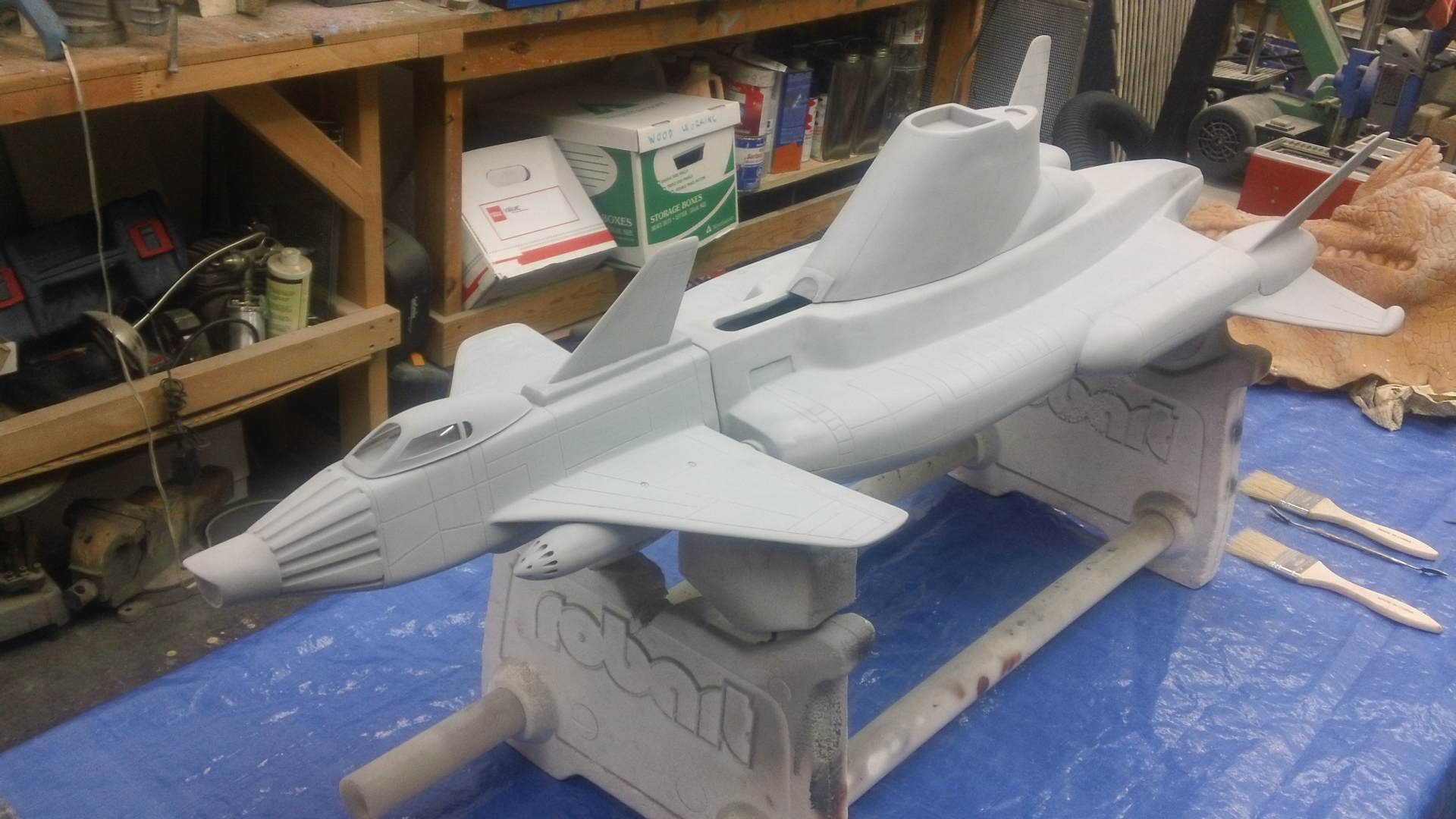

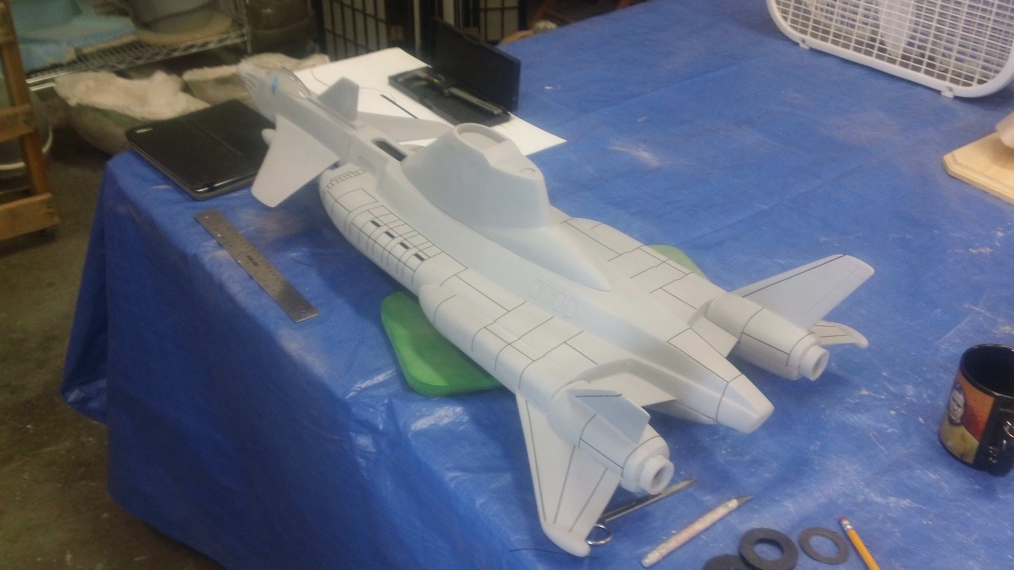

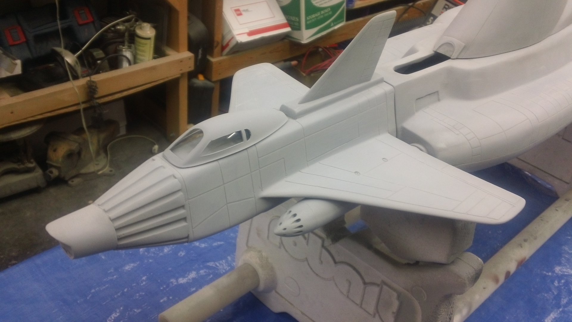

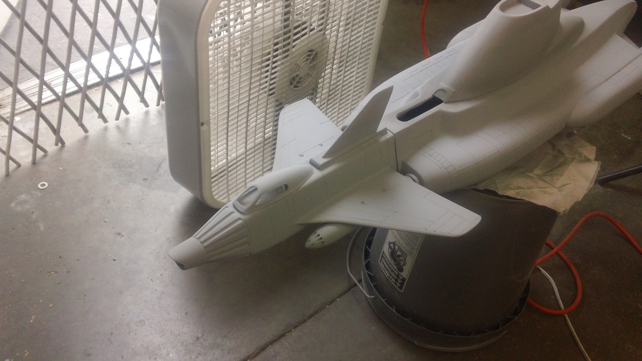

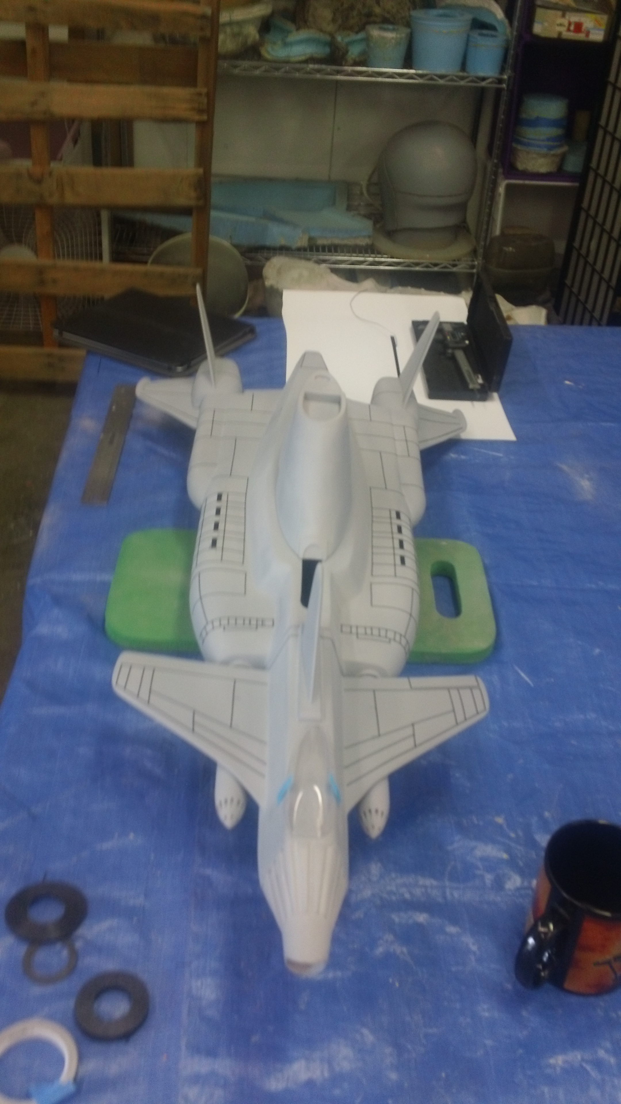

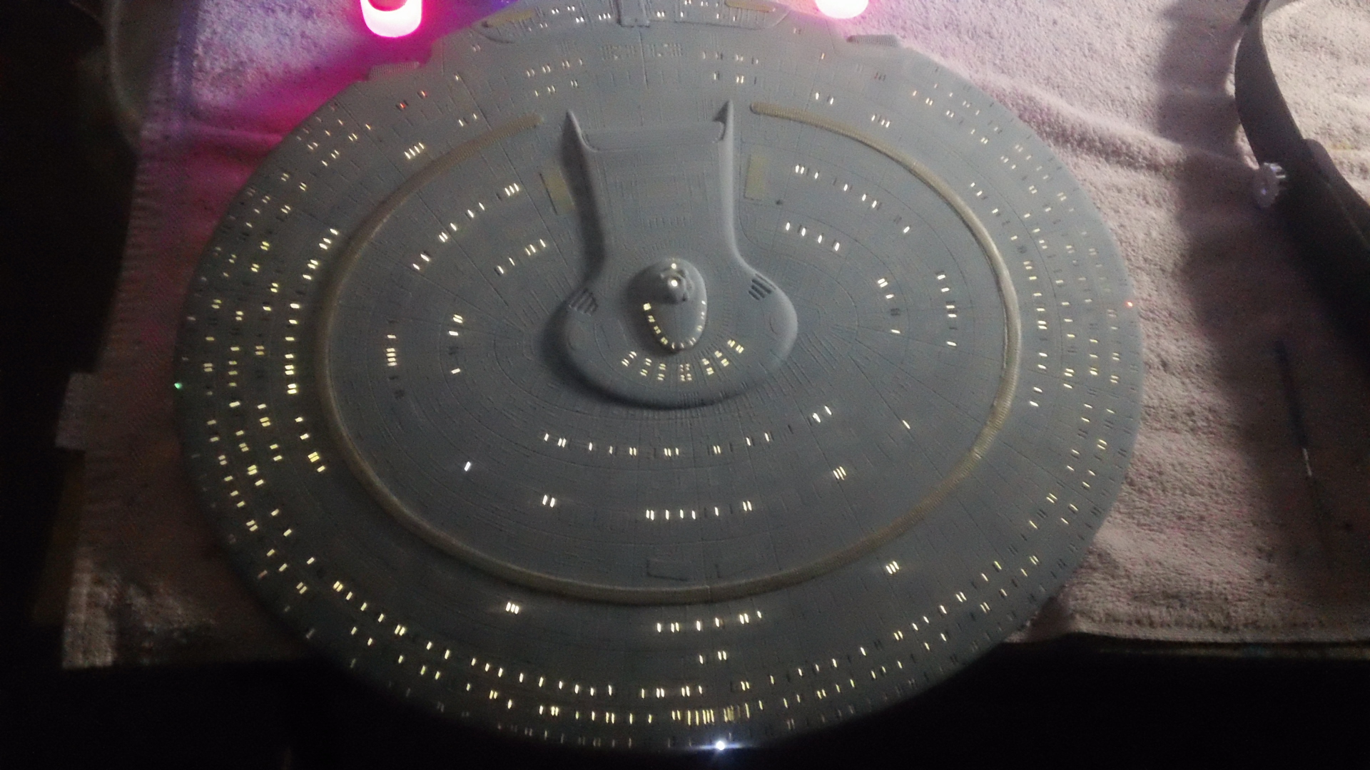

Today was a good day with lots of things accomplished on both models. The Skydiver has all the cart tape panel lines on. I placed an entire can and a half of high build primer over the tape.

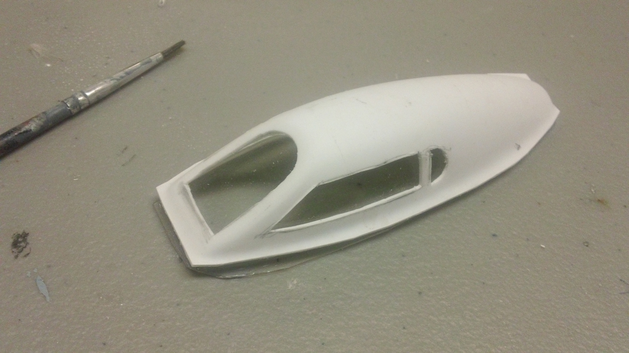

I got the canopy frame cut out and the clear under canopy trimmed to fit and placed inside.

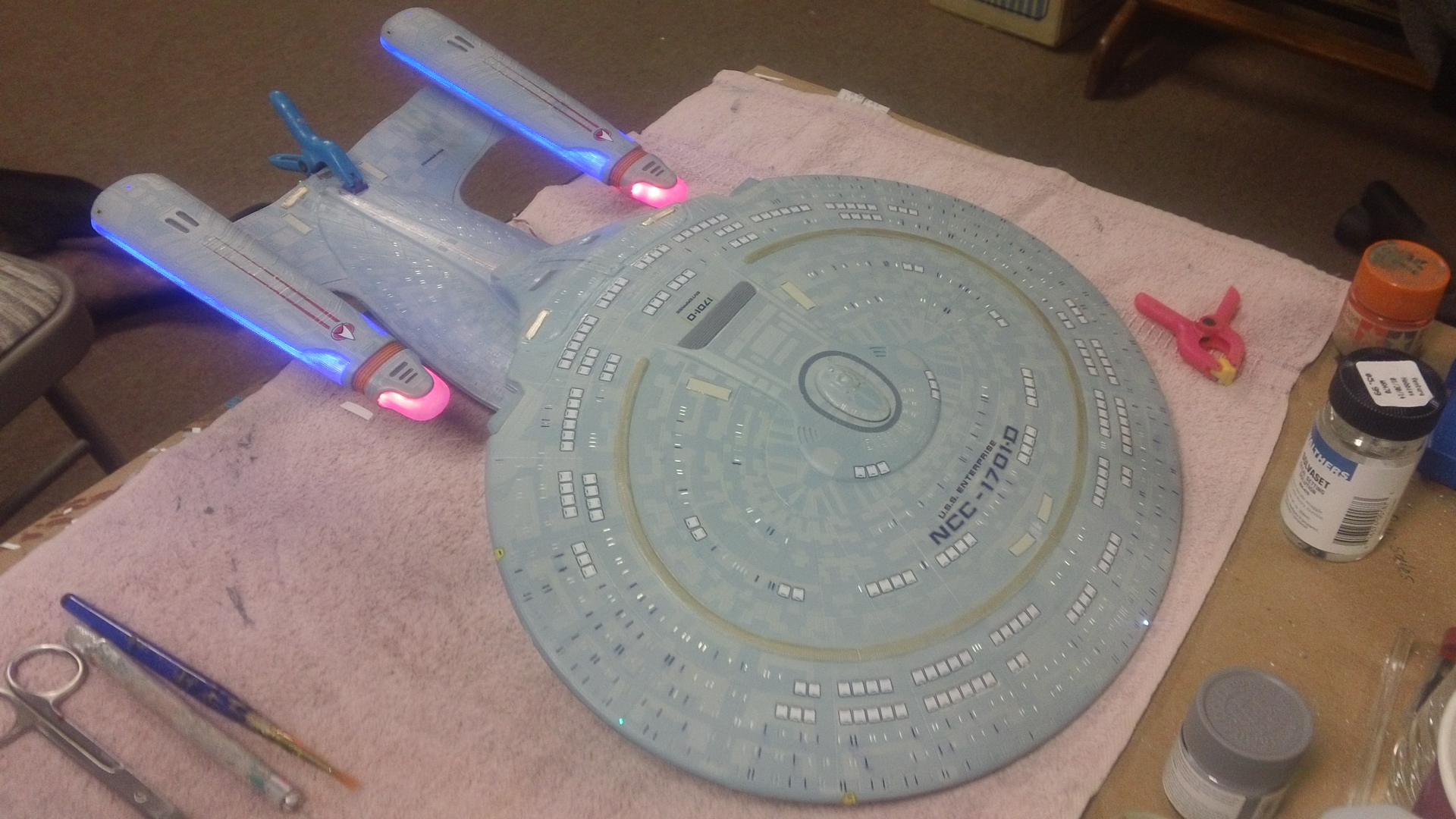

The Enterprise D got all the windows scratch in on the underside of its saucer section. Got a bunch started on the engineering section too. It won’t be long now until they are all done.
Tomorrow the Skydiver will have its chart tape removed so we can see the panel lines and move on to the under belly.
Another day and I’ll be able to finish the windows on the D. This leaves the clear coat, some painting trim colors and lastly the decals. We are on the home stretch.
Another day for the Skydiver and I’ll be able to start cutting the drain holes and soon be able to paint the base coats of gold and silver.

I got a lot more on the Enterprise D today and the Skydiver. On the d I managed to nearly finish the windows except for the neck which I’ll get done tomorrow and then it’s all downhill. I started this build about 7 weeks ago. I’ve been building both the Skydiver and the D at the same time too so it’s been a fairly brisk build. But always the big problem is keeping the pain stuck to this clear model that reminds me of Teflon. Once the windows are done it gets the clear coat which will stop anymore chipping of the paint one hopes.

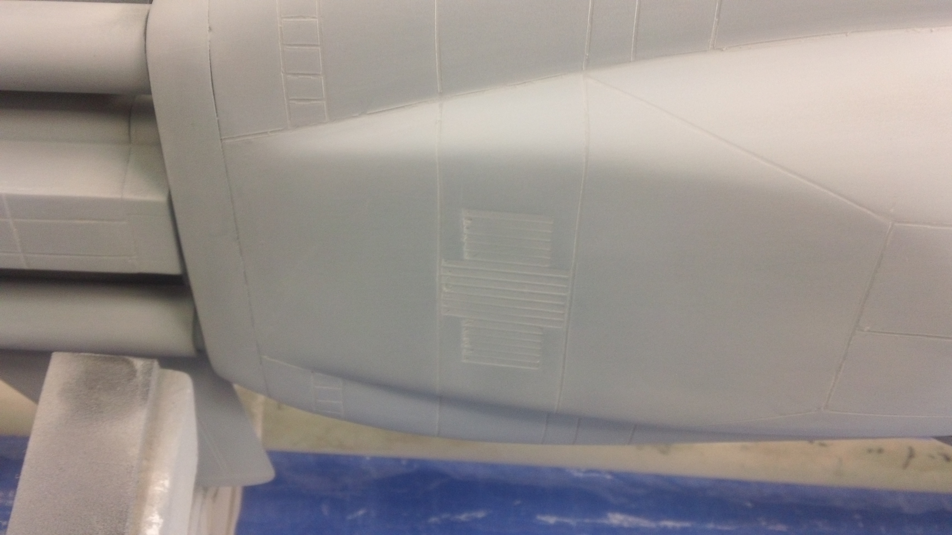

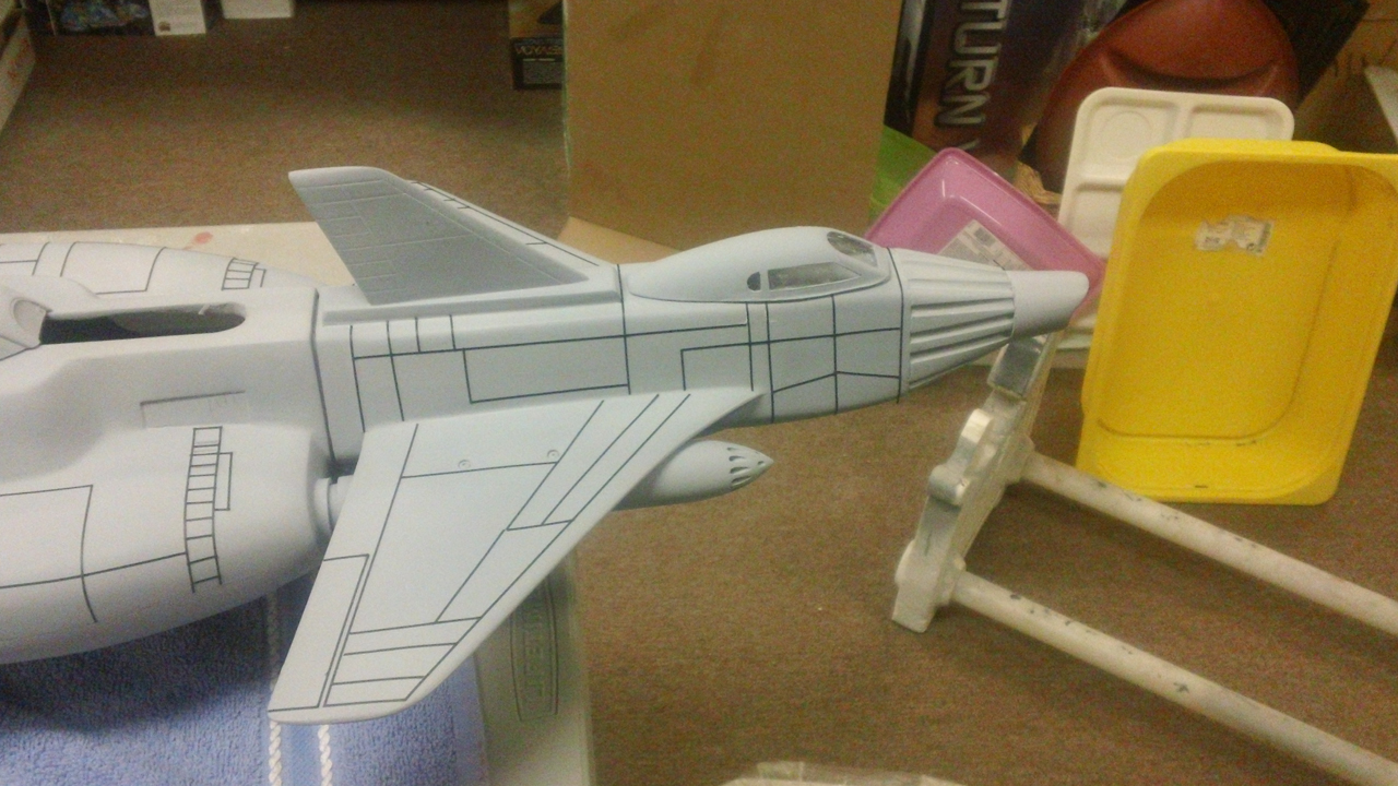

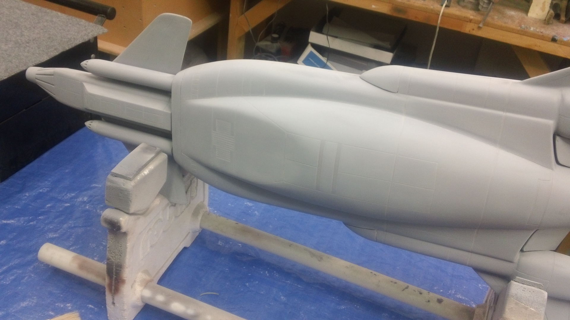

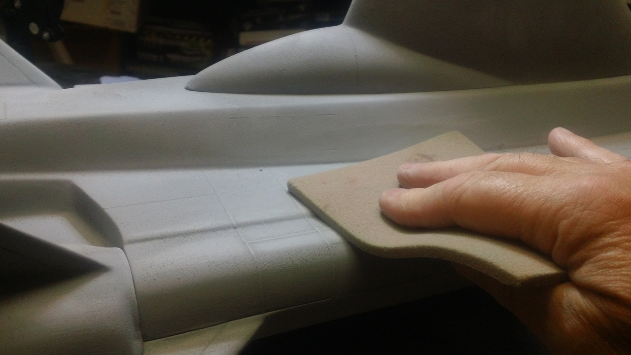

The skydiver now has all its panel lines back long sanded into oblivion by its former owner. I still have to do the bottom side tomorrow but it has less and will hardly ever be seen. Should go quick. In the sequence of photos you see the process of sanding the top of the tape first, removing the tape, sanded the overlap edges of and dusting the hull to reveal nice crisp panel lines.

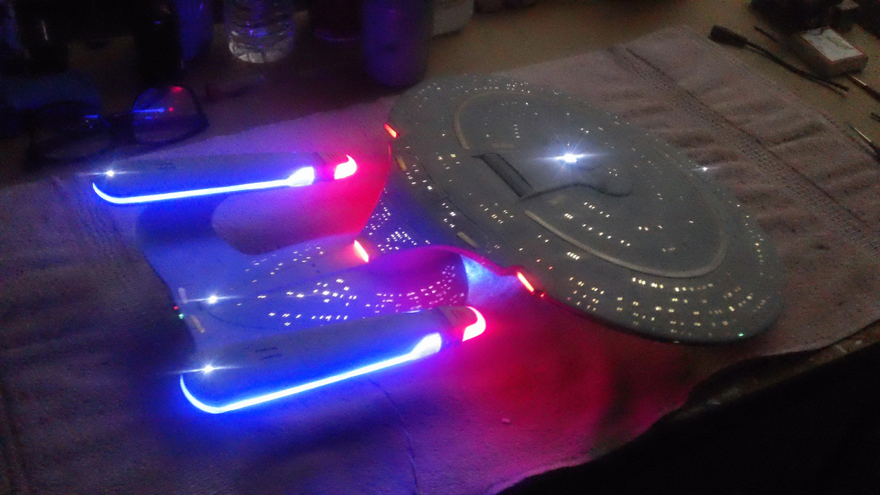

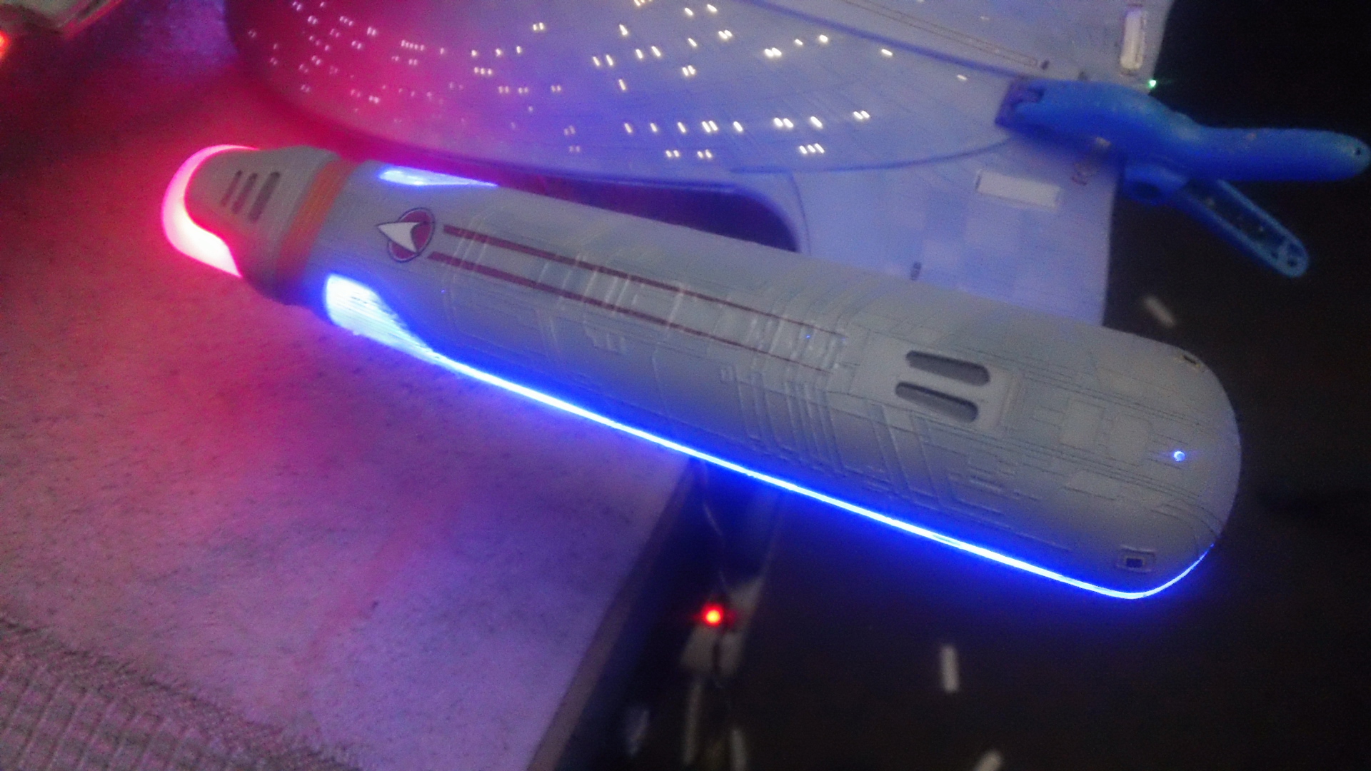

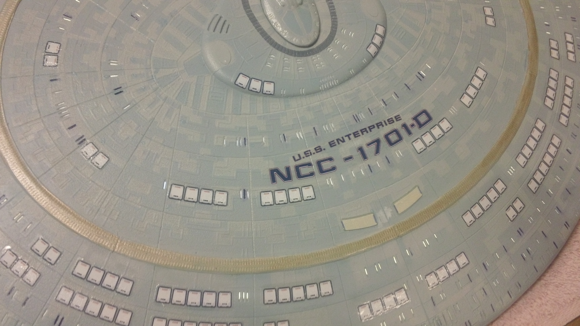

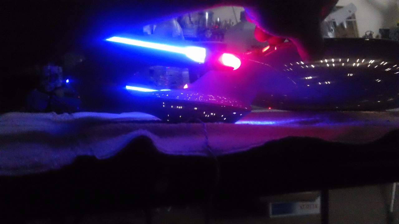

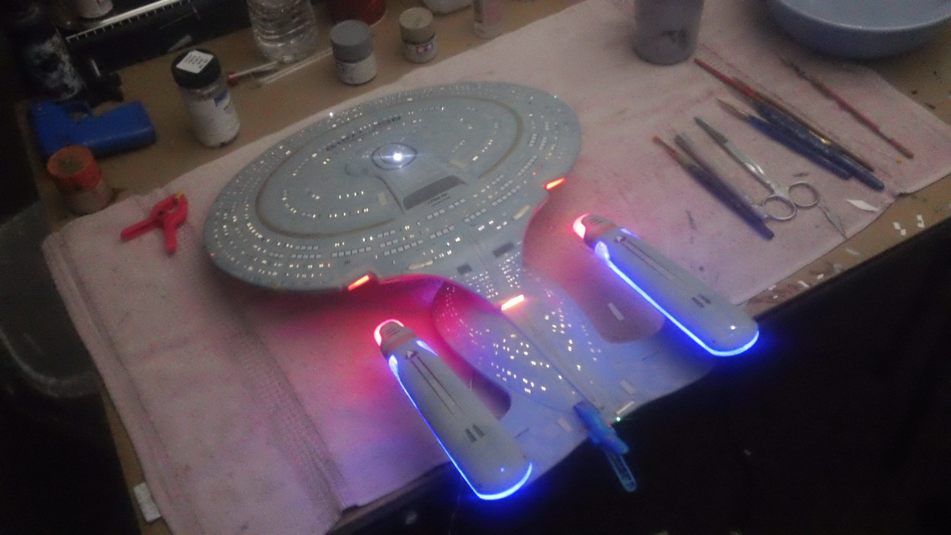

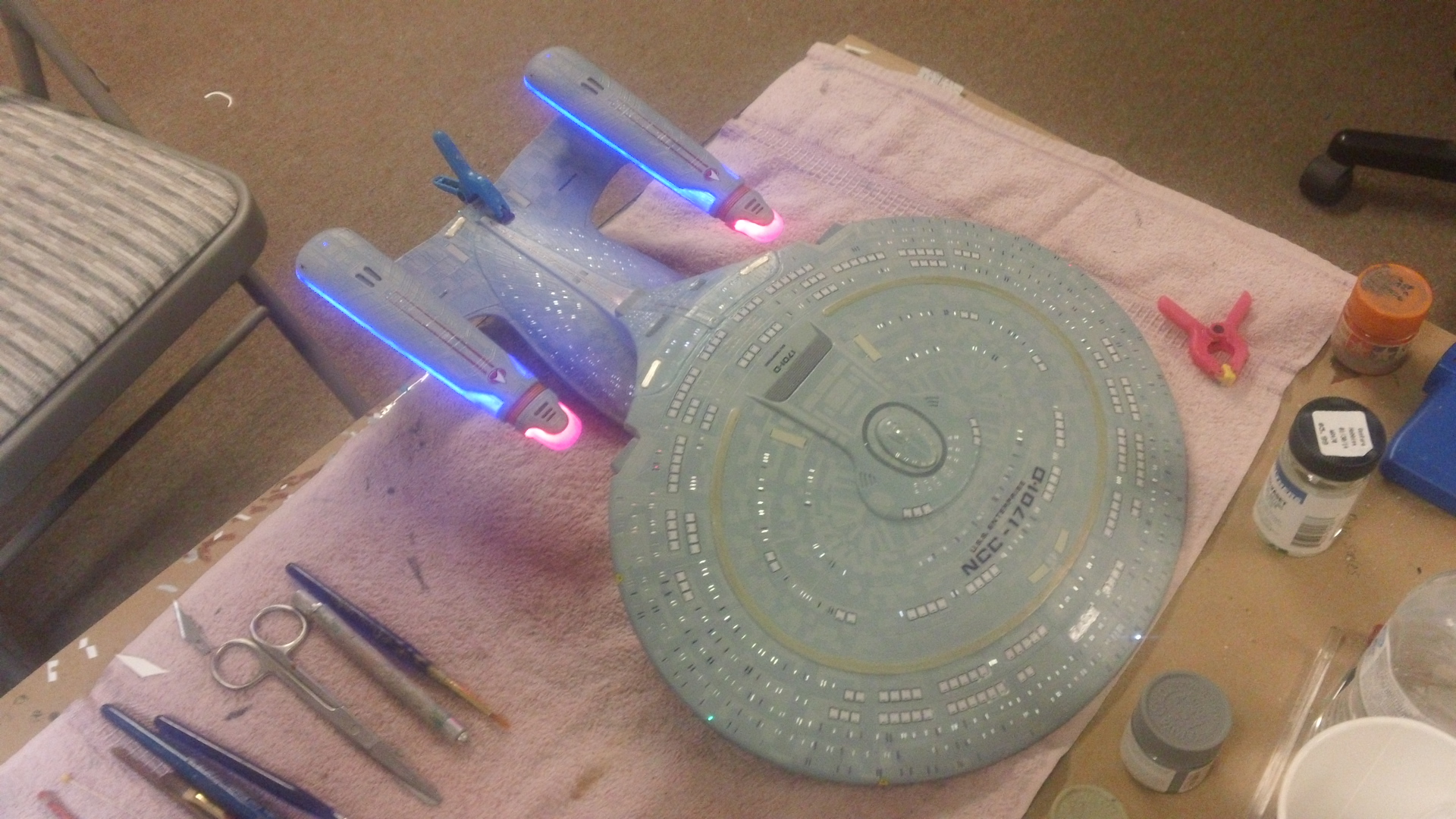

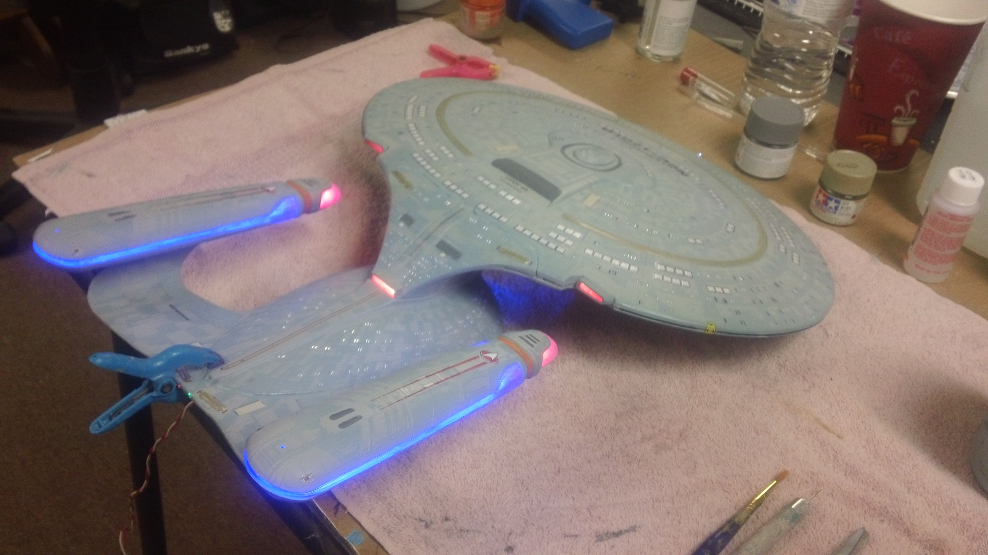

It’s been a busy weekend. The Enterprise D finally has all the corrections done and the orange painted on the nacelles along with that coat of acrylic gloss clear for applying the decal. Don’t worry gang once the decals are on she gets a matt finish clear.
We are looking at Decals will take a day maybe a bit more and she’s done. We are looking at Wednesday for a finished model.

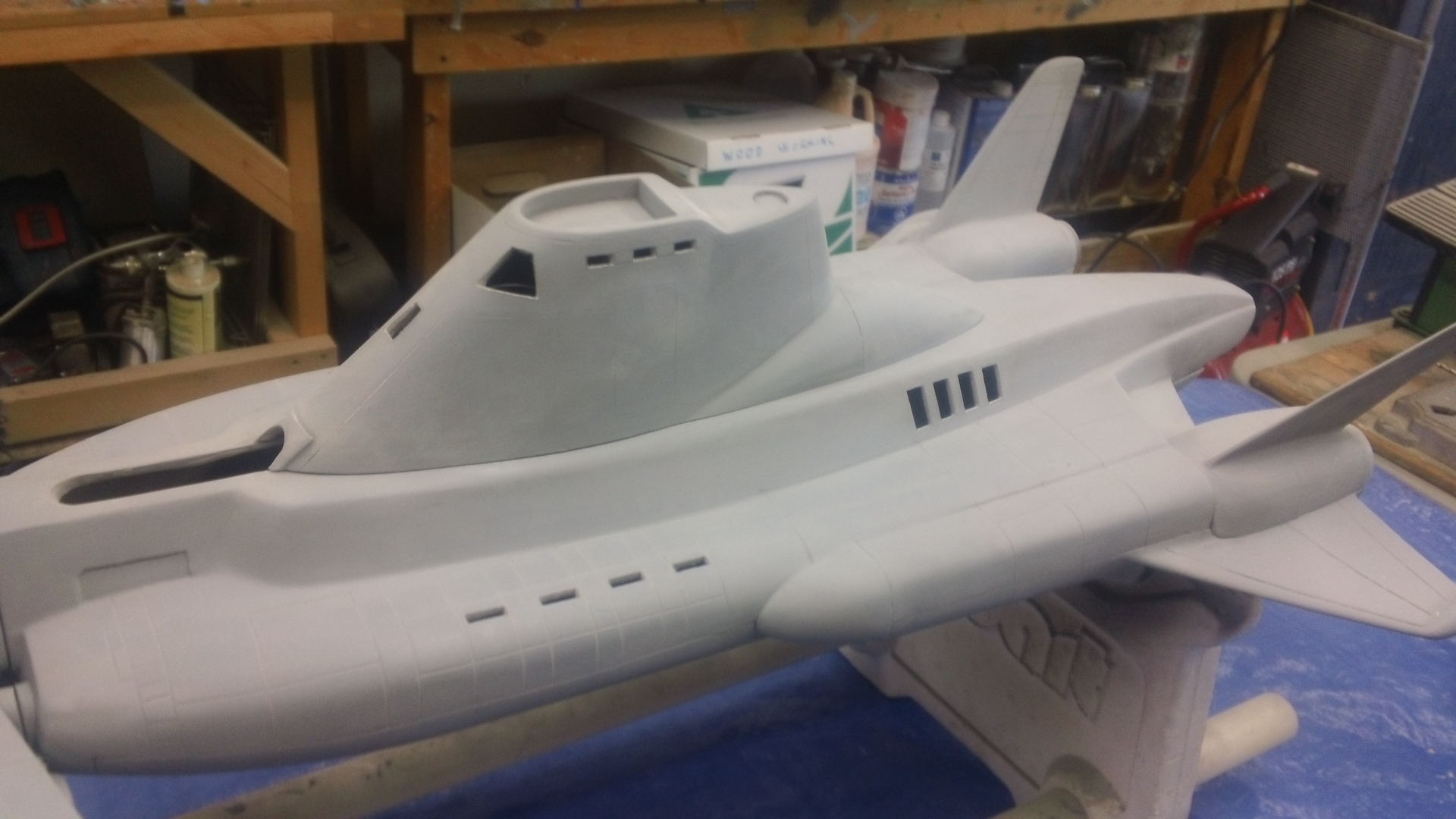

The skydiver has all her panel lines and they are all sanded down and smooth. Next up on Monday we cut a few drains and holes open and we can pain a base coat of a sort of gold brass color on. By the end of that week it’s my hope to have a paint job on her. Then we wait for the internals to arrive before I can finish her off.

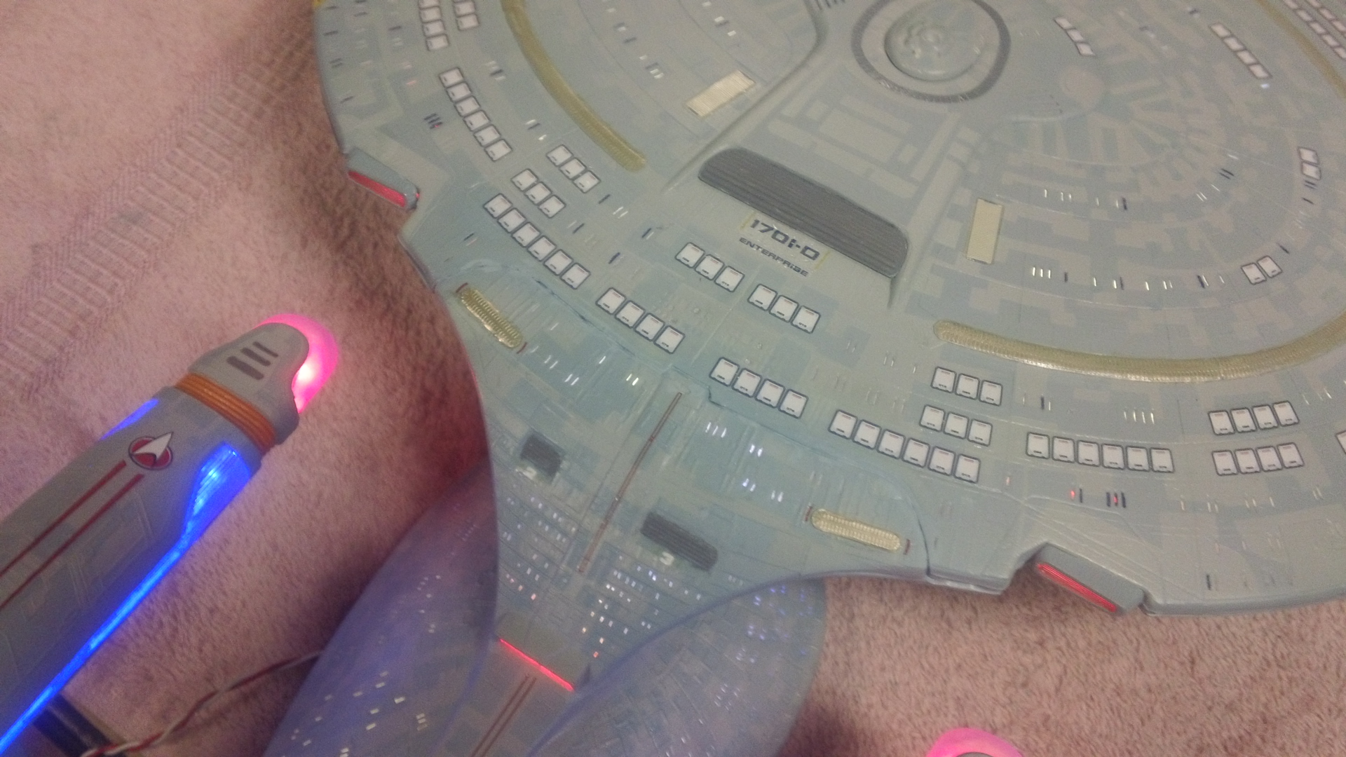

I have as of today all the decals on top side on the D. They were a bit brittle after sitting for years but fared well.
Tomorrow I’ll finish off the underside of the d and clear coat her on Wed. I also did a lot of hand paint work on various areas of the model.

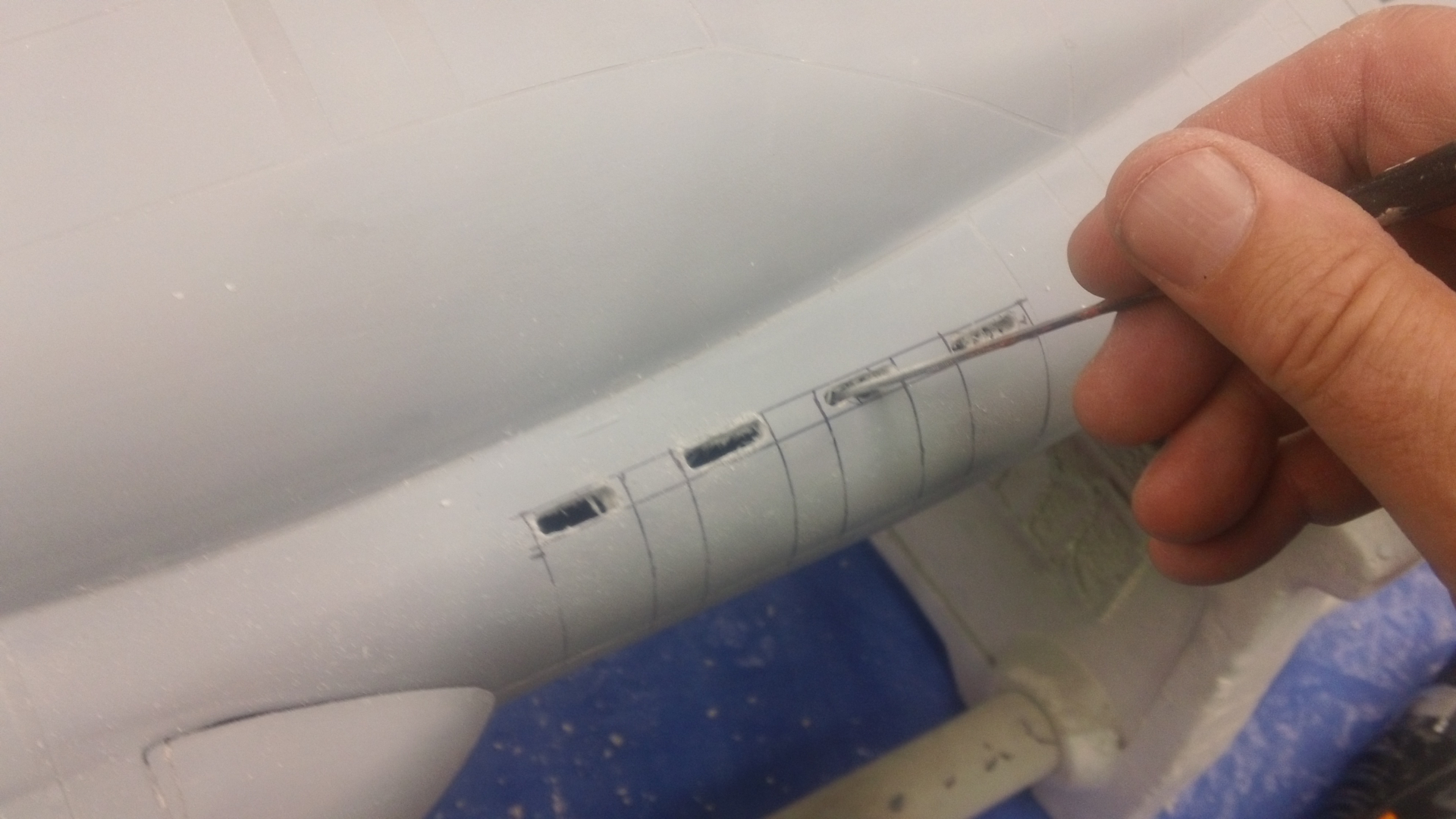

After all that dust settled I cut most of the drains out the Skydiver. Except for adding the small parts she’s nearly ready to start the paint job.

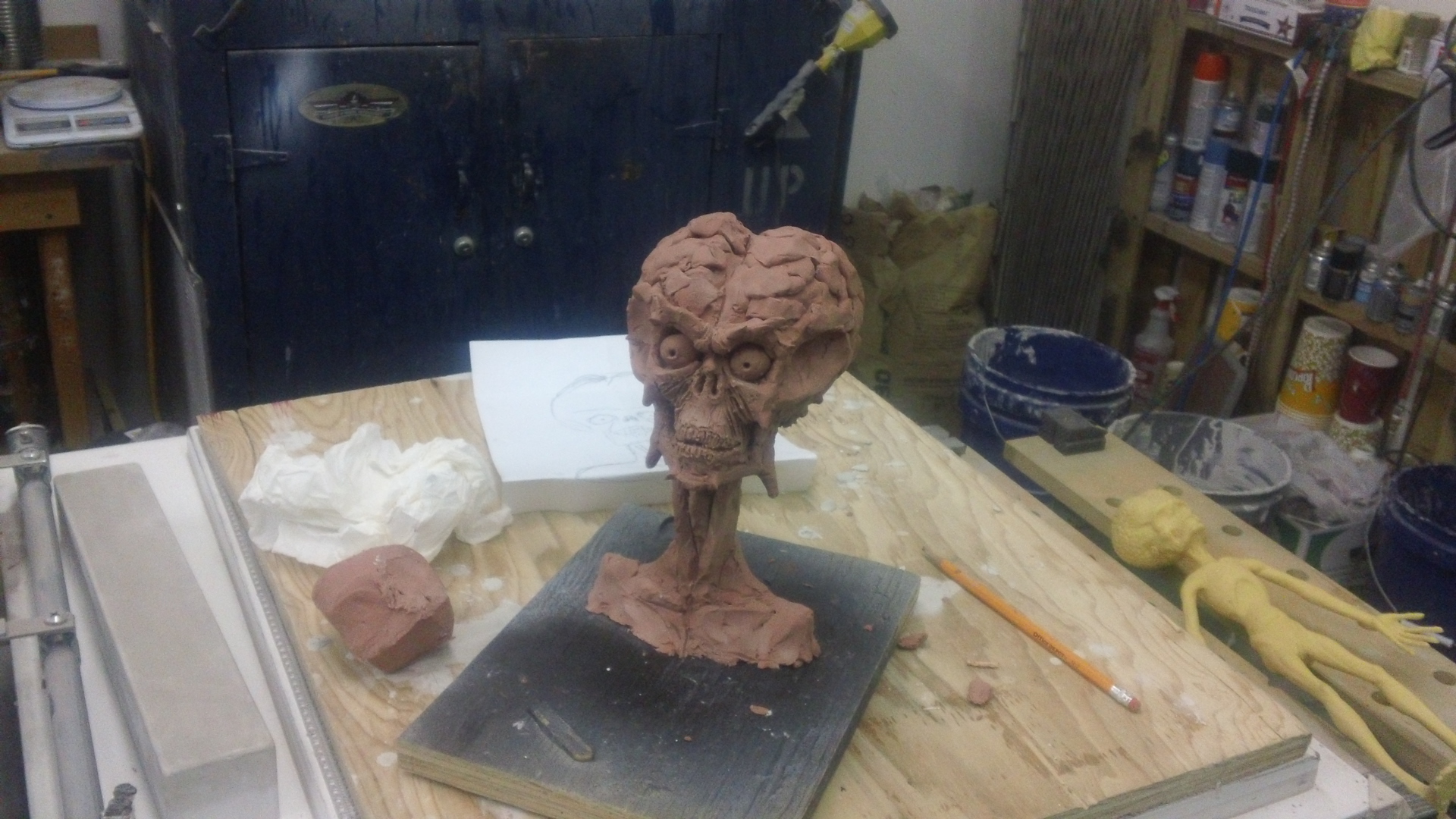

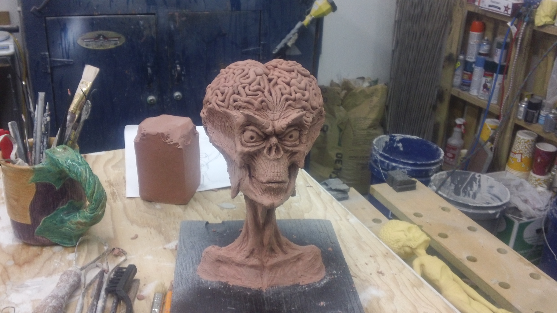

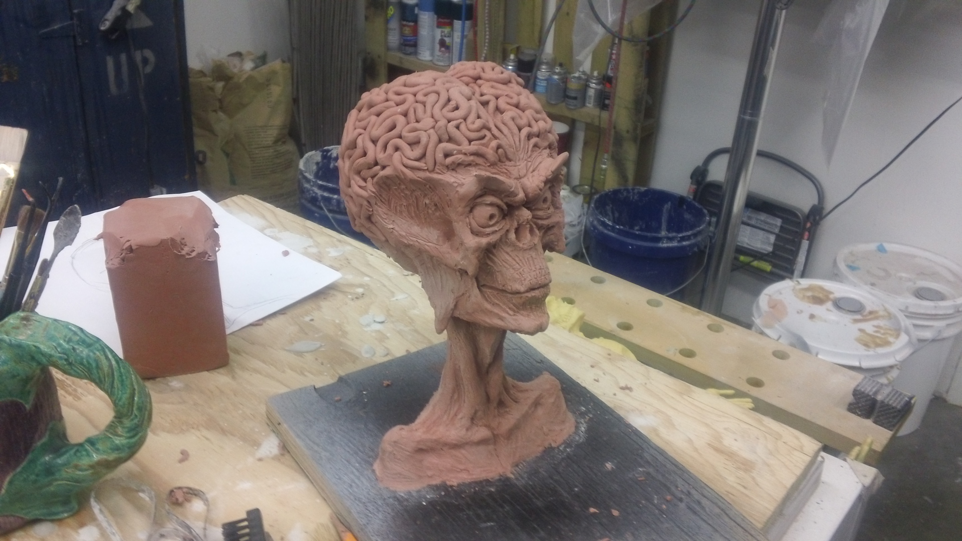

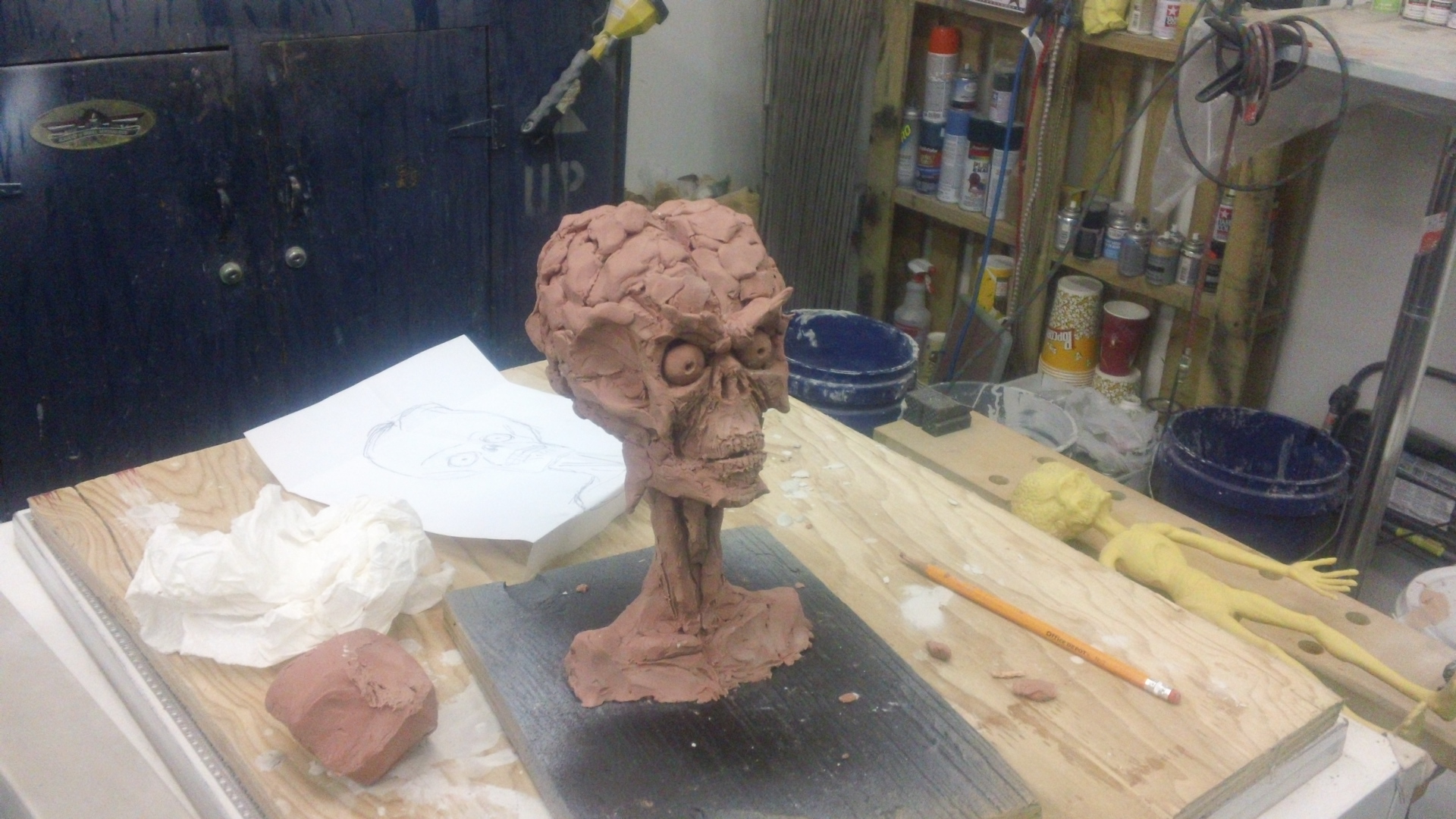

I had a little over an hour left at the end of the day and roughed out by hand our Martians Attack SNG Martian.
This is only an hour’s worth of sculpting to get the rough massing on the way. No tools were used except for that pencil you see. The eyes are in just for looks. Once the sculpture is finished they will be removed for molding.
I know it doesn’t look cannon. I am purposely not looking too closely at the original Top cards at all but rather free forming from my own thoughts. In fact his costume has been redesigned, the props and the head wear. That’s right I’m putting my own spin on it. We are also going to make up some cards that show these changes as though the cards looked like this design back in the 60s. And the cards will be call,” Martians Attack.”
We are now in pre-production as we close on finishing our last client model. We will also be starting in on casting our perks for the backers. Let Martians Attack SNG begin!
Steve
Today was spent mostly in town shipping. But we got back not too late in the day and I was able to get another couple of hours in on the Martian. Yes it has lips. And eye lids and this means it will have a lot more expression.
The eyes and lids are just for looks right now. I have to make up some actual eyes for the sculpture before I can finish it off. They need to be present in the sculpture and the mold so that when I make the core for the eventual under skull I will have an exact contour match for the lids themselves. You will see what I mean as we go through the steps. Most of you guys that have done this before know exactly what I mean. ;)
It’s still a rough. We are at what I call stage two out of four stages. The suit the Martian wears is a sort of Steam punk looking rig and have more of a military camo Desert Mars look to it.

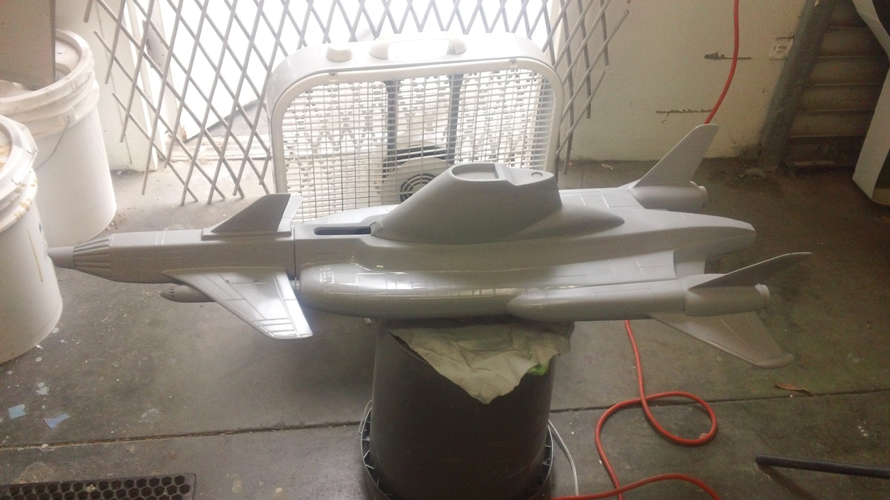

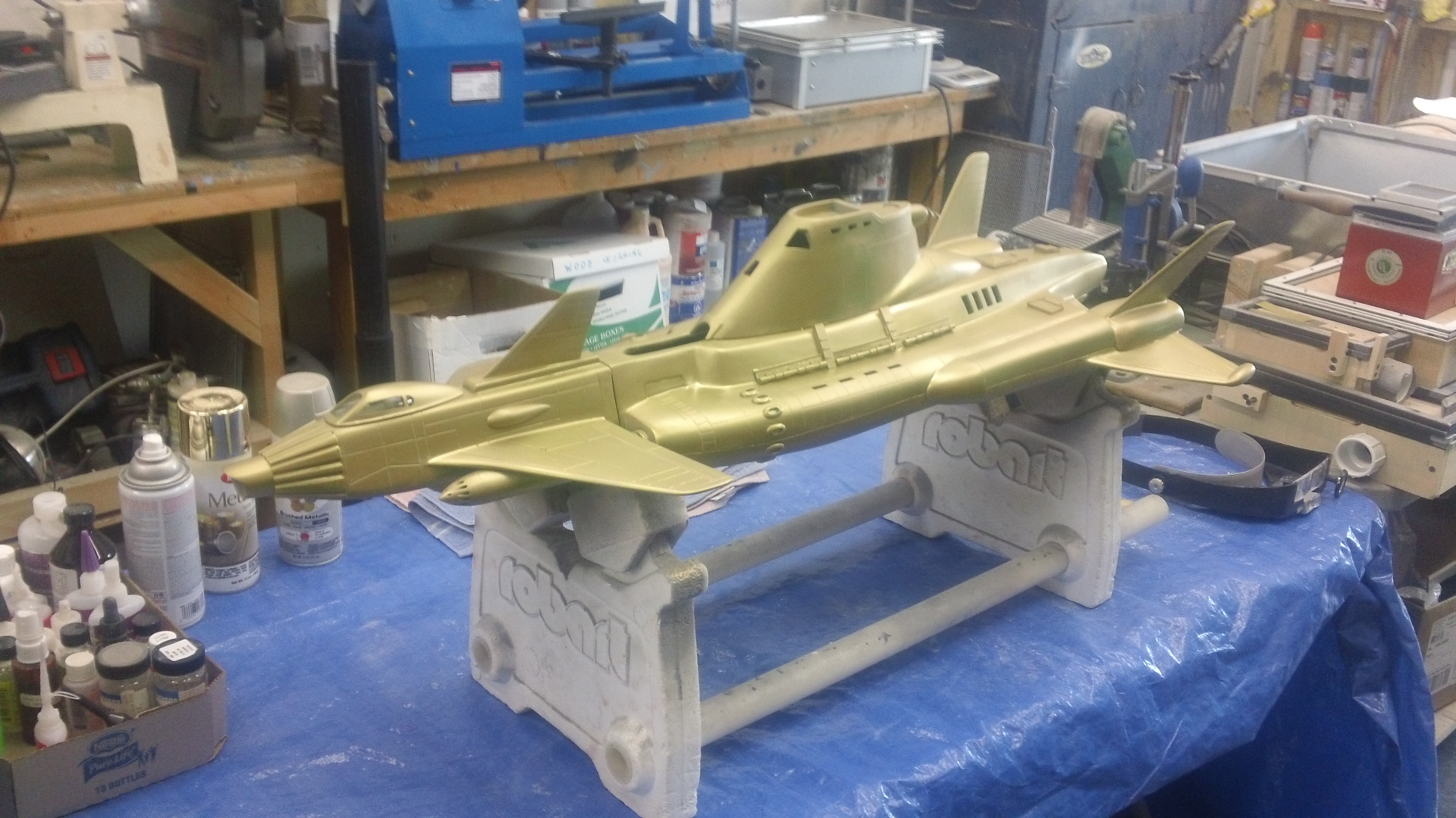

The Skydiver has all its drains and holes. Some un cannon but necessary drain holes on the bottom so the hull can drain water efficiently when in actual water use. Remember this is a radio controlled submarine.

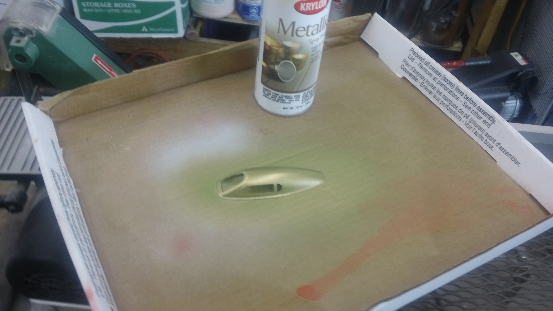

I added most of the small parts to the hull although many are missing from the kit they won’t be too hard to recreate. There’s a base coat of Krylon metal brass on the hull. This will get wet sanded smooth tomorrow and then the sort of Aztec nickel and copper can be started along with the dark colors or anti glare. She’s getting there.
