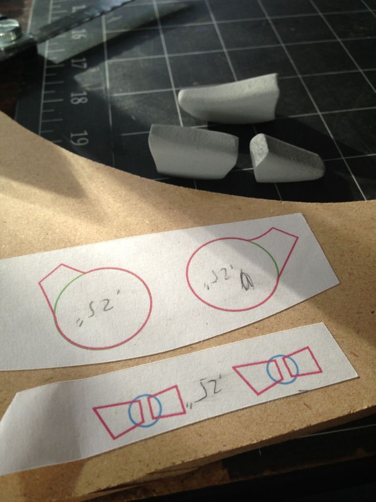

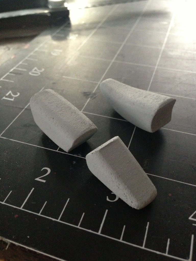

The toes are starting to shape up.
A little more sanding and primer and they should be looking pretty good.
The trickier part will be fitting these connector joints into the toe segments.

Foot pieces are almost done. I might recreate the joint pieces as laser cut parts if the hand made look bothers me too much down the line but I think I'll just go with this for the time being.

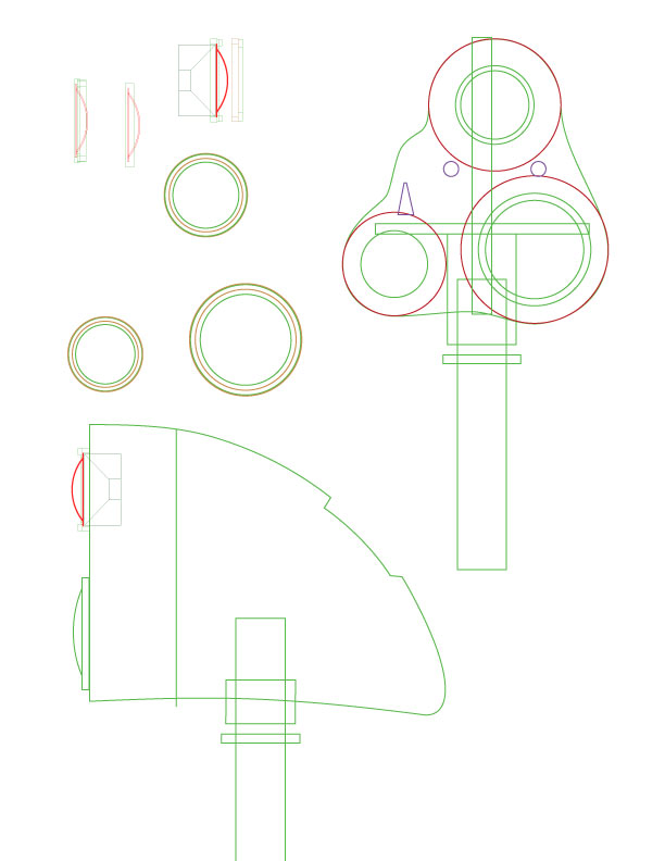

I'm also designing the lenses for the eyes. Trying to decided if they should be cast resin lenses or vacuformed dome.
I'm designing the rings that hold the lenses and the inner "cone" that holds the led in the lens in illustrator. I'm definitely having these parts laser cut. Should be interesting to see how that goes.
I need to sit down and plan out all the parts that I need laser cut so I can just make one big order and avoid the expense of multiples orders. Saved on material and shipping costs.
