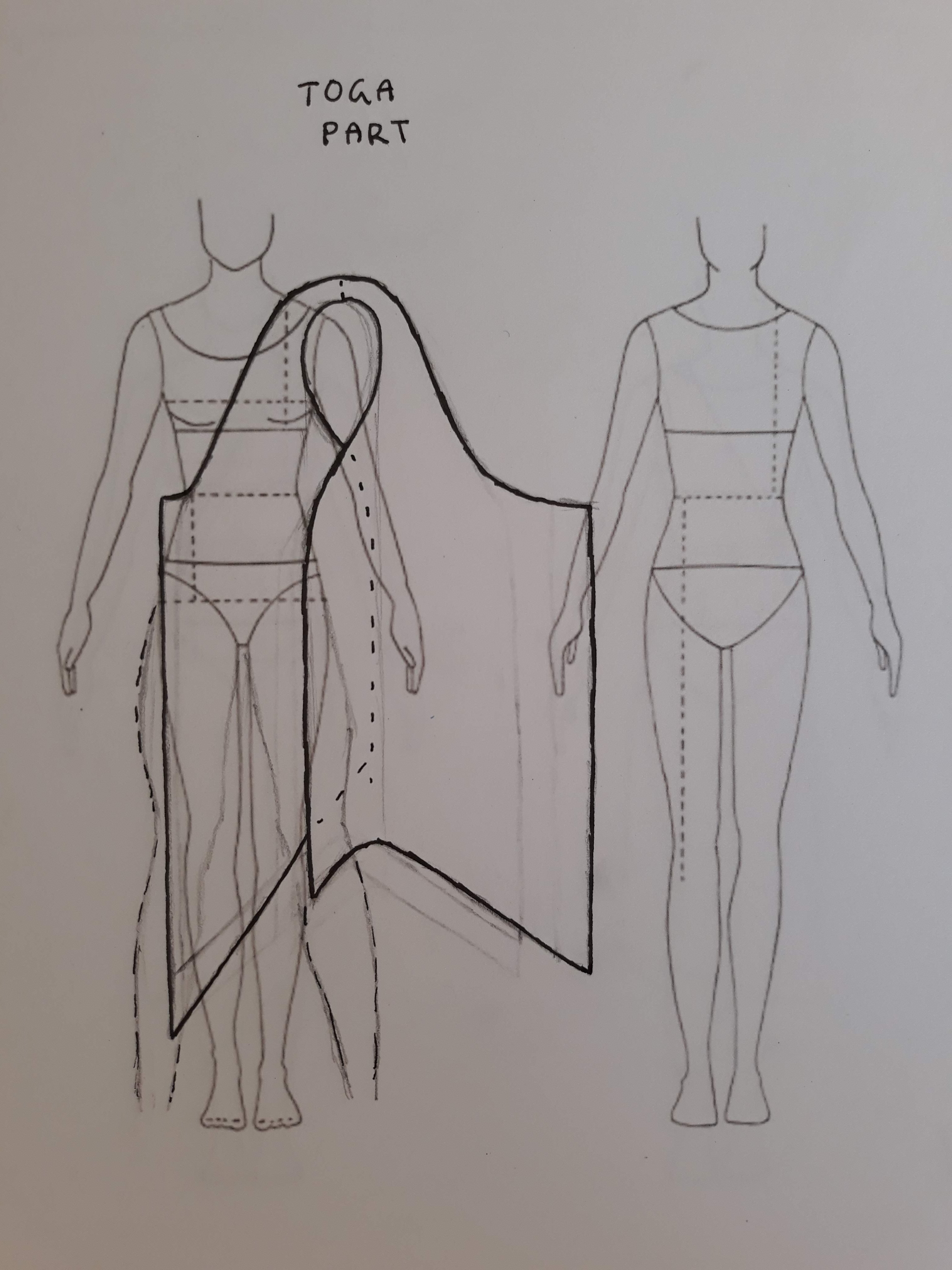

I'm a novice sewer (I've done 2 other mini projects and 1 other major), but I'm building up to doing really good costumes. This is a thread of my experimentation and theory on the Skyrim mage robes. I figured that these robes would be challenging but not completely impossible. I aim to have my final rendition of the project completed by June 2019. I'm currently in the rapid prototyping stage of the function, in cheap materials before I move onto looking into borders and more aesthetic aspects. Below is the original reference image and my sketching on paper. the last image is of the wrap but unwrapped!

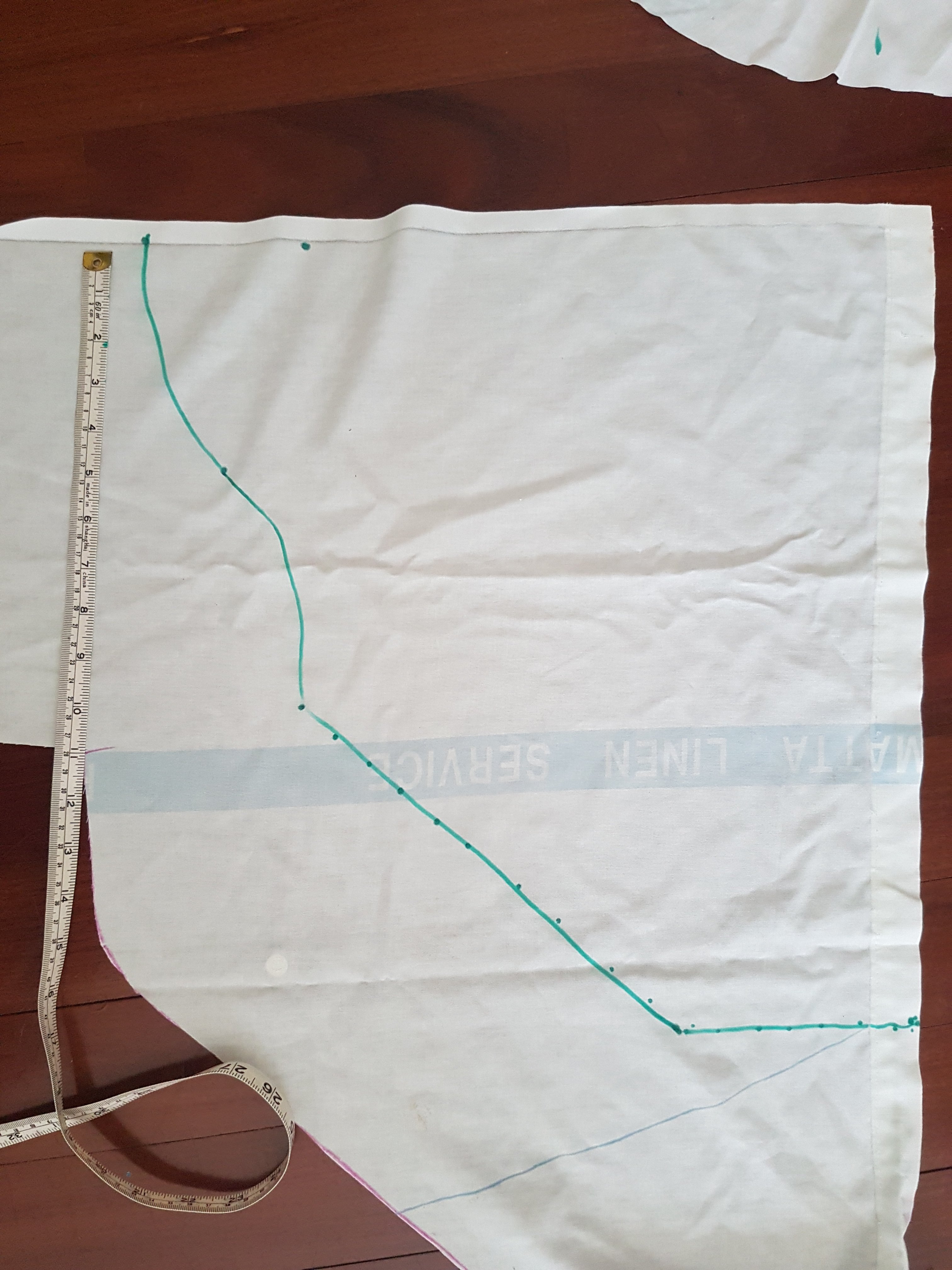

I started with templating two shirts which I own and wear, and fit me well. I intend to make the final product in a semi-stretchy fabric, most likely a wool-blend as I wish to stick to traditional materials which someone in medieval age would make their tunic out of. So I worked with two semi-stretchy shirts as my tunic would have a similar fit. Why not template a dress close to a tunic design? Dresses often require zippers, or more complicated designs to achieve what is actually quite simple. (I have worked with zippers before but didn't feel it was necessary or on theme to the mage robes.) So I stuck to quite a simple idea which was reflected in my research to work - template a shirt but make it longer! I layered the two shirts to get the best of both worlds in a sense - I wanted the chest fit of one shirt and the torso fit of another, I layered them so that when I traced them on butcher's paper I would get the outlines I wanted. Once I outlined the shirt part I made a quick estimate on where hips etc. are. as you will see later I placed the hips slightly higher than necessary, and will make appropriate changes on the next prototype. The quick estimate was done by taking the circumference of say the hips, and dividing it by 4 to get the "half" width of the template in the first picture. I folded the shirts in half to get the most symmetrical design possible, as there's less chance the shirts will stretch or sit funny on the paper as you trace. Once you place the half template on the fabric you're cutting out of, you simply outline it, mark the points to pivot on and flip it and outline again. I also made sure to give it a centimeter or a few all around the design to allow for seams and little cutting mistakes.

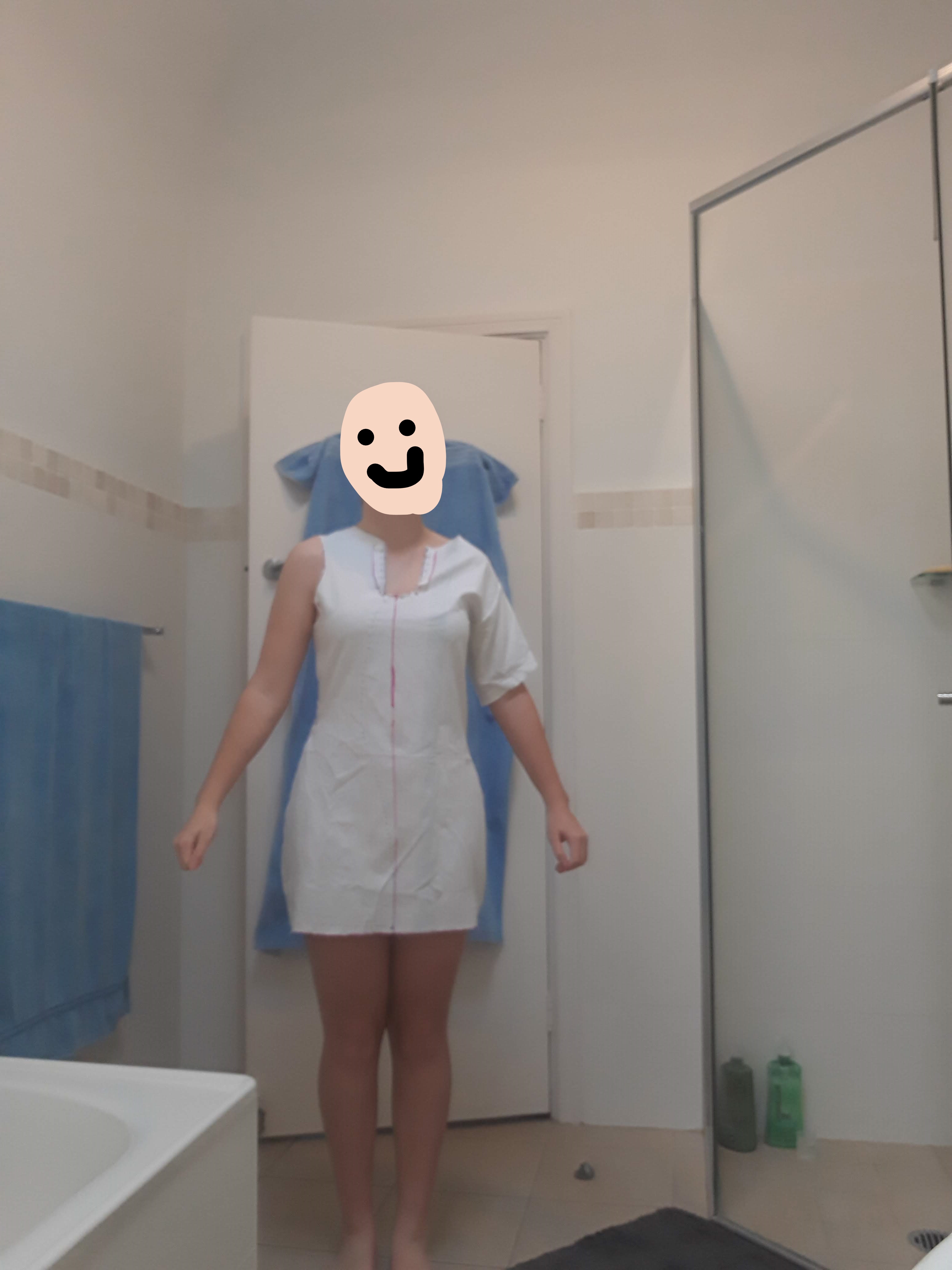

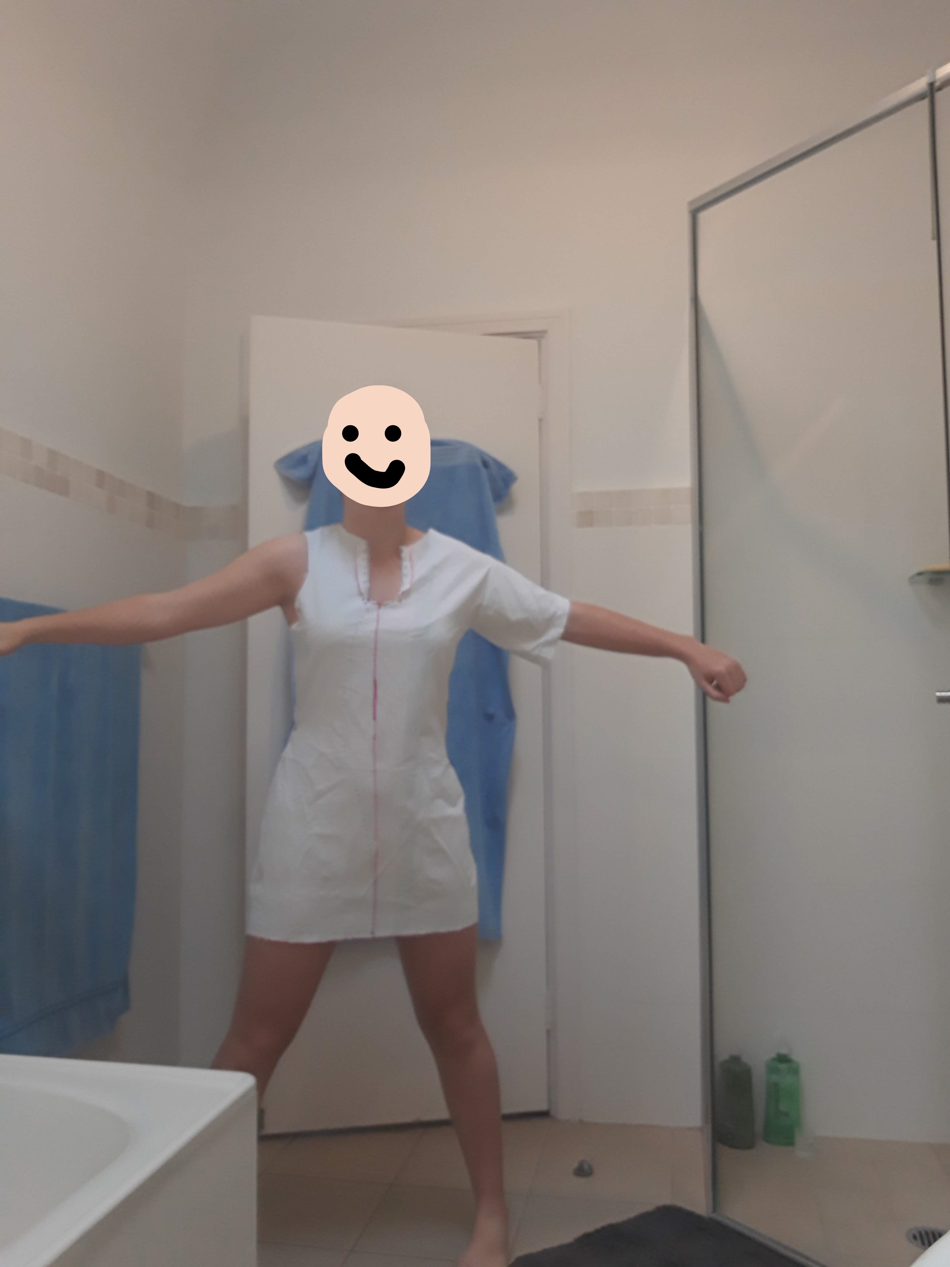

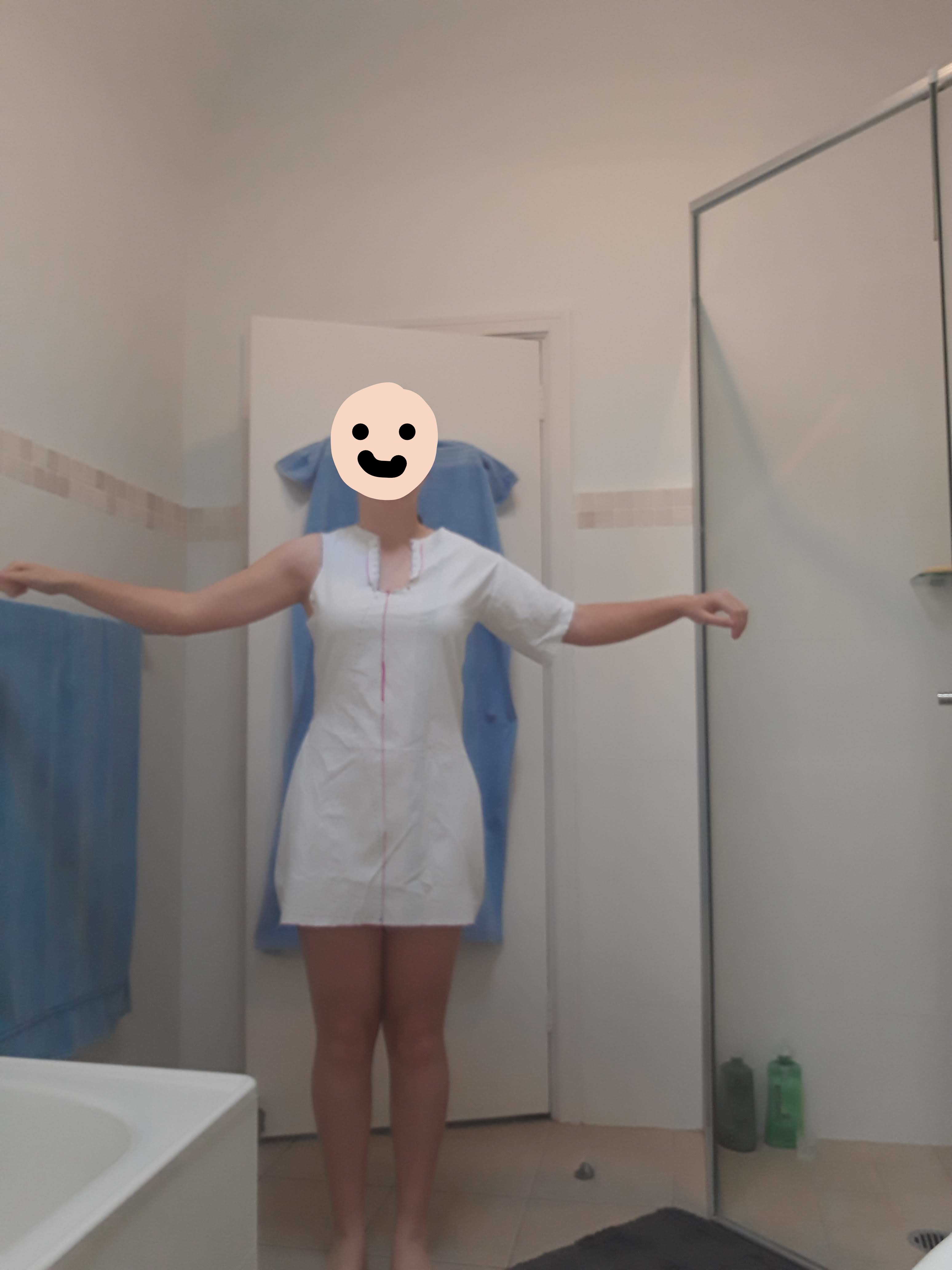

First prototype piccies! I think the hips down to leg can come in a little, as when the tunic is this short it doesn't effect mobility at all, plus it looks kinda silly to see it puff out when not needed.

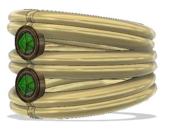

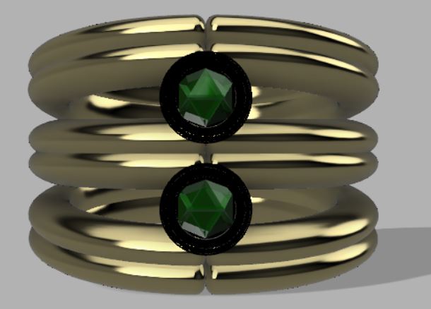

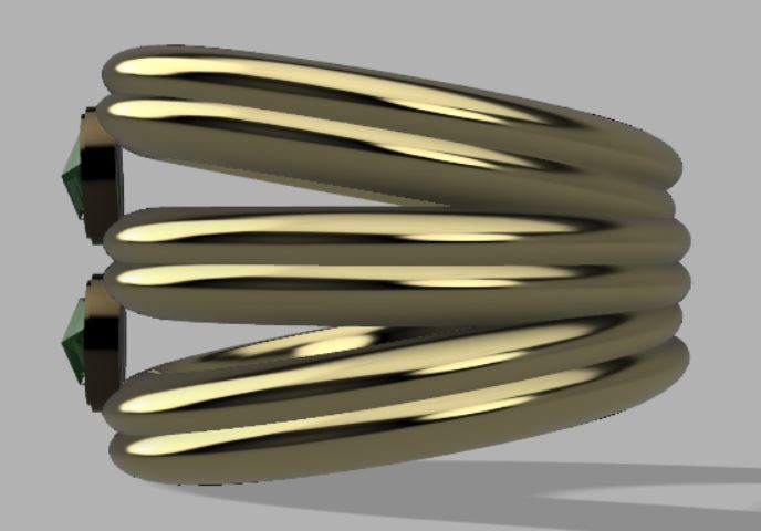

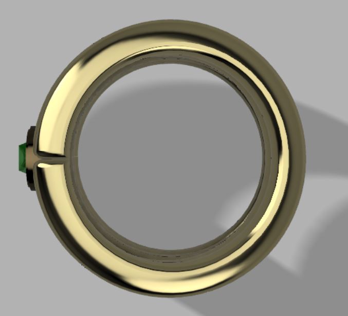

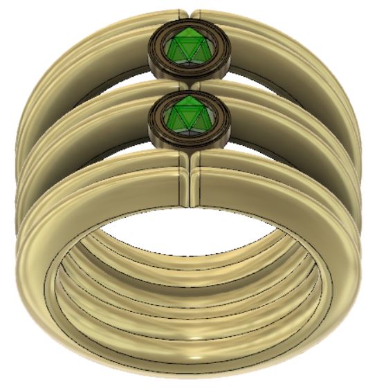

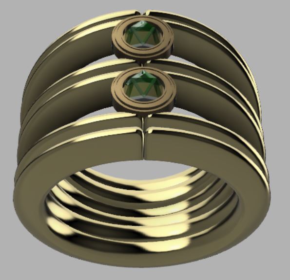

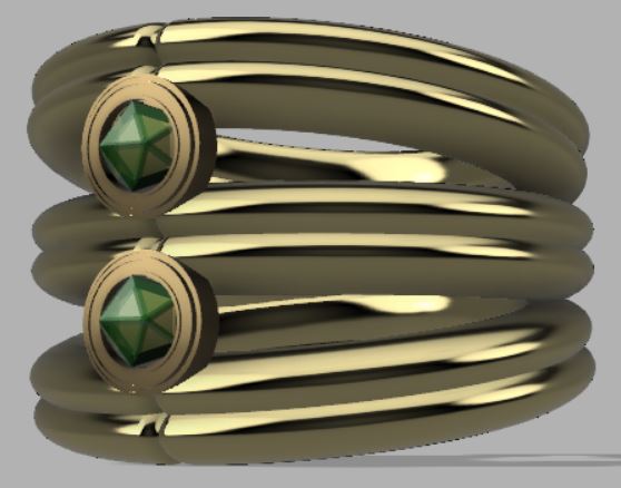

I finished the 3D creation of the ring of erudite! This is a great ring for a mage, and looked like a very interesting thing to explore in Fusion 360, so here I am! If anyone is interested in a full recount of how I did it, I would be more than happy to tell you. It was quite simple (took less than an hour which is insane in the 3D modelling world), I made a profile sketch of a single band, doubled it to make a single double band and then revolved it 359.9 degrees. I then filleted the ends of the ring to round them back. After that I copy and pasted twice, pivoting the bands slightly to get the best alignment for the finger. I then made a profile sketch of the gem holder, then revolved it 360 degrees to create the plate. After that I found an old d20 file I made and cut half of it off. I used this as the gem. Below is my timeline. Note: i would have loved to fillet the ends of the bands back as much as the original, but Fusion 360 didn't agree with me. Still seeking out a work-around.
Here are the renderings:
View attachment 841087View attachment 841088View attachment 841089
T POSE TO ESTABLISH DOMINANCE
View attachment 841230View attachment 841229
View attachment 841226View attachment 841228View attachment 841233
View attachment 841232View attachment 841227View attachment 841231
Daaang that looks incredible! Puts my amulet to shame haha.

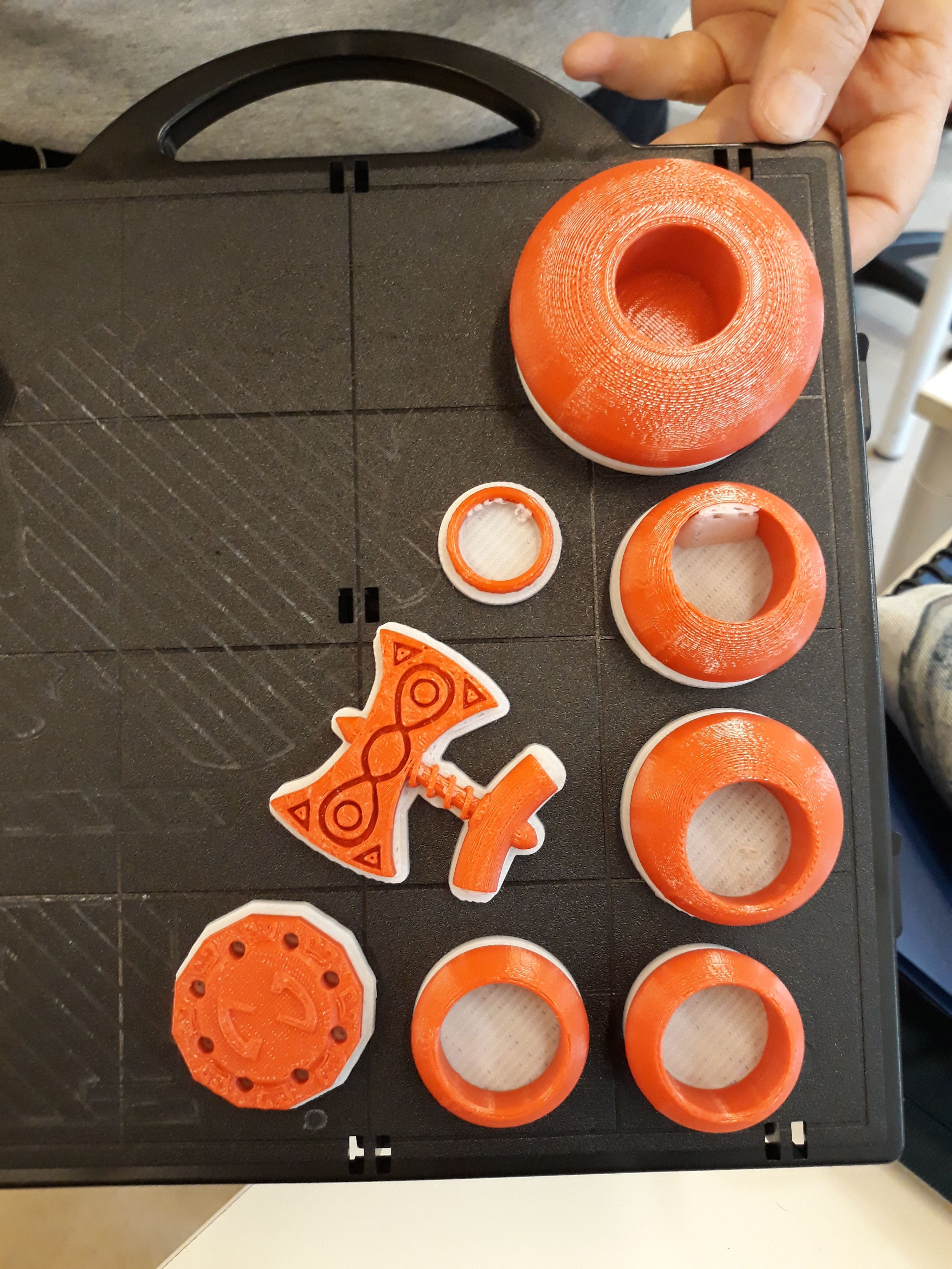

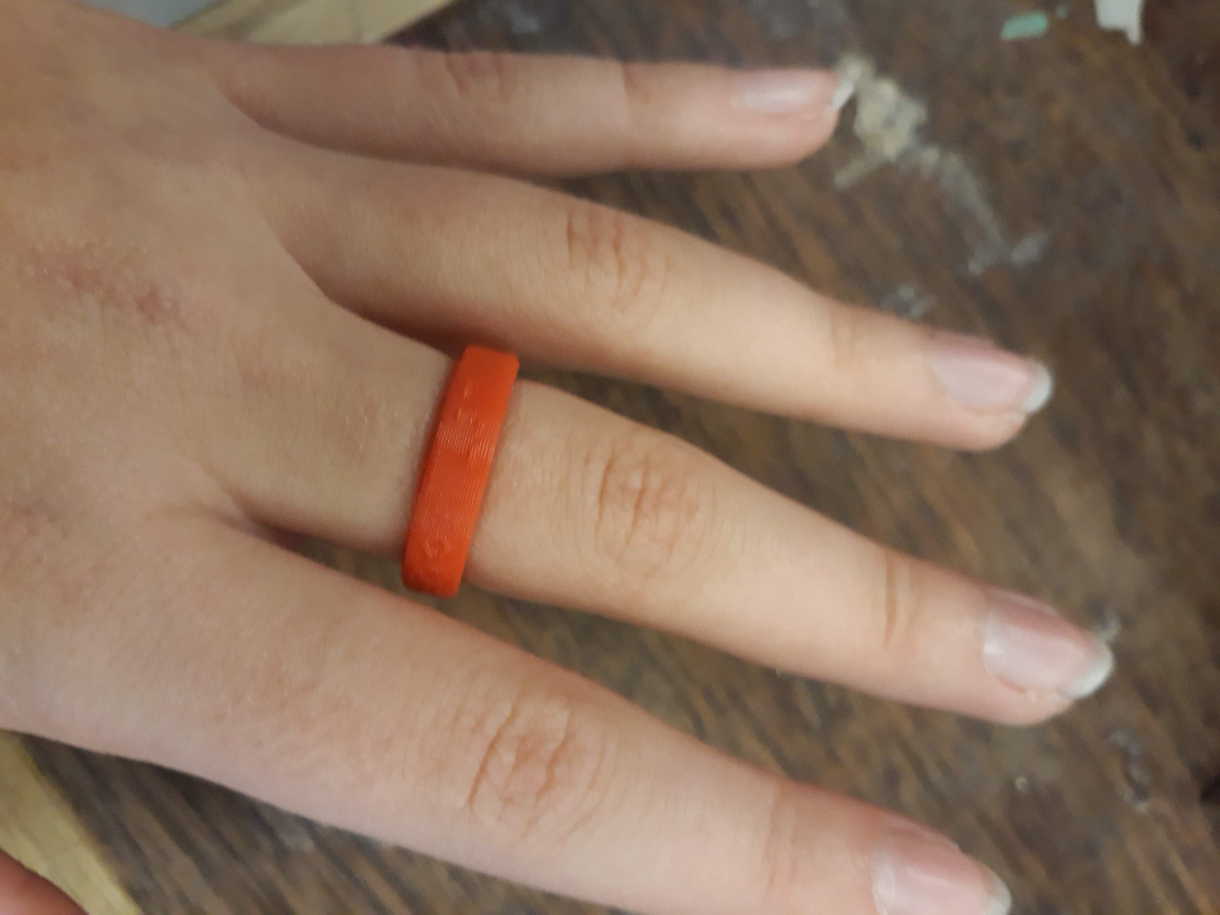

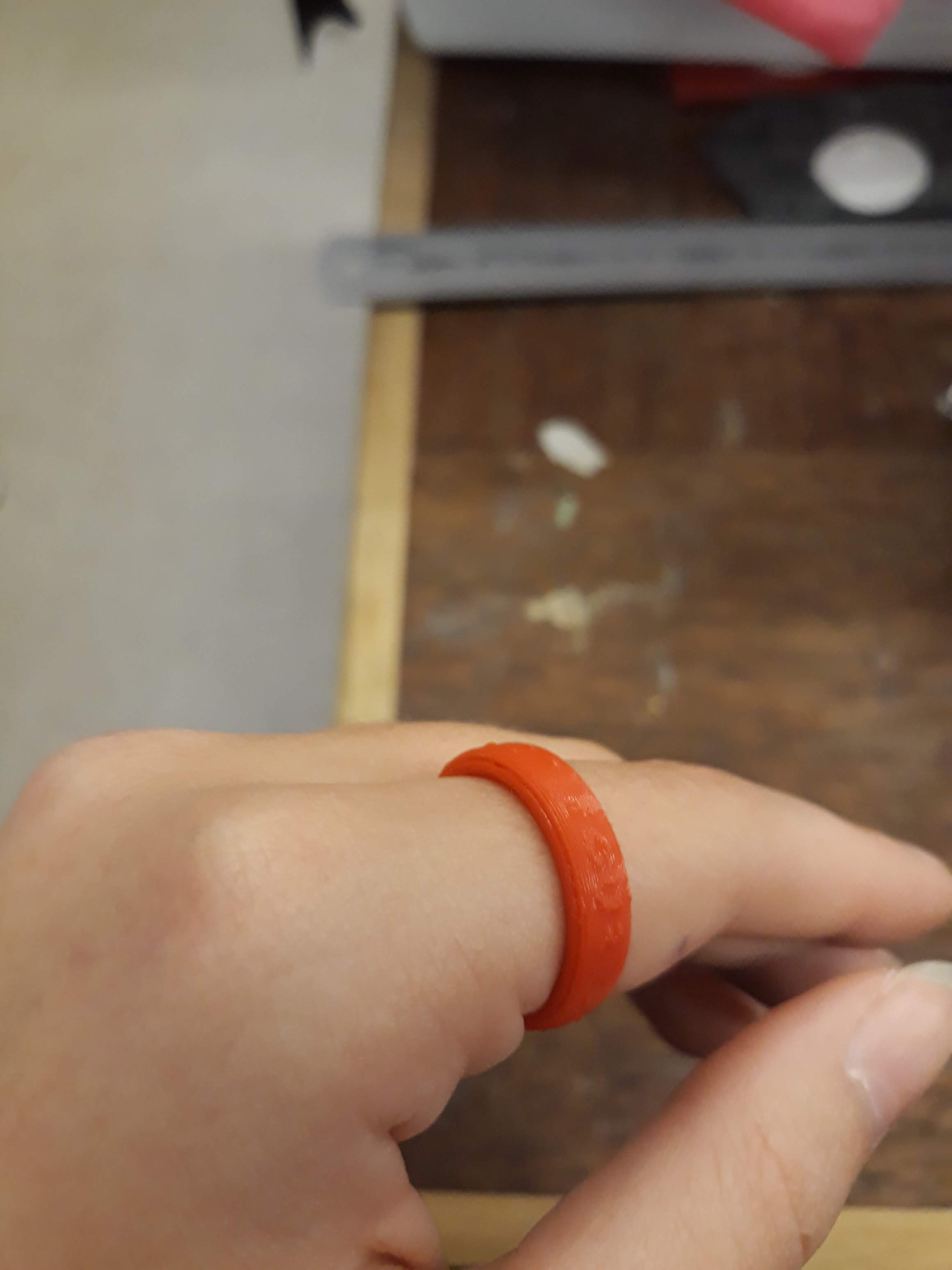

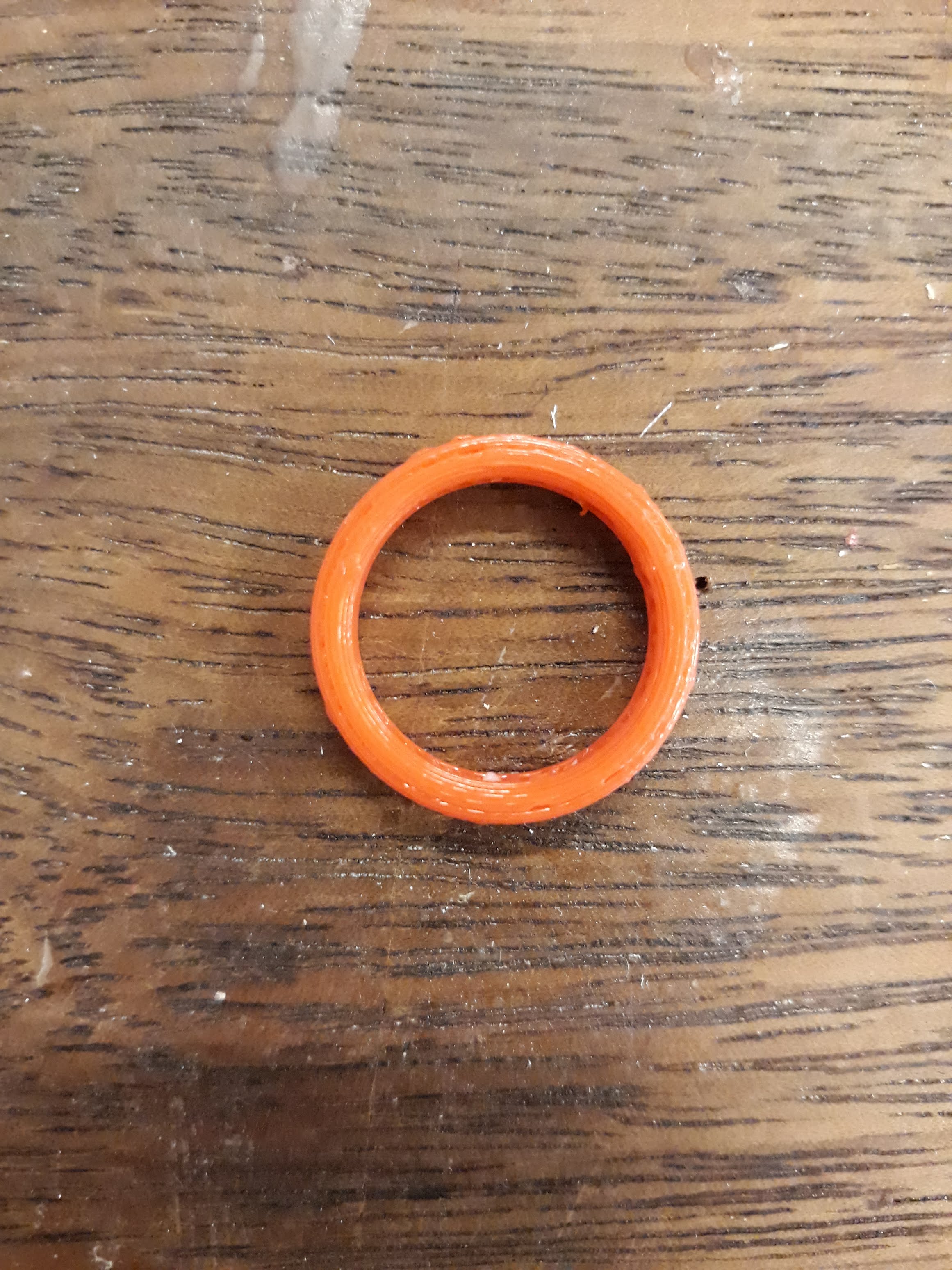

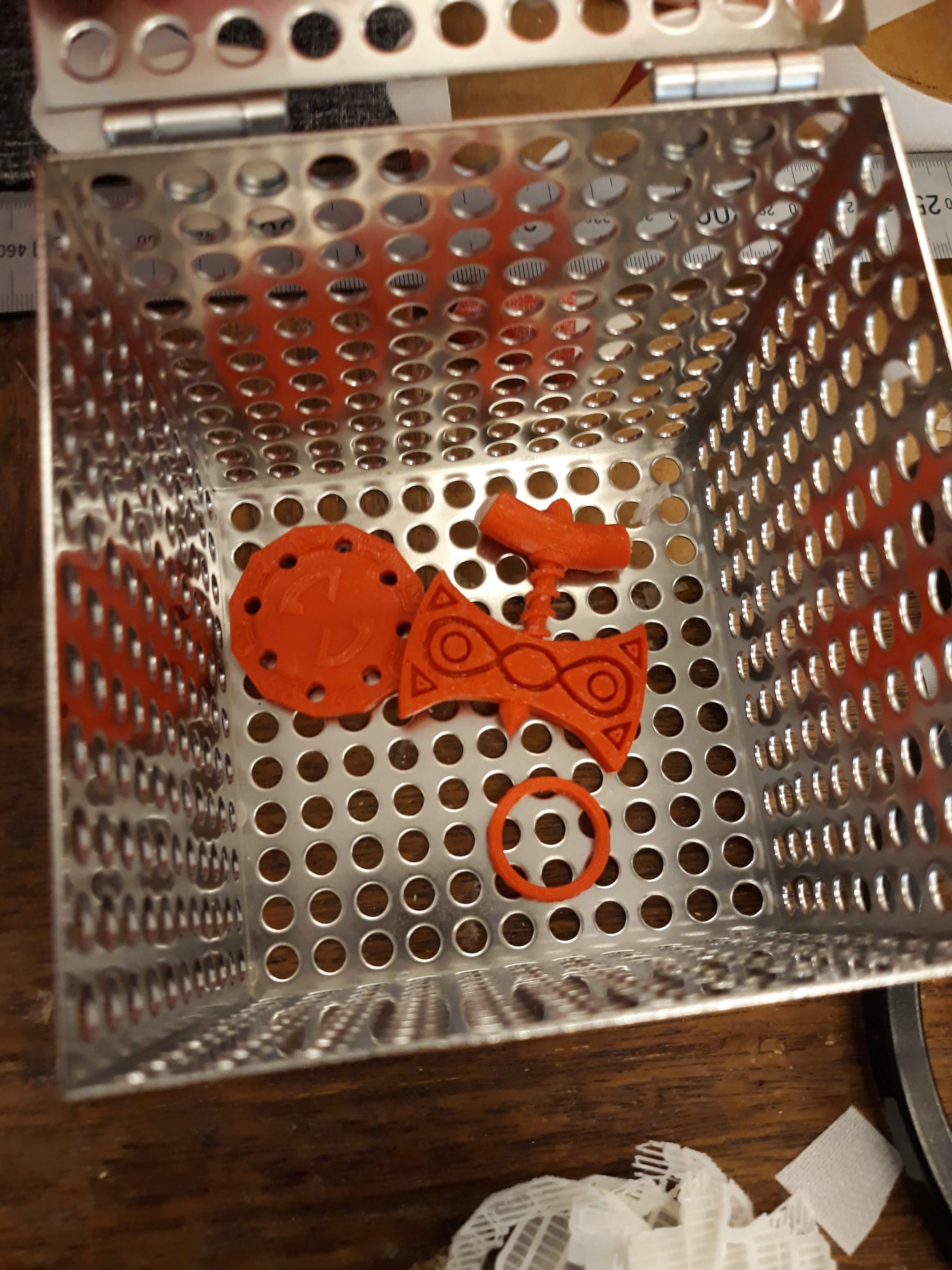

My first ring test print was a success! I did a single band ring with filleted edges - as well as text on the inside and outside of the ring. I did this to experiment with writing on a flat surface then bending it in to make a ring with text. This is a very handy technique to have under your belt. It also gives me insight as to how far I have to extrude things to get them to be noticeable. It also gives me an idea of how precise the printer is and its limitations. As well as how the lines come up on a printed design. The photos below are: ring on index finger (a little tight but not too bad), the ring and other designs in the cage of doom (this is immersed in an acid bath to remove the white support material), the ring on the messy workbench, the ring on my middle finger (a bit looser, an optimal size of 18.2 mm diameter) and all the 3D printed designs on the bed (the other large blobs with holes are someone's project, the coin and talos amulet are halrhyrr's go check his out!).
View attachment 841347View attachment 841344View attachment 841345
View attachment 841348View attachment 841342
Looking good :)

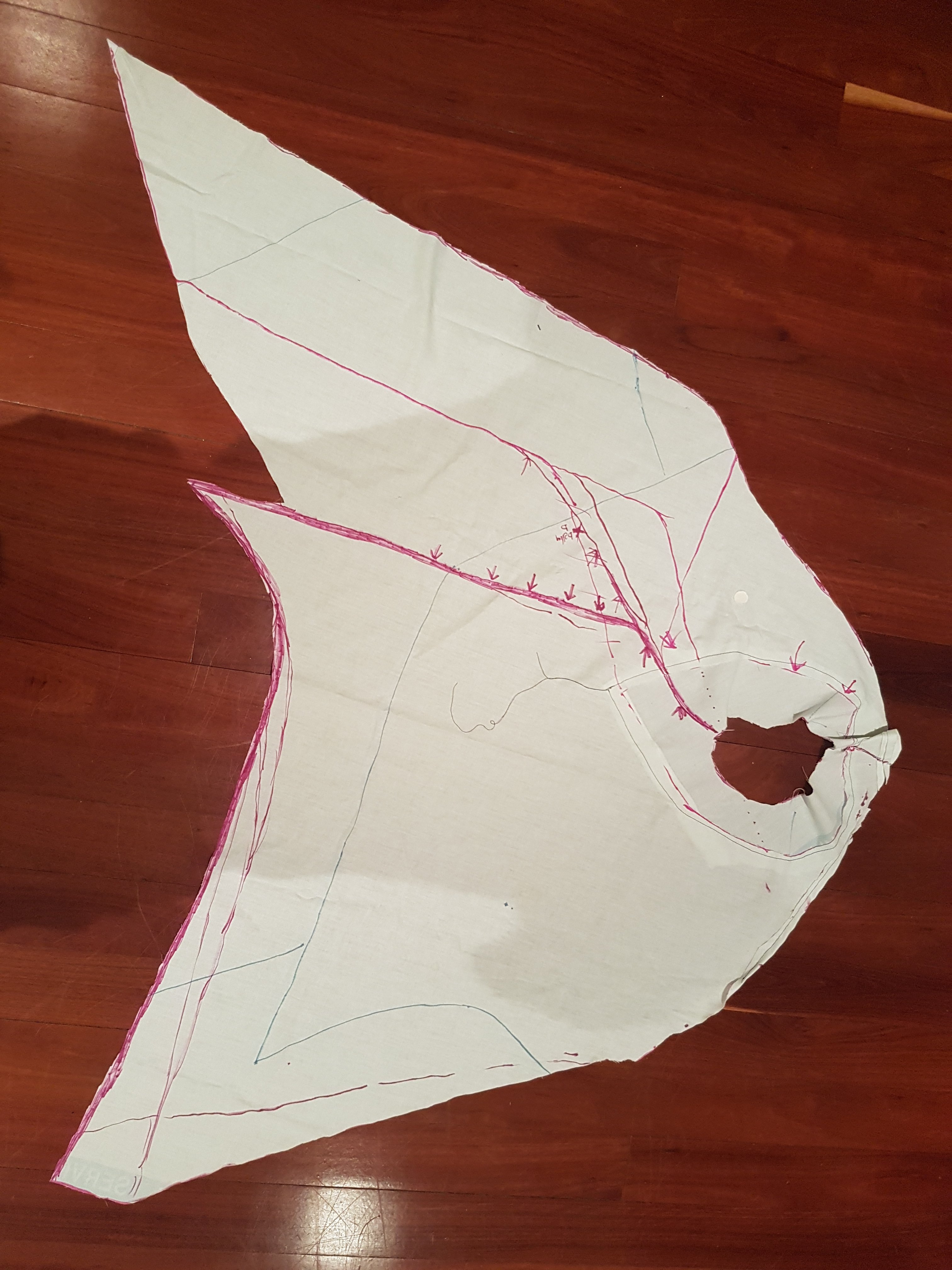

The wrap that goes around the tunic looks simple, but actually took a lot of time to get right! Once I figured out how exactly to make the wrap base (which was tricky, but then I had a eureka moment and discovered it was all one piece of cloth disguised to look like two!). After this I of course drew it out onto the largest piece of cloth a had and got to cutting it out. I tried it on and immediately found an issue - I had made the arm hole way too big! So I sewed a piece of cloth over the hole and more tentatively cut away at this new hole, putting it on, checking the fit, before cutting out a little more. A hard lesson learned - always leave extra fabric to cut away later if needed rather than cut it away straight off and have to sew and patch it back up! So then, after lots of experimentation, wrapping, fiddling and tonnes of scribbling annotations all over the fabric - I had a template which I was satisfied with. The good thing about the wrap is it comes in template form - I simply lay the first one down on the new fabric and trace! Okay enough prattling on, here is the pic compared to the original drawing for reference:
Edit - I also cinched up the shoulder part a little to get it to round over the shoulder more. I also sewed over the back slope side by folding the material back in over itself to reduce its size and encourage it to hug the back.

Looks great. Will you put on all the templated pieces for progress pics/testing the fit all together?

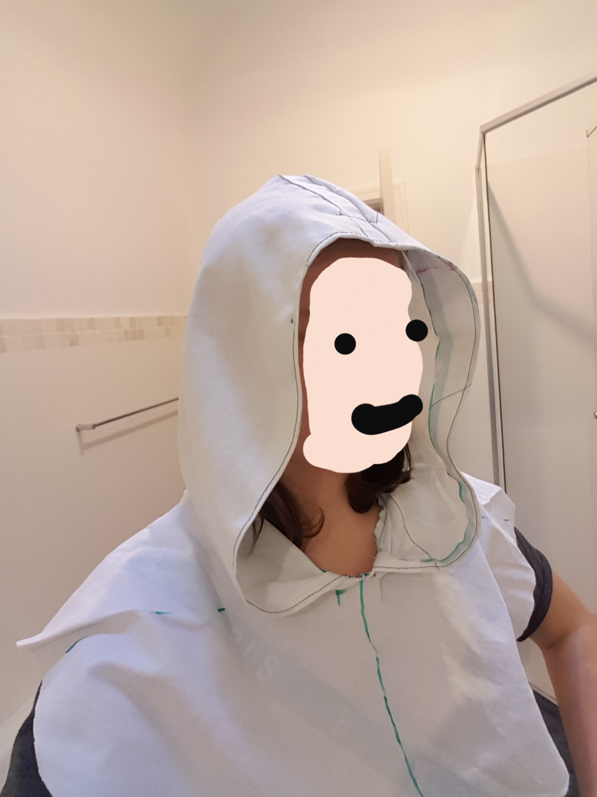

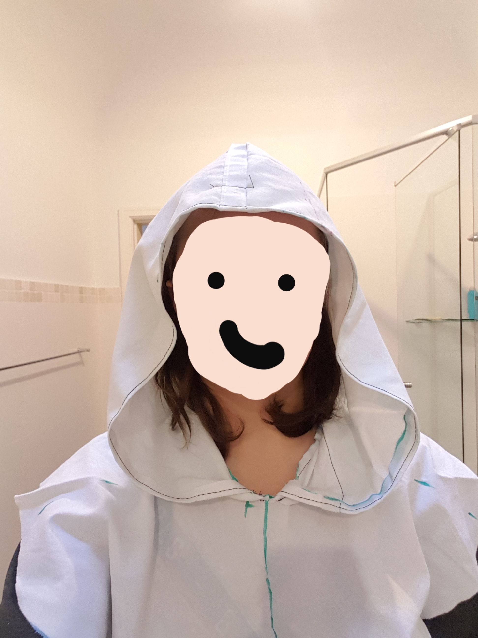

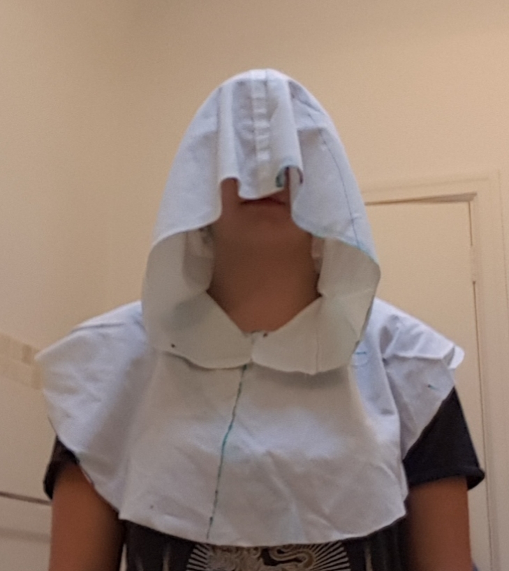

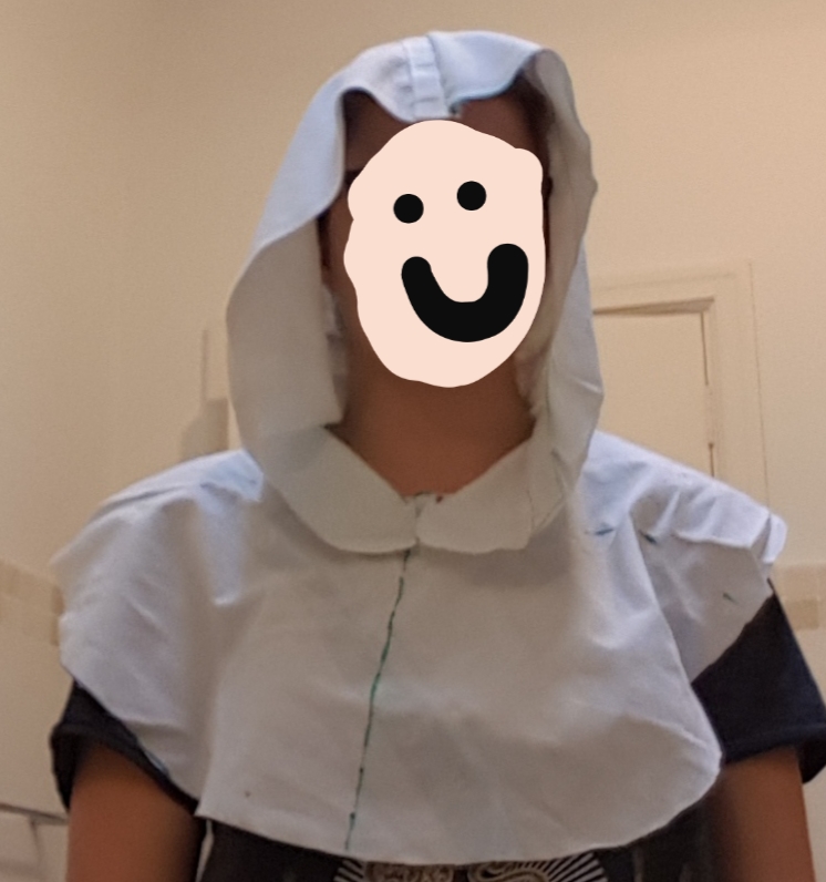

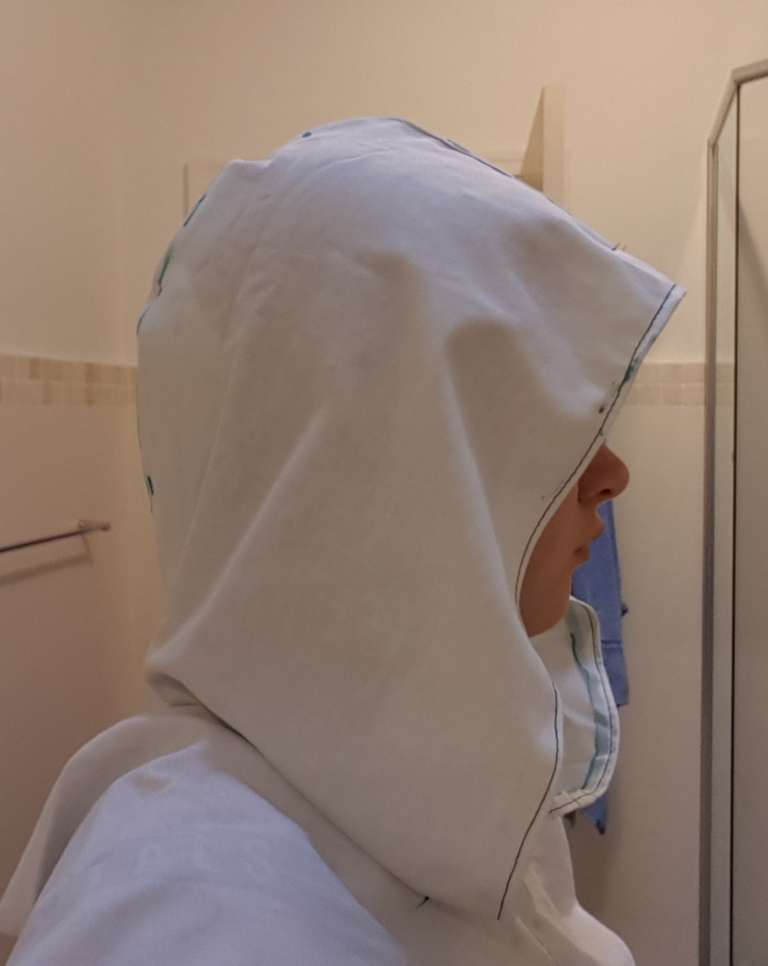

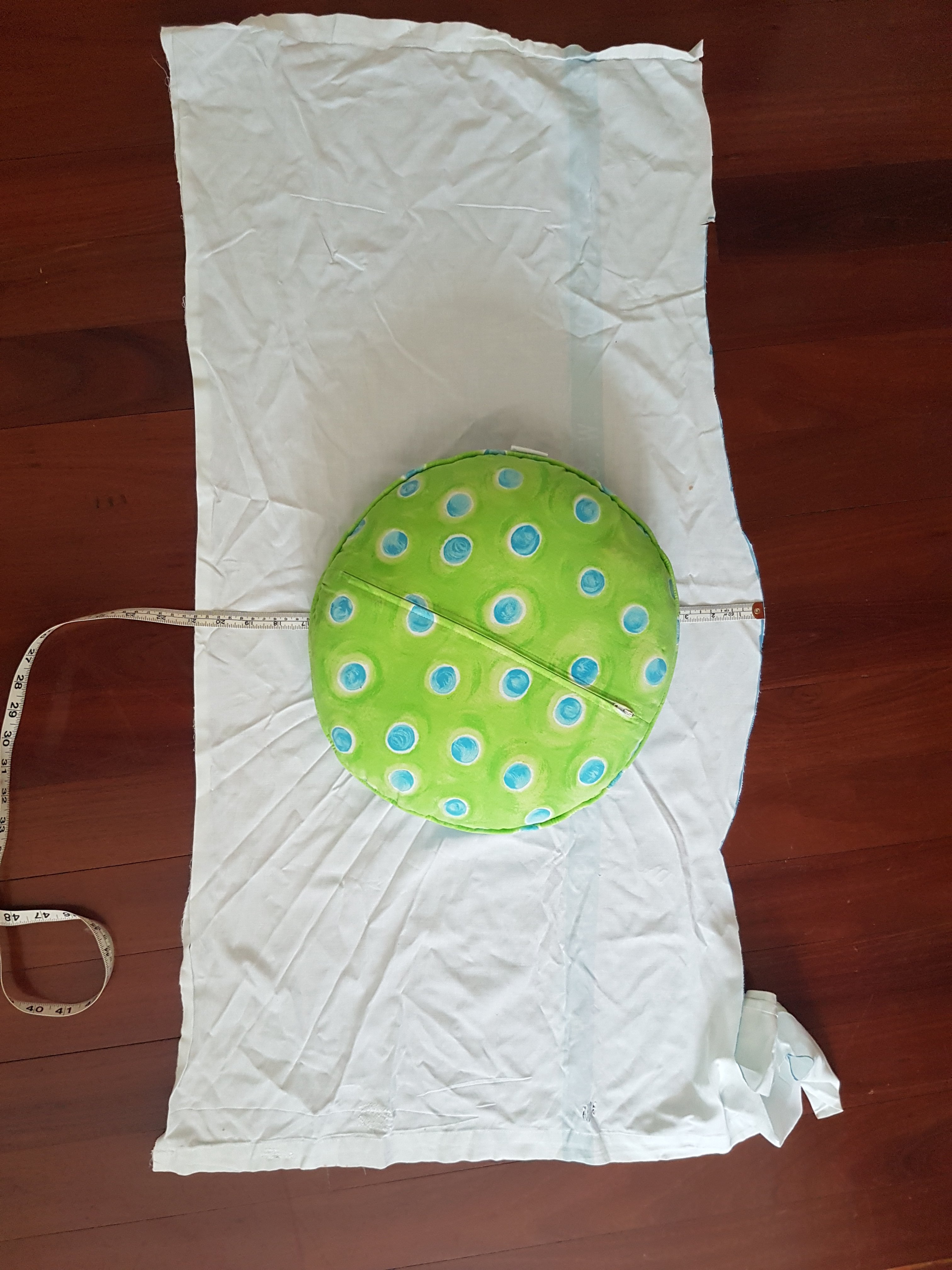

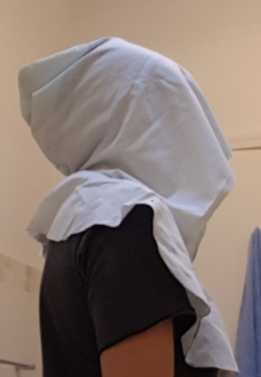

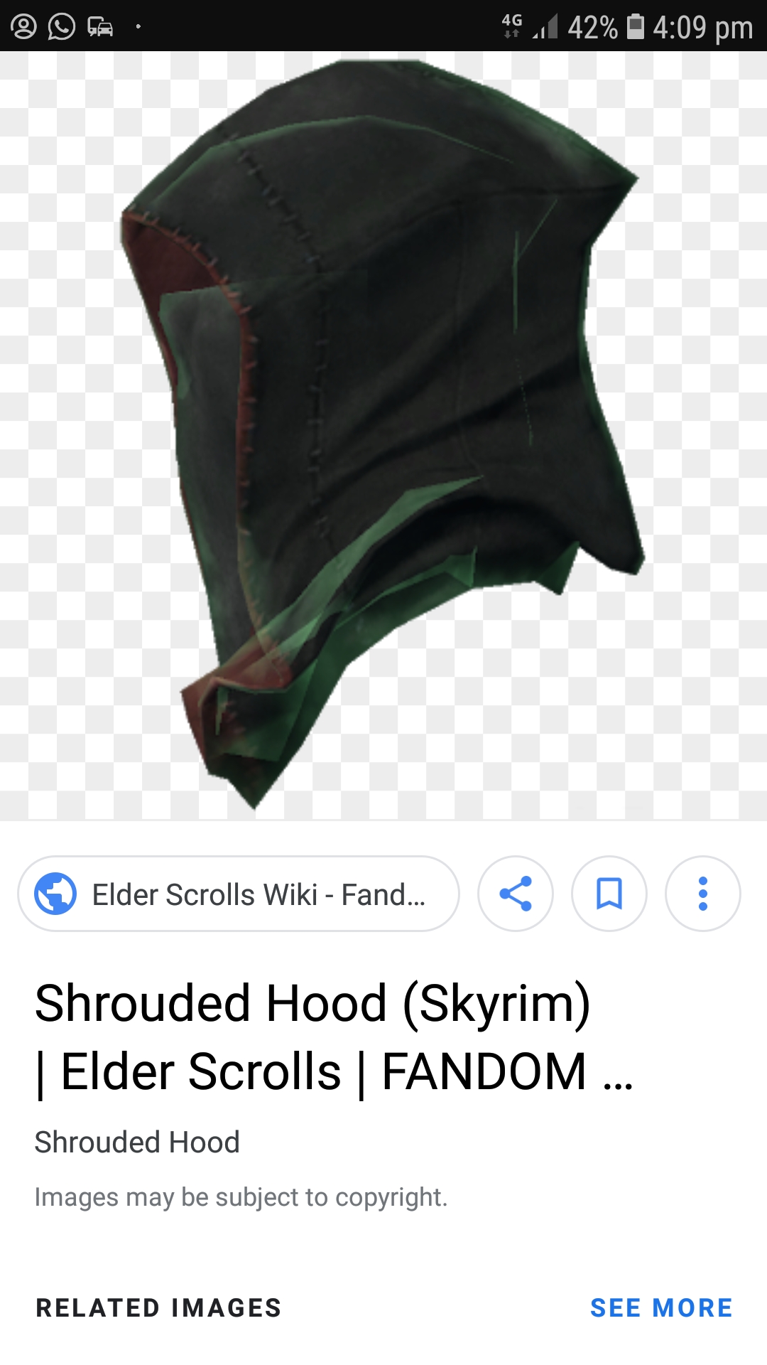

The hood is done! It was sadly a result of productive procrastination, but a result is a result! I used the first template a found even after a solid half hour of research and watching videos (which helped me understand how templates fit together) - I guess it speaks to google's accuracy and relevance of results. Turns out it did have quite a lot of flop at the back which I in the end removed (despite liking the flop) because the Skyrim design is more fitted to the back of the head. The one change I haven't made which I intend to experiment with is the opening - as you can see on the character below the opening is more narrow than my design which is quite wide. I'm thinking of making a mini mock test hood just to see how changing the slant and length of the hood side of template influences the hood opening (and watching more videos).
The process:
1. First I cut out the circle for the lower part of the design which the hood attaches to. The design did not specify any measurement for the neck opening so I just did some quick maths based off the length of a loose circle around my neck - like that of a collar. The circumference of my "neck" measurement was 45 cm, and my rearranging the subject of the circumference of a circle formula I could get the radius of my neck! Who said sewing couldn't involve algebra?! The radius of 7.16 cm was actually in that golden zone of loose enough to get the collar over the head whilst still being a relatively small collar (of course this depends on your head size, my sister has a fat head so I'll have to readjust if she wants a hood). Now I have the small and large circle measurements (note - I had to bring it down to about 22 inches because my piece of fabric wasn't quite big enough). So I set about cutting it out. I used a circular pillow to help as a guide on roundness and getting the right angle on my circle from all sides. I cut this out of course and now have my base circular thing which sits on the shoulders.
2. The hood was relatively easy to cut out, I made sure to keep an eye keeping the same ratio as in the picture - I didn't bother trying to print out this guy's template to get the very exact ratios as eyeballing is good enough for tests. I had to cut this out twice of course, and started off with pinning and sewing up the back and top of the hood. After that flipped the shoulder base and hood inside out and pinned the tan-curvey neck side of the hood to it. I started by aligning the back to the back then working out from there placing a pin on the left of the back, then the right, then left, etc to force out kinks in the fabric. This is then flipped the other way out and sewn together. After that I found the hood way way way to floppy at the back and came back, flipped it inside out and took a good portion of the rear, (looking at the far right image) I basically cut from where the blue strip meets the top of the cloth in a gentle curve outwards and back down towards where the curve ends near the blue strip. This was guided by putting on the hood and marking with a pen the curve of the back of my head, and then cutting that curve out with a bit extra fabric along the edge and re-sewing. This worked a lot better as you can see in later images. I also folded the opening of the hood in a couple inches, maybe around 6 to 8 cm. This provided more stability to the front of the hood and helped it jut out more and give the edge strength and a nice curve. However, as stated earlier, I may have to take in the opening and make it narrower to make it accurate to the original design. I'll also fiddle with the shoulder part and how much I want on each side.
cowl pattern.jpgradius of neck opening.JPGtracing circle base.jpgtemplated hood.jpg
Before adjustment:
After adjustment:
The process:
View attachment 842155View attachment 842156View attachment 842157View attachment 842158
View attachment 842146View attachment 842147View attachment 842148
Before adjustment:
View attachment 842149View attachment 842154View attachment 842153
After adjustment:
View attachment 842150View attachment 842151View attachment 842152
Oh you nerd, you actually included the maths? Hahaha very nice. Love the perspective you included on the face.
