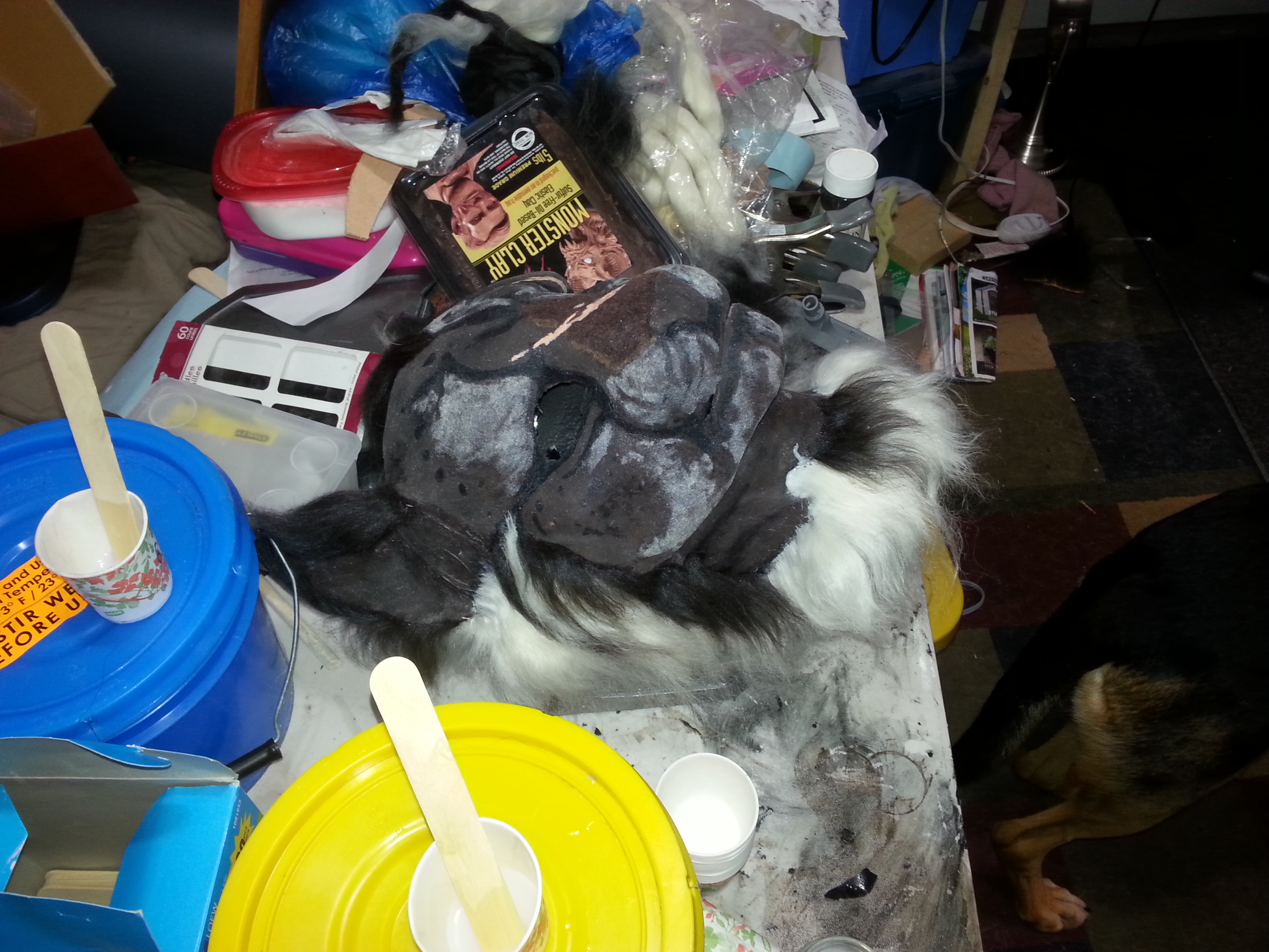

I'm continuing work on hairing the mask. I'm building up layer upon layer of hair, working from bottom to top (based on the hair direction, so I actually work from the tip of the ears down, etc). It's going well. I'm pigmenting the silicone to kind of match the hair color as I go. Only problem is the silicone cures a bit quickly, which is fine when I'm only doing one color but when I need to lay both black and white hair down it's a little tough. Since this is the Dragon Skin Fast that could probably be helped by getting some of the slower curing Dragon Skin. But I'm not sure I want to buy a whole kit. I guess it depends on how many more of these things I'm going to do. I only have enough Dragon Skin left for *maybe* one more mask, so I'm planning to buy another gallon kit at some point here. Maybe I'll buy a trial kit of the slower stuff to use when hairing.
