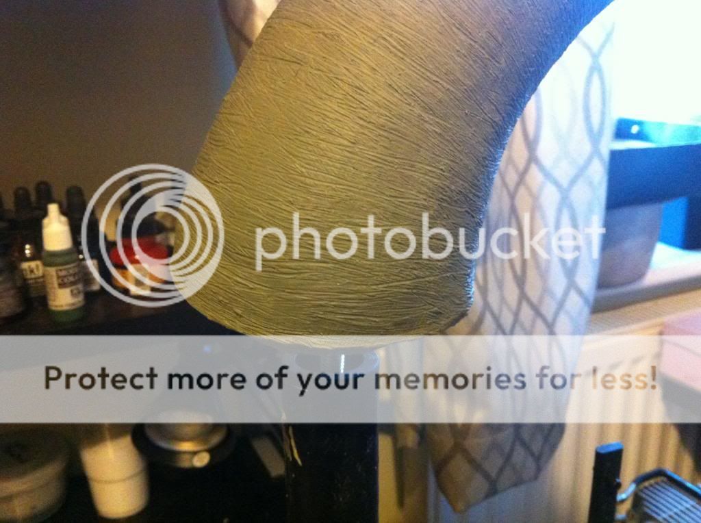

Finally started back on the horns the other nite. Overall shape is done, just need to refine angles (such as the tips pointing in more) then smooth and texture.
This is how they started off

Horns are in silicone as we speak. I did not want to do the very noticeable ridges of the in game model and wanted to keep them similar to the art I was using but if they were too smooth it would not be nice. So i added small details, my texturing is not the best (still practicing) but it will do.

Due to some foam which went bad the molds were ruined for the horns (got one cast and one which I was somewhat able to salvage with coats of resin but would be a bit wonky) but gives me an excuse to fix the horns as I was not happy with them and how they fit. Since these pics the white horns have been trimmed down and made a bit smoother and the grey ones have been attached properly and getting prepped for paint. Will do a thread when they are fully finished
