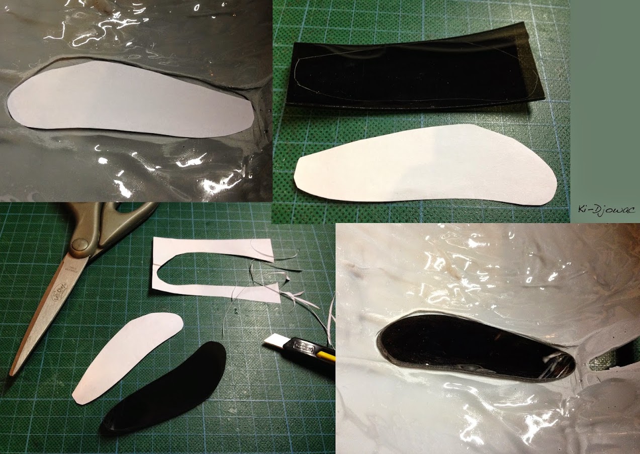

Made a paper template once i knew where the T-visor lenses would be placed and grinded them down into shape with a grinding mill and sandpaper. To get these into the shape to fit into the eye slots, i used one of those paintburners to make them a bit more flexible. Once hot enough, pushed them into place and they stayed into the shape of the mask once they cooled down again. Needless to say if you ever attempt this yourself : BE CAREFUL

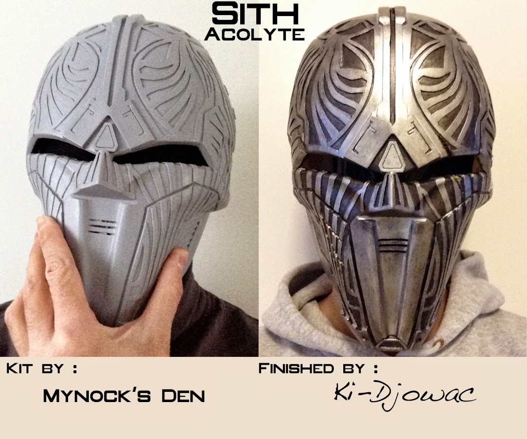

Before and after

Here's where the eyes were Dremmeled flat on the inside. The kit itself came with 2 pieces of black see through cloth. I decided against that and cut up a T-visor i had lying around from another project. I needed some kind of flat edge around the eye areas to make that idea work.

Before and after
